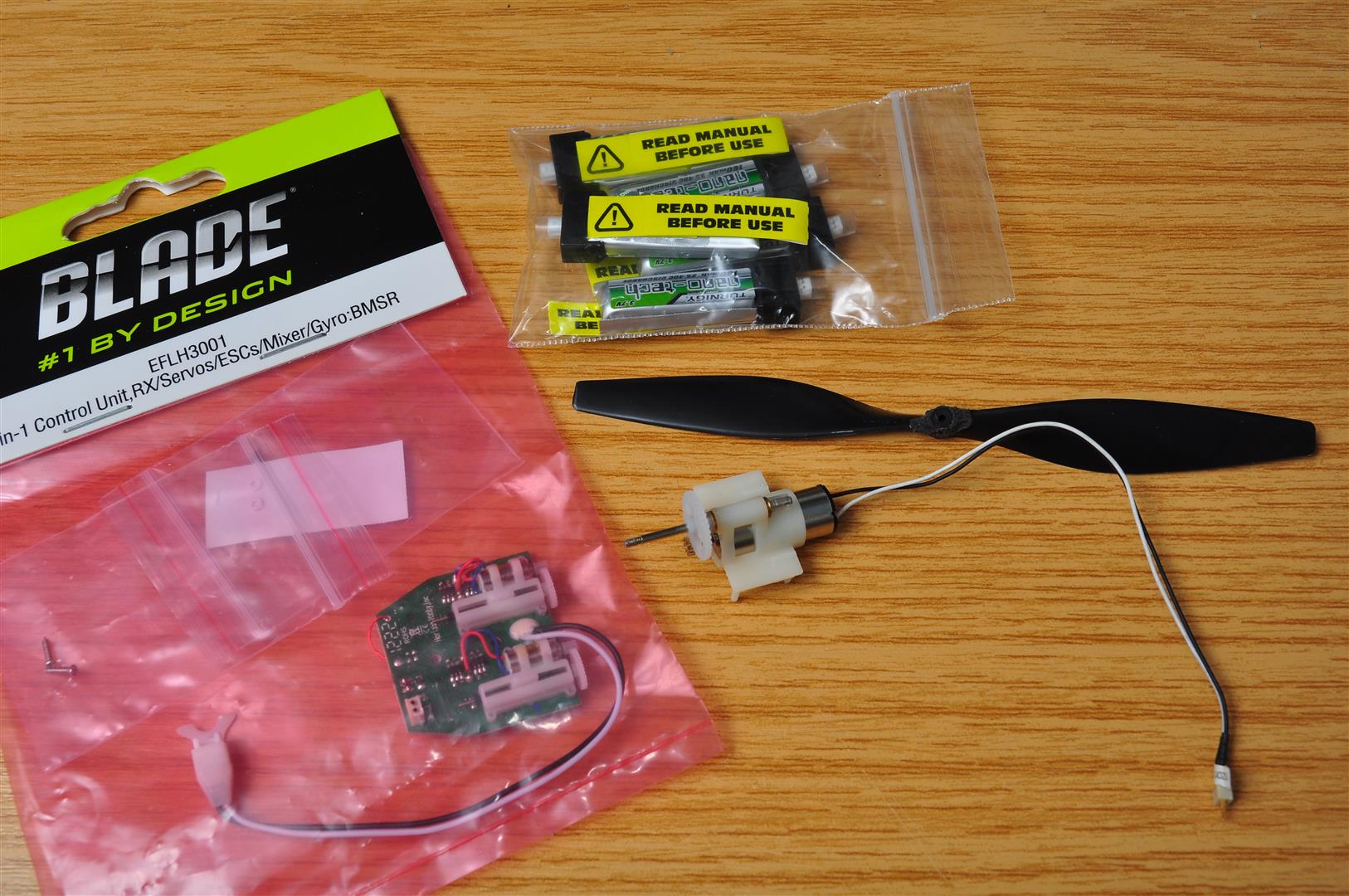

Andy S has been great and has been supplying me with info about motors radio etc etc. So to that end I am using the gear from an artf indoor model. The motor/gearbox is from a Parkzone indoor P-51, the Rx and servos are from a small indoor helicopter, this also gives a speed controller. The batteries are small NanoTech 160 mAh items.

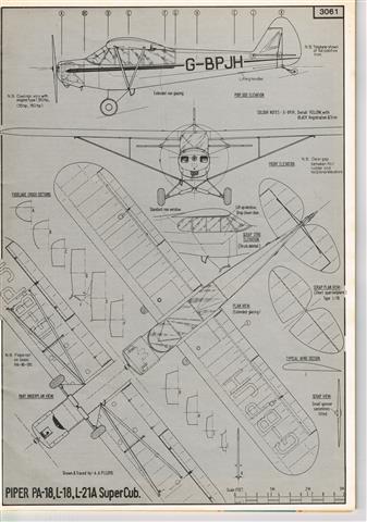

I have traced the 3 view using Turbocad and am in the process of filling in the lines with ideas :)

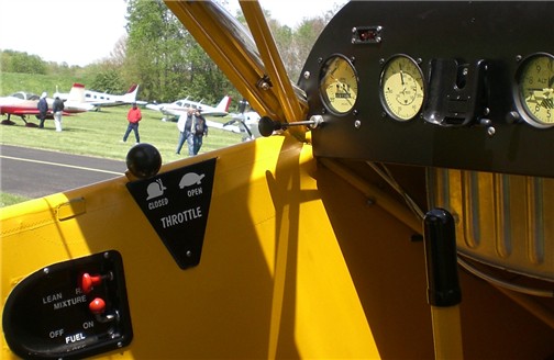

05 Jul 2016 13:51 #3 by Septic
Although this photo is NOT of Yankee Bravo, the throttle nomenclature is fab :)

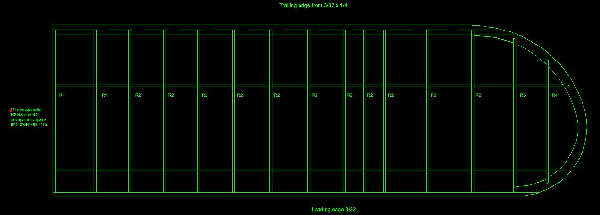

05 Jul 2016 23:05 - 05 Jul 2016 23:07 #10 by Septic
Well the cadding is coming along well. It has taken several hours today just to refresh myself with the shortcut keys and snaps. Well worth knowing as they do make the drawing move along so much faster. Anyway I had originally set the wing rib upper and lower slices at 1/16 square, but I dont think my fingers will cope. So have made the rib slices 1/16 x 1/8.
The leading edge will be pre doped air mail paper. As well as the wing tank covers.
Not as elegant as Andy or Tony but I am plodding along.....

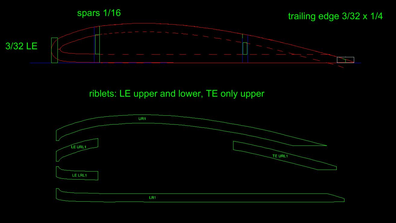

Right.... ribs are finalised, have dumped the idea of the half ribs as more trouble than they are worth....and barely visible on full size. Can add them later if feel I have made an error by omitting them. I have their shape.
Wing plan in basic form is done:
Might take a breather and do the tail end bits, before girding the loins for the fuselage!

Okay two days into the cadding and thought I would double check the riblets with my files. Spotted I have traced/used the flapped version of the wing GRRRRRRR.
It means starting again.........
