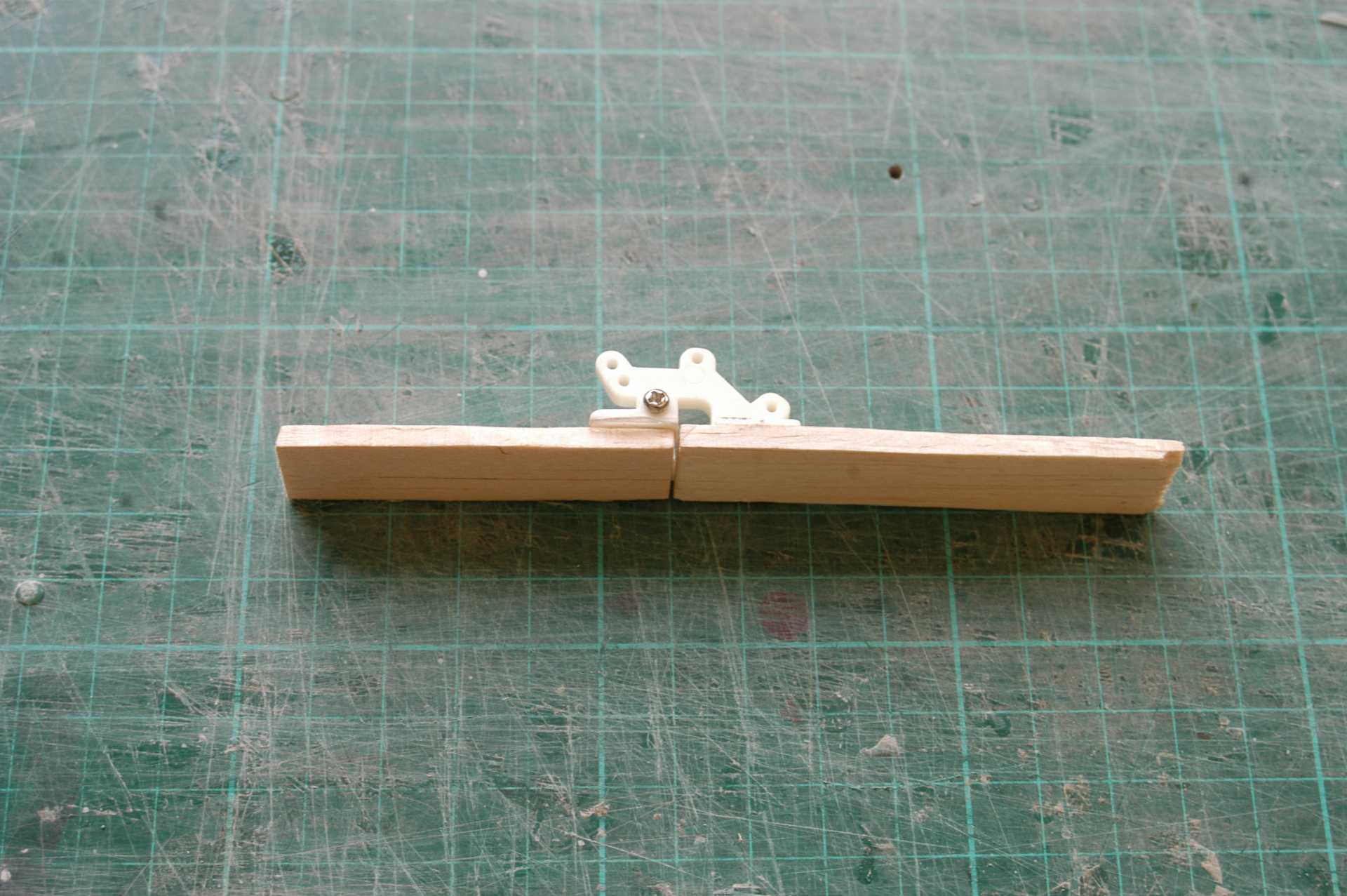

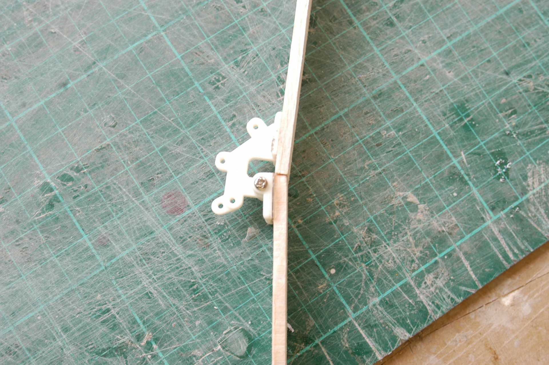

Simon it is the hing itself that will not allow the door to open, with a pencil line gap between door and airframe, as soon as you try to open the door it hit the air frame
I will load a picture when i come back from flying

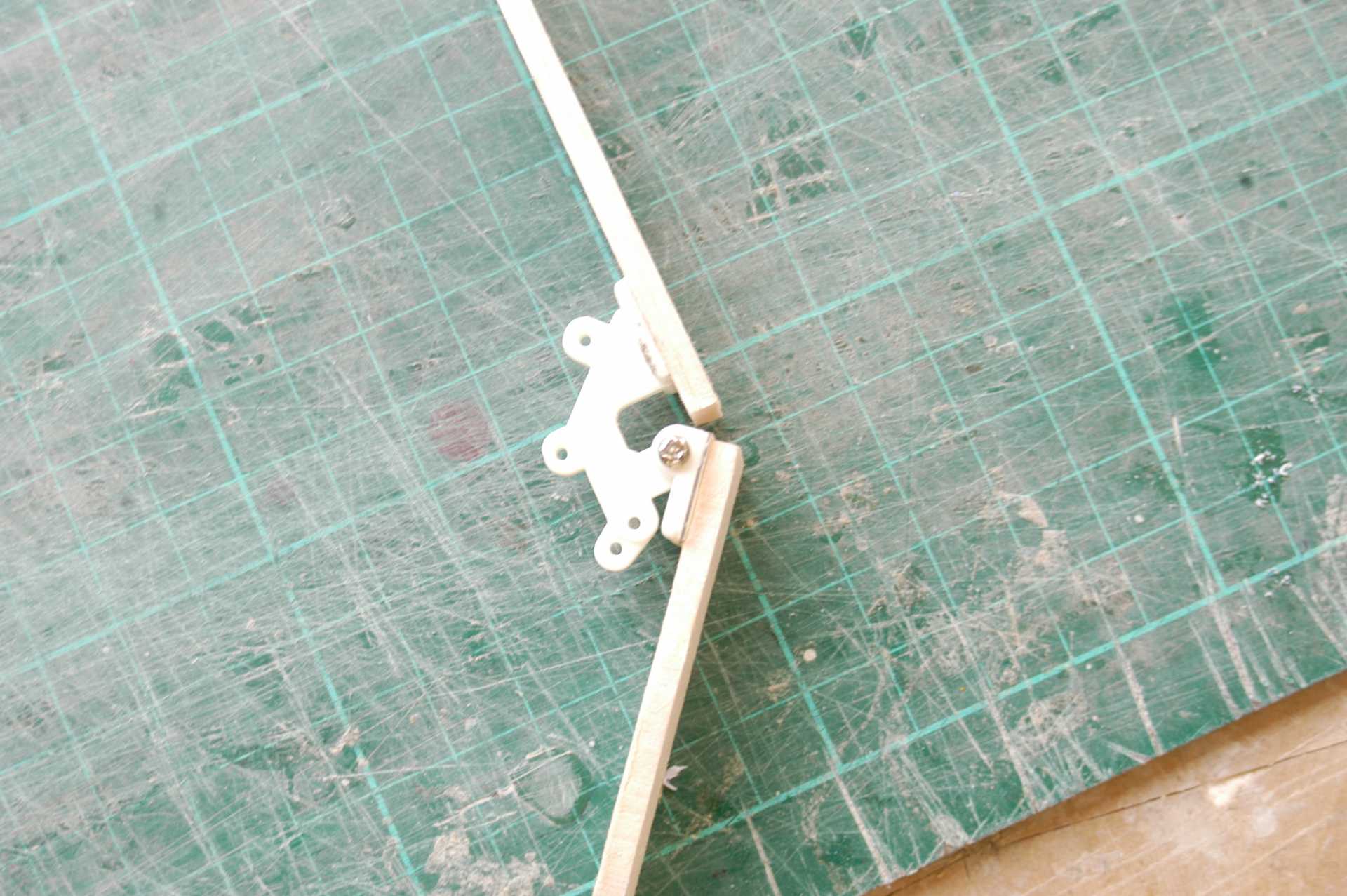

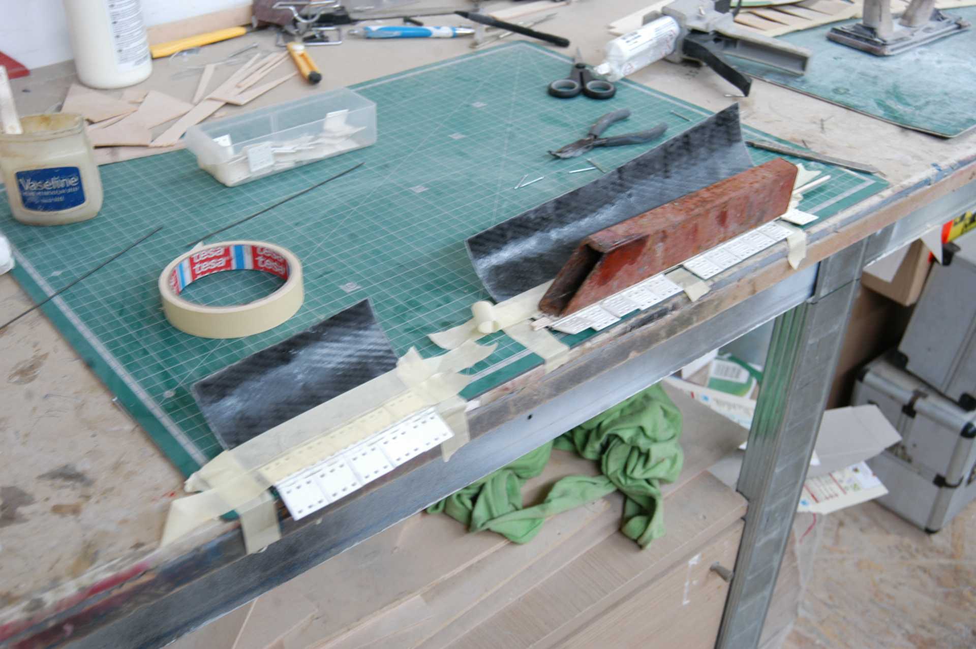

26 Mar 2018 01:00 #154 by THE BLACKBIRD
I got the nose cone glassed
And the hinge i was going to use on the gear doors
I scraped the gear door i fit, will make another, the joint between doors was in the wrong place
Thanks: Klipkopwildlife, Quorneng, Squirrelnet

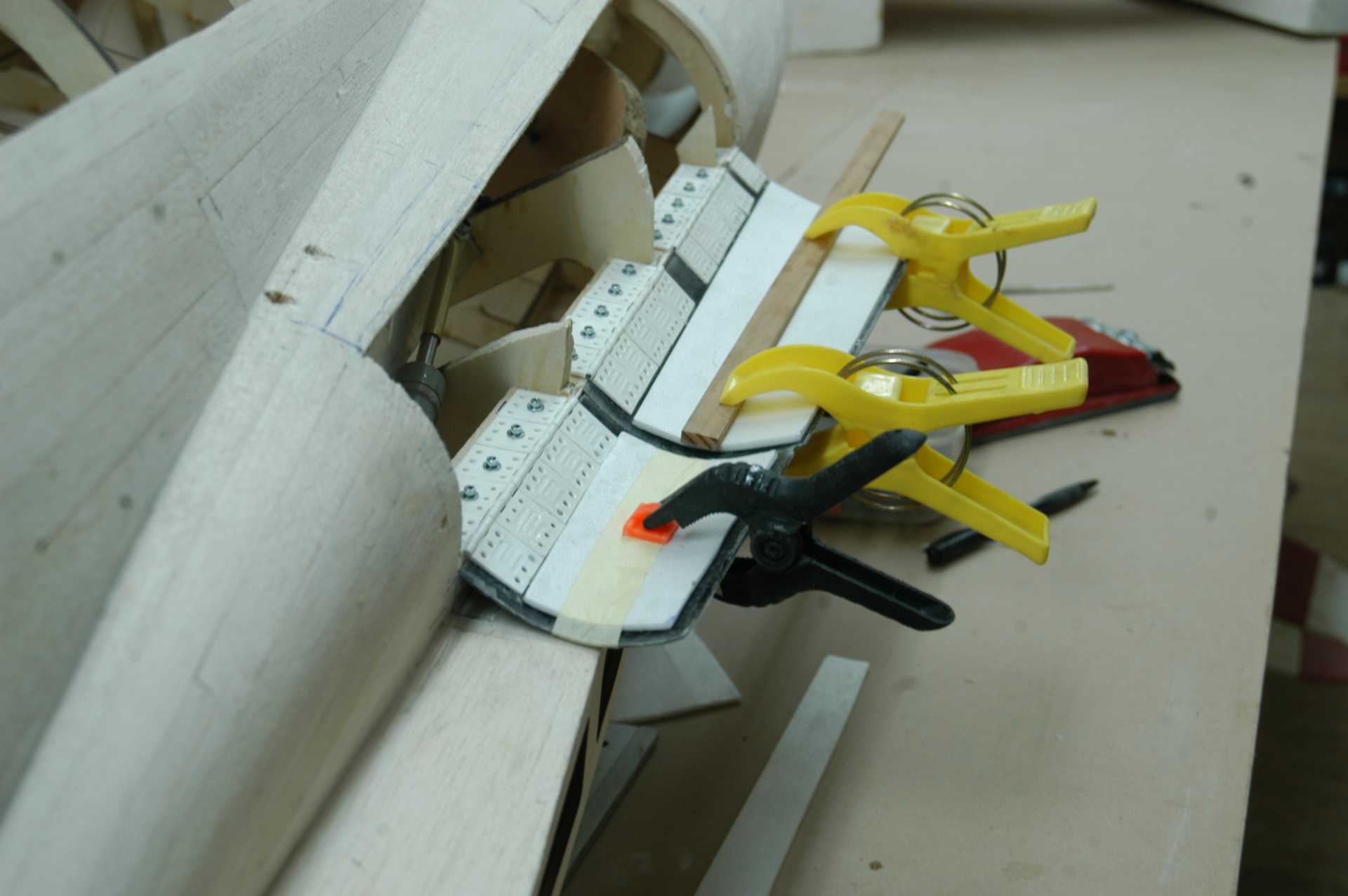

26 Mar 2018 19:52 - 26 Mar 2018 20:07 #155 by THE BLACKBIRD

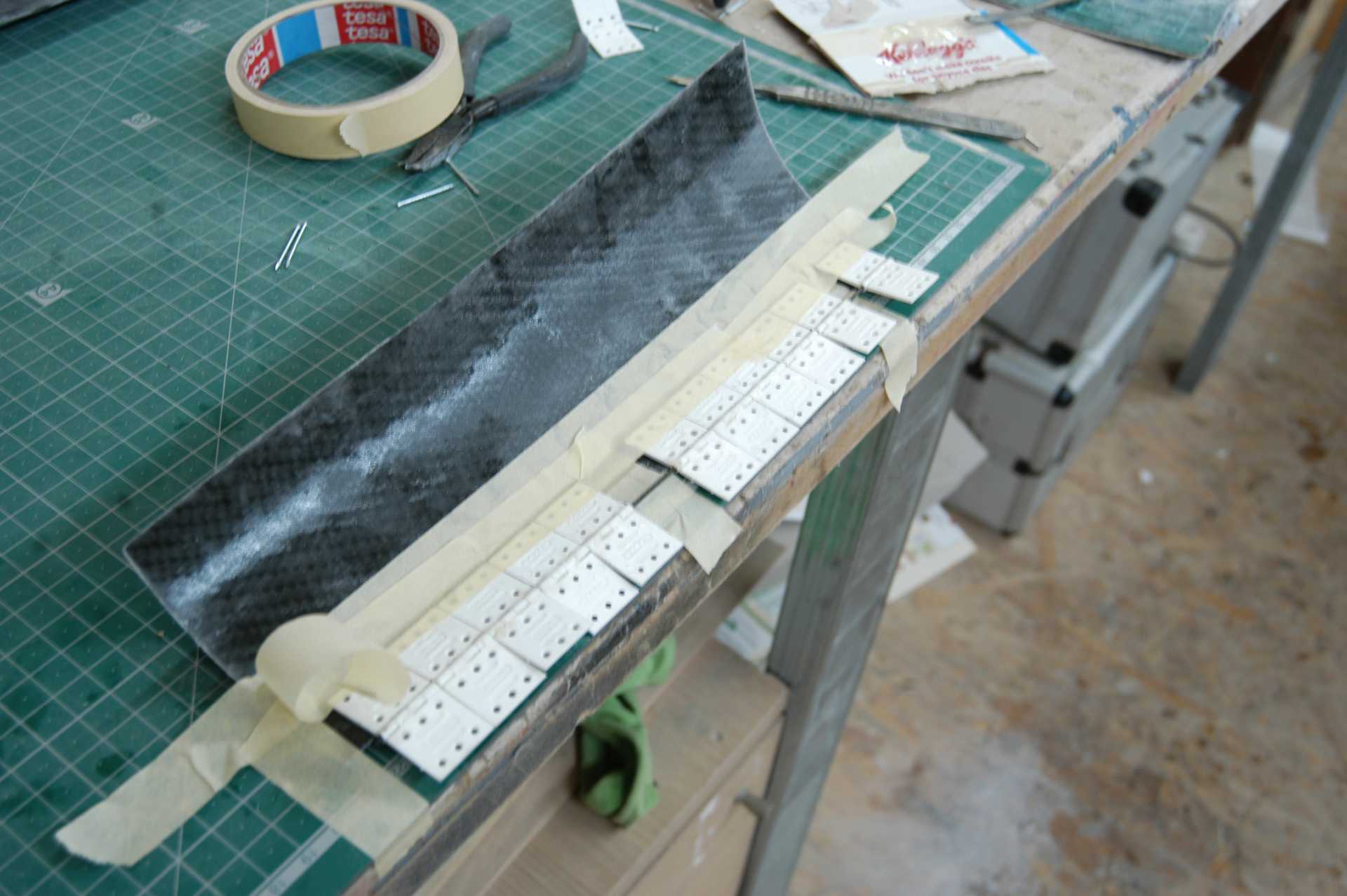

Glassed the thrust nozzel today
Made new retract doors, i had the joint between the doors in the wrong place, the front door needs to be the longer of the two as it will close after the retracts are down

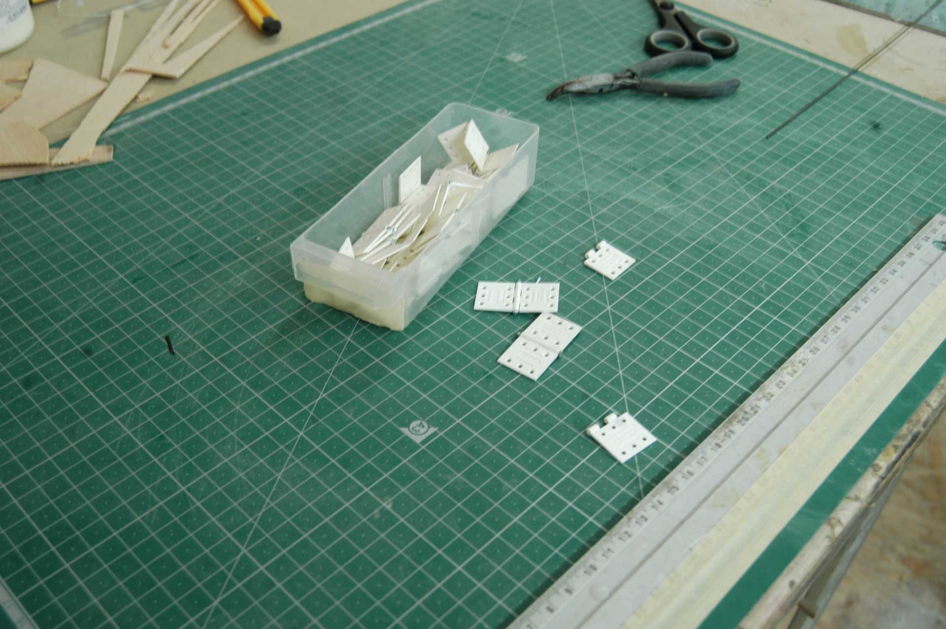

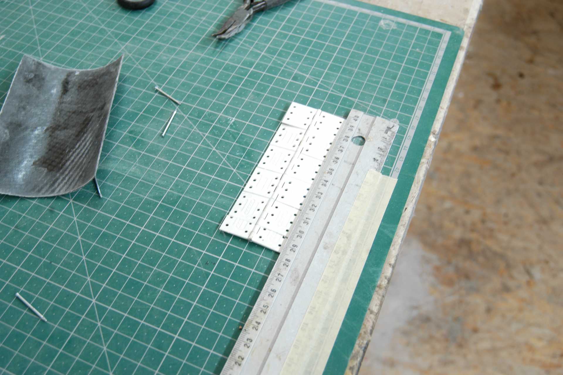

Made up some long hinges for the doors, removed the pin and replaced with piano wire
Hysoled them to the doors
Last edit: 26 Mar 2018 20:07 by THE BLACKBIRD.
Thanks: Klipkopwildlife, Quorneng, Ralpharr2001, boz, Squirrelnet

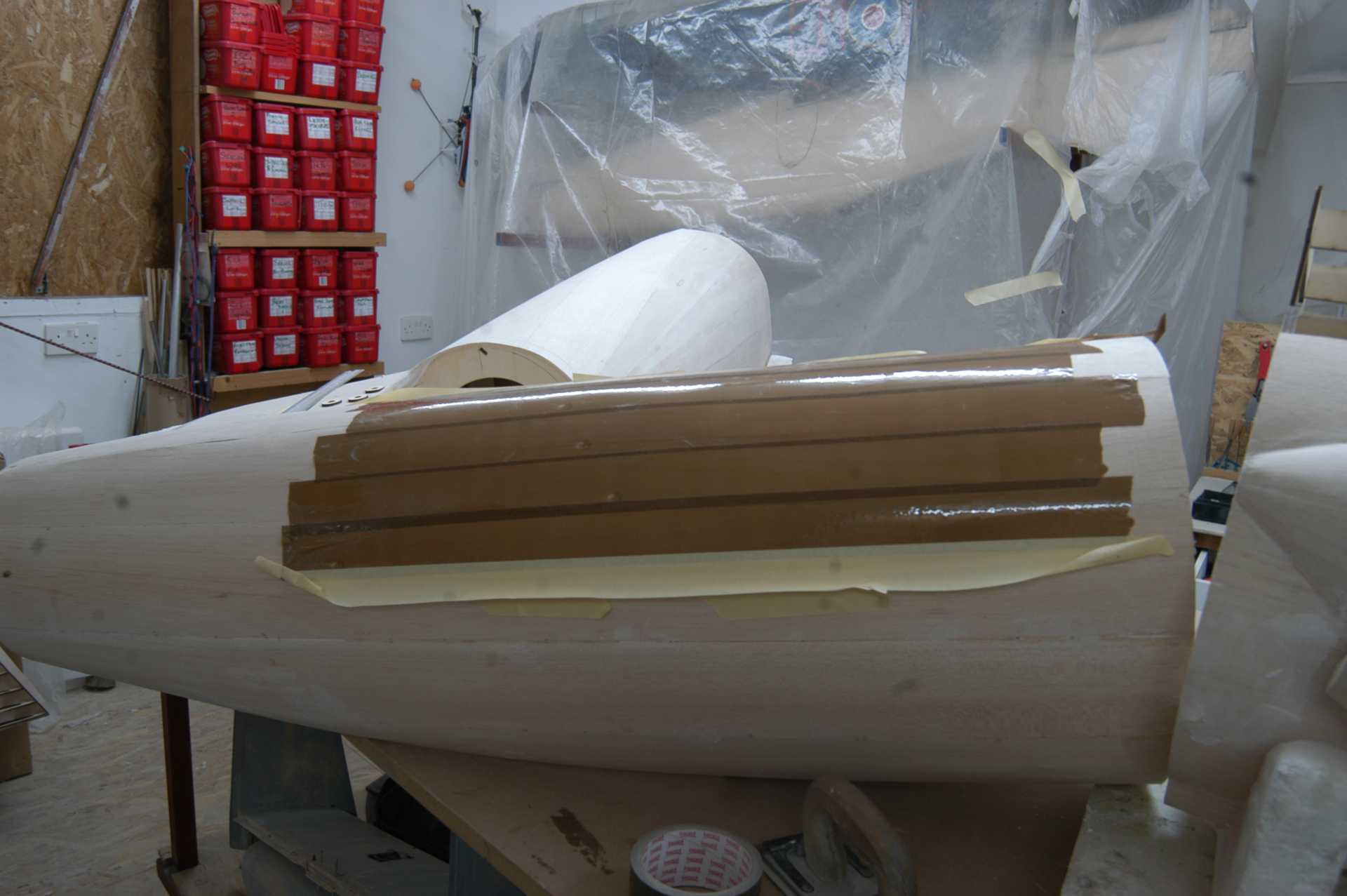

28 Mar 2018 20:26 #156 by THE BLACKBIRD
Got the first set of doors hinged and fitted, i have glued a piece of 3mm depron :woohoo: to the inside of the doors then covered it with fibre glass to make the doors even more rigid

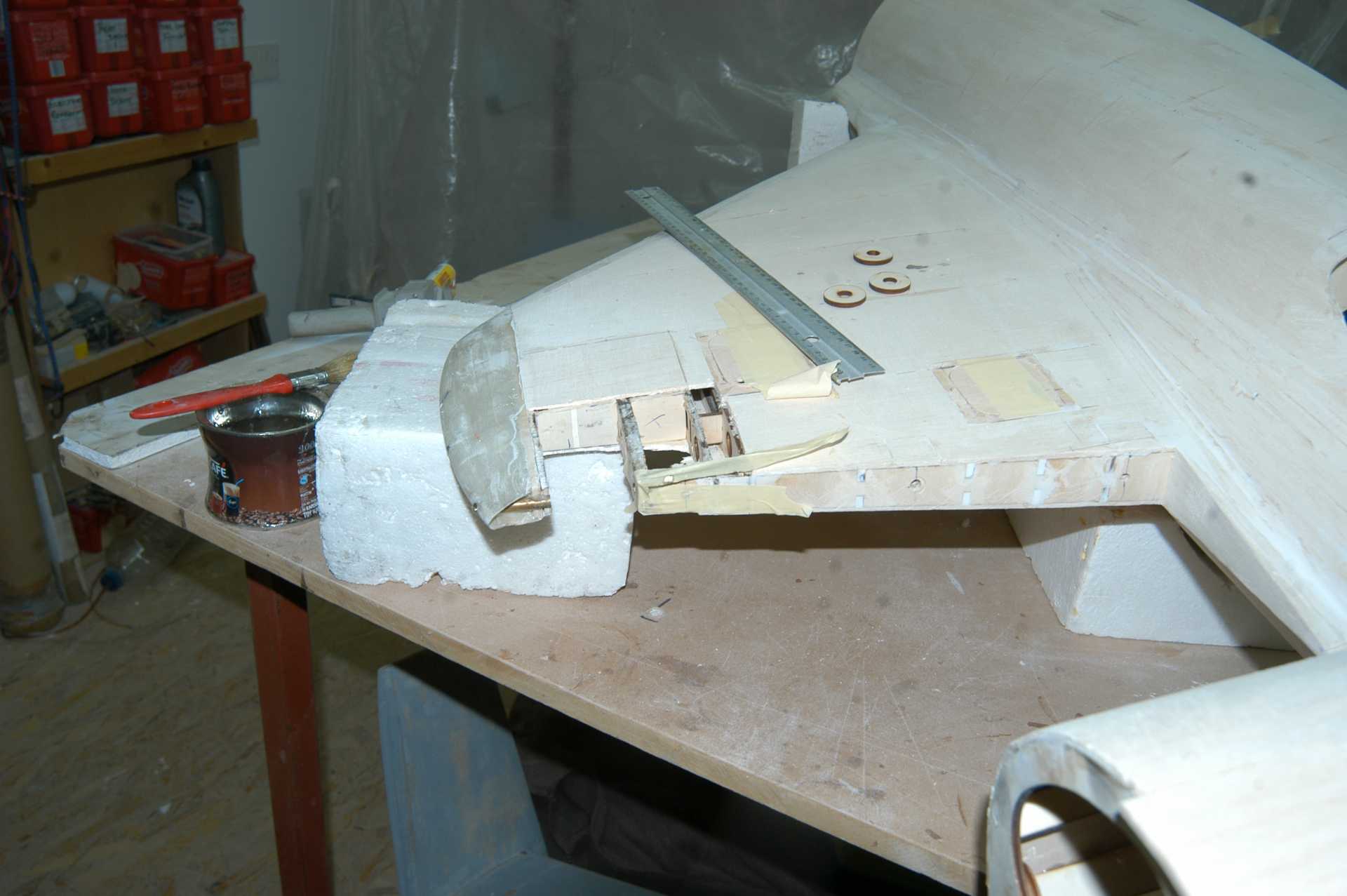

29 Mar 2018 19:58 - 29 Mar 2018 20:01 #157 by THE BLACKBIRD
Hysoled two brass tubes in the top of the fin as guides for the 6mm bolts that hold the tail plane on
Must say i have been a little concerned about the structure around the area where the tail plane mounts to the fin, so i ripped of the sheeting and will somehow strengthen it
Got the other main gear doors fitted and depron stiffener resined on, i will glass over the depron tomorrow

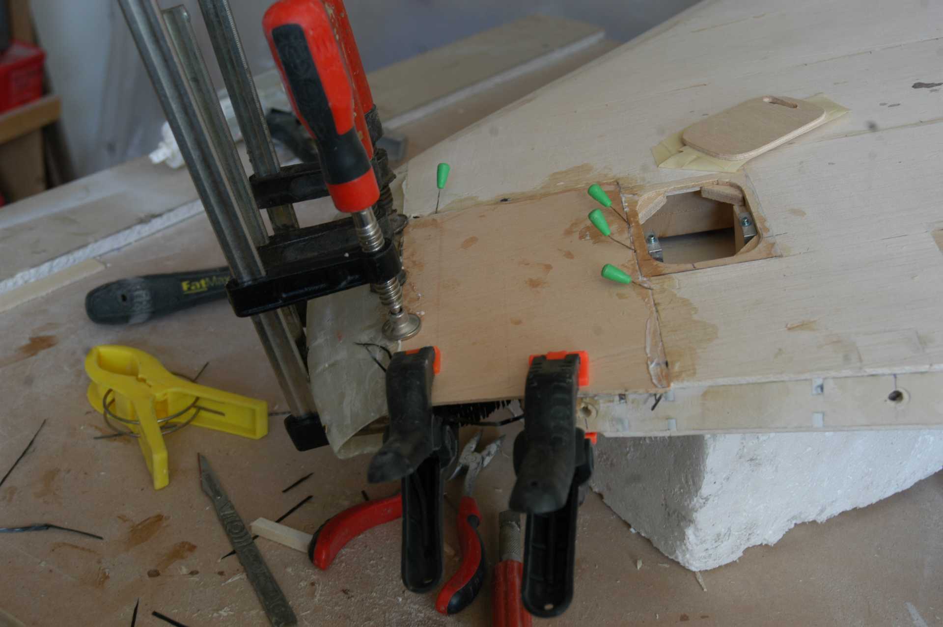

30 Mar 2018 20:18 - 30 Mar 2018 20:21 #159 by THE BLACKBIRD

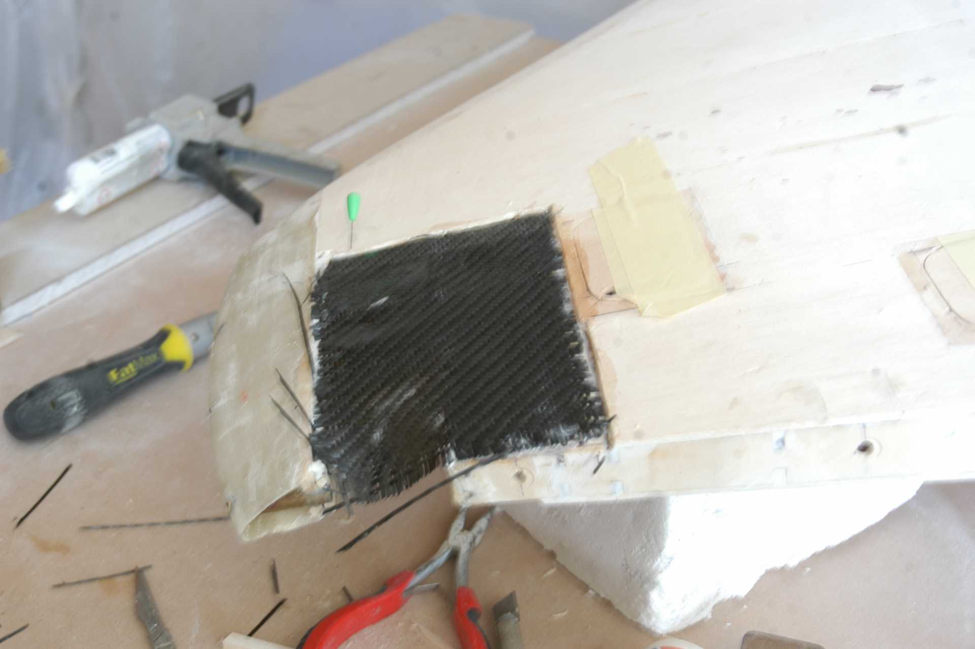

Made the opening bigger, put some more braising in then resin soaked carbon cloth
Then on top ply
Stood it on its wheels, well blocks of wood to get the length of the nose wheel and to see what clearance there was beneath it as they do sit low to the ground
It looks about right :)

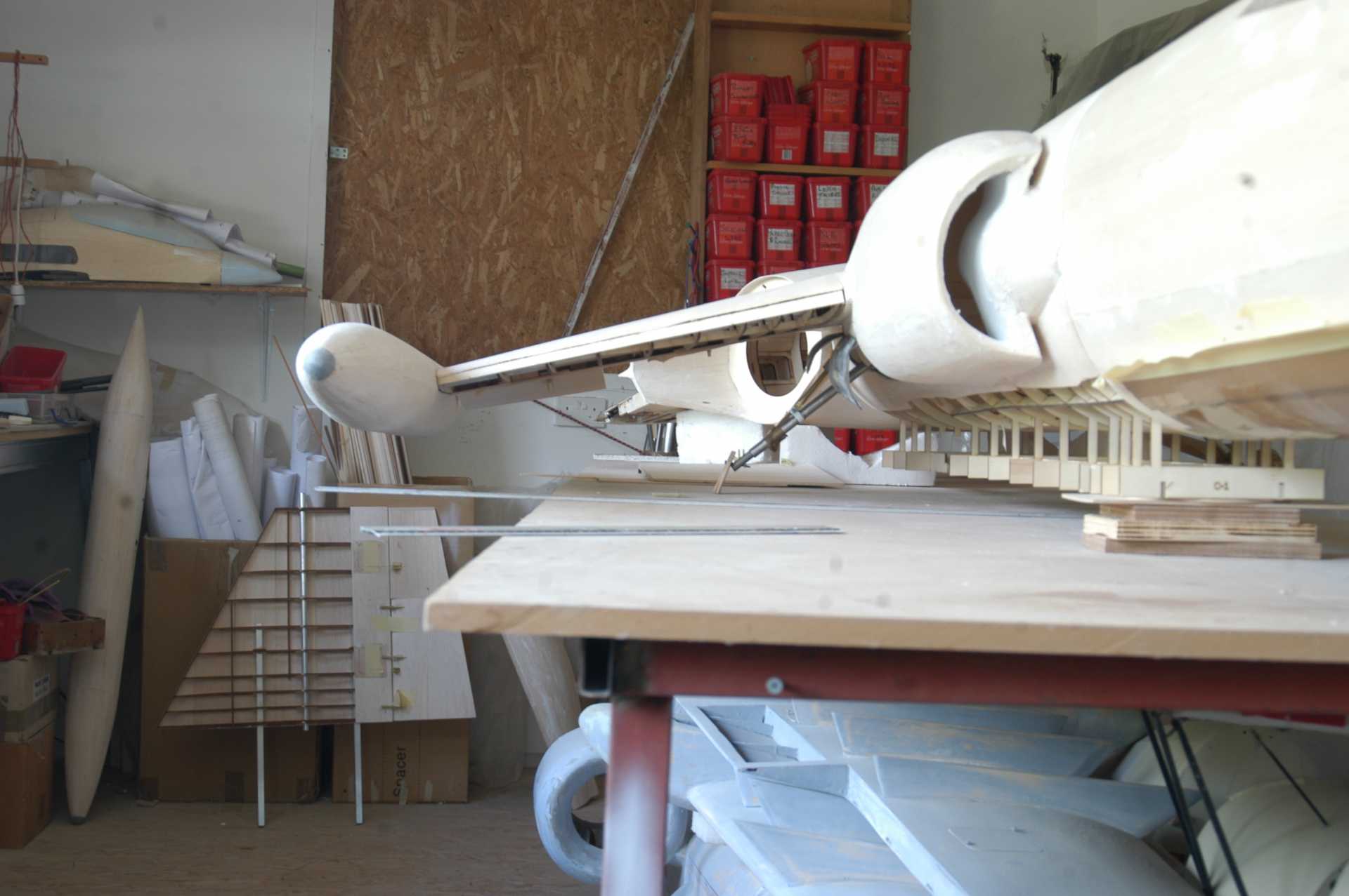

31 Mar 2018 15:00 #160 by Klipkopwildlife
Replied by Klipkopwildlife on topic The Cyprus peanut scale twin engine F104
I've been looking at that wing section, it doesn't look scale to me, probably will mean that the take off and landing phases will be a lot slower than scale.
31 Mar 2018 15:51 #161 by Quorneng
Replied by Quorneng on topic The Cyprus peanut scale twin engine F104
I am sure it is a practical section for the speed involved but it most definitely not scale!
A most extraordinary and very thin section! :woohoo:
