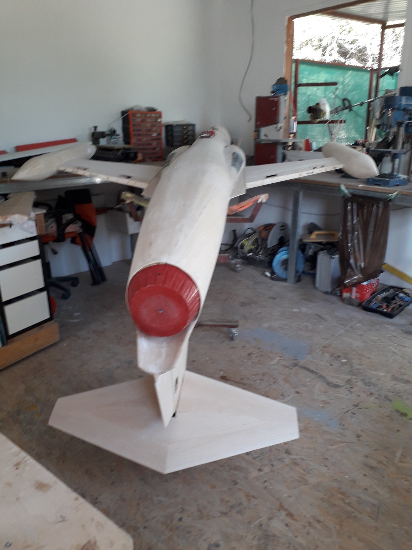

Still glassing the 104 but having trouble with the cloth, where all the folds were when it was in the packets
are all lifting off the sheeting, ill get over it but means more work
Iv got all the bottoms of the fuselage/wings and tailplane done now, whren its all done ill rub it down and give it a second coat of resin

Last night i finished glassing the three main sections of the fuselage :) and nearly all the control surfaces
Got the nose cone to glass again as its not up to standard, just had enough 4oz cloth to do it
Got some pictures on my new fangled phone but cannot work out how to put them on here, yet

At last i have got it all glassed, that was a lot of glassing with doing the glider at the same time
All i jave to do now is sand it all down :S

I weighed the F104 air frame yesterday with it all glassed but not sanded down and it was spot on 16kg

Spent 5 hours today sanding and all i got done was the centre section :S

25 Oct 2018 08:17 #195 by THE BLACKBIRD
After a whole day sanding yesterday it is now all sanded down :P but the glassing is probably the worst iv ever done apart from the first one i did, dont know why, i dont like to blame the tools but i think its a combination of the new to me resin, they did not have any of what i normally use, this stuff took days to go off even when i mixed it one and one, , usual to mix two to one, i even asked in the shop the mixing quantities, two to one they said, when i got home i saw on the tin 1 kg of resin and .45 kg of catalyst ????
And the cloth would not lay down where it had been folded, i even ironed it first
And thirdly me,
ho well more work with the painting, god i hate painting i always f(&%$ it up
