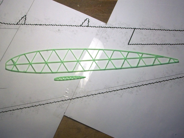

While I had the 4.3g servos I printed holders for mounting them in the tail.

13 Feb 2026 10:48 - 13 Feb 2026 10:53 #41 by Magpie
Replied by Magpie on topic 1200mm Dragonfly
In Cura the weight of the holder came out at 4g, on my scales it weighs 3.2g.
I tweeked the design & on Cura it came out as 3g, on my scales it weighs 2.65g.
I could reduce the length from 20mm to 15mm, on Cura this gives a saving of 1g.
The balsa servo holder for my Buzzard weighs 2.7g.
The 4.3g servo weighs 5g.
The weight of my uncovered tail is 37g.
I've got a nice long nose to hold the battery which should balance it out a bit.
Last edit: 13 Feb 2026 10:53 by Magpie.

13 Feb 2026 12:17 #42 by Magpie
For all you anorexics out there my servo holder now comes in at 2.0g. on Cura & 2.15g. on my scales.
