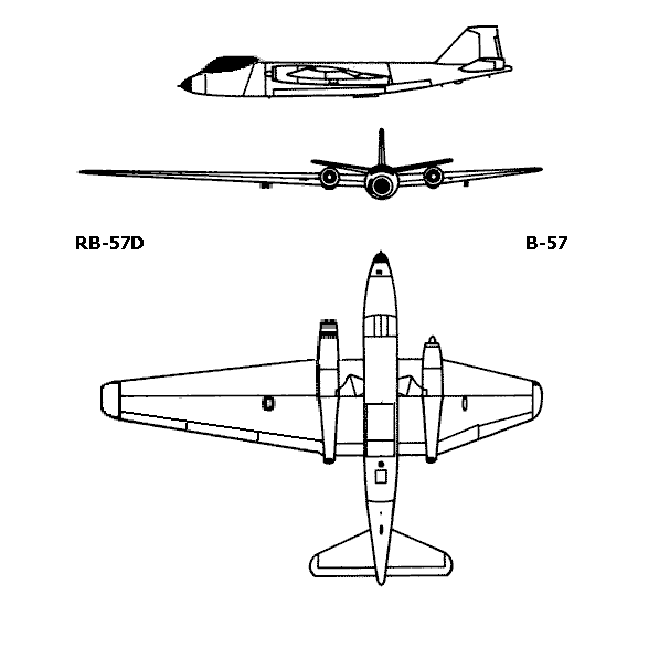

b) Build a RB57D. The one that had over span wings on an otherwise unchanged Canberra layout although it had J57s in rather longer nacelles. I judged with the extra span would fly pretty slowly so it would manage better on a low thrust level.
A neat view showing just how much the span was increased.

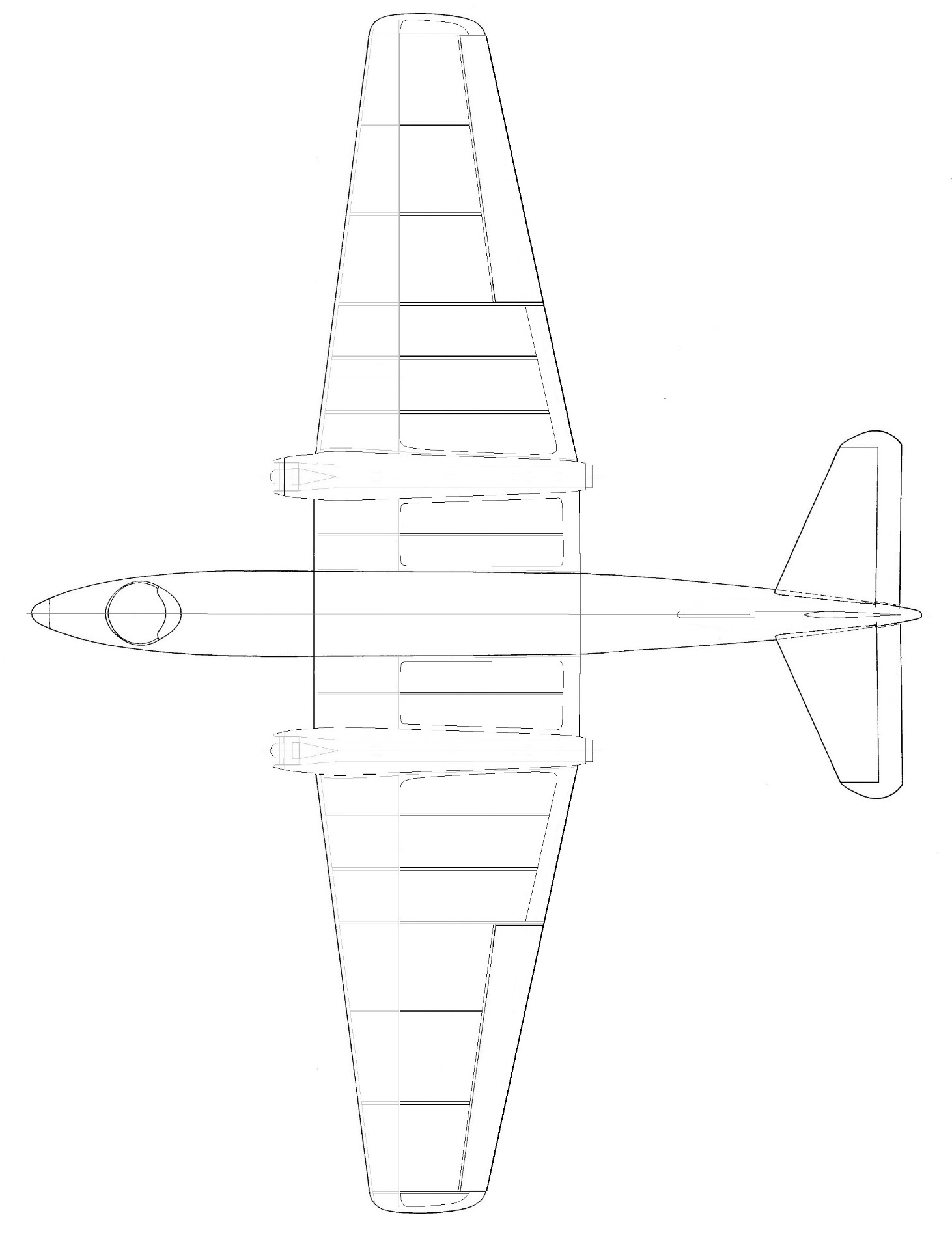

By a bit of judicious cut and past I have a RB57D plan created from the one I originally built the Canberra from.
It will just need blowing up to give a span of 54" and the outer wing panels tile printed.

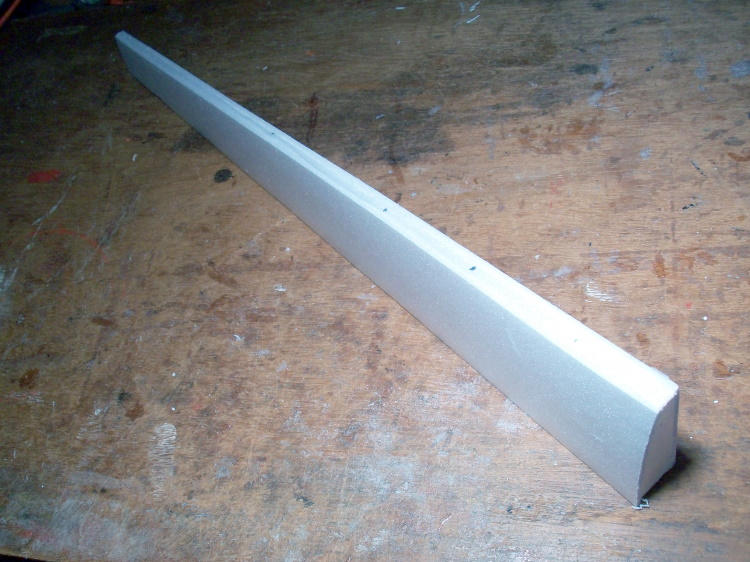

Just because I am lazy I decided to print 'masters' for each wing rib that can then be used to accurately cut a pair of ribs out of 2 mm Depron.
Only the biggest rib was actually drawn in CAD. The rest were % reduced using the CURA 'scale' function. The complete set just fitted on the printer bed so were all printed at the same time.
As I did with the B2 they are a true symmetrical section. As a sub 250 g EDF I judged minimum drag was more important than achieving the highest lift to drag ratio.

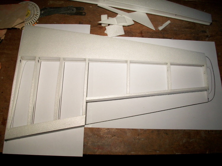

I read through the complete build log to refresh my memory and had forgotten the rather unusual wing construction method.
The outer wing panels were built 'free hand' working from a 'stand alone' D box spar.:woohoo:
So the first task is to build the D box.
Front, rear, top and bottom skins with 7 ribs. I cut out all the bits for both wings at the same time.
All 2mm Depron
A bit of a nightmare to put together. The front, rear and ribs are glued in place first (very wobbly!) and then the preformed top and bottom skins go on but once complete it is remarkably stiff.
It weighs 6.8 g.

21 Feb 2020 16:34 #116 by Quorneng
With both box spars built the rest of what will be tissue covered is added on.
It now weighs 10.1 g
Now to do the same for the other wing.

21 Feb 2020 17:11 #117 by Eric
I'd have carried the false te spar from the aileron cut-out in to the 'root' rib, to spread the load better and reduce possible twisting.
Then, I don't work with depron or such light structures!
21 Feb 2020 22:26 #118 by Quorneng
Eric
Its not really a spar but just to provide an 'edge'. First to stick the tissue to and then the tape top hinge!
The forces created by the aileron are carried forward by the ribs, which also have 2 mm thick cap strips so become I beams, to the rear surface of the box spar.
Well that's the theory. ;)

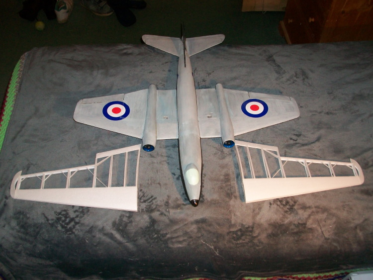

22 Feb 2020 20:09 - 22 Feb 2020 20:10 #119 by Quorneng
Today's building.
Still got the Depron leading edge to add and sand to shape.
The RH wing weighs 10.6 g, the LH one 10.8. :ohmy: but not really bothered by the difference at this stage.
I will weight the Canberra accurately and then take off one wing and reweigh it so it can be compared to a new wing when it is complete. It will take some resolve to destroy the old but perfectly flyable wings. :(

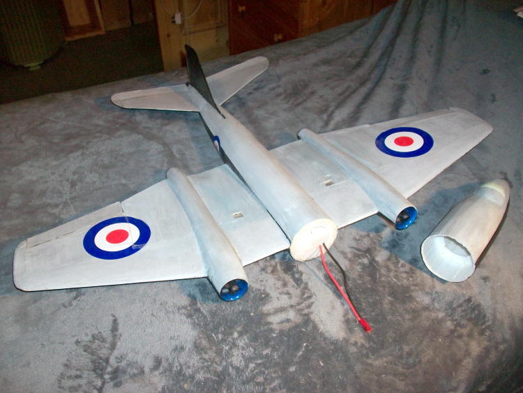

23 Feb 2020 23:35 - 23 Feb 2020 23:36 #120 by Quorneng
Started work on the new B57D nose.
First operation was to cut off the old one.
It weighs 17.4 g so that's the target to beat with the new one. :P
Last edit: 23 Feb 2020 23:36 by Quorneng.
