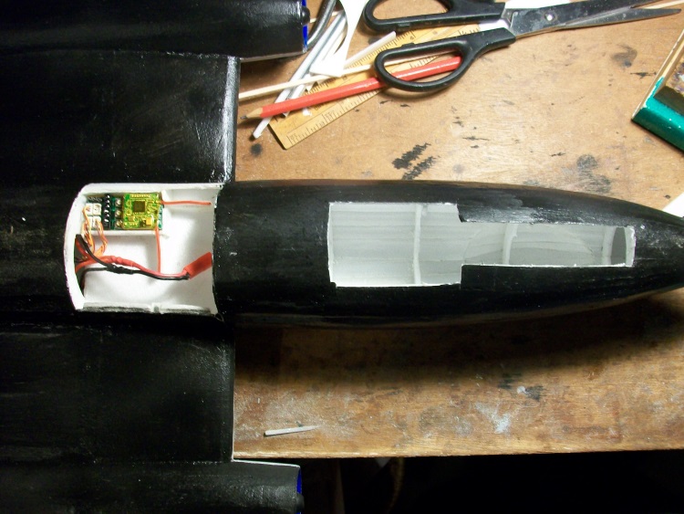

03 Feb 2015 19:03 - 03 Feb 2015 19:03 #79 by Quorneng
Flew the Canberra again today with the reduced tail incidence, battery full forward and 0.3oz of nose weight.
Much better but still tending to tail heavy making it very sensitive on the elevator.
Note the radius of the loop and it was still not with full 'up'. :woohoo:
The battery needs to go further forward some more but this time with a new hatch in the nose.
A bit of rather drastic surgery to remove the old battery 'tube'.
One advantage is the old hatch can be sheeted over which will restore the full fuselage strength at a critical point although a small hatch might still be left over the radio just in case it has to be 'rebound' at some point.
Worth noting that I was quite happy to completely 'build in' a 35meh crystal rx - they never needed touching.

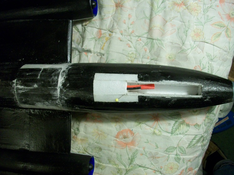

07 Feb 2015 01:21 - 07 Feb 2015 01:22 #80 by Quorneng
With the ESC lead extended the fuselage skin can be replaced leaving just a thin aperture for the battery.
The battery hatch will be front hinged so even if it opens in flight it will not be a problem on landing.
A small hatch has been left over the radio.

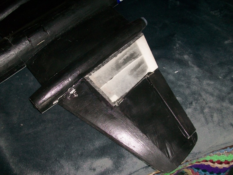

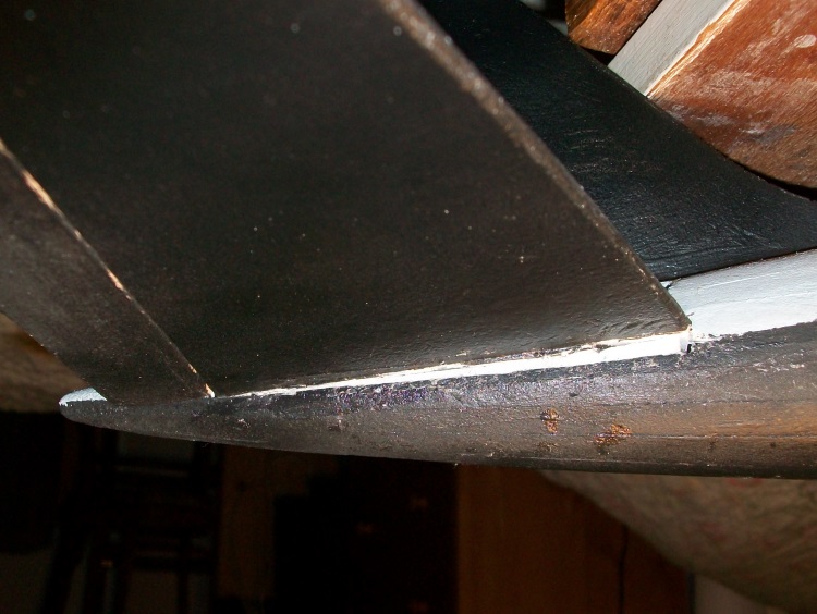

I will resurrect this thread (the build started in 2014!) to cover the repairs to the Canberra.
On the 21 March 2019 in looked like this.
Today, 20 Mar 2019 repairs have got this far.
The nose is almost fully put back together, the crumpled bit of Depron have been simply glued back in place. Just a few bits of missing skin are need.
The wing is structurally repaired so just needs tissue 'patches' top and bottom.
Some painting to cover the repairs will give it an appropriate "well used" look. :P

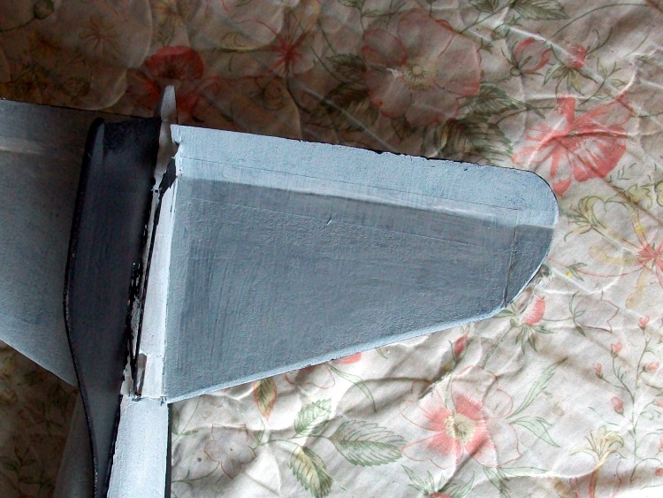

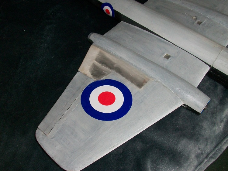

02 Apr 2019 09:28 #90 by Quorneng
Sorry Phil.
To be honest after the crash which seemed to be control related I was not sure it would be worth repairing so it went in "Been flying" however, all the electrics seems to be sound so the repairs have been added to the original build thread.
The tissue paper goes on.
Being water based Easy Dope is safe to use with Depron.
Nearly there.:P
On another forum there was a discussion on the problems of making a practical outdoor RC plane under the 250 g 'registration' weight limit in the USA. With its 850 mAh 2s battery the Canberra weighs 247 g. ;)
