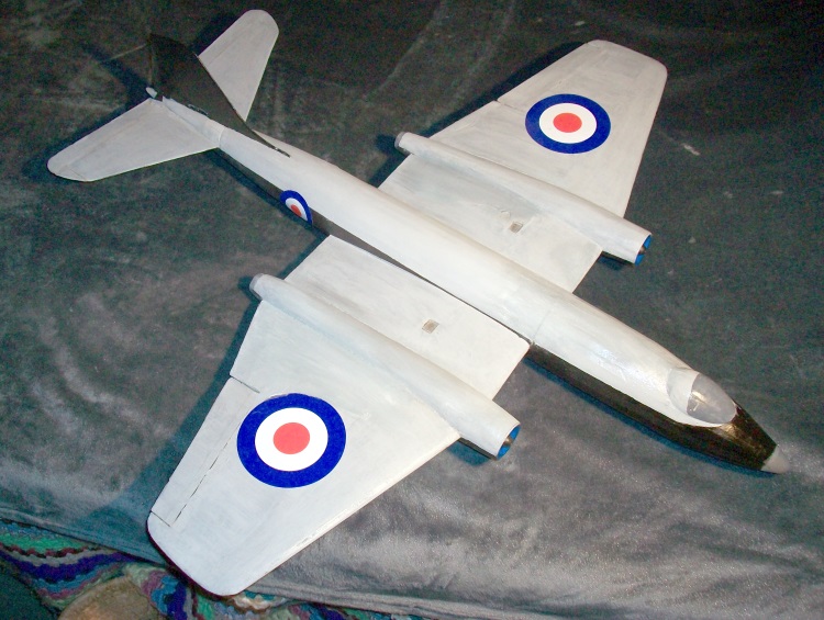

All finished!
I don't think it has added too much weight as it still under 250 g, just, including its 850 mAh 2s! :P

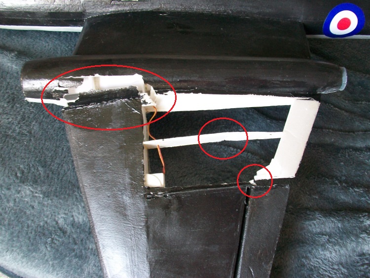

The damage resulting from an uncontrolled "cartwheel" on the 3 July 2019.
The nose is pretty well mashed up.
Of more concern is the RH wing panel has pulled out from the front of the nacelle, taking some of it with it, and creating a 'compression' failure on the trailing edge. A bit more obvious once the tissue has been cut away
I suspect this will largely be a "glue and push back in place" type of repair rather than "build much new".
The nose is a different matter as there is really nothing left to work with! It will be simpler to just cut back to sound and build a complete new nose section.
Oh! well. C'est la vie.

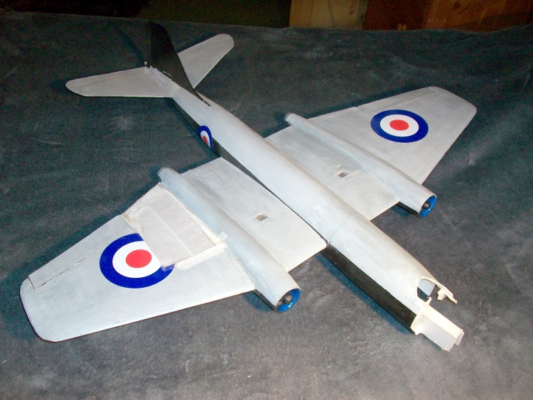

The wing is structurally repaired and tissue covered.
The crumpled bits of the nose have been cut away.
I should be able to salvage the battery box and use it to support some of the new fuselage formers
The acid test will be its weight when it is repaired as it was, just, a sub 250 g plane. ;)

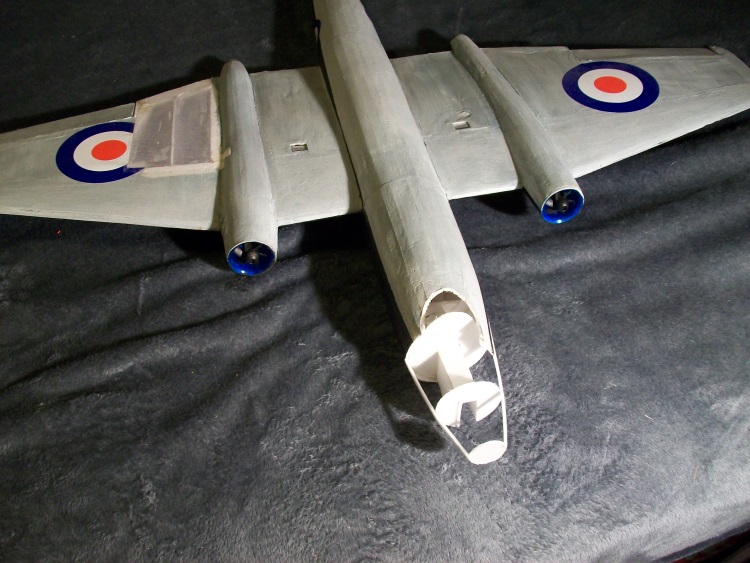

With repairs to the Endurance and flying planes has meant progress has been rather slow but the 'bones' of the nose are done.
Just some delicate planking required now.
The wing/nacelle repair is complete and the tissue doped ready for painting when the nose is complete..

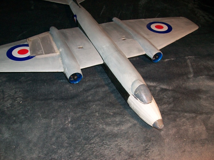

The nose skin complete along with the 'salvaged' canopy and nose cone.
Filling and sanding next.
