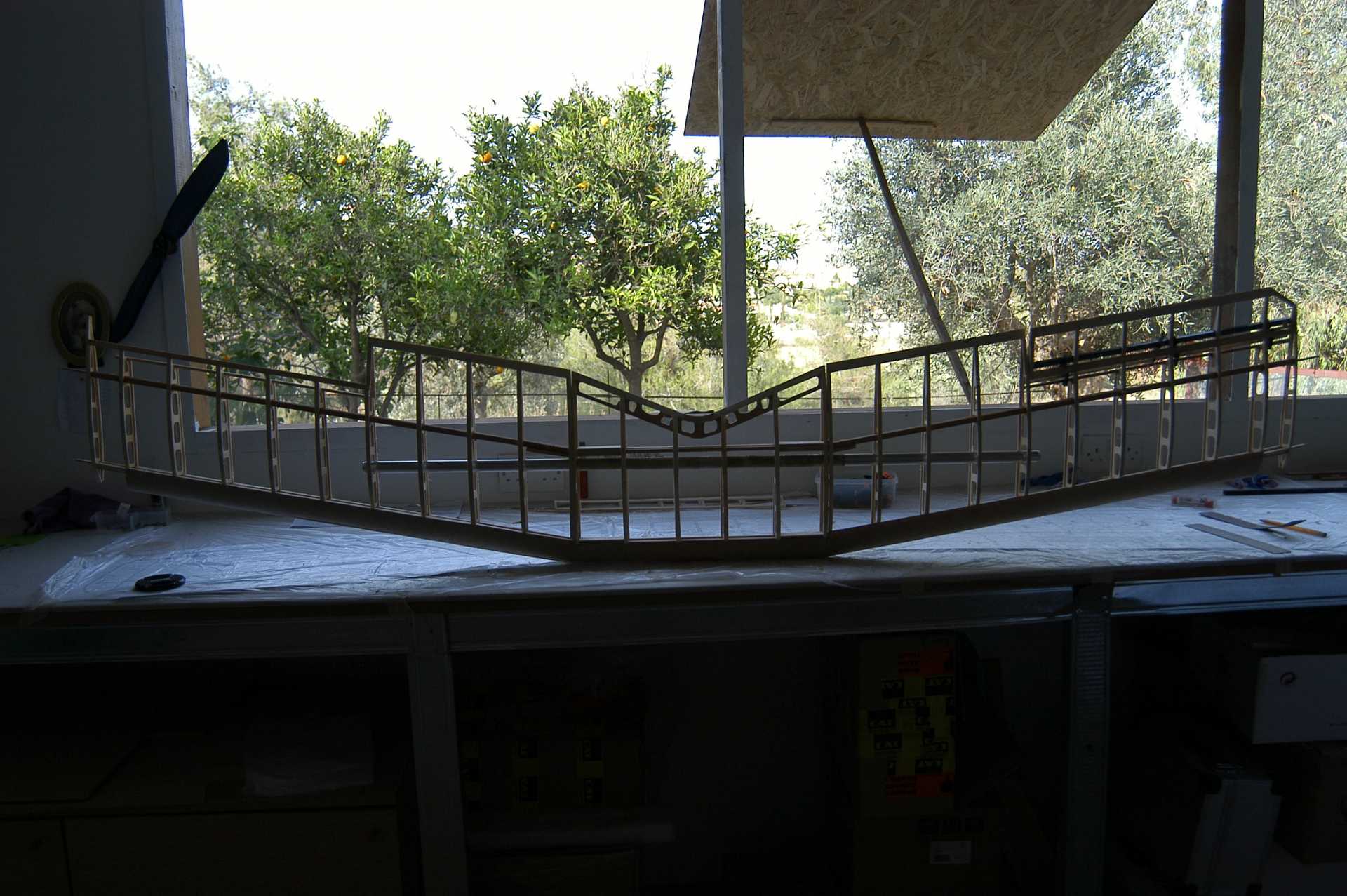

10 May 2016 20:04 #33 by THE BLACKBIRD
Got a bit of time on it today between other jobs so started on the top centre panel, cut the ply ribs and trailing edge
And got some of it glued together

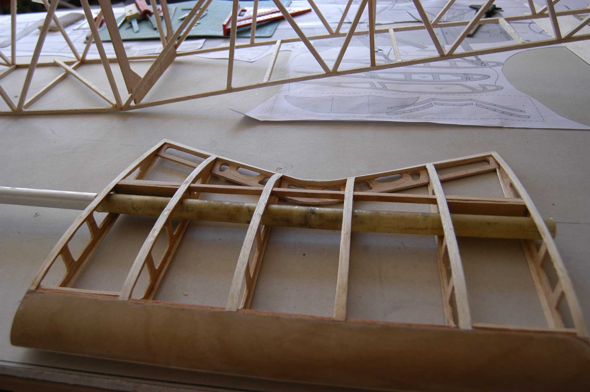

14 May 2016 19:26 #44 by THE BLACKBIRD
Done a little more, with the order from slec I had a wing tube in it so with that order cancelled I went through my crashed box and found some fibre glass tube took it to the local DIY store and found some ally tube exact size
The wing on the plan are held only by the rigging, but I thought it must be a struggle to put it together without something to hold one set of wings on, so installed the tube in the top wing
Thanks: Phil Wood, Klipkopwildlife, Quorneng, boz, Skydanz
14 May 2016 20:33 #45 by Skydanz
Outstanding work. Gonna be a beauty.
Just curious why you didn't install an outer spar tube in the outer wings? Seems it would make it a bit easier to slide the wing on. The latest idea I've heard for holding wings together is using magnets. Since there is very little pressure to separate the wings, especially with the flying wires attached, magnets would be all that's needed. ;-)
