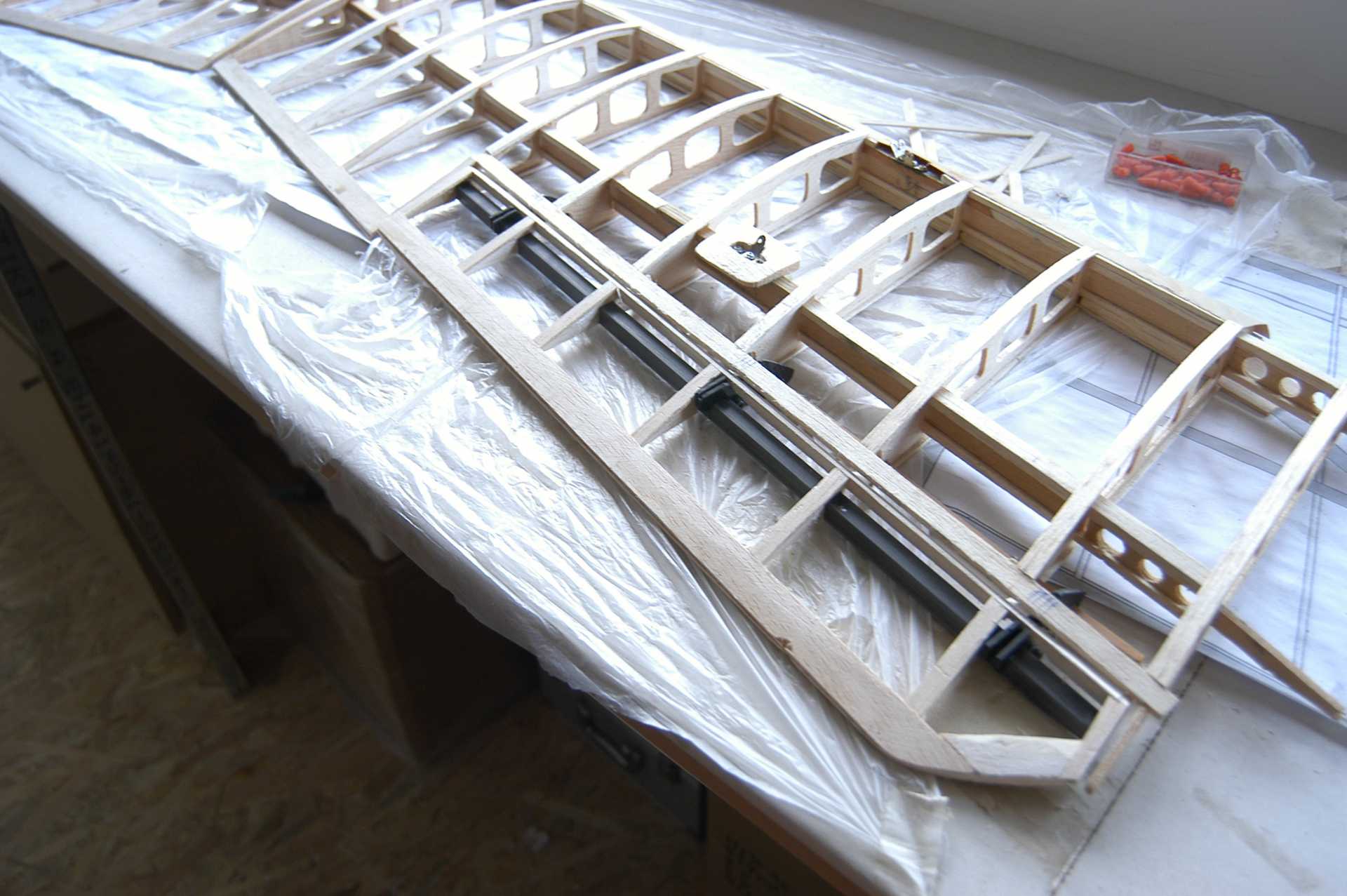

Hi Skydance the reason is that I don't have any more of the outer tube :S and you can get nothing here in Cyprus
So I had to make a good job of the ply that holds the ally tube in the wings, go's in easy once the second rib hole is found
The problem as I see it holding the wings on is not the coming off , but holding them in place while assembling the model at the field, without six hands ;)

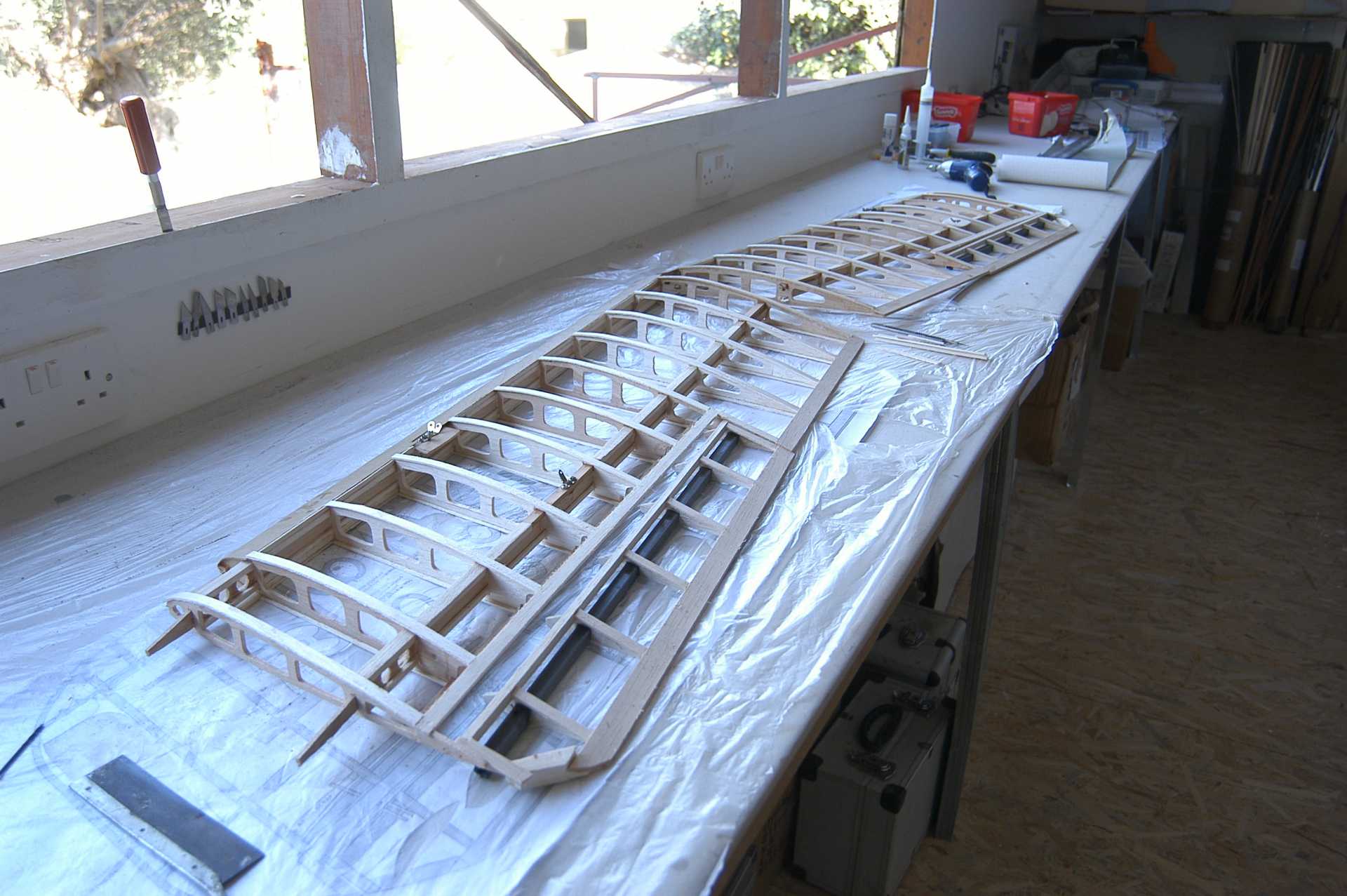

28 May 2016 10:49 #48 by THE BLACKBIRD
Not getting on very quickly with this one, the top wing is almost complete, got to get some SS tube for the wing tips
And I have got this far on the bottom wing, just the one picture thanks to Microsoft and their windows 10 :angry: :evil:

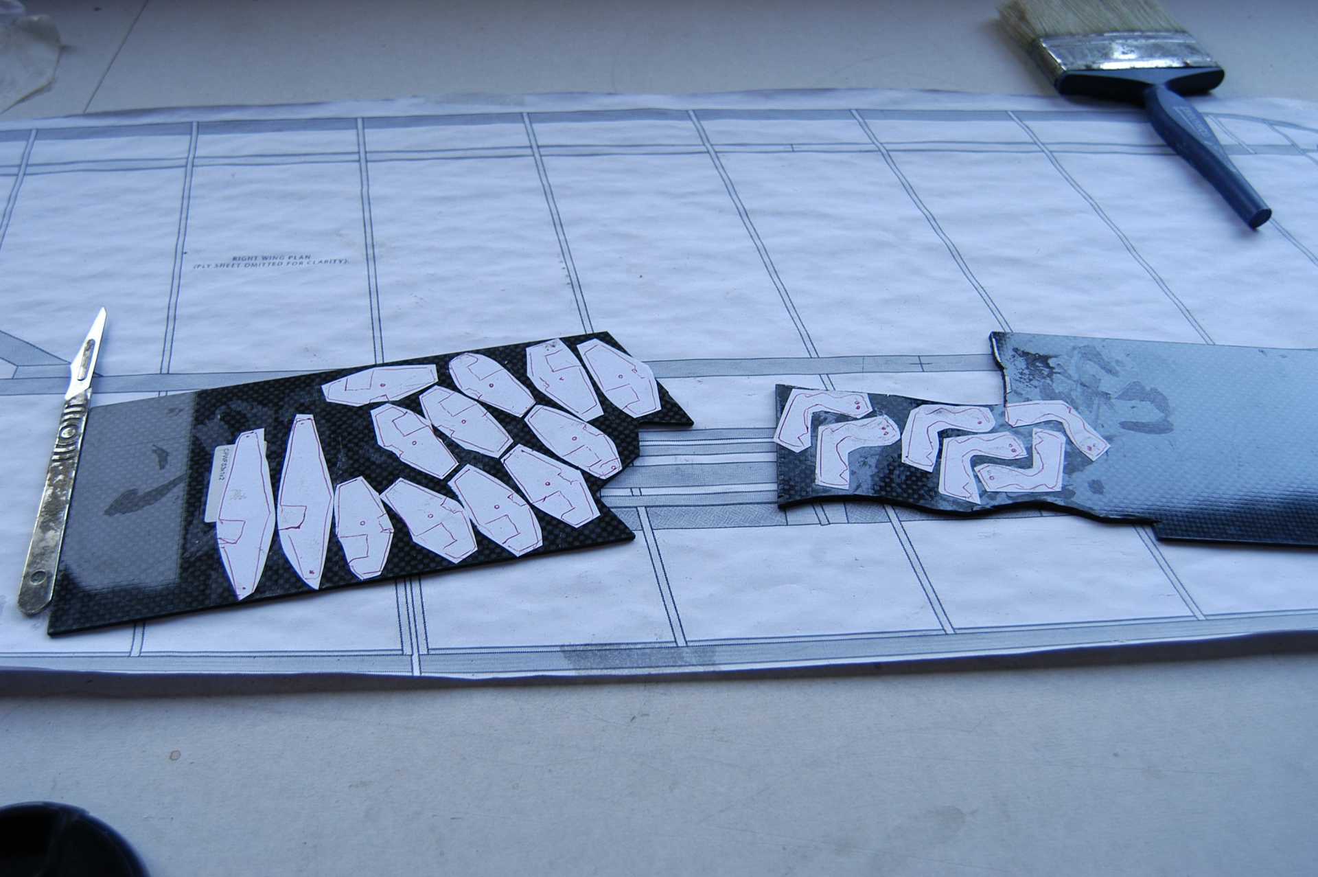

All I have done to it in the last few days is draw up the hinges for the ailerons and stick them to some carbon fibre sheet read for cutting,

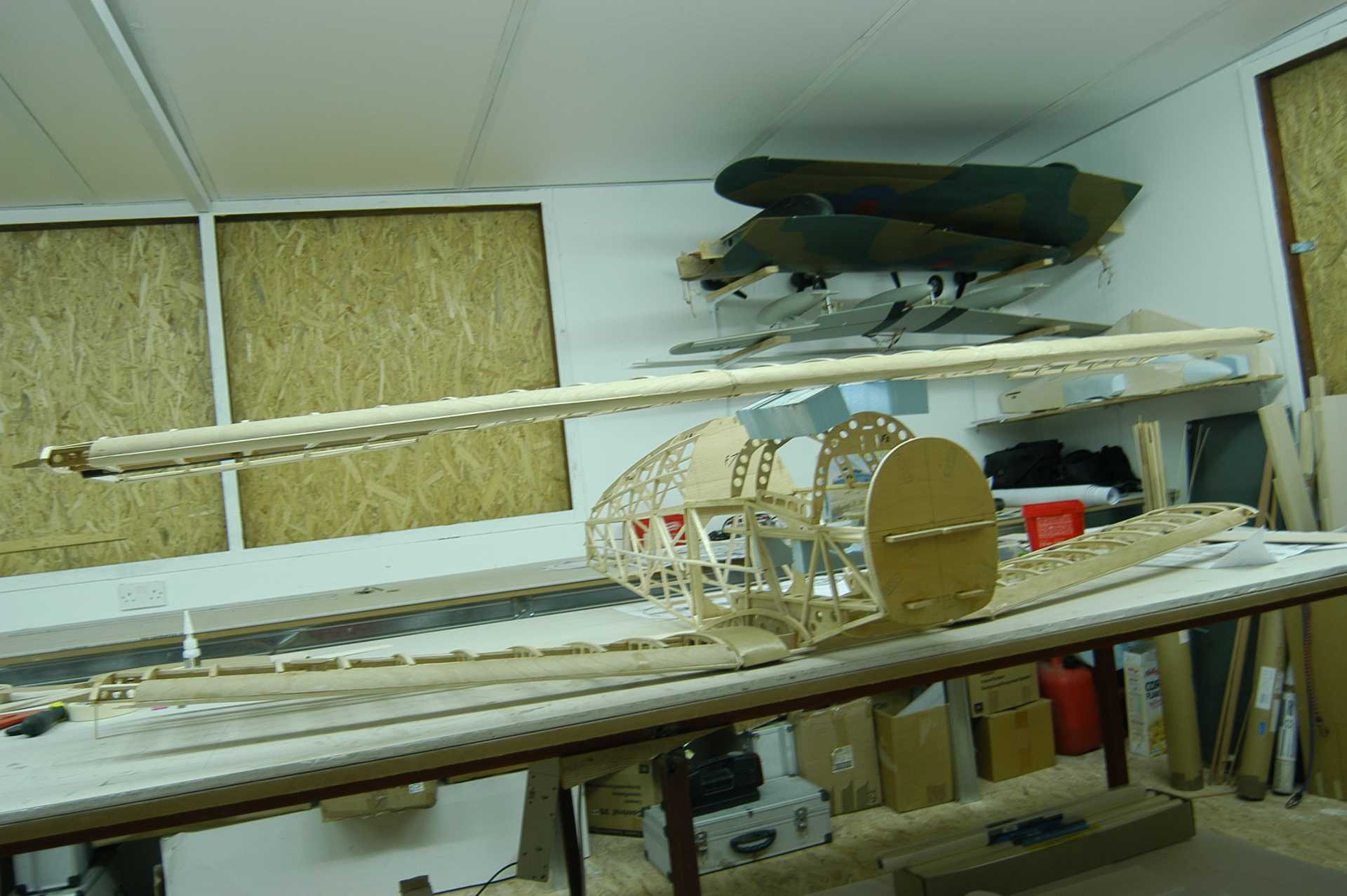

04 Jun 2016 03:51 #52 by THE BLACKBIRD
Got all the carbon parts for the aileron hinges cut out and the ailerons finally fitted
Nasty stuff that carbon dust :S I don't want to be cutting much more of it to be honest

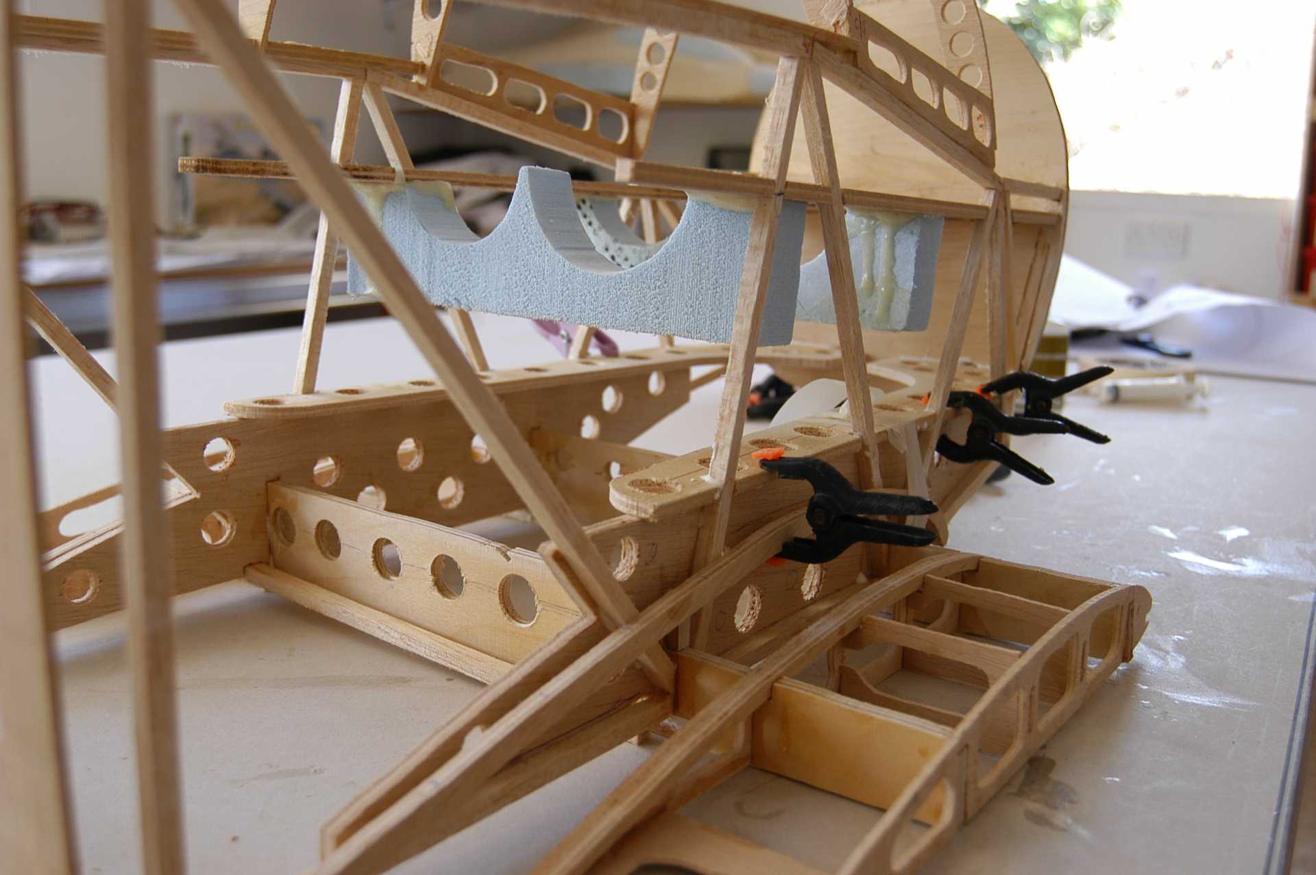

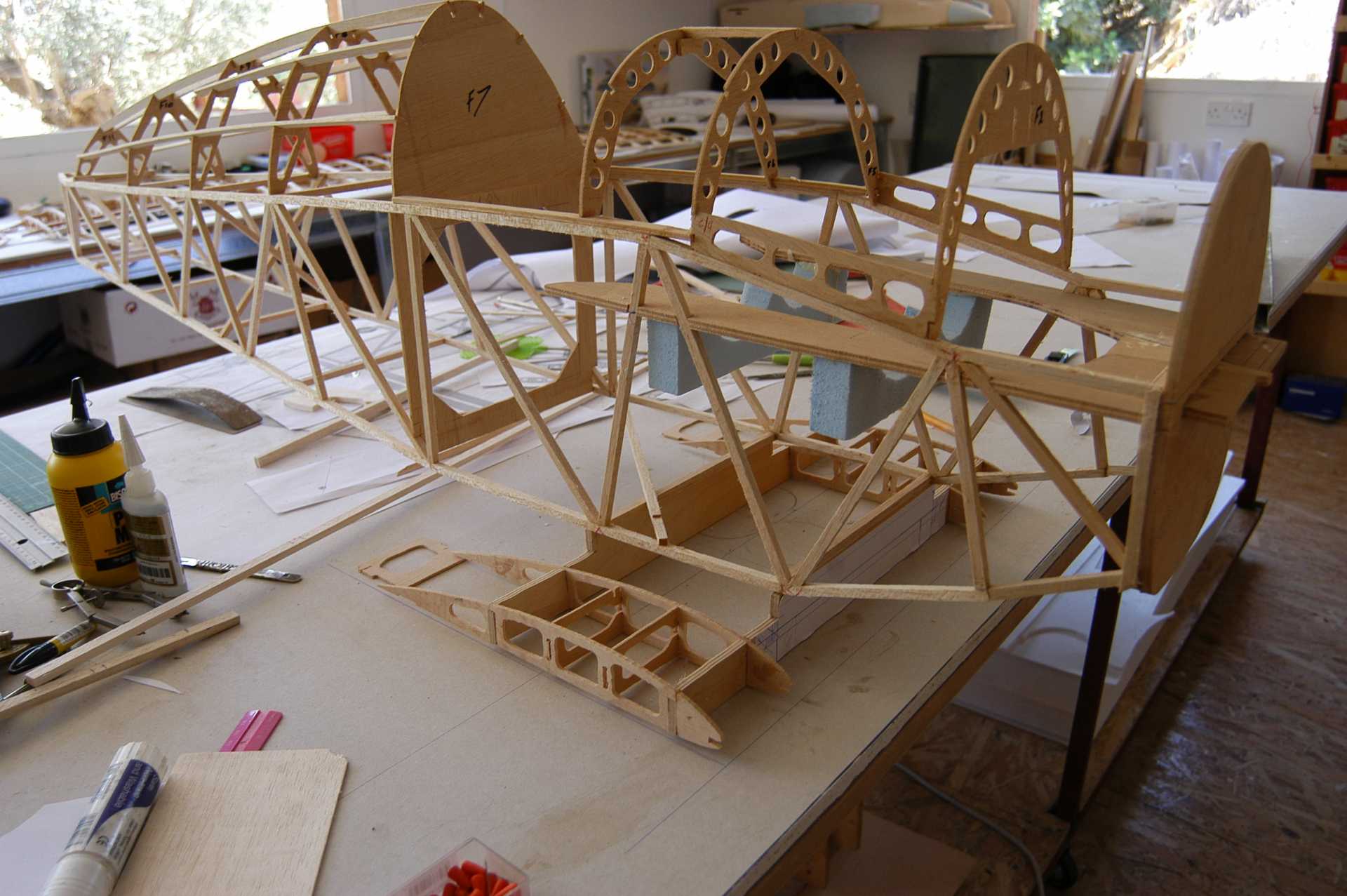

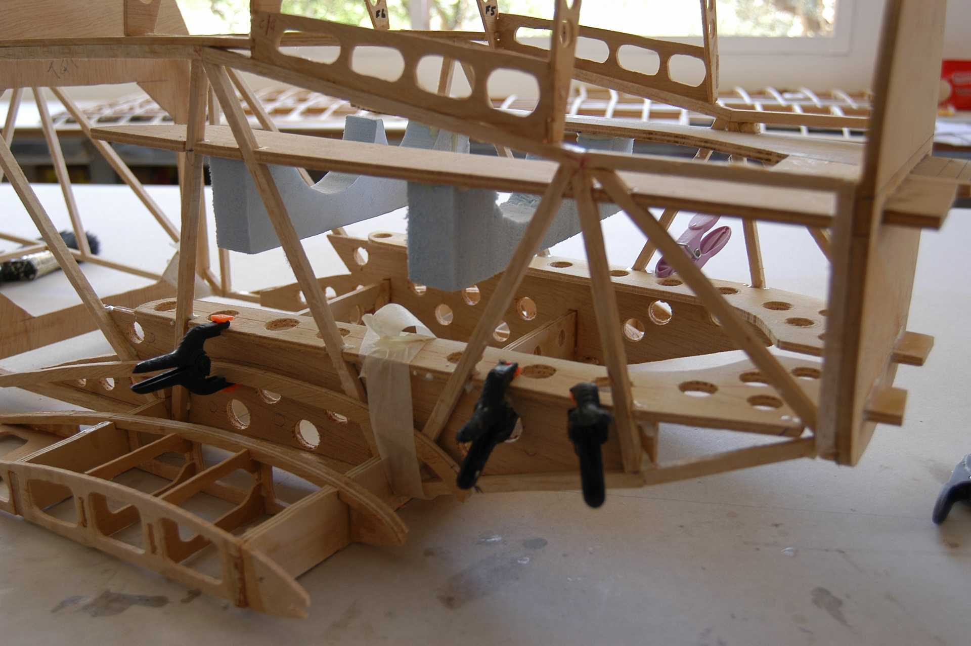

07 Jun 2016 20:23 #53 by THE BLACKBIRD
Got some time on the Bucker and I started to enjoy it again

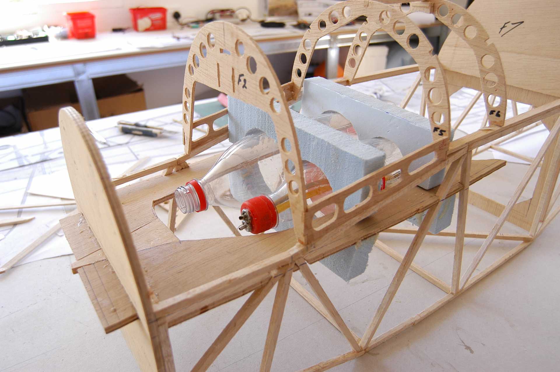

A trial fit of the fuel and smoke tanks

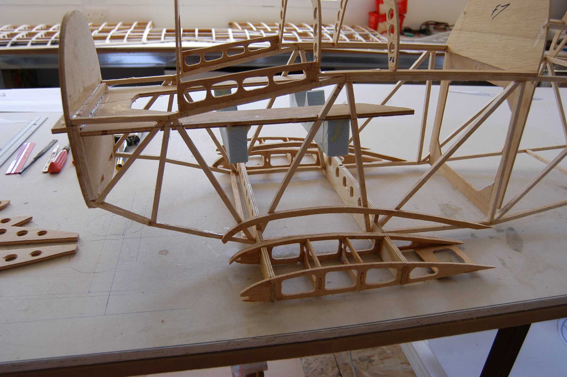

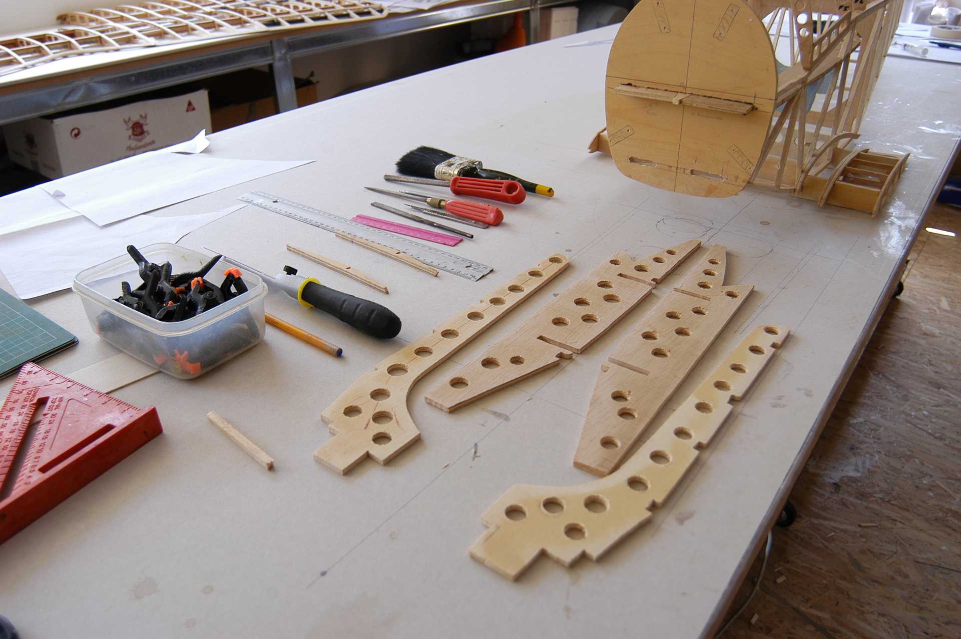

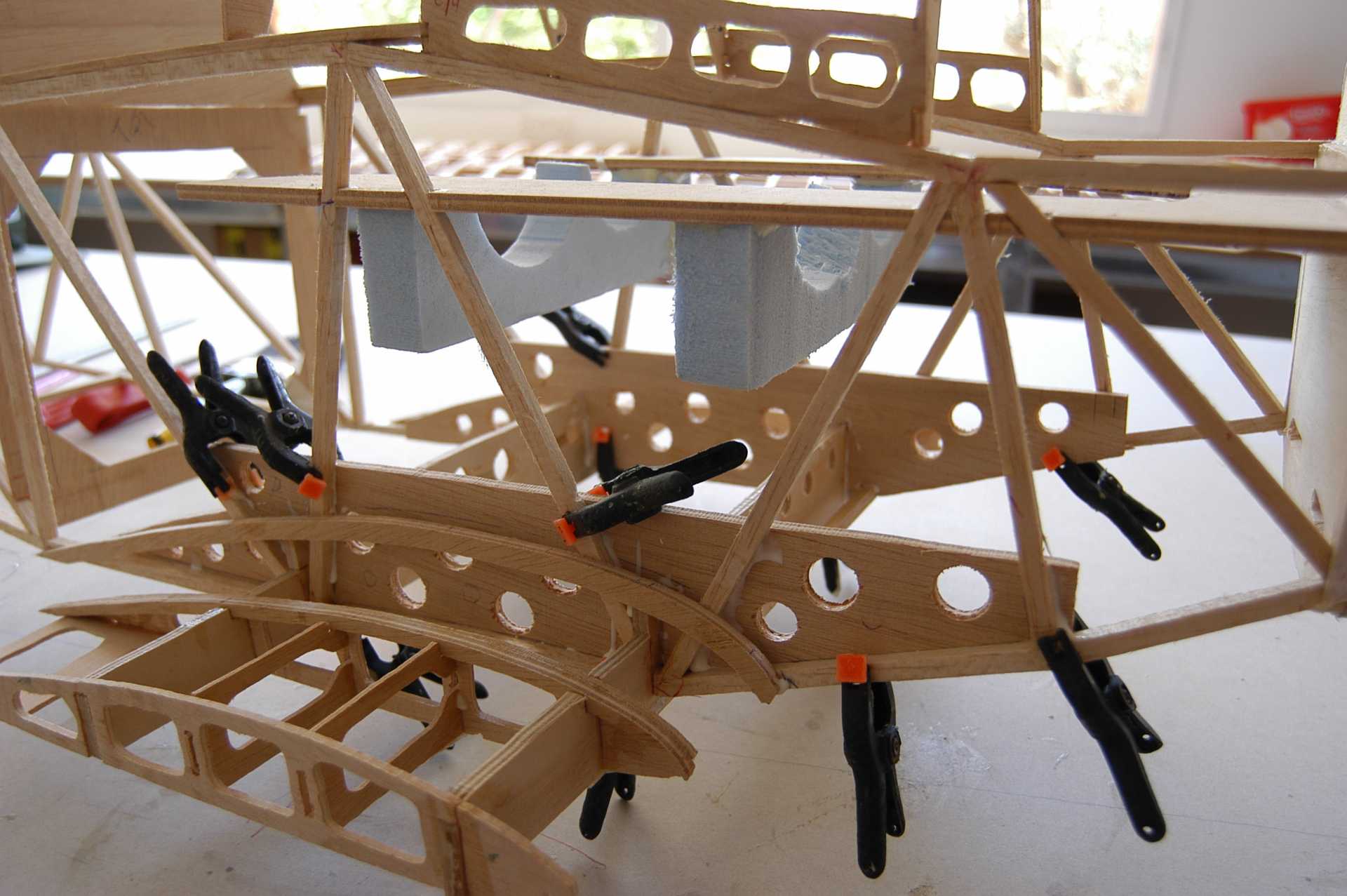

Then I had to start thinking about how to do the wing centre section as I want to build it into the fuselage and also tie the fire wall into it and the undercarriage will anchor to it as well, so I had to draw up the main spars and cut from hard 6mm ply
Drew and cut the ribs and other bits, here dry fit together
Placed them on the model and marked where to saw
The whole unit glued in plce
Then drew up and cut the parts to anchor it to the sides and fire wall

07 Jun 2016 20:31 #55 by THE BLACKBIRD

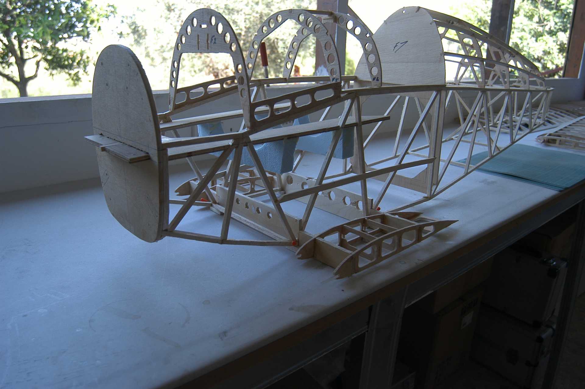

Start to fit them

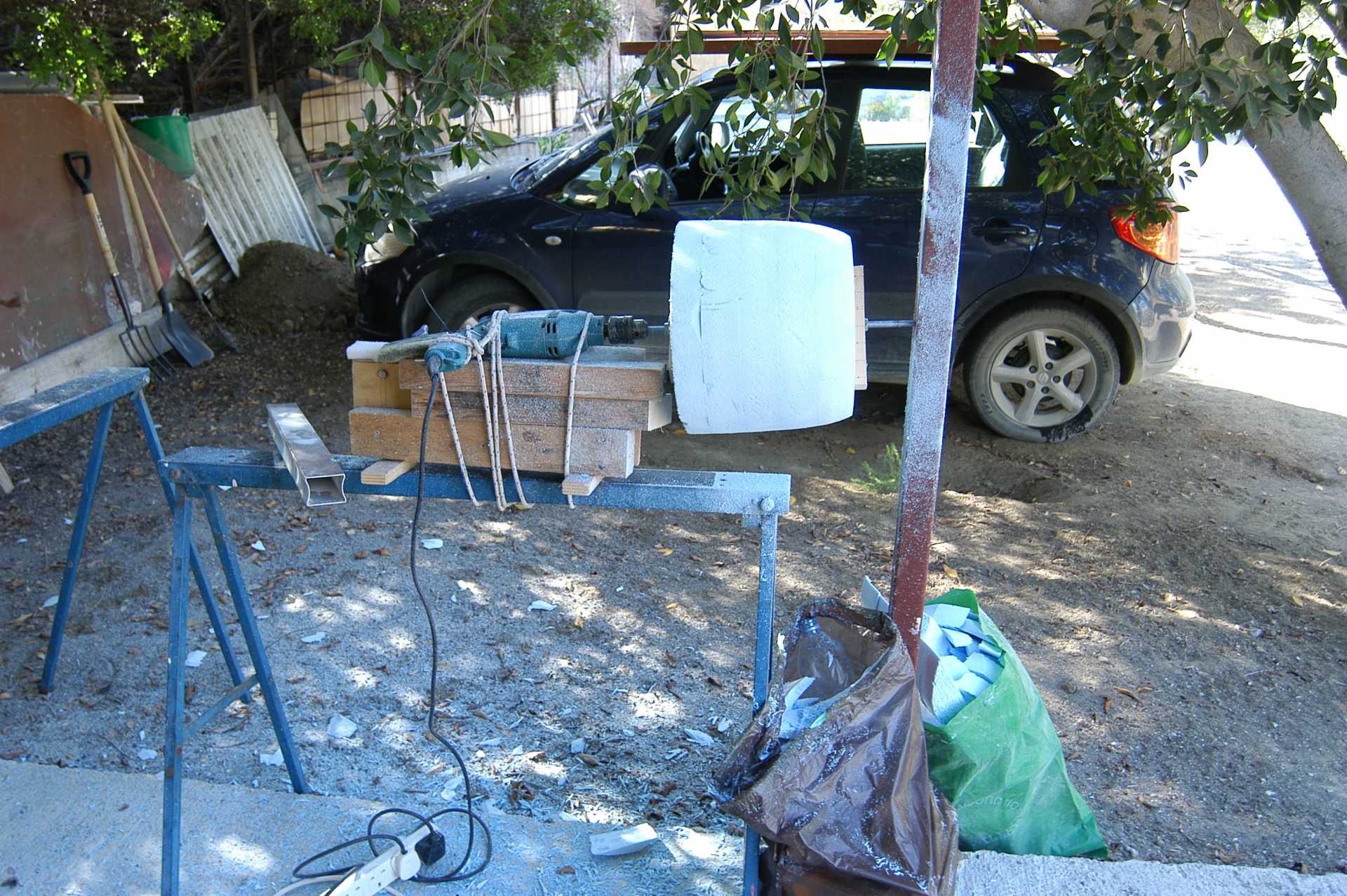

09 Jun 2016 21:01 #56 by THE BLACKBIRD

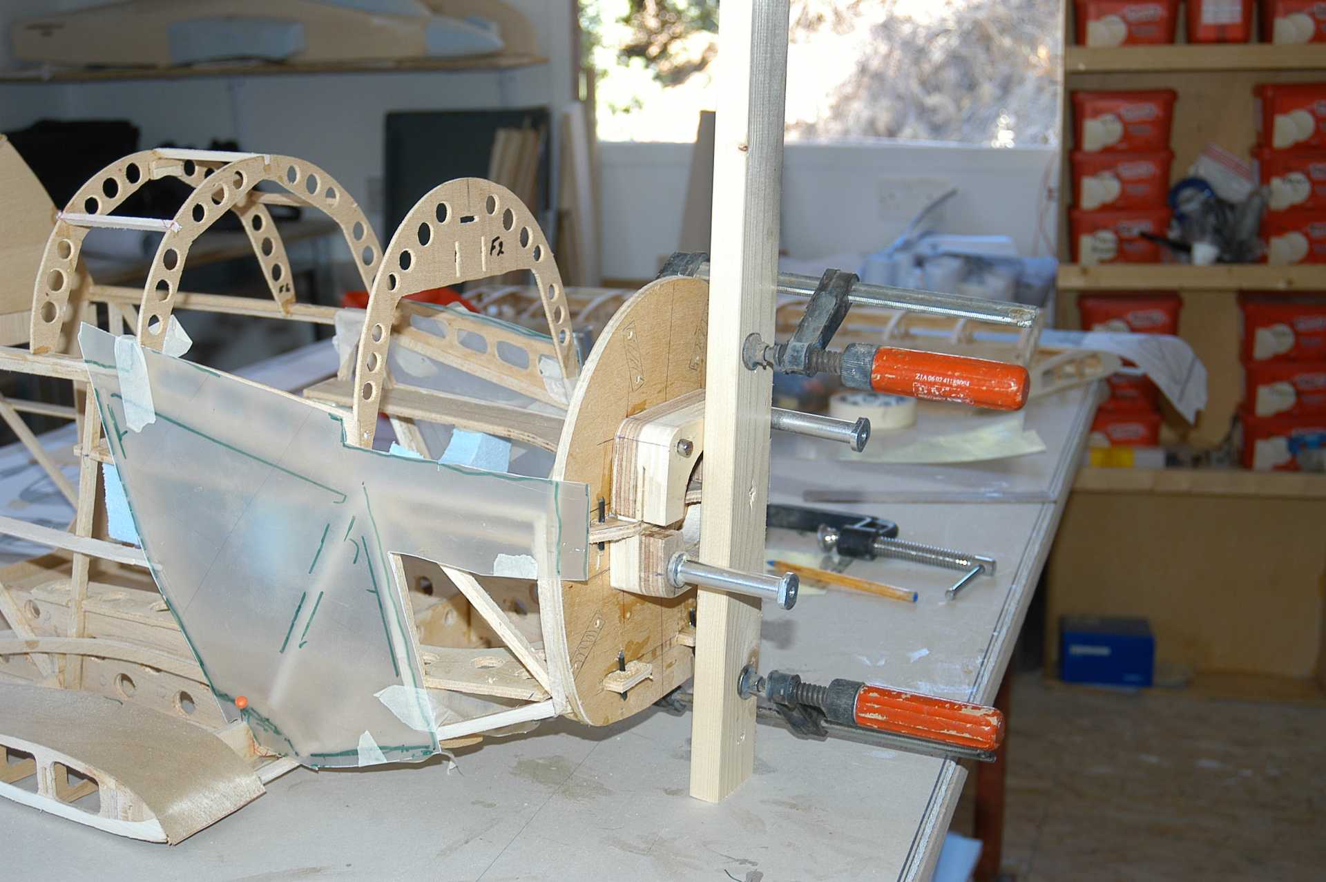

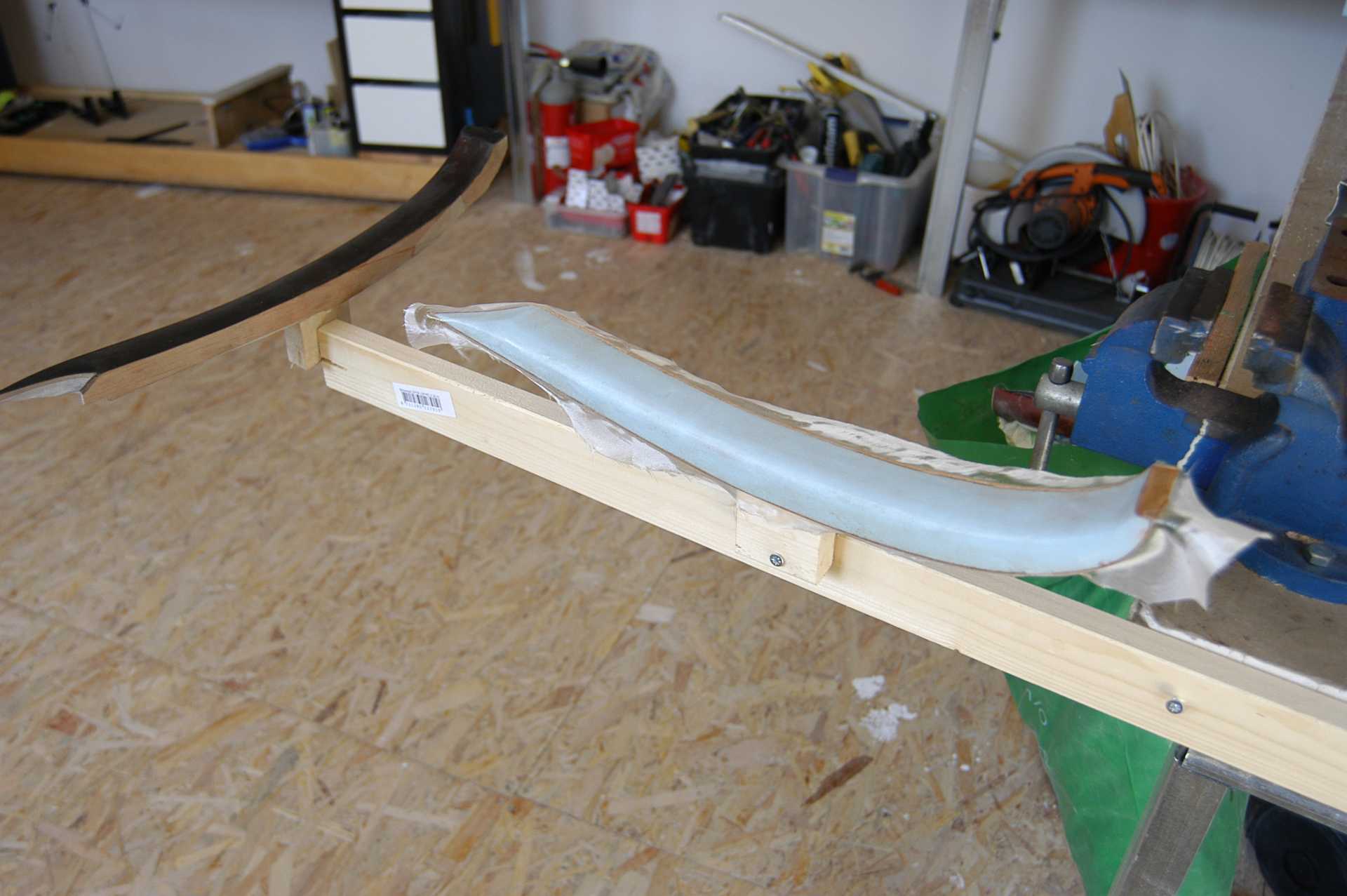

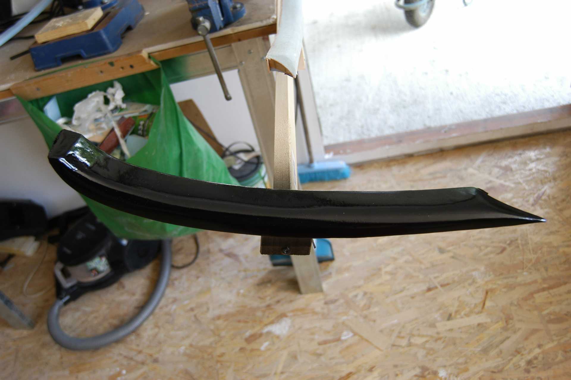

On this model it has fairings between the lower wing and fuselage, so I decided to do them in fibre glass
Made a plug from blue foam then glassed it
Then sanded it down gave it a coat of paint and sanded it again then filled any holes
More sanding and filling and sanding, then three coats of paint
Tomorrow I will flatten it down and the polish it before giving it a coat of mould release
The one for the other side is a few stages behind
Offered it up to see what it looks like

13 Jun 2016 19:08 #57 by THE BLACKBIRD
Got my DLE 55 rebuilt and with a new expensive wrap around silencer, it runs good again
Proving to be a costly engine, $250 to buy, 95 euros to repair after the first crash and 175 euros this time, it destroyed the silencer last time it hit the ground and this one was 140 euros but its so much better to fit in the cowl

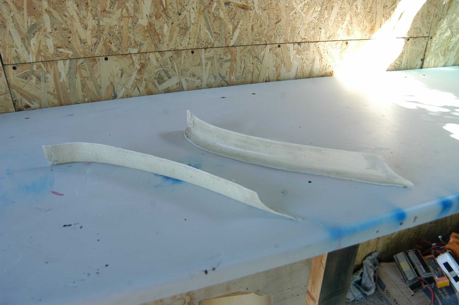

Glassed the fairings
And they came out ok
So I built up a block to mount the engine
Built a 20" lathe to turn the blue foam cowl plug
And it worked :ohmy: started to fill and sand it
