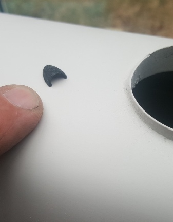

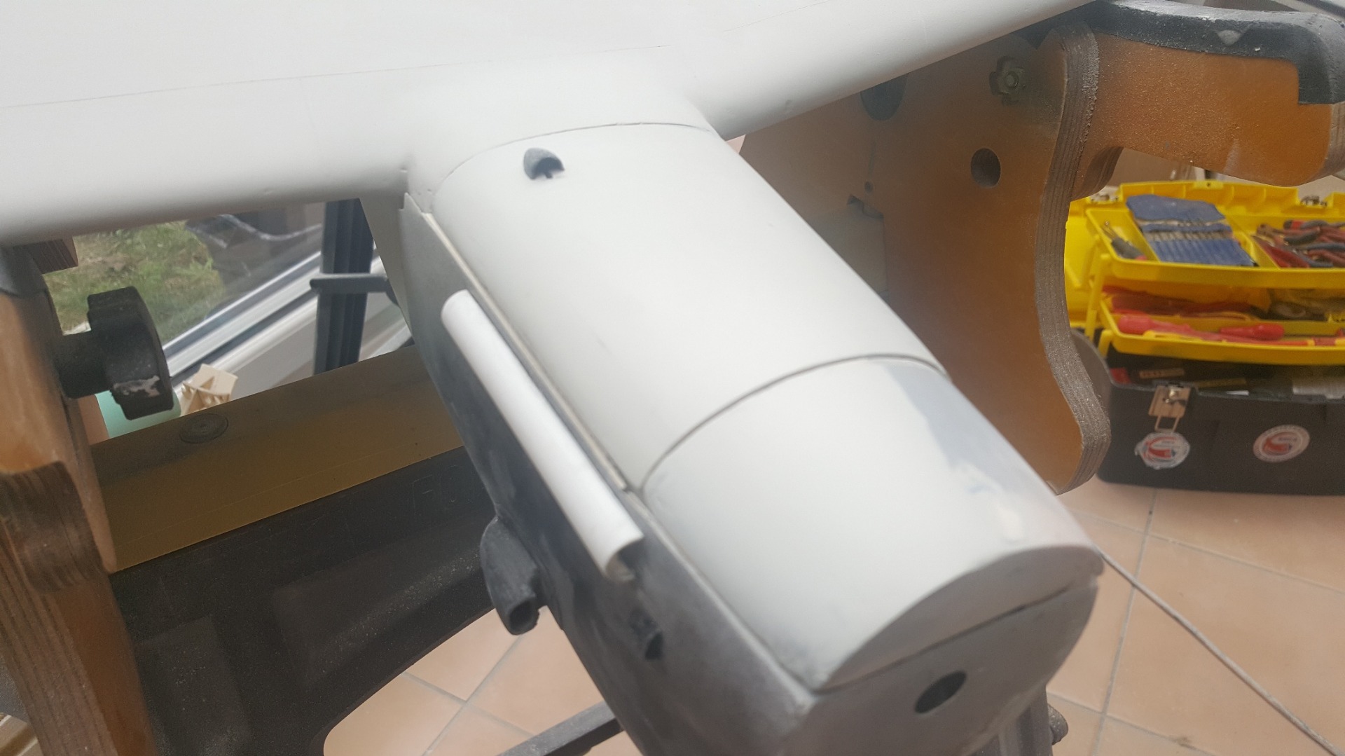

A bit more done on the Lanc. Designed some air inlets and printed them. These are for the oil cooler on top of each nacelle. They are also on the engine cowling. So glued them on. To secure the battery cover I used the air inlet as a handle to slide the locking pin to secure the battery cover in place. Works well. No springs as im relying on the prop wash to keep it back in place.
Little bit of filling to do before paint but looks ok.
Slide the air inlet forwards and Lock open
slide the air inlet back and lock closed

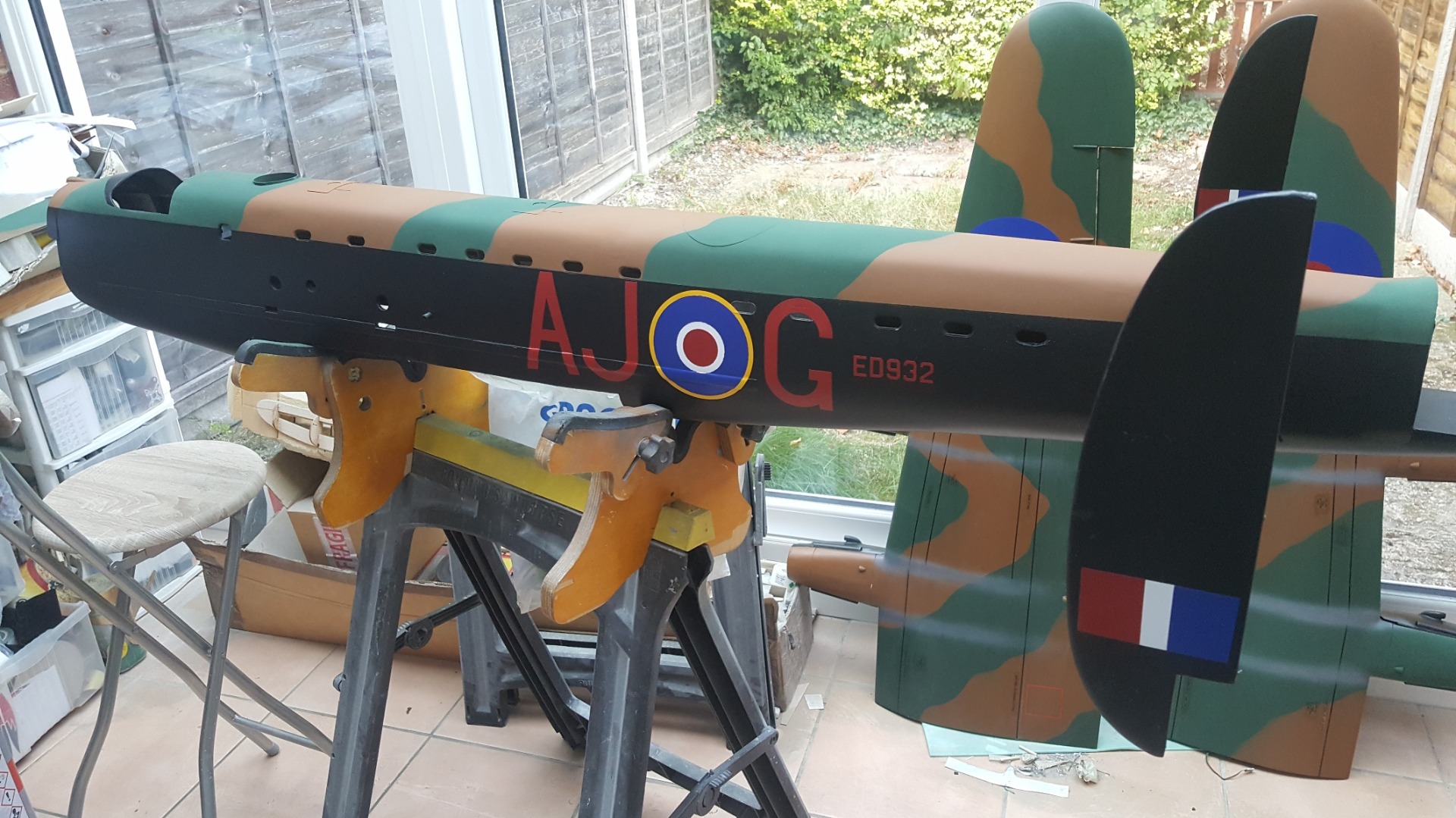

Spent the last 4 weeks getting the paint on. Had a reaction to some filler i used so had the dig that out, refill, sand and prime. Painted it last weekend and left it until today to harden off. Not too bad. A few marks to touch up. So put the vinyl decals on that I cut using my Silhouette Cameo cutter. First time I've tried this. Had a bit of fun adding some weathering with the airbrush. Just got to put a coat of clear satin varnish over the whole thing then I can start fitting it out.
