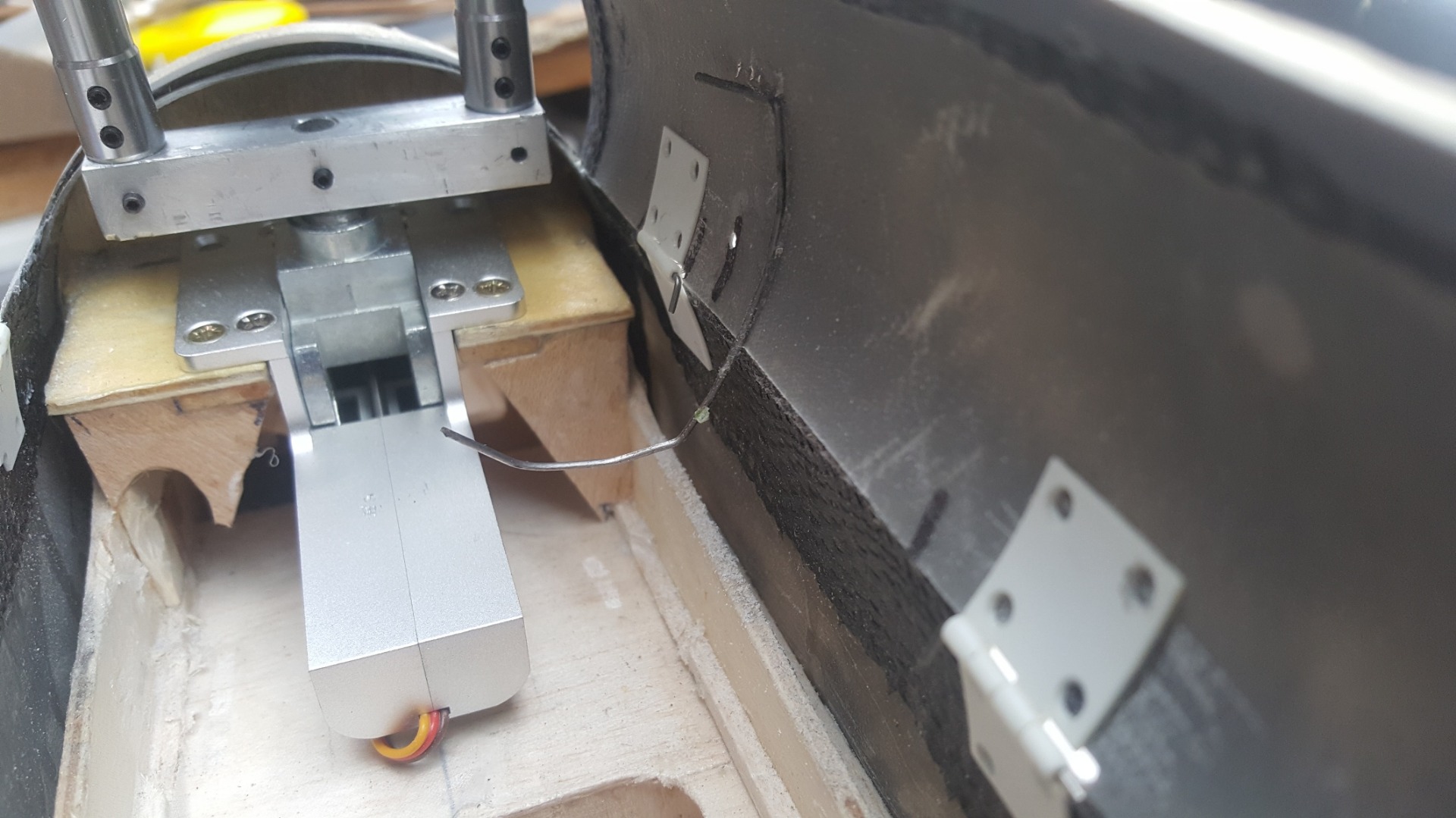

Set up the gear door hinges and tried out the gear door mechanism. It kinda worked but very fiddly. So not a long term reliable solution. Going to scrap it and use the oleos to open the doors against a spring which is pulling them closed.

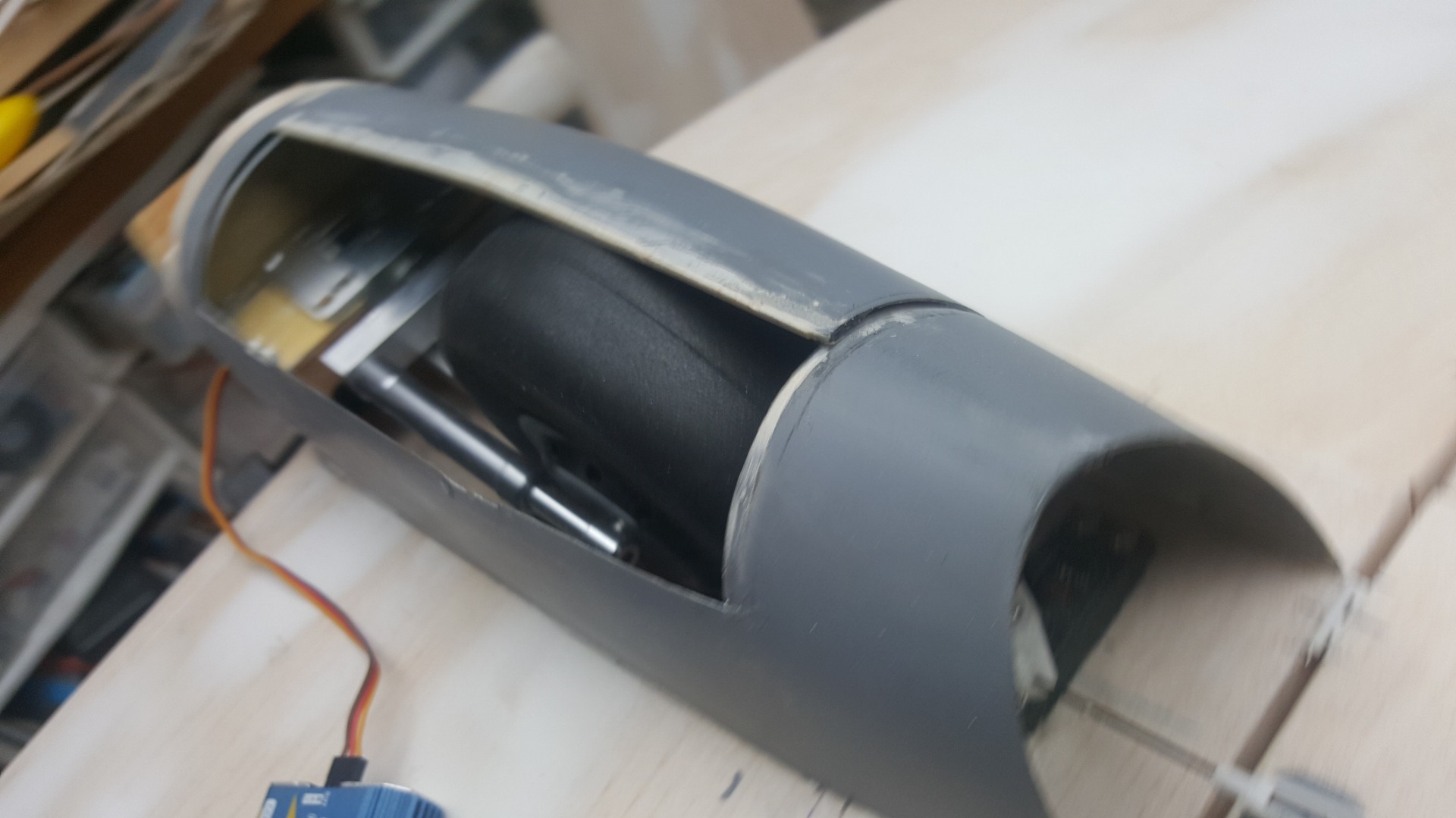

Did away with the door crank system and research other methods. Decided to 'KISS' and went for a sprung piece of piano wire that is attached to the door and gets pulled by the oleo when it retracts. One wire on each door. The doors are sprung open so the wire has to overcome the spring tension. A bit of a balancing act. Still got to sort that bit out.
With the door closed and the wheel stowed there is only just enough room. I might have to gently skim the door where the tyre is close. Alternatively get a smaller wheel or trim this one! Not sure how to trim the rubber. Heard of various ways, one being to put the wheel in the freezer and turn it on a lathe when it is frozen. More research required I think.
Did a few other things like hinged all the control surfaces on the wing, a bit more filling and sanding. Slowly getting there.

nice work Ralph! I wouldn't freeze your tyres, your liable to damage the rubber, think I would mount them on a dummy axle and run them on a belt sander, by applying a little brake ( finger on rim) you'll soon shave the rubber.
08 Jul 2019 08:10 #98 by Eric
Replied by Eric on topic Avro Lancaster 102" Dambuster
Be wary! If the tyres are solid, (and heavy!) you can wear them away a little
BUT
if semi-pneumatic, you will weaken and possibly rupture the side-wall!

Still playing with the doors, a bit more carbon to stiffen up the nacelles. I shall stick with the pull wire to close the doors and springs to open. The belcrank and push rod system is too complex to set up right. If its not set up right then the servo stalls or the doors don't fully close.

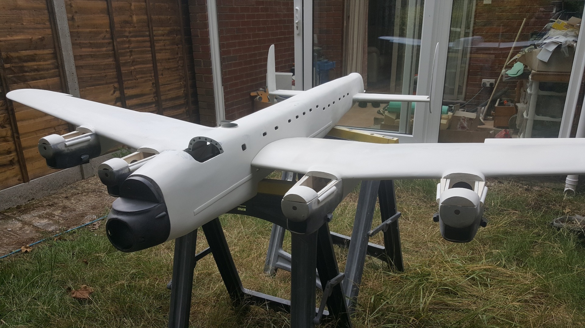

Spent the last 3 weeks sanding, filling, sanding filler (repeat 20 times). :angry: :angry: Put some primer filler on, sand, fill, sand fill, paint, sand, fill and so on. Totally fed up rubbing this thing down. Had a paint reaction with some new filler i used yesterday which required stripping all the paint off on the port inboard wing top, refilling, sealing then paint. :angry: :angry: Took all day yesterday to sort that out. Anyway, today gave it another rub down today and did a trial assembly with it in primer and yes I know the grass still needs cutting.:lol: :lol:
Then the fun bit adding the panel lines. Used 1/64th chart tape and a 3 view drawing to give measurements. Looks ok
Then a coat of primer to get the effect. I shall leave the paint to harden now for at least 48 hours then rub down the primer on the tape, peel the tape off and ready for top coat.

04 Aug 2019 16:31 #102 by crash happy
Replied by crash happy on topic Avro Lancaster 102" Dambuster
I can only find one word, stunning ! :cheer:
