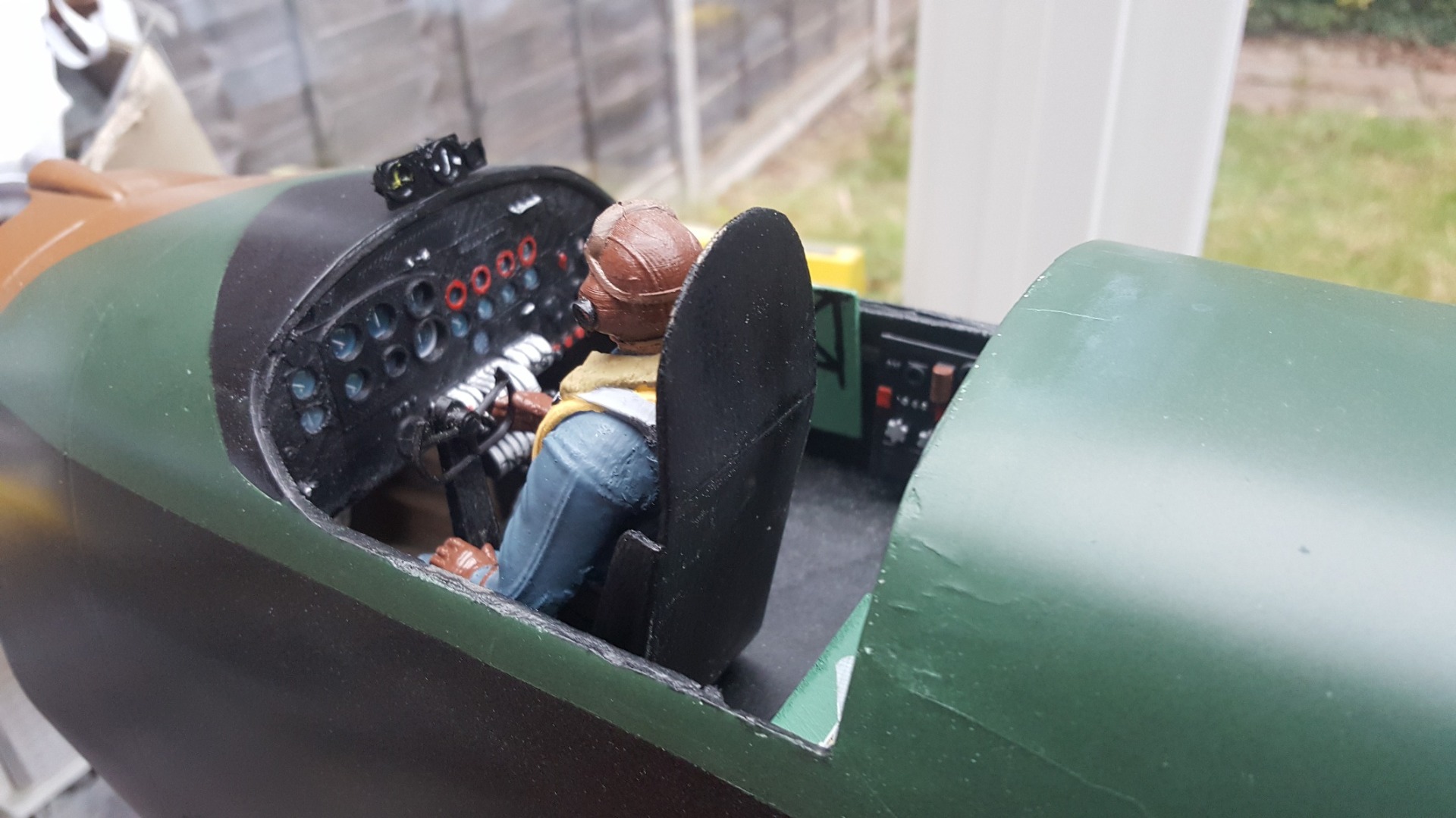

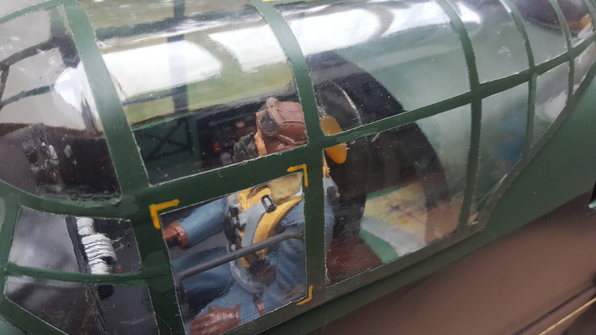

Had a bit of fun this afternoon after flying this morning. Finished off the cockpit. Managed to find a map on the internet and scaled it down printed it then sprayed it in three coats for clear lacquer. Did the same for the navigation slide rule. Stuck them onto the navigators table behind the pilot. Fitted the engineers panel and seat in the stowed position. Ready to glue the canopy on tomorrow.
