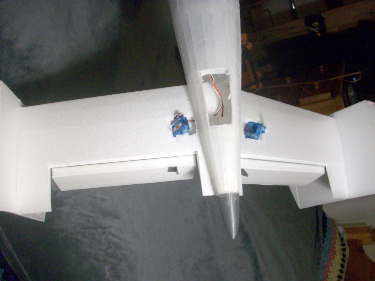

Quite a lot of fiddley work to extract the old servos, feed the new servo wires into the fuselage and solder up the Y.
Next some serious testing before the servos can be finally secured in place and the skin made good.

Just a quick up date.
The new servos work perfectly normally so the problem was not some much that it failed (had a few of those) but how it failed apparently creating instantaneous short circuits as it travelled. A new one on me.
Next is to put it all together just to make sure. Video to follow.

18 Mar 2021 18:51 - 18 Mar 2021 18:53 #140 by Quorneng
Replied by Quorneng on topic Depron Heinkel HE162
It was new servo.
Here they are working from a servo tester using the full 1350 mm length servo wire.
So far so good.
Last edit: 18 Mar 2021 18:53 by Quorneng.

19 Mar 2021 19:42 #144 by Quorneng
Very strange with hind sight you can detect the fault as on a short lead the servo does not make quite the same sound as a good one but otherwise performs normally, however on a lead of a 1000 mm the hesitation is pronounced and on the 1500 mm lead it is very pronounced whereas on a good servo the length of the lead makes no difference.
Just to make matters even worse one of the aileron servos does the same thing :woohoo: and being on a Y they both hesitate! Must have been a suspect servo batch. They were all delivered together.
I have ordered 4 more digital 3.7g versions to replace those in the ailerons. Getting the old ones out and making good will be even harder than the elevators were. :ohmy:

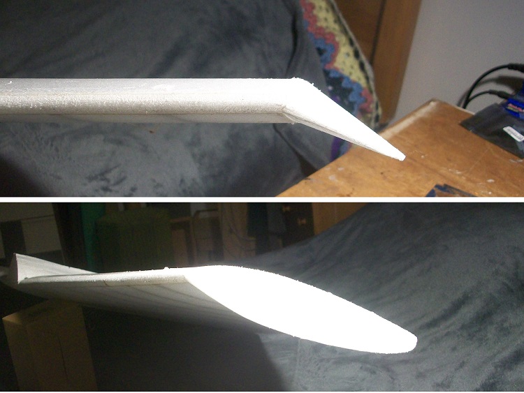

In the mean time I have added the down turned tips.
Completely hollow just top and bottom 2mm Depron skins with a single Depron shear web.
Slightly less than the scale 'down' angle just to make sure the tip will pass easily between the engine nacelle and the fuselage when sliding in the wing.
Structurally it is now complete apart from the making good required after the aileron servos are replaced. ;)

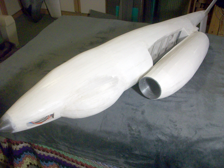

The first coat of thinned white acrylic on one side of the fuselage.
It does a pretty good job of 'hiding' the plank joints but because the paint is so thin it also seeps into any joint gaps to ensure each plank is fixed to its neighbour over the entire joint area. When dry the hard paint surface also makes it much easier to sand any joint imperfections.
I suppose I really should have weighed it before painting so I could obtain a 'before and after' painting but I am not sure I really want to know! :woohoo:

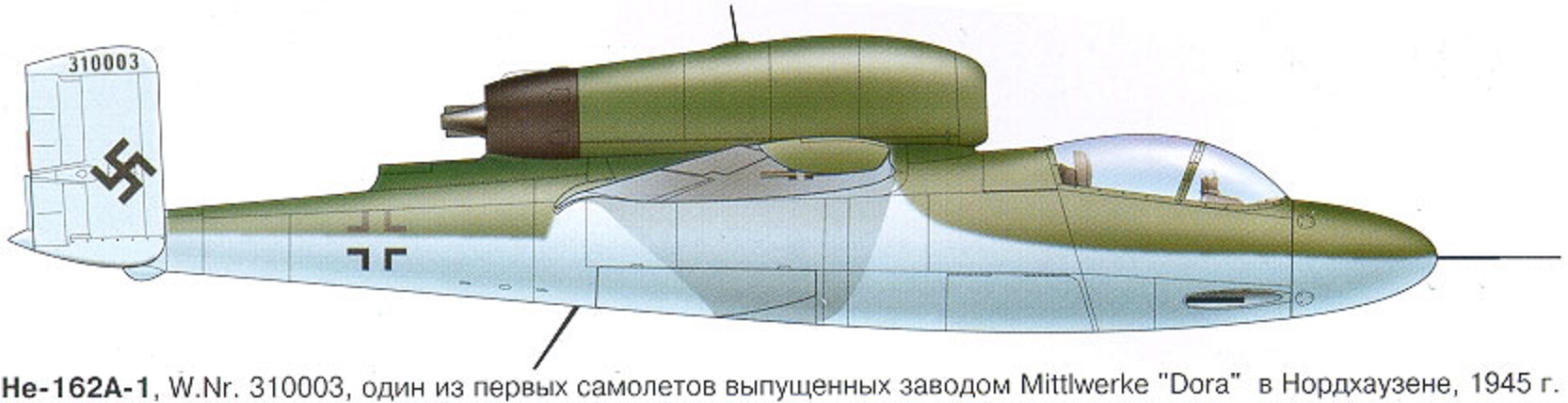

I am following this fairly early production model in the "as delivered" scheme simply because it is about the simplest I can find!
It then received received the markings of JG-1 as "Yellow 5".
I will see if it flies before going that far. ;)
