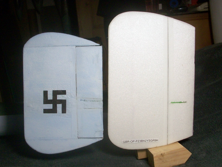

A little voice in my heads says "If it actually flew with the big over scale fins is it wise to change to the smaller ones even with rudders added?"
So big fins with rudders.
The rudder area is 40% bigger as well.
They are a direct replacement. The existing rudder mechanism and push rods will be unchanged.

A very short video of the big fins and rudders being tested.
The big rudders also have substantial travel so hopefully the 10% travel allowance of the gyro will have some authority.
