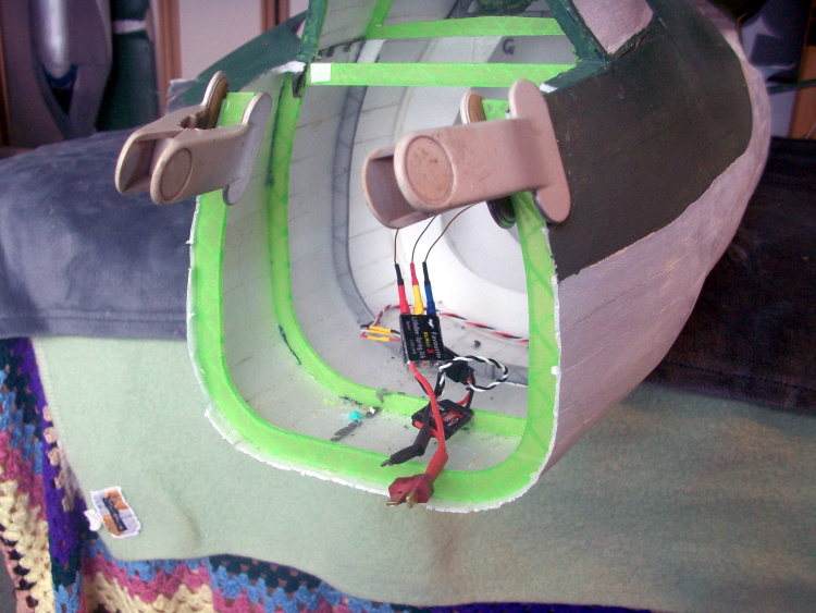

Anyway the damage was fairly severe. The impact caused the wing bolts to pull out locally disrupting the fuselage. The complete engine nacelle partially broke away from the fuselage and of course the nose was quite severely disrupted. The wing itself only had very slight RH tip damage.
Repairs underway with the damage round the wing mount and nacelle stabilised with making tape and the glue drying.
The nose back to the canopy will have to be completely rebuilt.
The nose cut back and a new former "C" added.
Note the negative wire on the Deans. It was held in pace by the shrink wrap. :woohoo:
It would appear my first suspicion was correct.

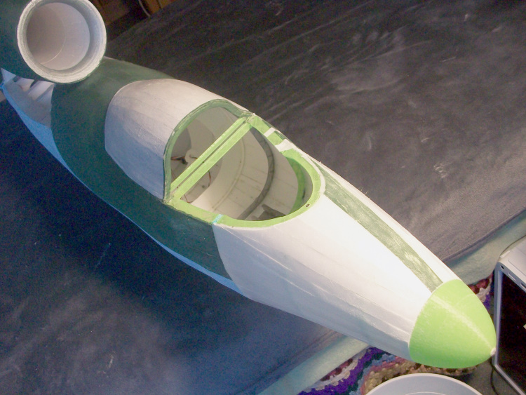

03 Jun 2022 16:07 #228 by Quorneng
Replied by Quorneng on topic Depron Heinkel HE162
A start on the new nose section.
My usual vertical planking.
Seriously wobbly to start with and using up a bit of my scarce 2 mm rear Depron. :woohoo:
05 Jun 2022 16:15 #229 by Quorneng
The nose planking complete and the new nose glued on.
Not perfect but adequate and with little or no weight gain.
The Battery Box is replaced onto the cockpit floor. The box also supports the OPTO ESC and SBEC.
The front half of the canopy surround is a slightly different shape so the "battery hatch" canopy will have to be partially rebuilt to give a good fit.
Nearly there!

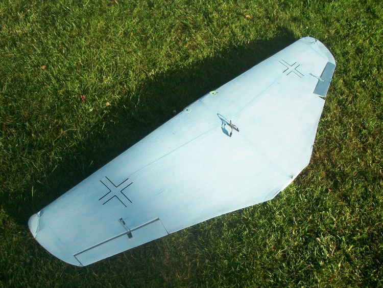

24 Jun 2022 17:59 #236 by Quorneng
The reason I am not sure it is a simple CofG problem as it is already at about 20% of the mean chord.
The thin line is the root balance point which is just 18.75% of the root chord.
The wing section is pretty conventional so providing the tail to wing incidence is not way out it should if anything fly a touch nose heavy.
In the video from 00:13 to 00:15 you can see the HE162 simply does not react to the influence of the fins indeed it is almost travelling sideways until it stalls nose high, drops almost to the vertical and recovers. :woohoo: Not really visible in the video but it repeats such a manoeuvre a couple more times.

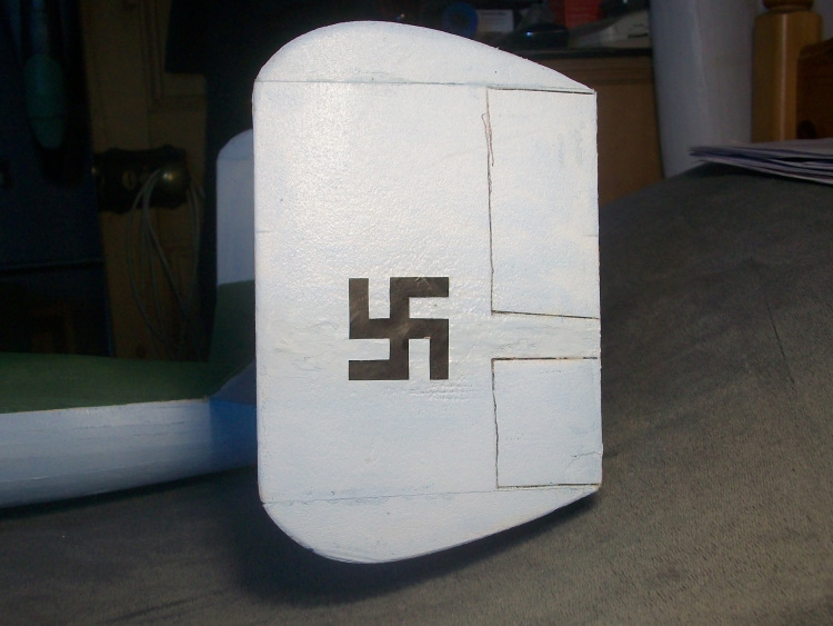

26 Jun 2022 19:42 #237 by Quorneng
I have been working how I might organise giving it working rudders.
The original had each rudder split top and bottom to clear the tail plane.
A complication I can do without!
The elevator stops short of the fin so with a cut out in the tail plane I can use a one piece rudder.

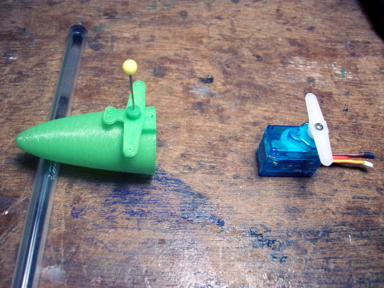

My idea is to mount a single bell crank at the centre of the tail plane on the tail cone and move the rudders with 2 mm carbon tube push rods.
The bell crank would be moved by long pull/pull lines from the 5g servo up front nearly 1.5 m away.:ohmy:
So a bit of printing.
A revised tail cone which includes a mounting for the printed bell crank. Made as light as possible simply because any weight added is at the extreme rear. It should be countered by the servo that will be placed well ahead of the CofG.
Hopefully the complete rudder installation will only add about 12g.
Actual fitting will have wait until the carbon tubes arrive.
29 Jun 2022 23:24 #238 by Quorneng
After several attempts I have fitted the the bell crank and 2mm carbon push rod to the left hand rudder which is now a single unit.
It all seems to work ad is very free running which just as well as it is a small servo.
Now to do the same on the other side and then mount the servo up front, 1.1 m away! :woohoo:
