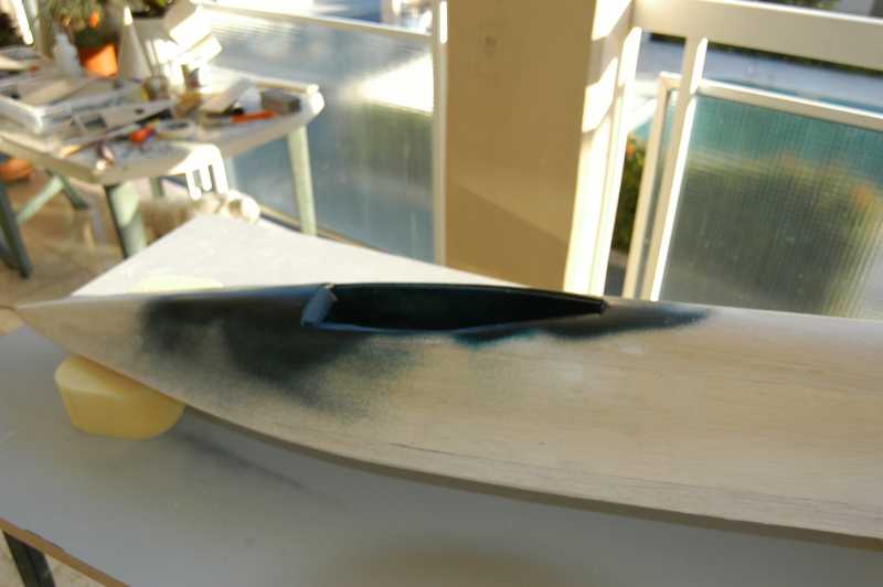

Could not resist it, had to start the painting this afternoon on the front section, a coat of grey primer, let it dry for a couple of hours rubbed it down with wet and dry and then another coat, ( nothing like grey primer to show up all the crap building ) i have found out today,:ohmy: i will rubb it down again tomorrow add panel lines and then another primer, that will also be a new experience im treading on new ground again, learning as i go.

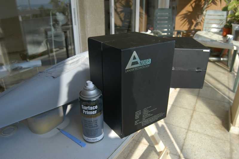

Well look what i got today, could not believe my eyes, 10 day's from ordering to crossing my doorstep
and from China,
The fans weigh 885grs each, the boxes 1200grs each no wonder the postage cost an arm and a leg
and they are the new version, the fan's i mean!!

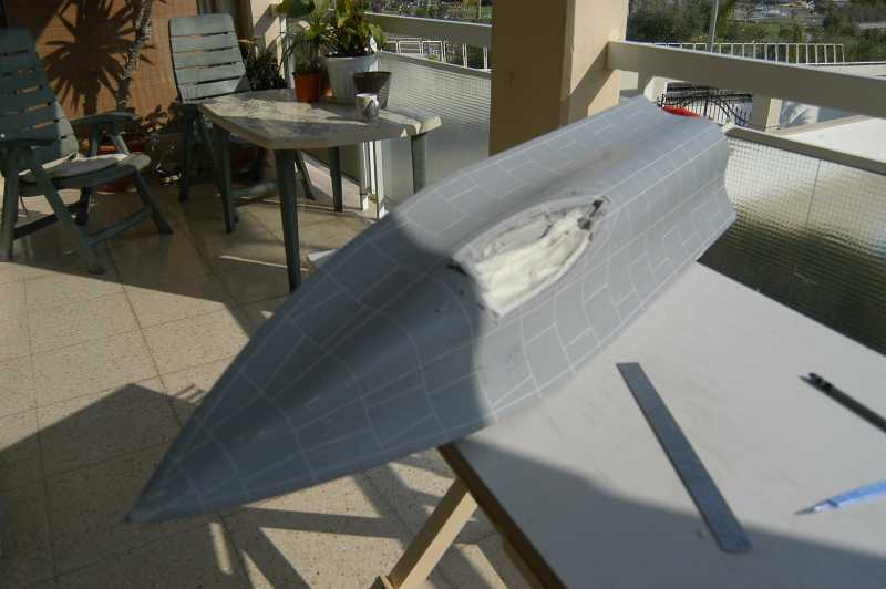

I gave it another good sanding down then added the panel line's
Then another coat of grey primer, when dry a light sanding followed by a coat of black
Tomorrow i will do the canopy and cockpit all being well
Then the final coat of black

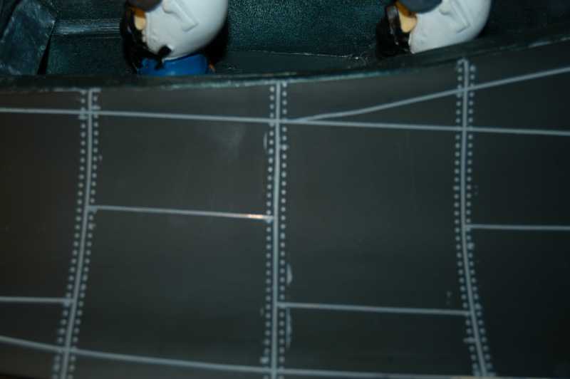

Had a riveting day today, never done it before, just experimenting, glazed the cockpit and stuck the pilots
30 Mar 2012 14:26 #135 by THE BLACKBIRD
Replied by THE BLACKBIRD on topic Re: SR71 BUILD - The Blackbird.
Had another riveting day yesterday so not much to show, but i put the top coat of black on some of the rivet detail ( cannot get it to come up on my camara ) but im very pleased with the outcome.
