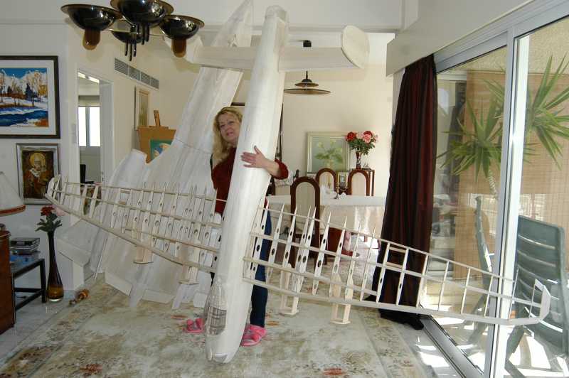

04 Mar 2012 17:45 #93 by THE BLACKBIRD
Replied by THE BLACKBIRD on topic SR71 BUILD - The Blackbird.
The SR71 and the Lancaster posing with my thired model Natalia
Lucky me

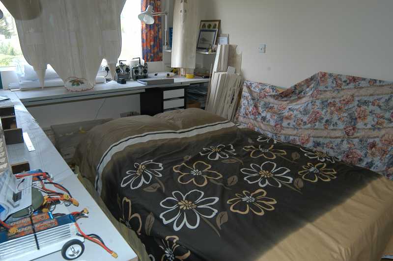

08 Mar 2012 03:59 #100 by THE BLACKBIRD
With my company staying i get to sleep with all three of my models for a week
