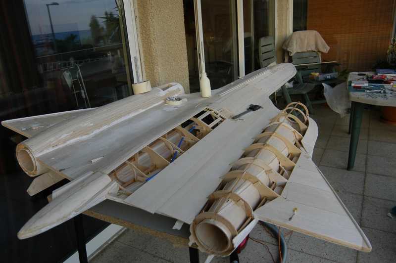

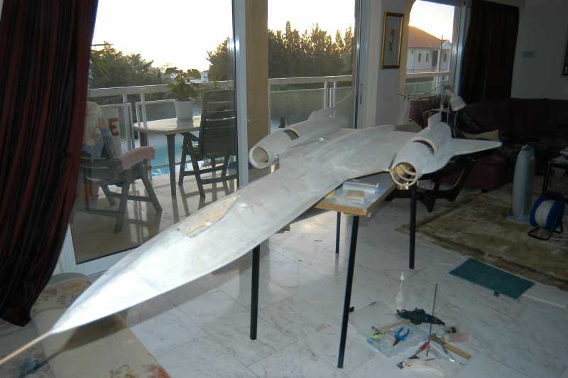

SUNDAY
Joining the two sections together with bolts, so they come apart for transporting
Trying to get the join of the two sections to look like a panel line

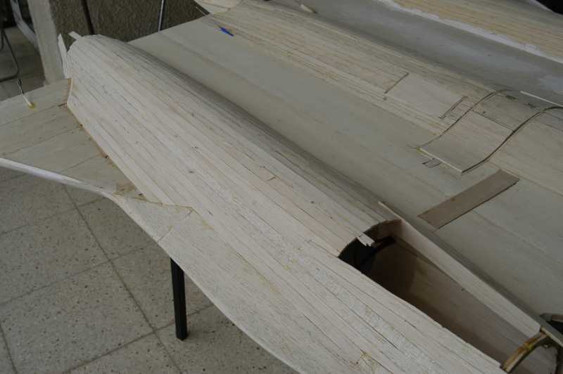

22 Feb 2012 01:44 #81 by THE BLACKBIRD
Replied by THE BLACKBIRD on topic SR71 BUILD - The Blackbird.

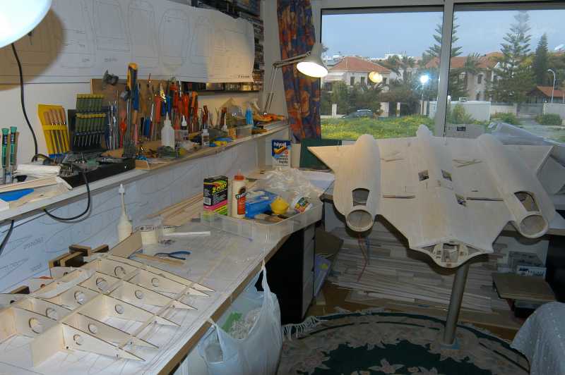

Another slow day planking, not much to show for the effort put in
but ill get it done tomorrow thankfuly.
leaving hatches for access to wire's, and covered the inlet air duct

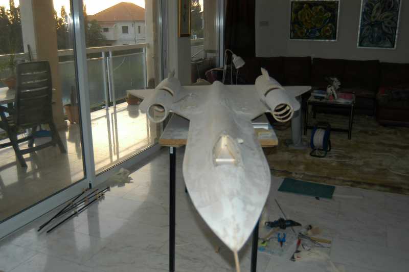

23 Feb 2012 01:47 #82 by THE BLACKBIRD

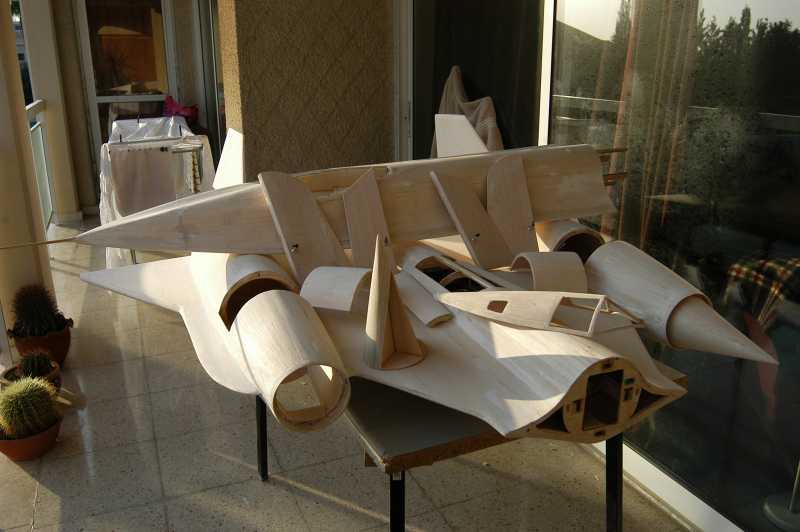

At last i have finnished the balsa skin, it's been a long haul and i can do away with the CA now
maybe ill start to feel better for it,
so im sanding again
This is the cheater inlet intake fo the fan with the spike fitted 100mm x 50mm wide 180mm long

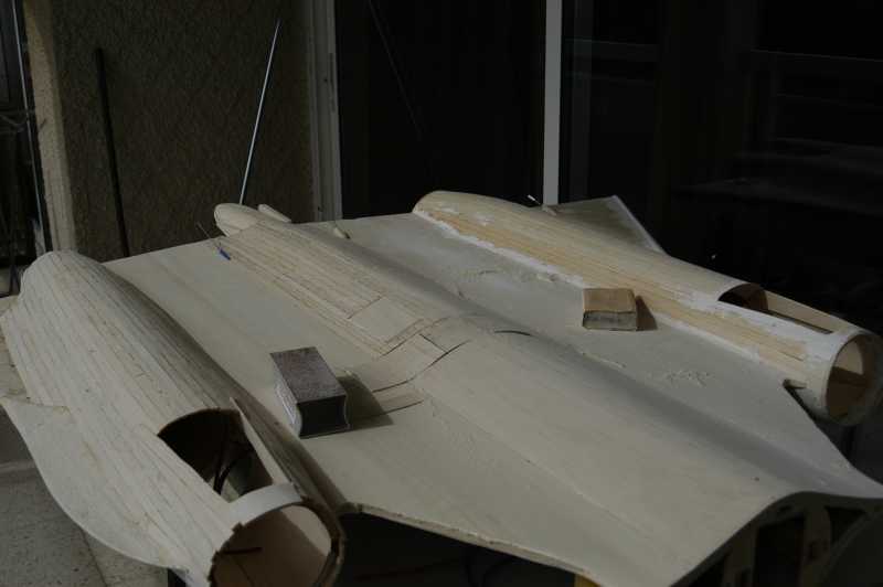

Only sanding/filling done today, tomorrow i will have a change and do filling/sanding
But a nice enviroment to do it in

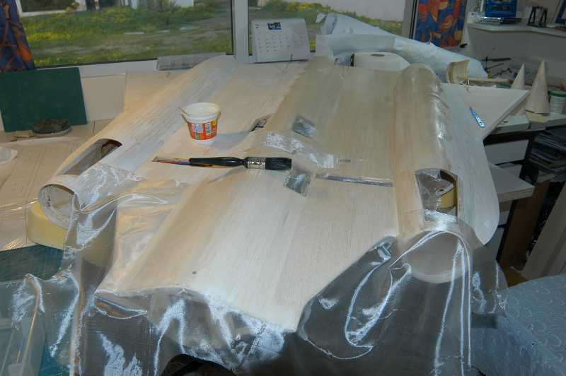

Getting ready to glass the underside
Glass cloth attached with thinned down pva glue ready for a coat of resin
