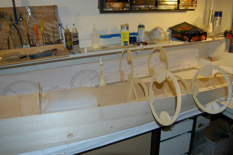

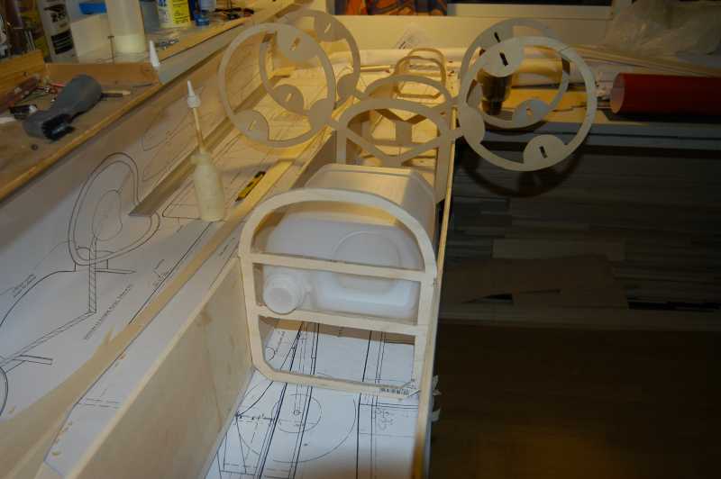

My fuel tank
A 10 formers
Astra and puppys

09 Oct 2012 00:45 #35 by Ex-Member
Replied by Ex-Member on topic Re: The Cyprus A10 THUNDERBOLT
nice formers BB.
was the plastic can full of cider first. :P
dogs are sweet as well.

I stuck paper on 1/4 ply then drew the formers ( i think i need a few more lines on them)to make it even more confusing :blink:
This one is going to be a make it up as i go job :unsure: :unsure:
The can was empty, they always seem to have two tanks when theres two turbines ?? cant see why, one tank with two feed pipes one fill and one vent should not be ok.

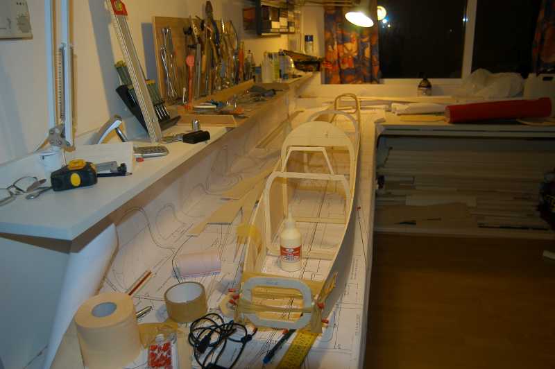

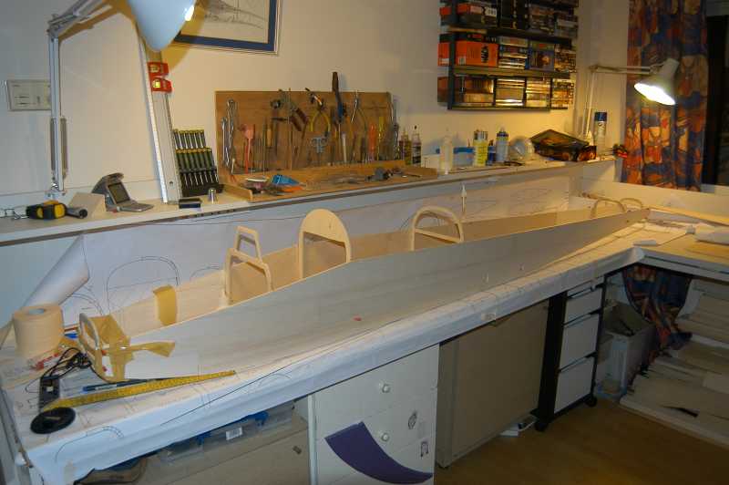

Iv been having a go at the A 10, making it up as i go trying to forsee problems that might crop up later

And a few more pics
Thats a gallon can for the fuel tank holds 5 lts i think i can get 7 lts in the space so im looking for something else
The centre of the tank is the C/G position ( about ) :unsure: ;)
There's about 7/8 sheets of balsa in each fuselarge side
Last edit: 20 Nov 2012 01:51 by THE BLACKBIRD.
