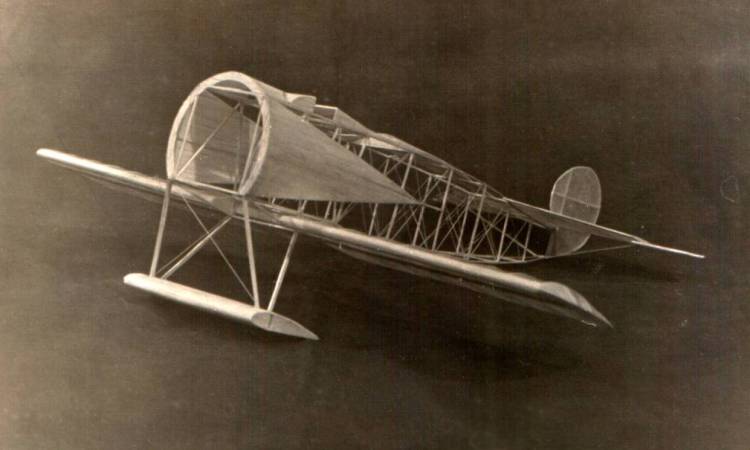

I did use 1mm round balsa for the fuselage of my small Fokker Triplane for the same reason and I even painted it before covering so it looked like painted steel tube.
I must have been truly daft 40 years ago! :woohoo:
At such a small size balsa glue gave a 'fillet' to the joint to ensure is was passably strong in tension but at larger sizes it might be difficult to achieve a reasonable tensile joint strength. You are after all trying to emulate a welded tube joint which is virtually as strong as the tube itself.

You cant get 1mm round balsa - I made it myself sanded very carefully from 1mm square cut from sheet. I discovered that some 1/32" (0.8mm) sheet was actually a full 1mm thick.
But to be fair the longest piece required was only 11" long.

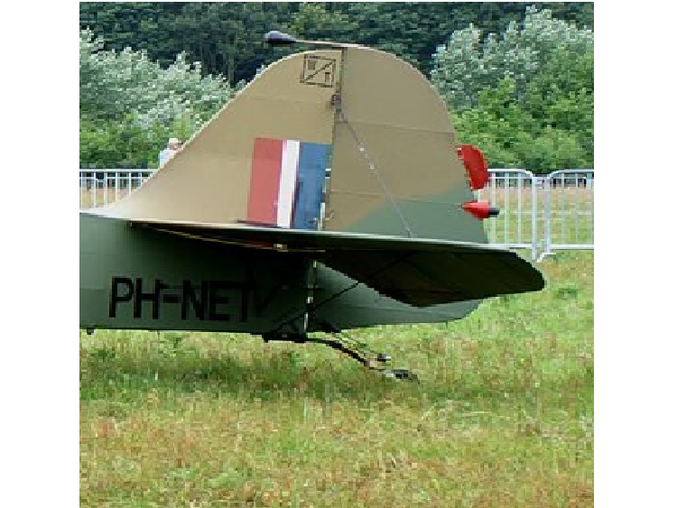

Will you be able to cover it with the trim tab and nav light in place?
From what I remember the trim tab was just a sheet of aluminium riveted to the outside of the trailing edge tube after the covering was in place.
Don't know about the nav light though.
