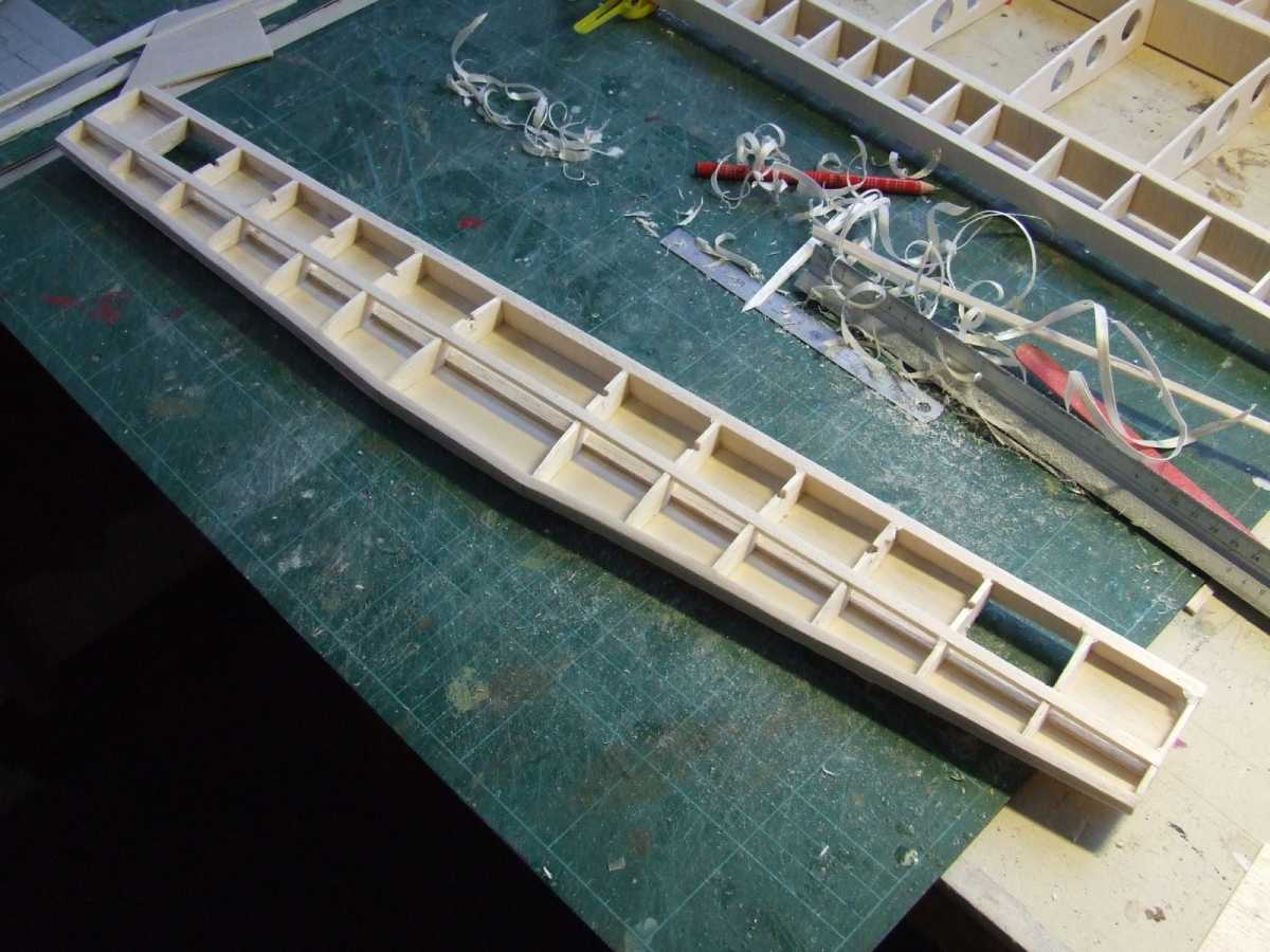

16 Jan 2014 16:35 #10 by Ex-Member
Replied by Ex-Member on topic 72" lancaster build
sat down this afternoon and cut the tailplane ribs all 14 of them, then we cut a spar and made a start.
you have to build the tailplane upside down, so that the underside has the dihedral.
then you add the trailing edge.
and then the false leading edge and leave to dry over night.
tomorrows job will be to fit the rudder servo mounts, run the servo wires and sheet the underside.
then when dry i can flip it over and sheet the top, make the fins and we are done on this bit for now. :)
17 Jan 2014 13:00 #11 by Ex-Member
well i have glued in the final spar and sheeted the underside of the tailplane, need to wait for it to dry now.
cut out both fins and rudders as well.
will post pics later.

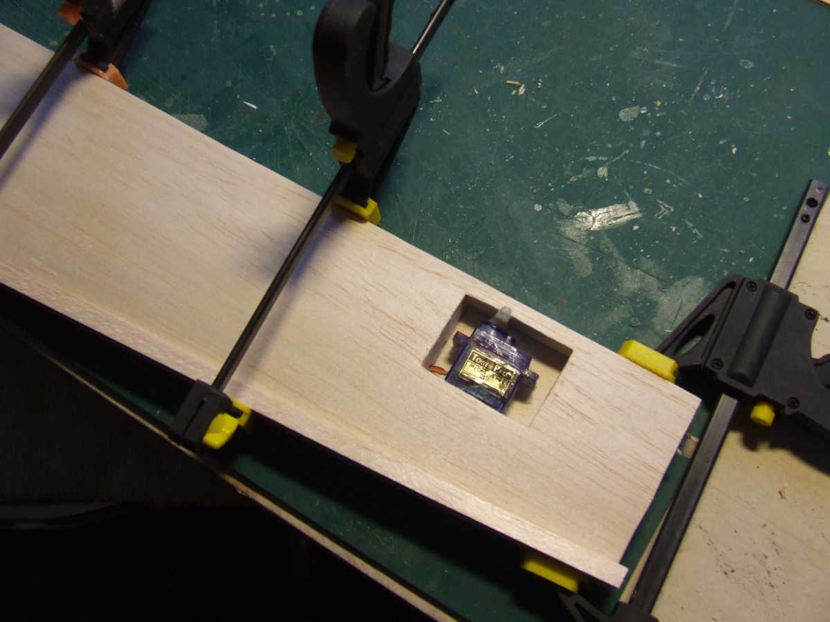

17 Jan 2014 20:25 - 18 Jan 2014 17:20 #12 by Ex-Member
glued the bottom spar in place and then cut the rudders and fins.
then when the spar was set i sheeted the underside of the tailplane.
had to cut 2 holes so i can fit the rudder servo's next, then i can sheet the top of the tailplane and fit the l/e.
another job done.

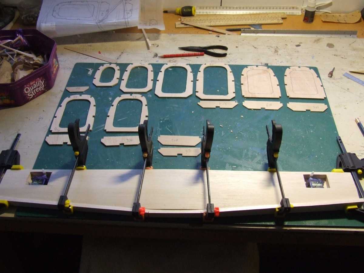

18 Jan 2014 16:45 #13 by Ex-Member
rudder sevos fitted.
top sheeting done and the leading edge gluing.
started cutting 21 fuselage formers, long slow boring job.
still nearly done them now and we can start the fuselage soon.
