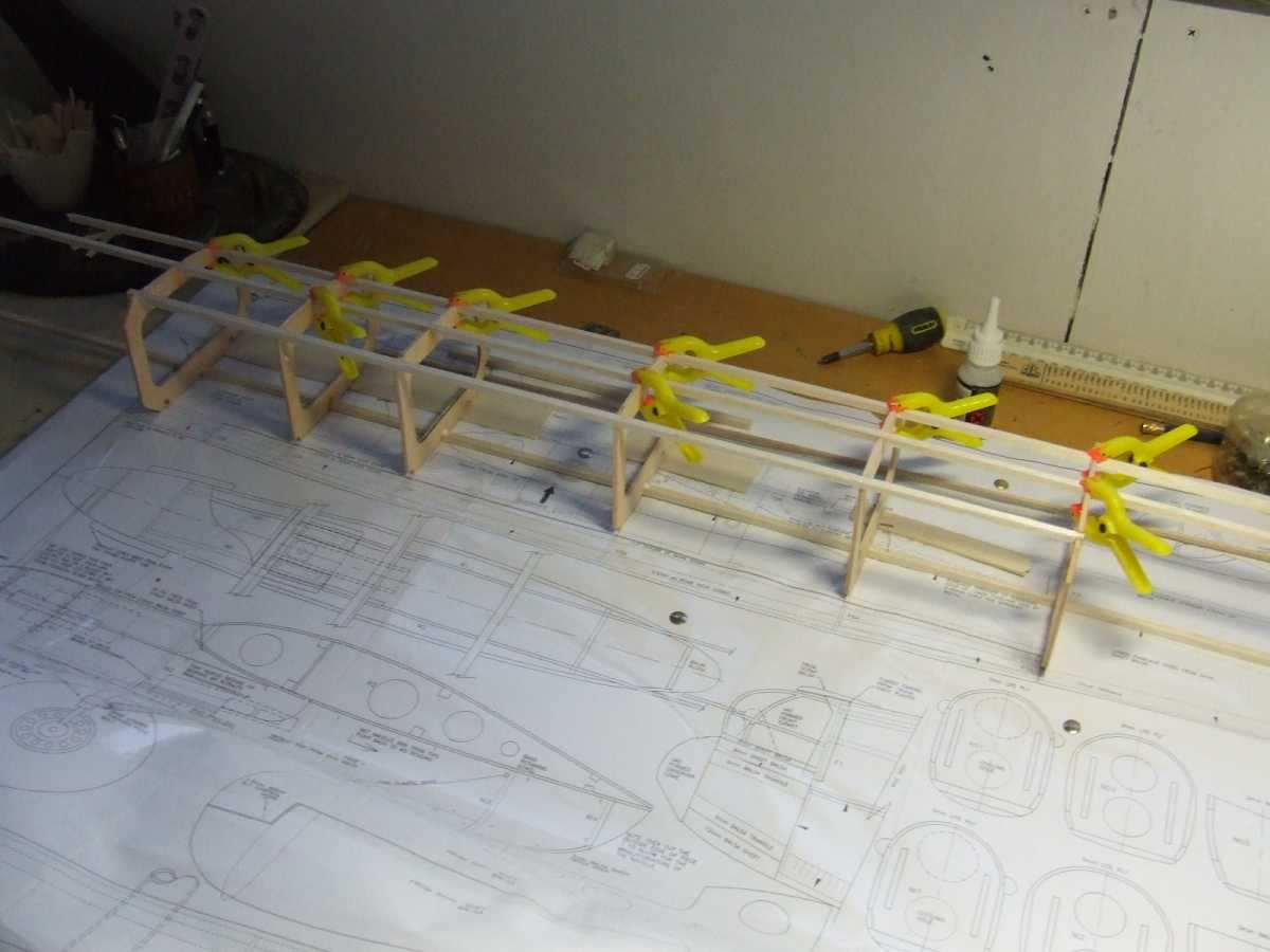

Finished cutting the formers this morning.
Started the assembly.
will do some more after lunch maybe.

checked on the plan and the formers 2 to 7 are the same width, so i can build that part of the fuselage on its side.
it will make it easier to build it square.
then i can lift it off and build it upright in a jig.

well one side is partially done and ready to lift off the plan.
Fins have been set and glued on, need to leave them to set for now.
tomorrow back to the fuselage.

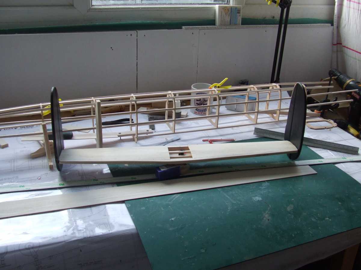

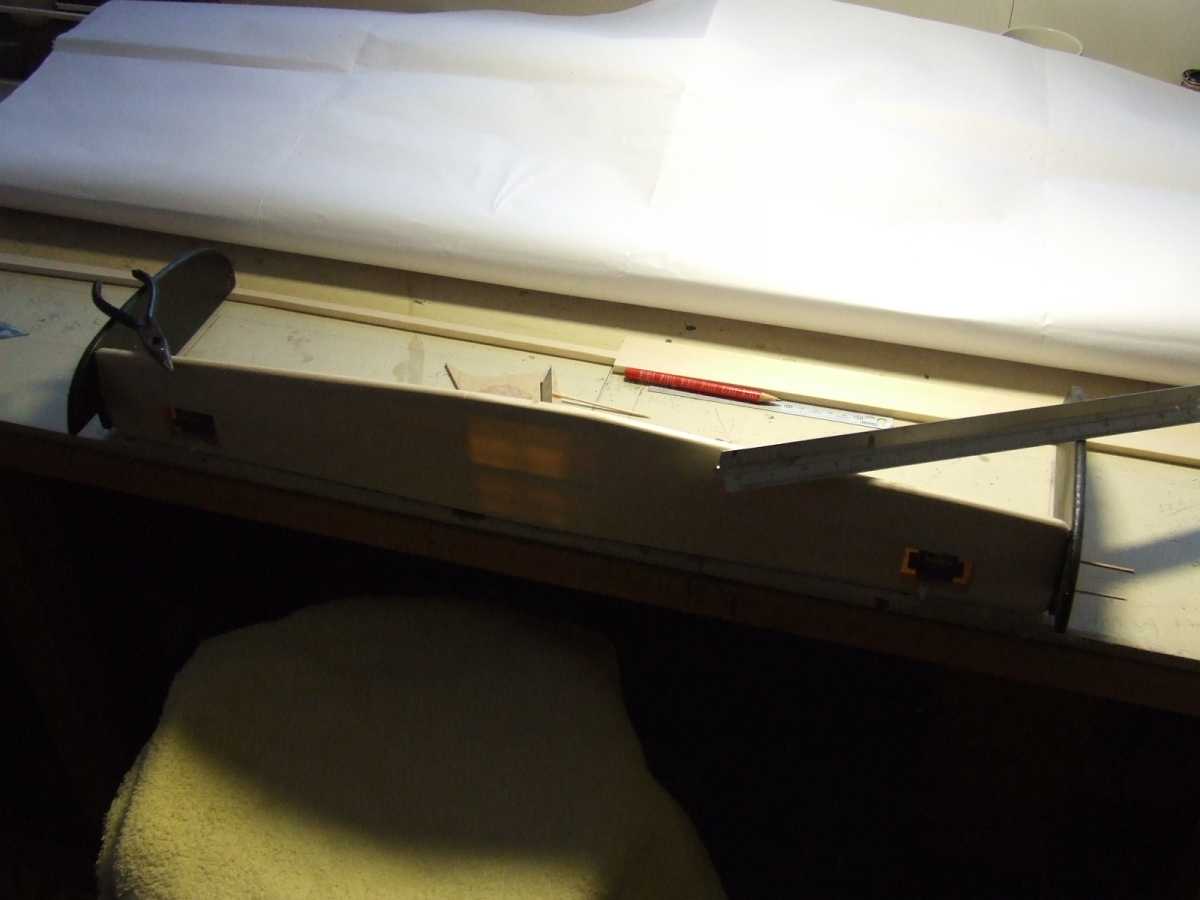

hope to start sheeting tomorrow.
tailplane, fins and rudders sorted.
i need to glue it in before i finish sheeting the fuselage.

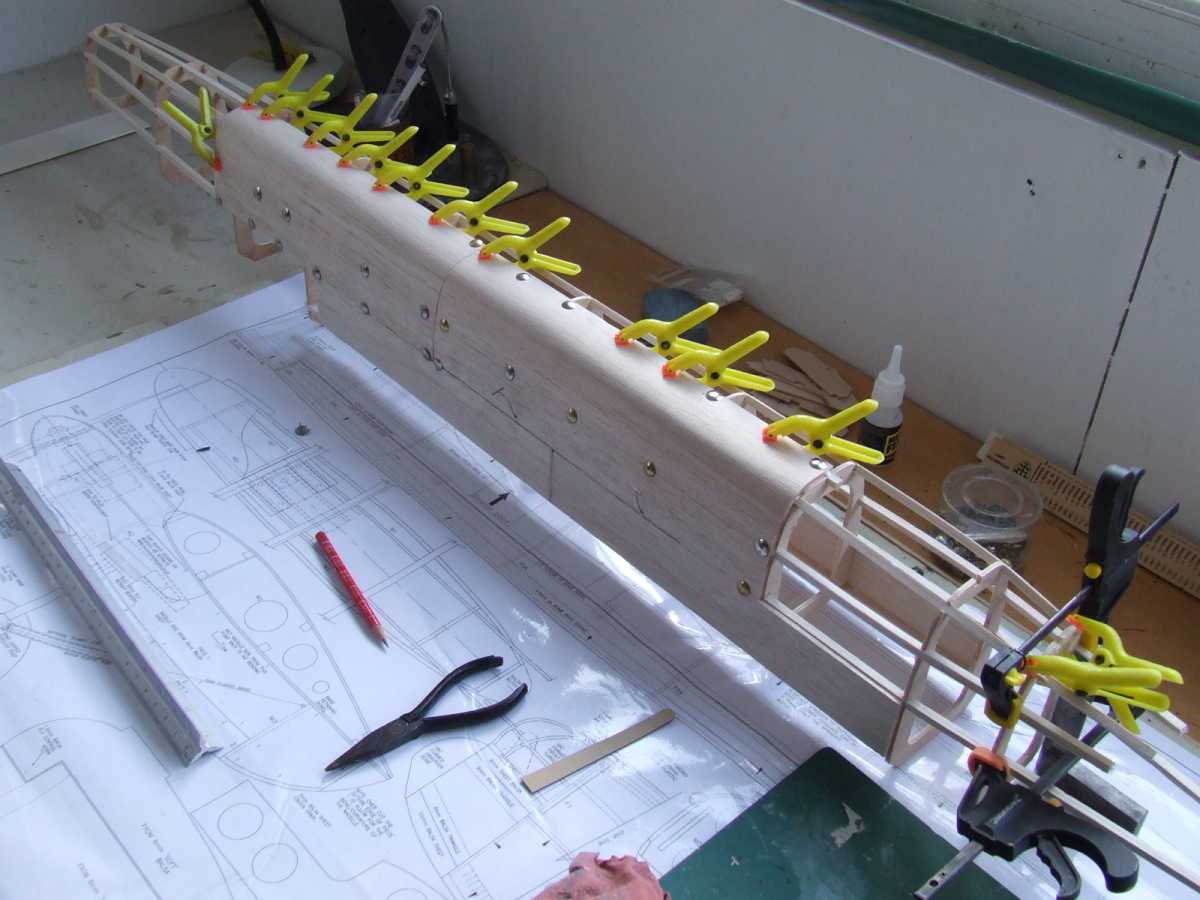

today i pulled the fuse off of the plan and proceeded to fit some of the lower sheeting.
then i whetted and curved 2 sheets of 2.4 for the top half of the fuselage and glued them on.
then i pulled in the front and fitted F1.
thats it. :(
tomorrow i can do the other side and then carry on sheeting.

got the curved sheeting glued and drying on the other side of the fuselage.
got to wait now till it dries enough for me to handle.
then i can plank the tail area and fit the tailplane.
might happen today, but i doubt it.

more sheeting going on. don't like this method, puts a lot of strain on the stringers and formers.
still it all still looks to be straight.
back to planking the curved bits tomorrow.

Still plodding on with the fuselage sheeting.
doing it this way, because i feel that curving sheets of 2.4mm even when wet, would tend to twist the fuselage out of shape round the curved ends.
so planking it is. slower maybe, but it will keep the thing straight and twist free.
traced the main wing ribs, ready to bee transferred to the balsa for cutting tomorrow.
so i still need to plank the rear down to the tailplane mount, then fit the tailplane and finish planking round it to tie it all in, do the underside, the bomb bay doors and then sand smooth.
so i hope monday to start the wings. :)
