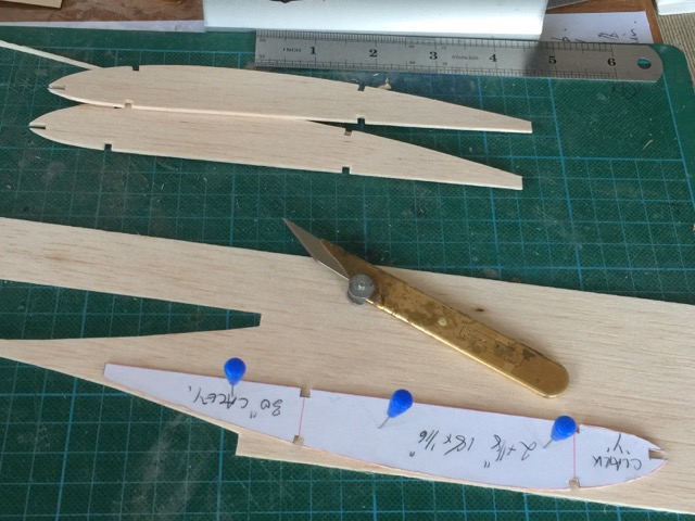

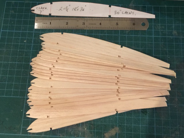

Yesterday's work included cutting out a ply wing rib template; rib cutting has begun in earnest!
...and before anyone comments or suggests it, I don't get on with the sandwich method of rib creation. I prefer to cut them individually, pin them together and then give them a final touch-up with a sanding block.

Not much modelling time available today (currently sorting artwork for an exhibition in Stevenage at the end of the month, but more of that in another thread nearer the time....), but I did manage to finish cutting the wing ribs and played around with CAD to work out the shapes of the 1/8" balsa pieces I'll need to build up the nose shape. The latter is not yet complete!

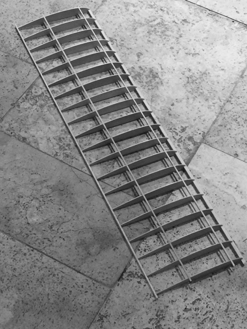

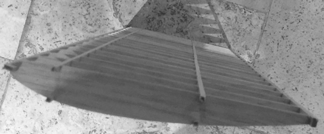

The CAD work remains as it was, but over the past couple of days, I've built the wing, taking it off the board yesterday.
Spar jigs getting laid down using a straight edge:
Spars and TE have been jigged in position, ribs are now added:
All ribs in position, top spars and LE added:
The following are in monochrome as the colour pics were a bit washed out.
Off the board and ready for sanding, adding accoutrements and ailerons:
Last edit: 24 Jan 2017 18:18 by Ex-Member.

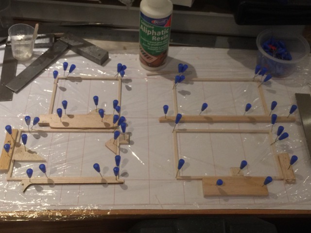

I've had some non-aeromodelling priorities over the last few days, but I was going stir-crazy this afternoon, so I took time out to make some formers:
One of the nice things about a boringly square aeroplane is that all the bits are boringly square as well, and therefore, they go together easily!

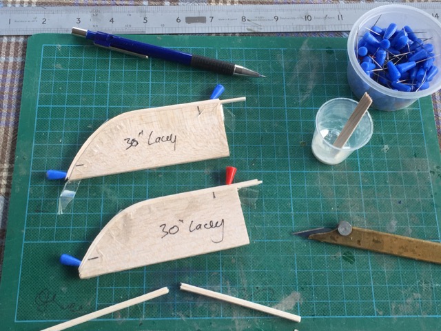

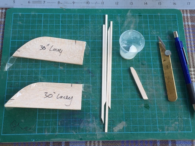

All I managed to do yesterday and today was cut a form from 1/8" balsa over which to laminate the canopy frame from two strips of 1/8" x 1/16":

Andy
How long have you had that brass modelling knife? Mine must be 40 years old or more (if I can remember where I last left it - use Swann Morton scalpels 90% of the time)
Mike
31 Jan 2017 06:57 #30 by one tenor
Replied by one tenor on topic SAMS Models Lacey M-10
Mike Rolls wrote: Andy
Mike
:cheer:
Me too! I also have one the same but stamped Keil Kraft .Not a clue where they are at present Moved house 9 yrs ago April 14 th :cheer: :lol: [badass]
