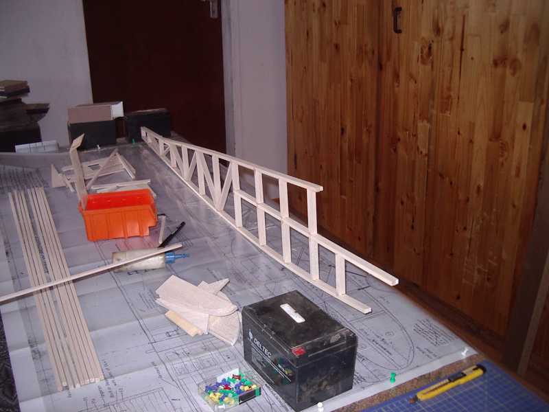

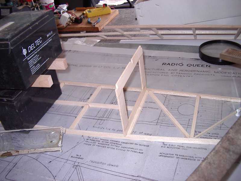

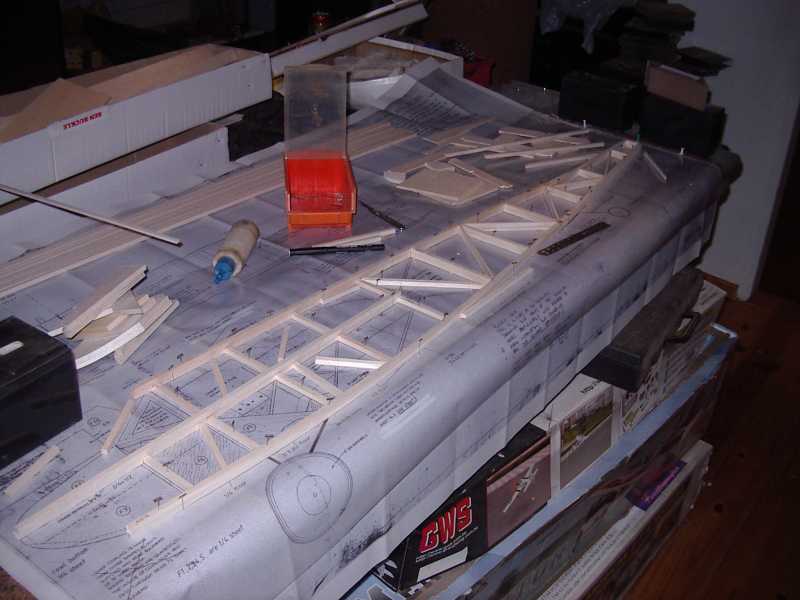

Fidelis, this is the old way of doing things
This is what we call a Traditonal build, and even here I've strayed, because in the old days we would have used Balsa glue, it came in Lead tubes, and the active ingredient was Acetone. It took ages to go off!
Nowadays we use Aliphatic glue (grabs in 15minutes and is easy to sand) but you can use any of the 'white' glues as well.

with balsa constructions its triangulation that builds in the strength. i think
