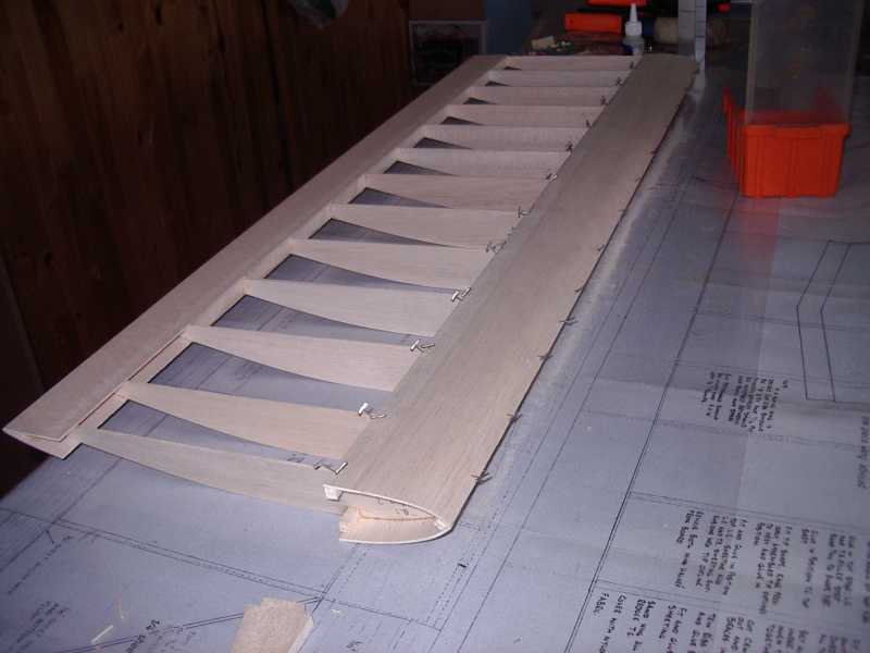

22 Dec 2011 21:29 #42 by Klipkopwildlife
Replied by Klipkopwildlife on topic Re: Building Materials, Structures & Processes.
This is a wing built up in Balsa, other materials can be used, such as Depron.

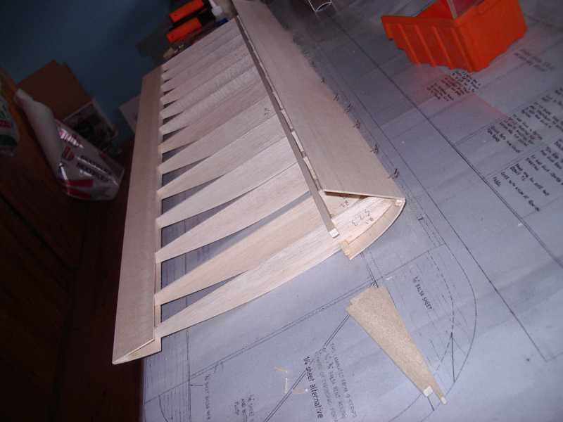

22 Dec 2011 21:34 #43 by Klipkopwildlife
Then boxing in th 'D' section to give it twisting (torsional) rigidity

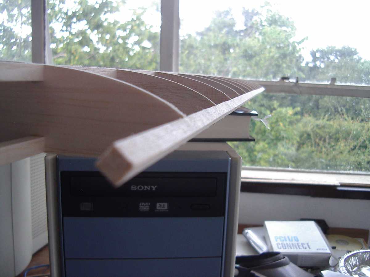

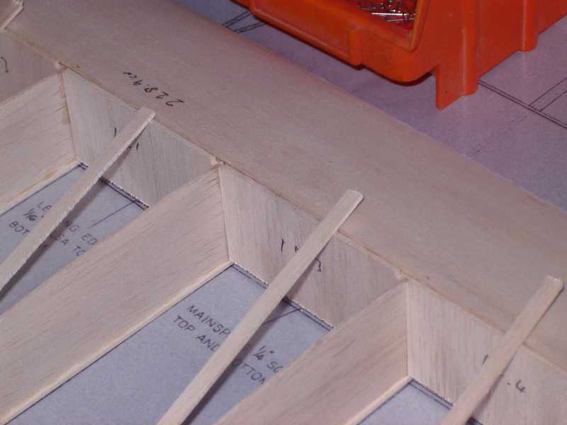

22 Dec 2011 23:00 #44 by Klipkopwildlife
And of course, closing off the 'D' section
23 Dec 2011 00:54 #45 by Eric
Klippy got there first - torsional stiffness = the resistance of the structure to twisting and bending.
an example. Four sticks of equal length. join all the tips together to make a long stick, join the two ends together.
You have a square - but, one side can slide up and down relative to the other.
Take one stick out, and join the tips, so you have a triangle. That will not move.
