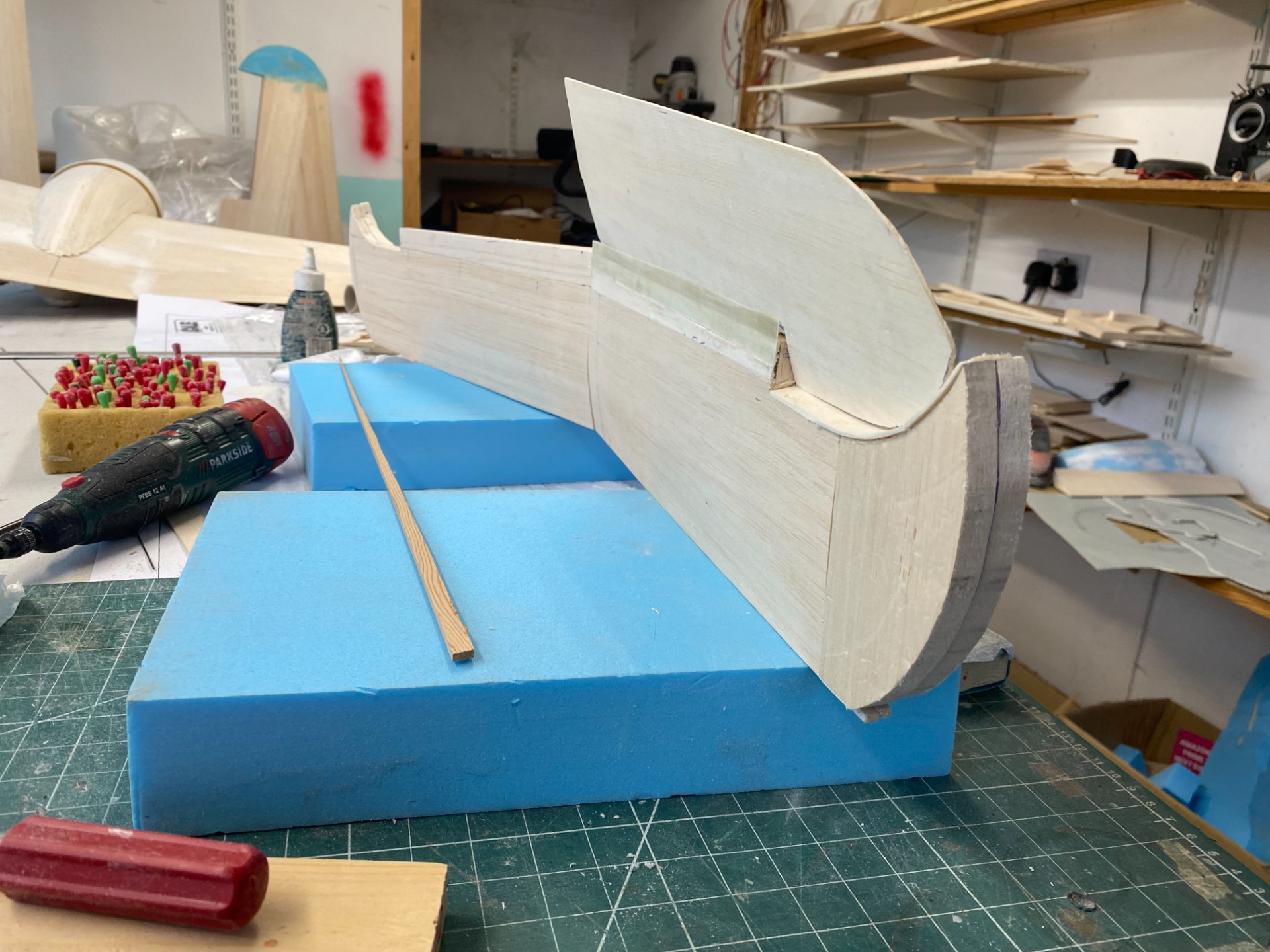

I got the planking all done
So i thought i would have a break from the wings as i seem to have been building them forever, so much work in them
So i got the tailplane drawing on the bench and started it, again a lot of building in it, seem you have to build it in 4 halves and then glue them together then join the 2 together with the dihedral

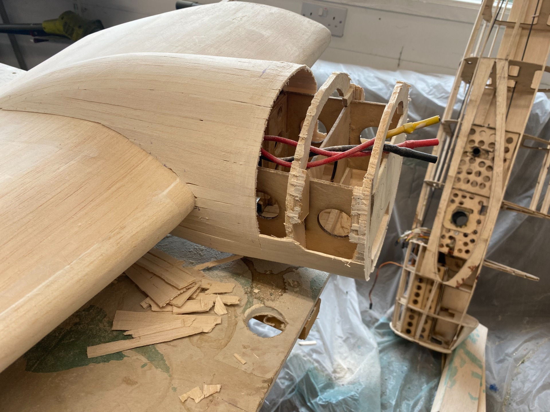

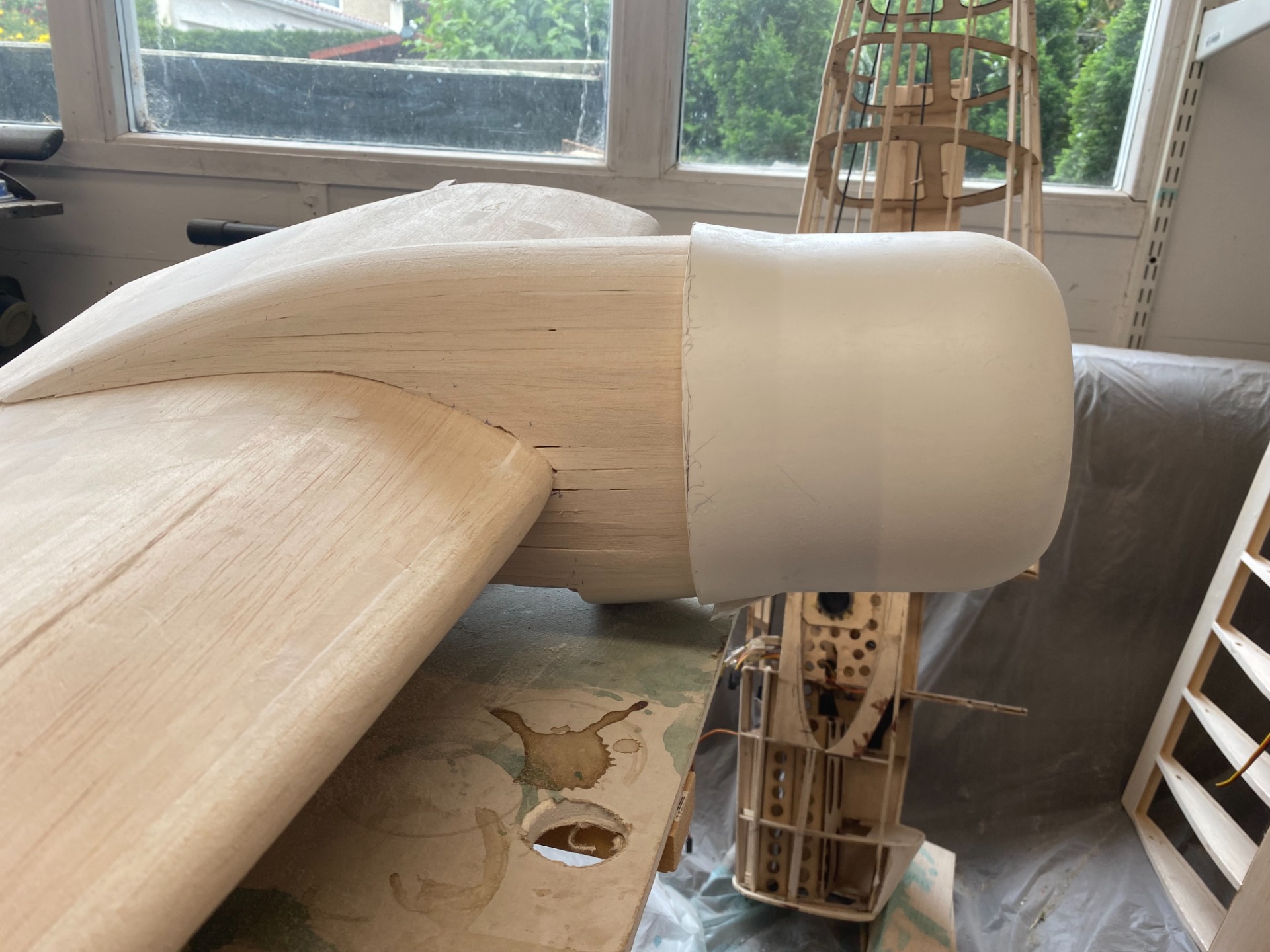

Run into a problem having built it to the plan i find the cowl will not fit over the planking, iv sanded the 3mm planking down to a point it cannot sand anymore so it looks like its a pull apart job
Lot of dihedral on the tail
Trying to come up with a hinge that i can take apart

I rebated the 2mm sheeting on the tailplane 1mm so that i could glue a 12mm wide piece of proskin along the edge to act as a cover for the elevator / tailplane joint

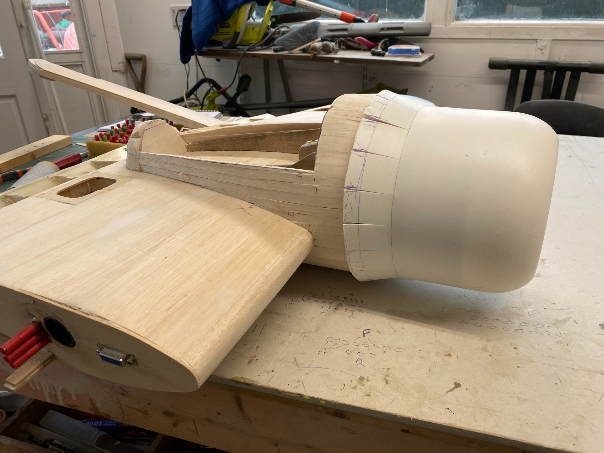

Did some pulling apart where the cowling fits
It now fits in the correct distance from the wing
Dont think it needs re sheeting as its only seen with the cowls off

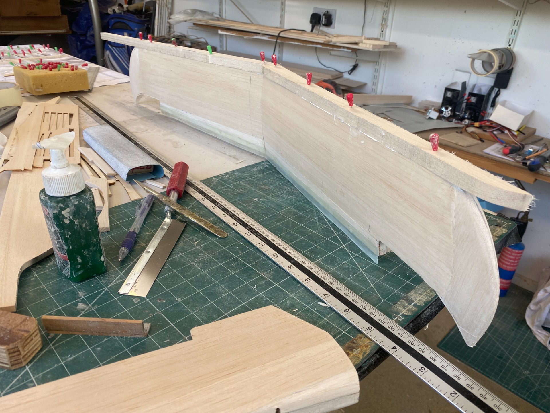

Just been looking at some pics of this and looking at the plastic model i have and the elevator and ruder look like they are covered in cloth or they have external ribs, iv already sheeted the top side of the elevators, anybody got information on this

Thanks Simon iv sheeted them now as they would be very flimsy as built, just have to try and make them look cloth covered somehow

The sheeted tail
