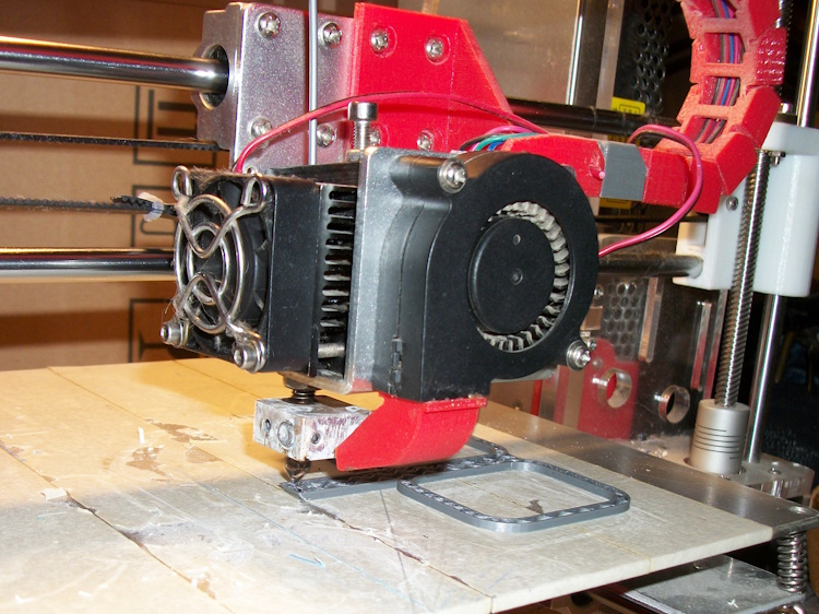

Since Jon bought himself a Mk 4S I noticed a modification that interested me, I occasionally get failed prints like this  It only ever happens with LW-PLA. On the 4S Prusa have added a fan to cool the extrude. Once shown the fix it's obvious that the problem is caused by heat in the extruder.Having a spare fan I decided to organise my own fix.
The fan is only 16mm wide but the extruder is 42mm, no problem
A bit of heat (180C) does the trick.
Check out the fit
and then job done.
Could this be the end of my occasional problem?

09 Dec 2024 13:12 #38 by Quorneng
Replied by Quorneng on topic Prusa Mk 4
Interesting. A neat installation
I suspect it happens on LW-PLA because the extrude is much hotter.
Is yours an additional filament cooling fan?
If there was no other filament cooling fan and Prusa actually needs one then it is a bit behind the humble Anet A8 which has always had one. The fan has a nozzle to direct air directly onto the deposited filament to cool it fast.
 The fan speed is adjustable although with the Anet's limited heating power it struggles to hold the nozzle temperature with the fan at full speed. The problem is if the nozzles drop too far below the set figure it triggers a print abort with a "heating failed" message.
09 Dec 2024 16:55 #39 by Klipkopwildlife
Replied by Klipkopwildlife on topic Prusa Mk 4
My Prusa now has 3 fans, the photograph showing the left side of my modification shows the print cooling fan. The right side of the finished article shows the heat break fan underneath my modification.
12 Dec 2024 17:17 #40 by Klipkopwildlife
Hmm, not so good
I had hooked the new fan into the heat break supply, not such a good idea, I did think there wasn't much huff, I rerouted to 12volts, now blowing much harder.

12 Dec 2024 19:39 #41 by Quorneng
Oh! dear.
Not quite clear in my mind as to why the print should fail at that point.
It seems to occur at a very specific print layer. Strange that a "cooling" issue would be so precise.
It could be some sort of "mechanical" issue related to the way the layer is laid down but I can't imagine what it might be!   .
14 Dec 2024 08:04 #42 by Klipkopwildlife
Well, I did some temperature checks with a non contact thermometer, the ambient temperature in the room is averaging 34C with the walls at 36C. The extruder surface at print start was 34C, extrusion failed when the extruder surface reached 38C, about 2hrs into the print. Bearing in mind that the extra fan is drawing warm air off the heated bed (80C) it would appear that my mk4 in its current form needs an ambient of less than 32C. This is just a guess, I'm probably the only person in the world that prints at those ambients. Mary and I don't do airconditioning! It's bad for the environment.
We're currently in a heat wave at the moment, no rain and daily shade temperatures of 40C+. Our river has stopped flowing, just puddles at the moment and no way of knowing when the weather will break.

14 Dec 2024 09:32 #44 by Quorneng
Yes indeed. You are printing at close to my heated bed temperature!
You printer needs some aircon.
