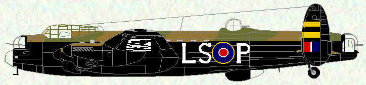

Is the use of a serif font correct for the squadron letters?
The pictures I have show them all ways 'sans-serif' but I may be wrong.
29 Sep 2017 10:18 #51 by Ex-Member
Replied by Ex-Member on topic Lancaster restoration project.
it should look something like this... i hope

It would appear that whoever painted the letters on some of 15 squadrons Lancasters did not exactly follow the Air Ministry instructions :P which states squadron letters in the appropriate colour (initially grey, then red and post 1945? white) are to be of 6" wide stokes.
I cannot find an actual photo of LS-P but there is one of LS-W that clearly shows it had that type of lettering although a photo of LS-H shows it had conventional ones.
Its anybodies guess!

Weren't they supposed to be "Sans Serif " too?
