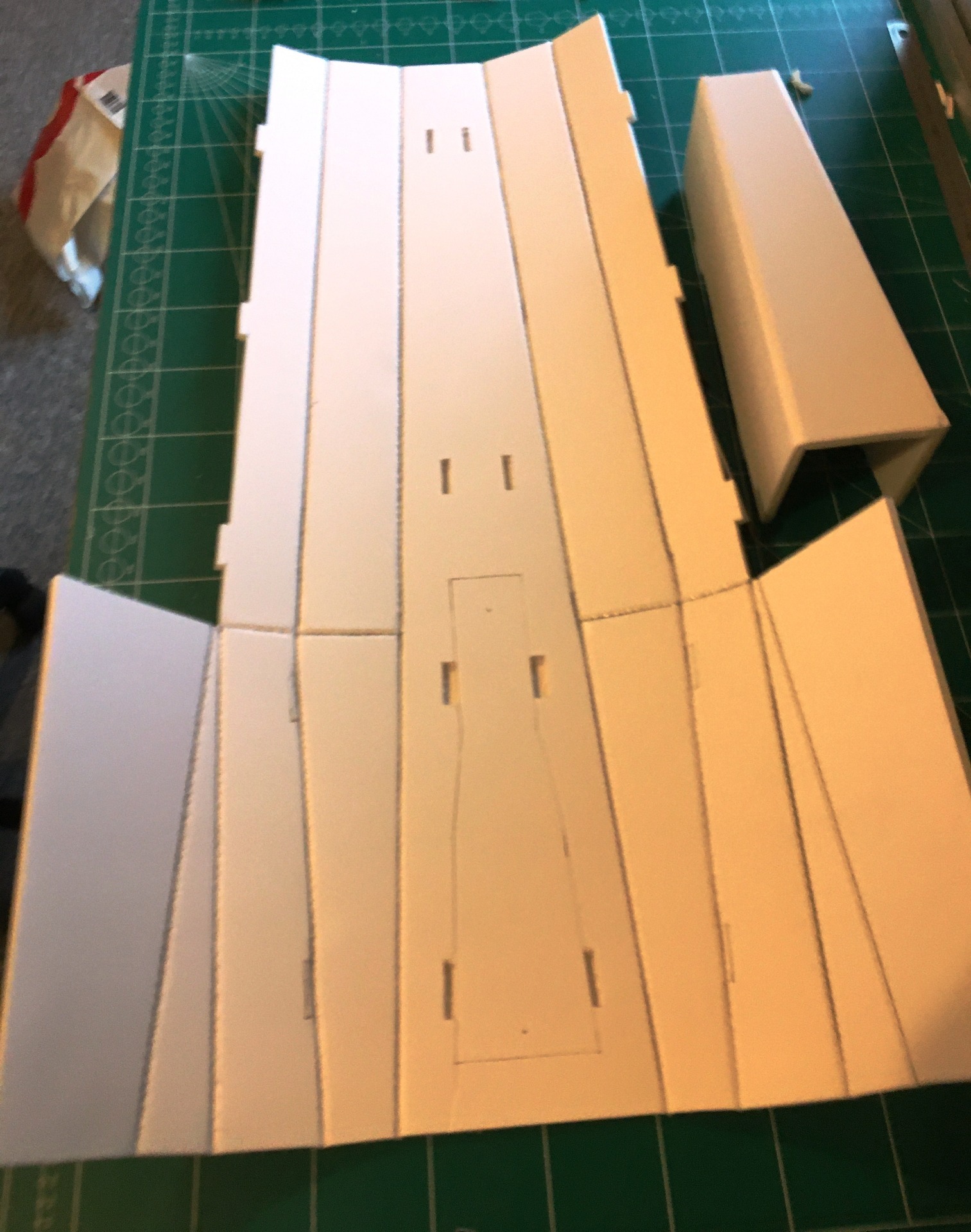

Not that sophisticated, after seeing Ralph's Firefly ! Anyway Iv'e made a start & the first tentative cuts have been made. It is quite a novelty to be working from plans for once, & I have to say It's quite therapeutic !

Ah, confused there for a moment, the first photo is a paper template, the second is the cut part, yes?

Exactly that Klippy. To maximise the number of parts from each sheet of board, I cut them out of the plan with a small overlap & position them with painters tape, then just cut to the lines. I will keep the board, so if I want to make more parts I can simply mark round the inside of the cut-outs. :)

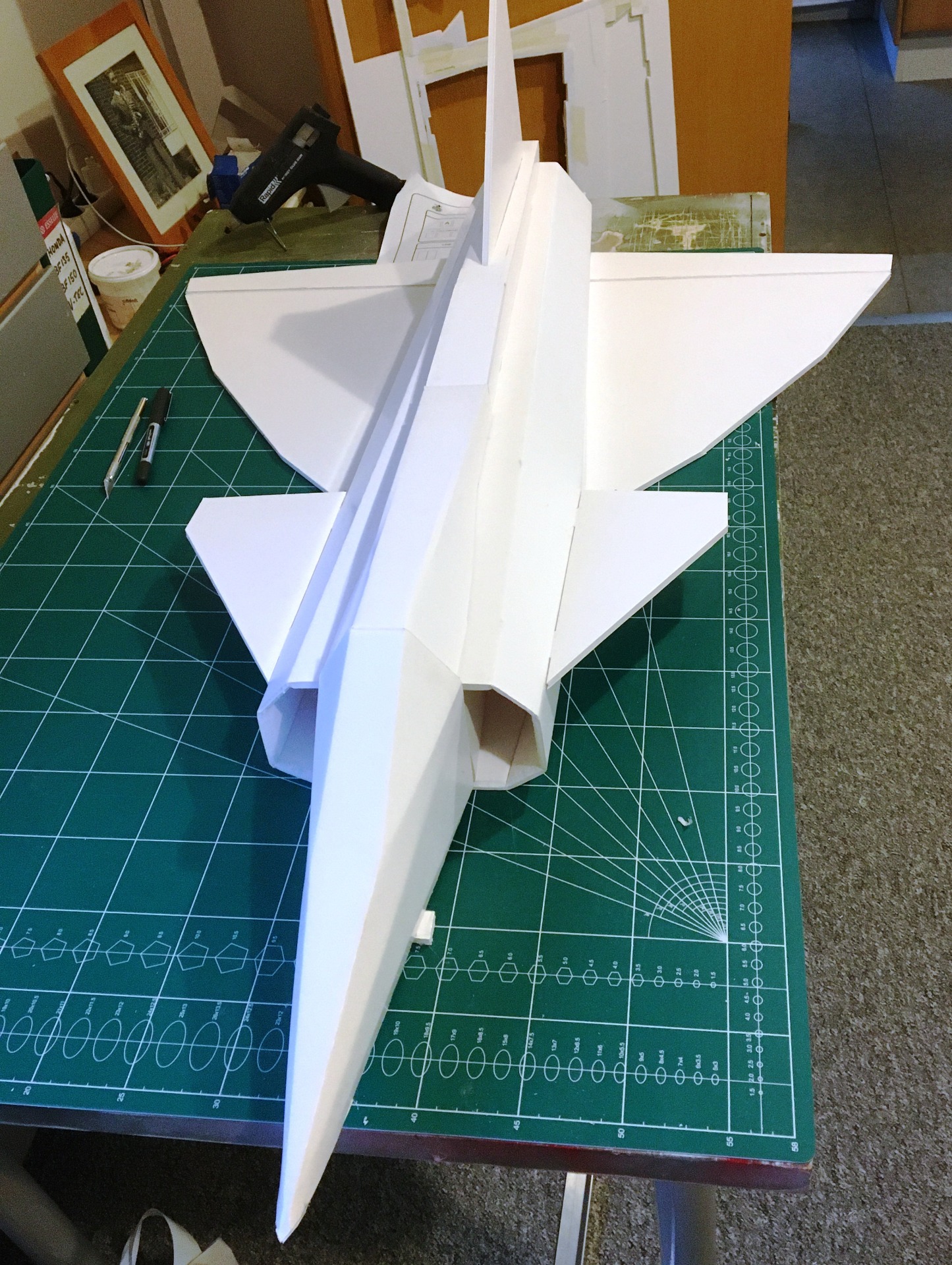

Making some slow progress with the build. There are some fairly complex cuts & folds, but up to now my patience has not been tested to badly. how long that will last is anyone's guess !:whistle: I take my hat off to David Windestål, the young designer. He certainly thought it through & came up with a great design. :) The last photo is a dry fit, at least it's starting to look like an aircraft. A few more parts to make & then I will be stuck until the EDF arrives. :) Notice the two black dots near the front of the wing, that is the CG point. The nose was particularly interesting to fold to shape !

looking good! what's the dimensions and predicted weight? is it possible to "roll" that board to give a less angular look? not a criticism just curious.

I believe you can roll the board by removing the paper on one side. I haven't tried it as this plan doesn't call for it. I actually like the sharp angles, gives it a bit of a stealth look. :woohoo: Here are the specs;

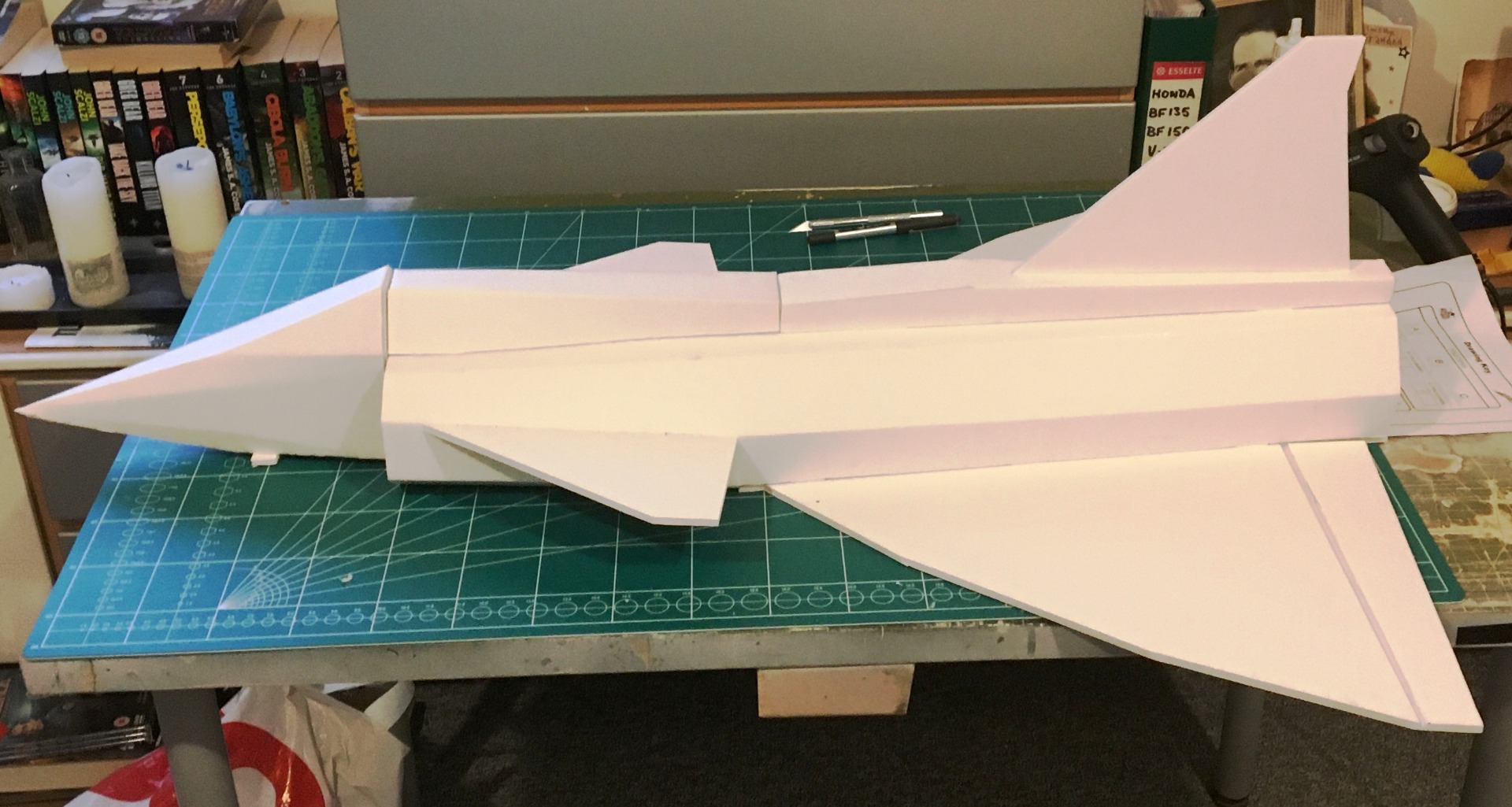

The last of the parts were cut, folded & glued today. I did a 'dry' fit to check everything lines up. Not everyone's cup of tea, but if that isn't one sexy looking aircraft I don't know what is ! :woohoo: [badass] I will start on the electrics tomorrow. I hope that bleedin fan turns up soon ! :pinch:

How about the leading edges? A half round of balsa would not only give some 'ding' protection but would significantly reduce the power needed at cruising speeds.
It would also make a difference to the top speed but at full power such a design uses so much anyway you are unlikely to notice the odd mph or two!

looking good crash! agree with Simon about the l/e, presume those wings are "flat plate"?

I have been giving some thought to the leading edge & agree, it is going to need some streamlining & protection. Balsa would be my first choice. I will see if I can source some locally.
