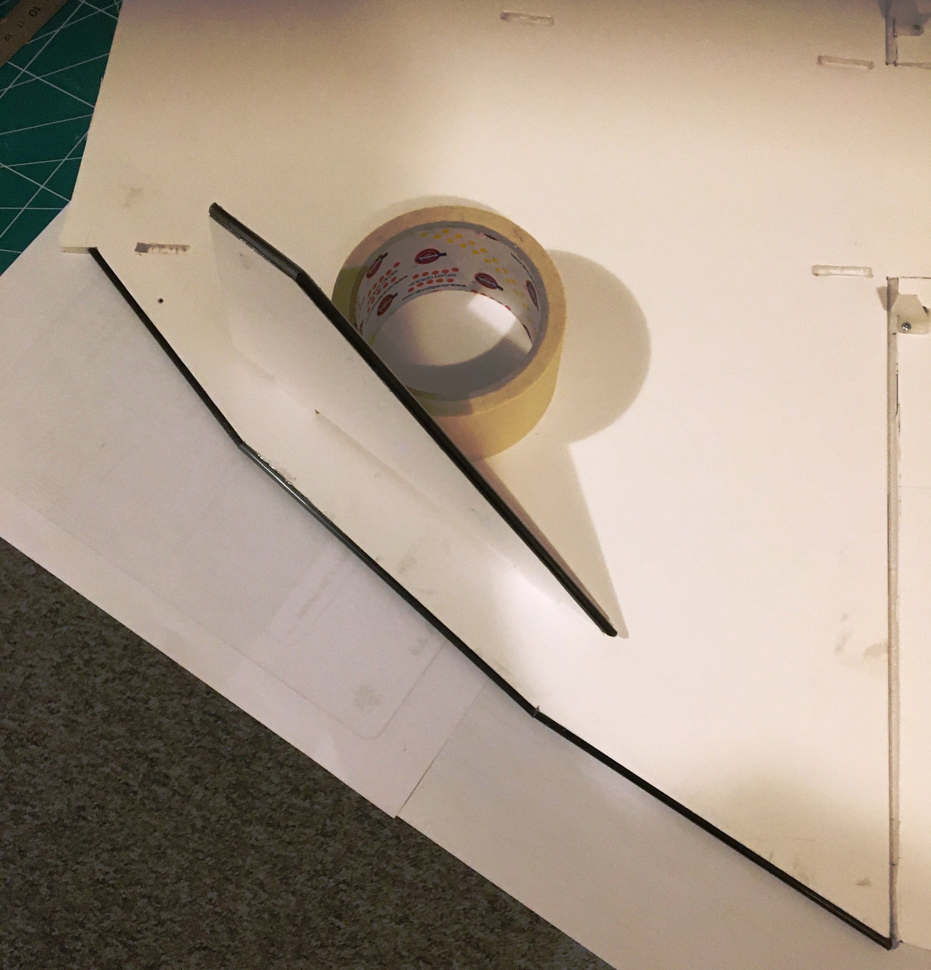

Replied by Klipkopwildlife on topic FT Saab Viggen 70 mm EDF.
I would be tempted to take a 5mm chain saw file, file out the leading edge to a concave half round and glue in a 5mm dowel if it's not going to be too heavy?
10 Dec 2020 10:05 #18 by crash happy
Replied by crash happy on topic FT Saab Viggen 70 mm EDF.
That's an idea Klippy. I don't think a bit of extra weight would be a problem. The estimated all up weight is 875 grams. The Fan I have ordered produces 887 grams on 3s & 1,435 grams on 4s, static thrust. I have found a shop that has pre- shaped leading edge balsa, but I would have to order quite a few lengths to justify the postage ! I will see if I can find something local, if not weigh up the alternatives. :)

Replied by paul d on topic FT Saab Viggen 70 mm EDF.
Just use a piece of softwood ( pine etc) .

10 Dec 2020 10:17 #20 by crash happy
That would be an easy solution if it would do the job. I can buy 5 mm bead locally.
5mm Pine dowel rod is readily available in most hardware stores.

Replied by supertigrefan on topic FT Saab Viggen 70 mm EDF.
A combination and refinement of Klippy and Pauls' suggestions would be to file or cut a vee in the leading edge, glue a square section of softwood on edge into that vee and sand to profile?

13 Dec 2020 19:05 #30 by crash happy
Made a start on the leading edges today. I went with Klippy's idea of sanding a U channel in the foam, but instead of using dowel or balsa I went with 4 mm carbon tube epoxied in. nice & strong but still light weight. I didn't quite have enough, so I will pop over my mates tomorrow & nick a length of his ! ;)
