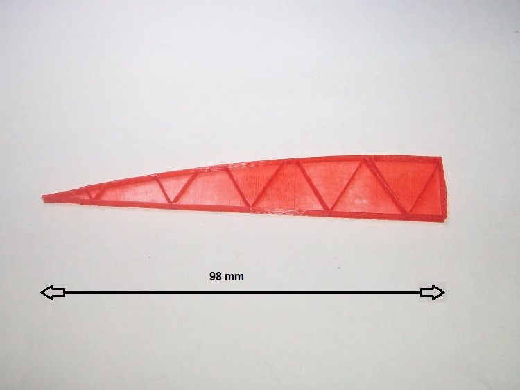

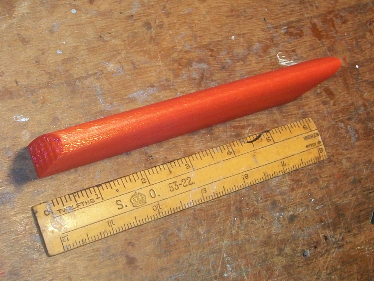

Not quite the same technique but I have printed all the parts for a wing.
The leading edge box spar showing its shape.
It actually printed with the spar face on the bed so the filament direction was along the wing like this.
Bed size limitations meant the complete wing was made up of 3 sections.
The rear part of the ribs were printed
And were glued onto the rear face of the box spar
The complete wing assembled. The centre section included a dihedral angle.
The rear of the wing was tissue covered.
My concern was that the printed material is relatively heavy for its strength so I tried to arrange it was only used where its weight had the least penalty although the end result was still 20% heavier than a thin sheet Depron covered wing with a conventional spar.
