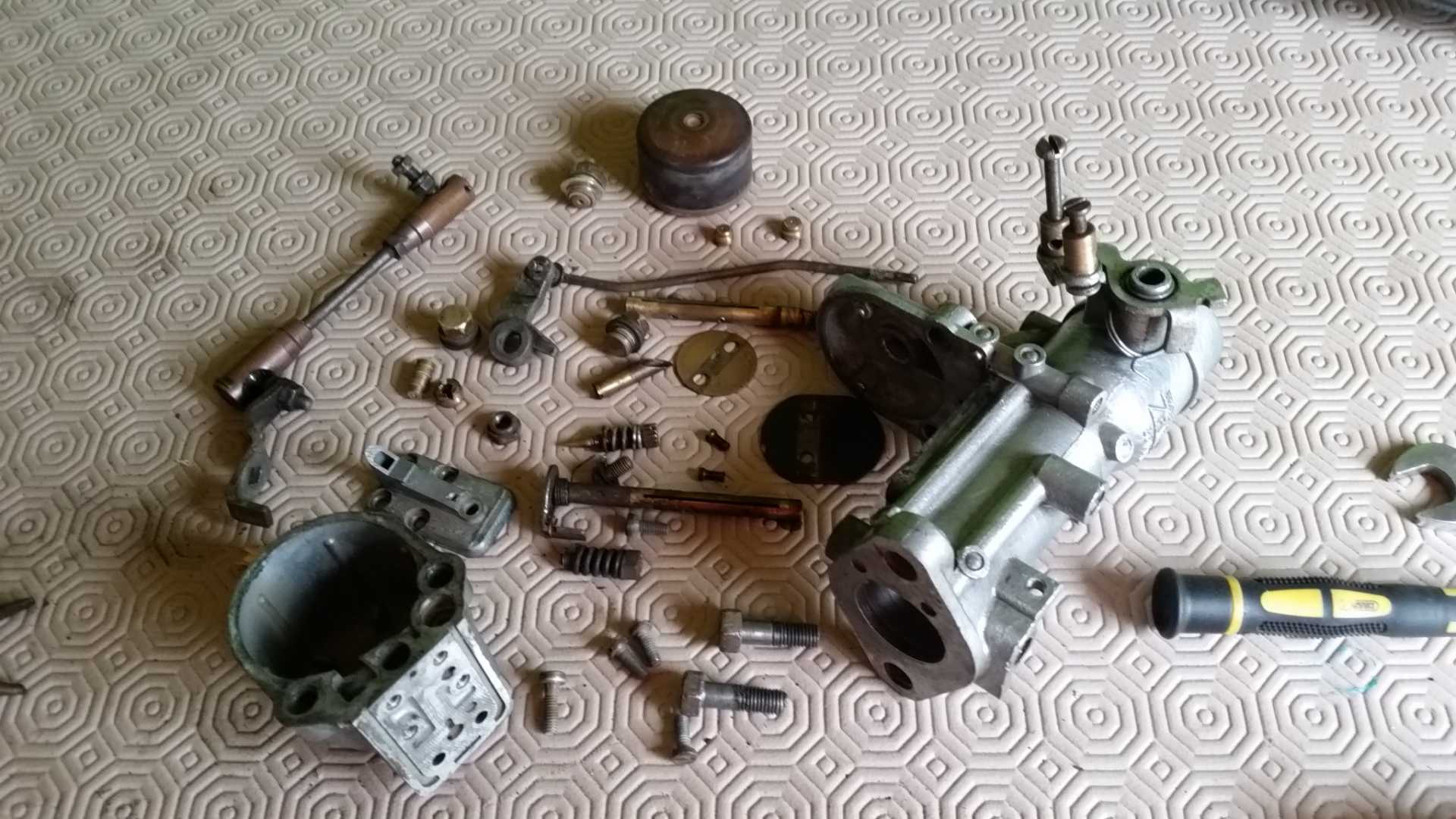

29 Jul 2016 17:21 #131 by boz
Replied by boz on topic AUSTIN A35 1957 MODEL
Carb is now stripped down, it soaking in thinners until Saturday morning
Thanks for looking, boz

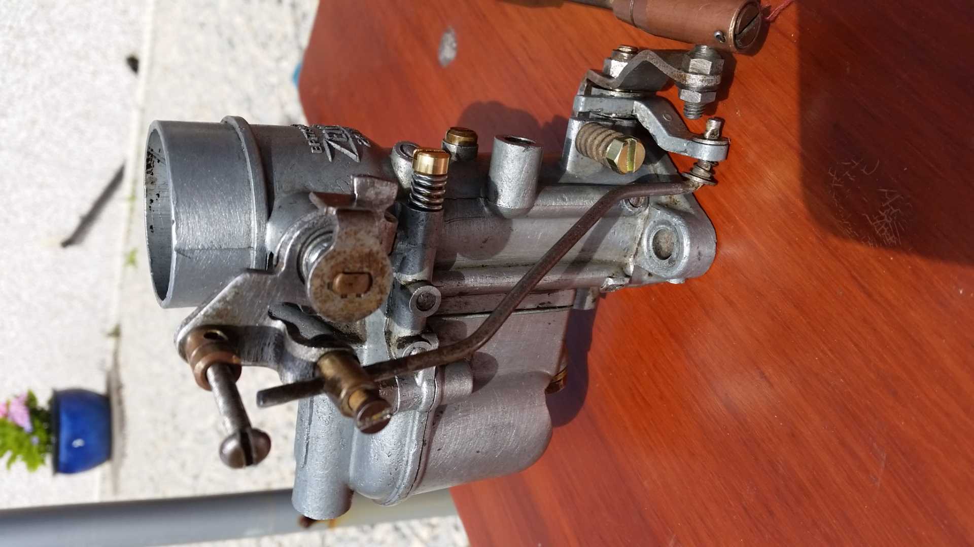

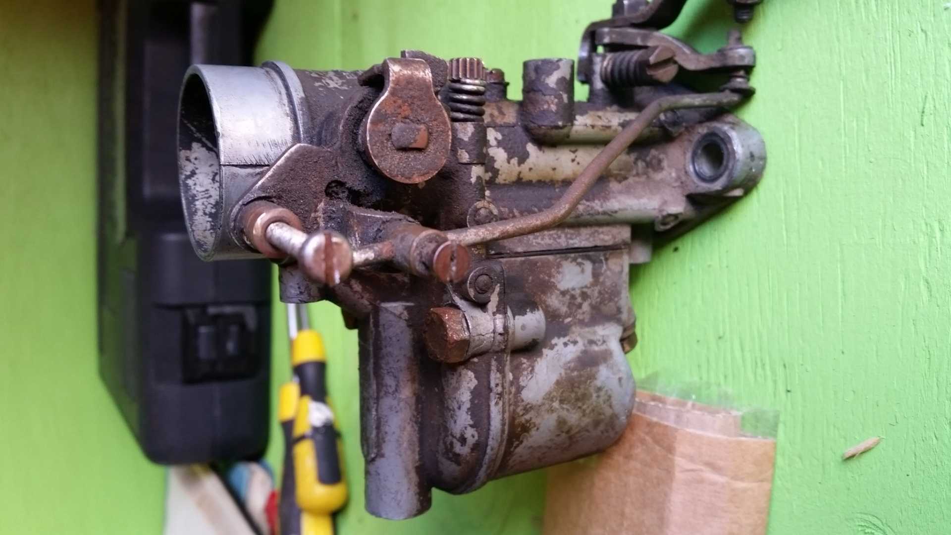

30 Jul 2016 12:19 #134 by boz
Well boys and girls, cleaned up the carb after 12 hours soaking in thinners, then fitted the new service kit.
Then gave the whole thing another good clean, it's now gone from this,
To this
The new fuel filter has not arrived as yet so hopefully soon, I will have to set it up when fitted mixture etc etc.
Thanks for looking and keep the comments coming along with the advice, it's all very much appreciated, boz
30 Jul 2016 15:12 #135 by one tenor
Replied by one tenor on topic AUSTIN A35 1957 MODEL
Hi Boz , glad you are pleased with the result. Said it would Thinners is a magic fluid .Now oil all the linkages and pivots etc.
