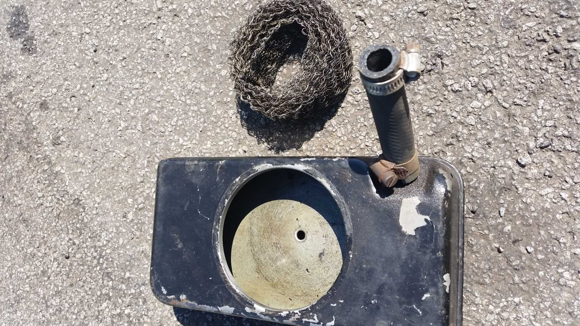

Then I replaced the air filter assembly, I say that in the most loose terms as you can see from picture it is very basic compared to today's expensive systems

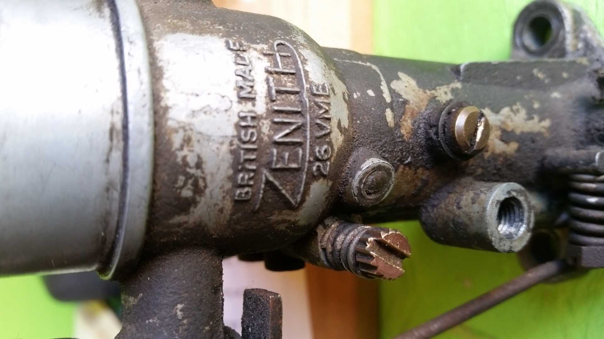

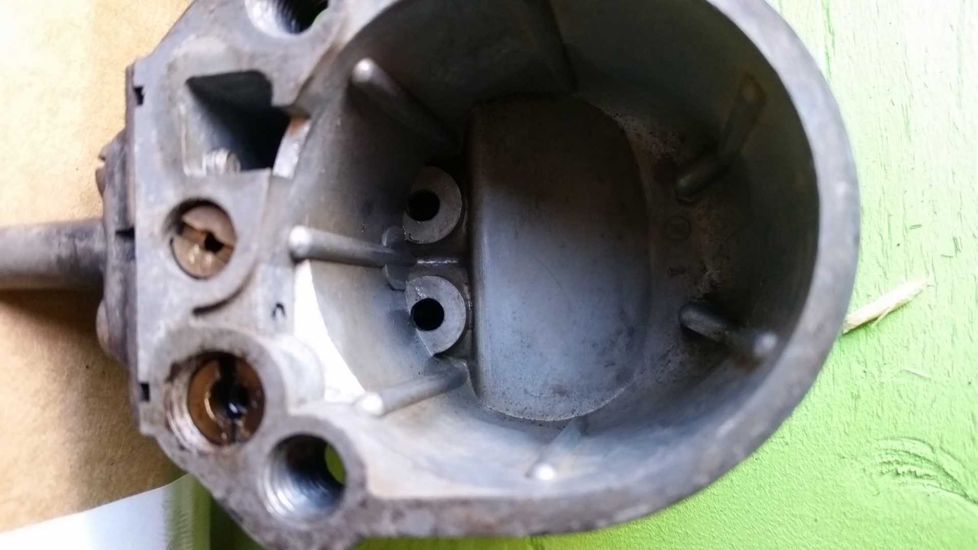

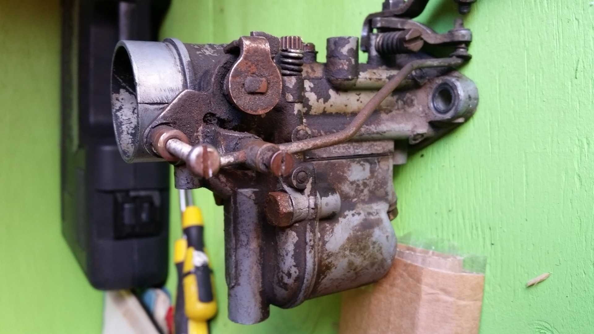

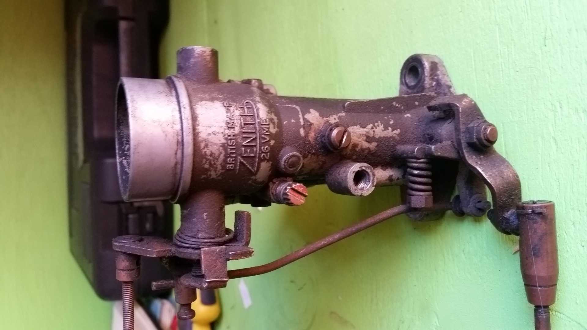

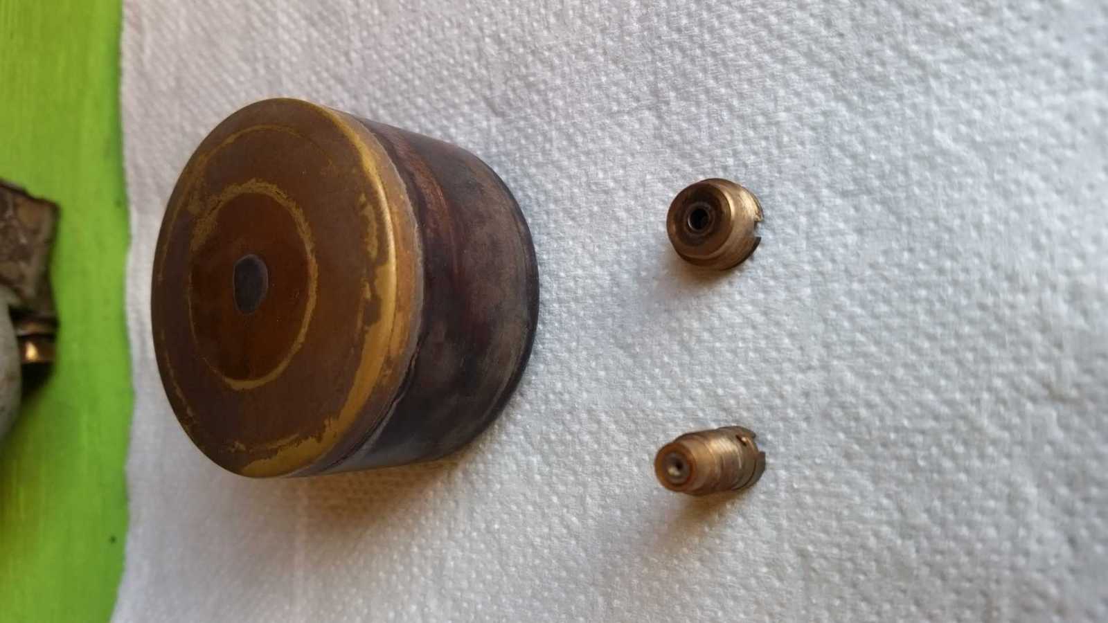

I took the carb off this evening, and the first thing g I noticed was that the advance/retard vacuum pipe was only finger tight
Anyway removed carb
I didn't want to do too much to it as I'm still hoping to use it for work until my jeep gets back from main dealers after putting wrong fuel in it.
So just did a very basic check on it,
I cleaned what I could for now, and will do a complete strip down later
I don't have the gasket set yet so hope it don't Leake
Will let you know tomorrow.
Thanks John for your help and very detailed post, hope you enjoy the pics , thanks for looking boz

Ok Boz that looks to be sound and clean. i.e. none of the horrible white corrosion inside The original gasket looks sound so put the whole top with gasket into a bowl of warm ( not hot ) water for a couple of minutes.This softens the gasket a little to make a good seal when replacing the top.Smear a /LITTLE./ vaseline on it to help the gasket spread. The float and jets look ok from what I can see,I would have liked to see the float needle tip though.I suspect it is worn and not air / petrol tight which is why the fuel runs back overnight to the pump.Please get the poor thing into a bowl of thinners with a lid on and leave for a while then use a stiff brush like a toothbrush to shift the crud. You'll be surprised how well it comes up. The loose coupling you mentioned certainly wouldn't help. A couple of turns of PTFE tape round the olive / flair will help sealing without needing to overtighten the unions on any connexion when reassembling..Good luck. Any. q's just ask
P.S. please check very very carefully for leaks round all of the joints when full again. Don't want you going up in flames

Thanks John, can get the repair kit for about £26 from zenith so will get that underway if there are any probs when I put it back on car, is the float needle the thing that lives above the float, that cuts the fuel off when the float pushes up to it?, if so will post a pic later.
