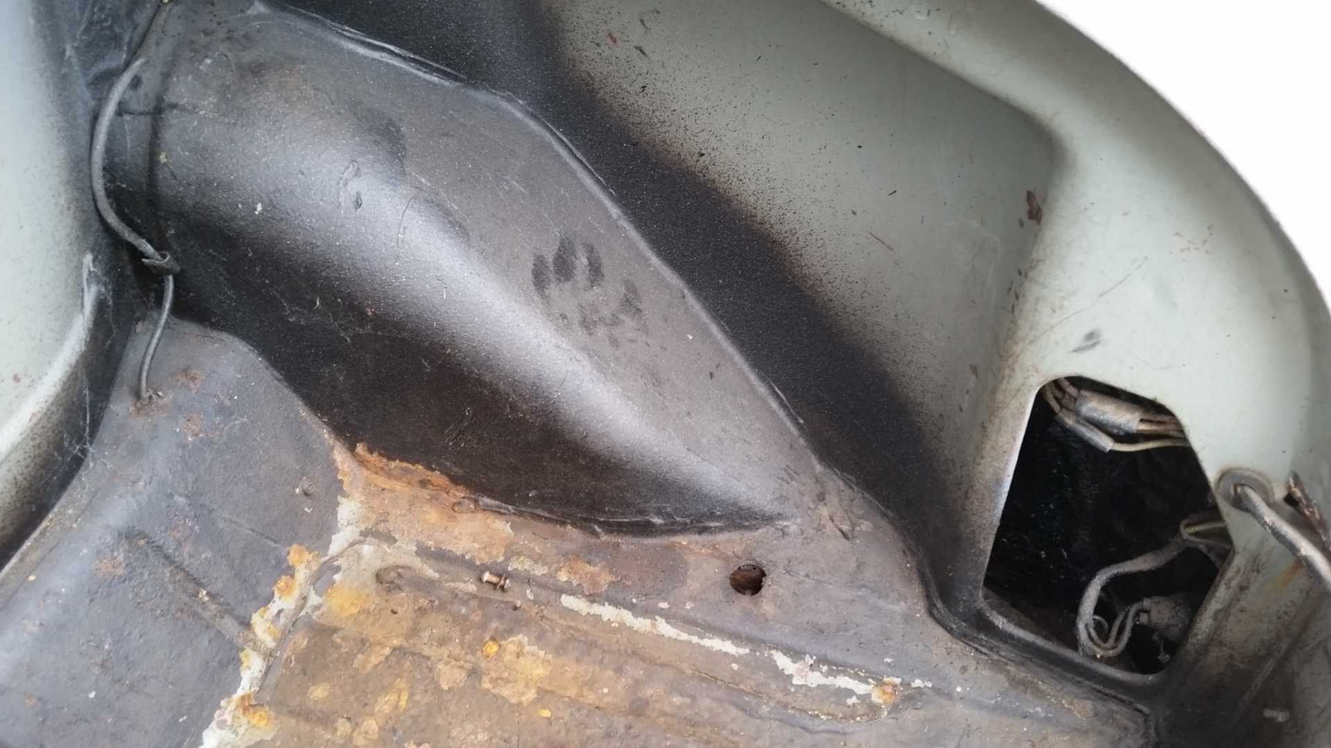

09 Jul 2016 17:58 - 09 Jul 2016 20:11 #67 by boz
Replied by boz on topic AUSTIN A35 1957 MODEL
Just a few more pics.
when I get a work plan will post in a better order, I'm only the 4th owner, and the man before me had it 5 years, I'm fairly sure the milage is correct, as I'm going to be stripping and rebuilding the engine I'm not so concerned, it's what's under the re sprayed bodywork that I'm concerned about.
Glad there is plenty of interest in my project, all advice is welcome.
And if anyone has a good idea where to start please post, I can then see what you all think, thanks for looking, boz

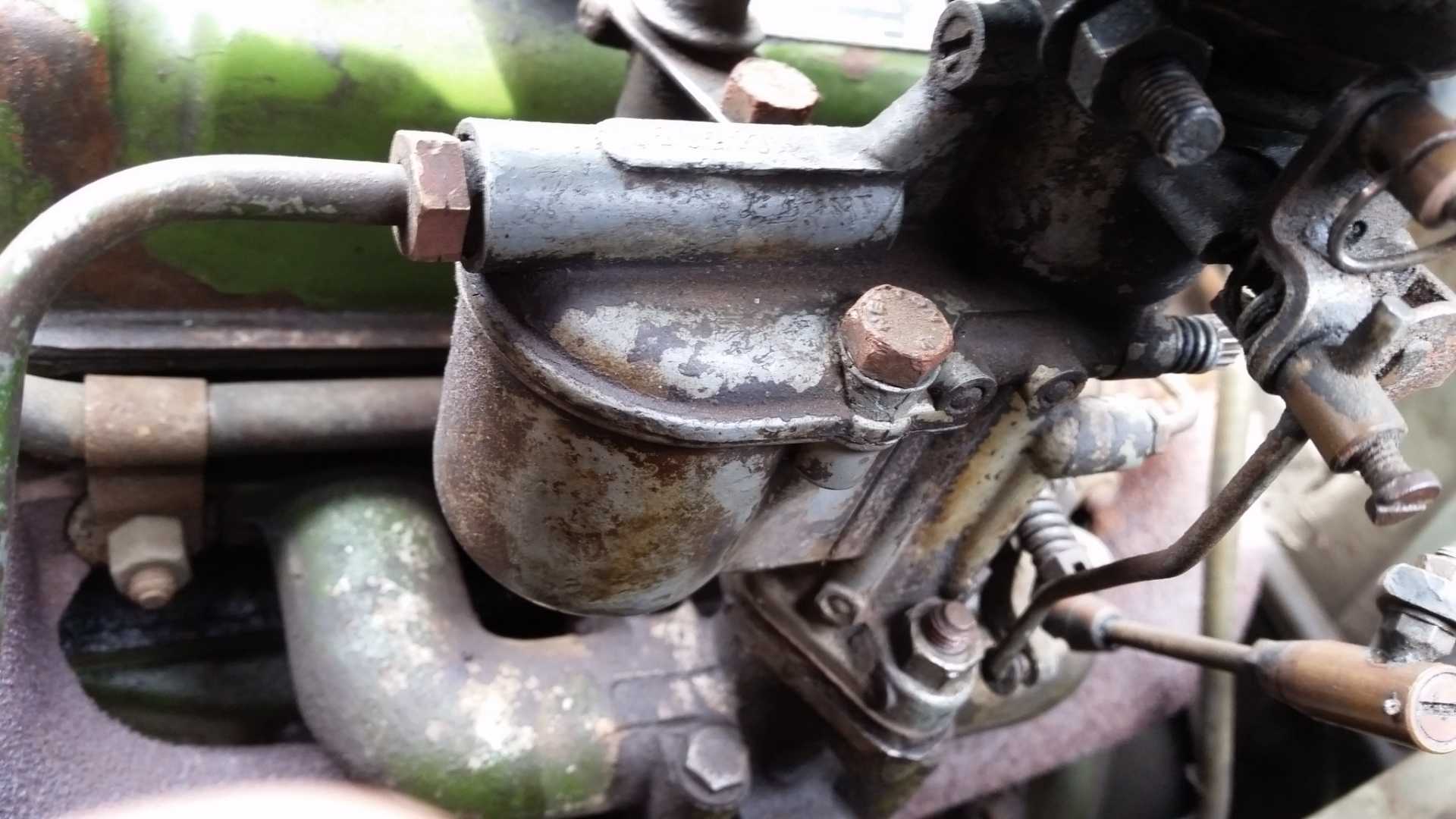

09 Jul 2016 22:50 #69 by Andrew Darby
Replied by Andrew Darby on topic AUSTIN A35 1957 MODEL
Hi,
I really can't remember, it was 15 years ago. I know the local garage to me in Borrowash (near Derby) will do the work, as I went to school with one of the blokes that works there and he still does the MOT on the Midget. I suspect it was less than £100 to do the work plus the cost of the guides and seats. I contemplated doing the work on the Bridgeport at work, but bottled it!
What I did do on the old Bridgeport was re-bush the spindle bushes on the SU carbs. I think yours as the old Zenith downdraught carbs though, less efficient but a simpler design...

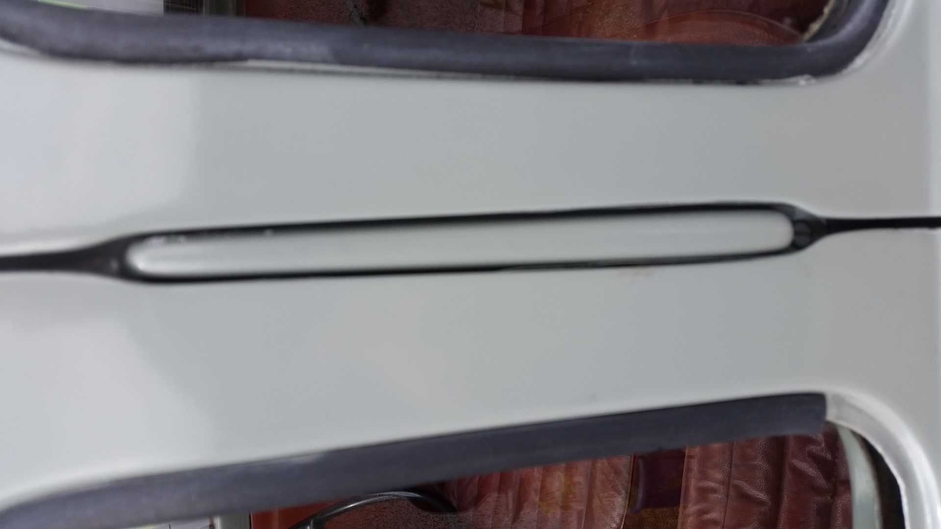

09 Jul 2016 22:55 #70 by Quorneng
Replied by Quorneng on topic AUSTIN A35 1957 MODEL
That picture of the sills looks a bit suspicious.
My guess it has had new sills welded on the outside of the old ones. Never an ideal (or long life) solution.
  • boz
10 Jul 2016 08:25 #71 by boz
I agree q the sills both sides are the same, looks like they have been put over the old ones, there are other panels that don't look quite right, the shut lines along the bottom of doors is also questionable.

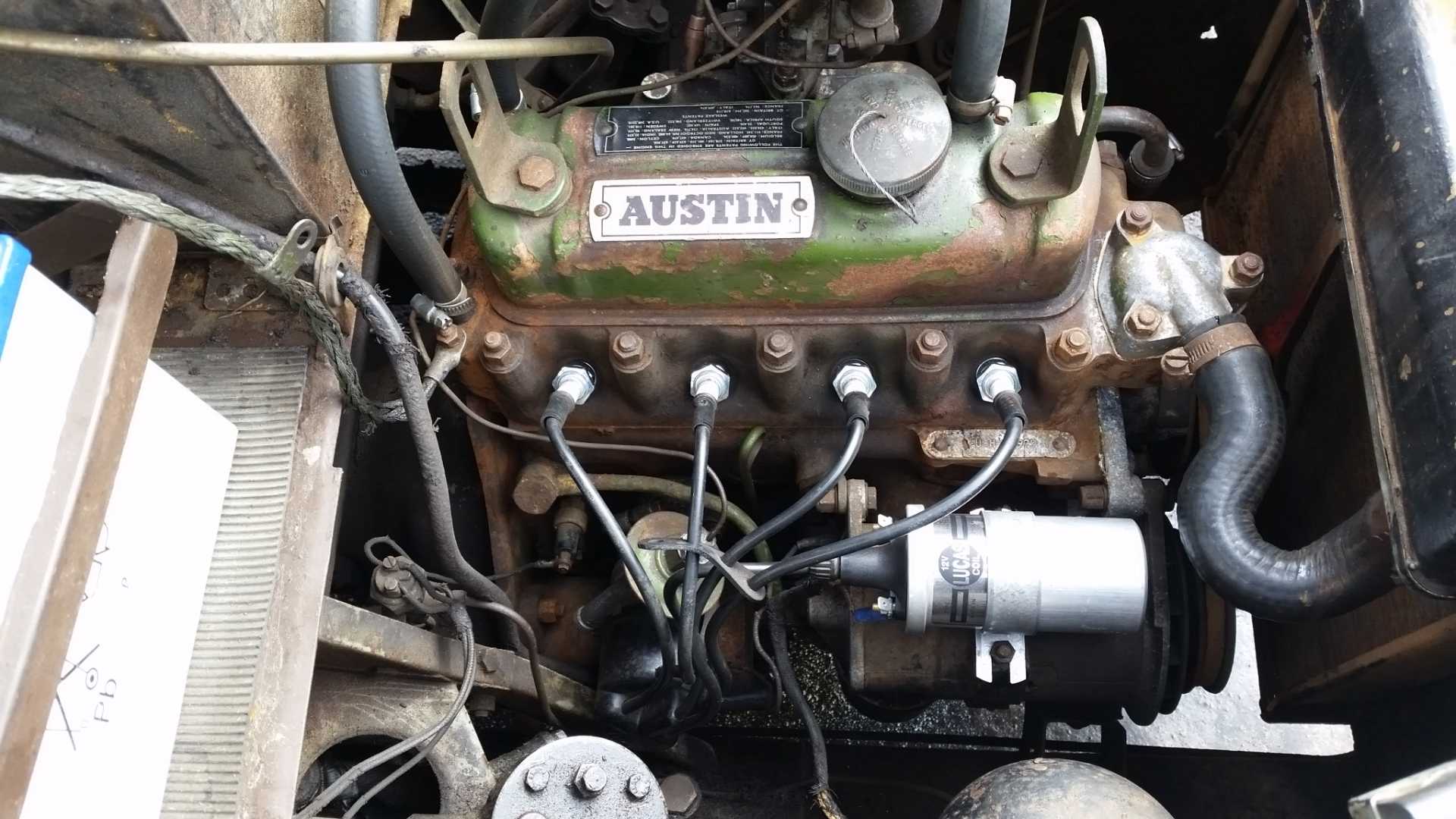

10 Jul 2016 09:11 #72 by Klipkopwildlife
Replied by Klipkopwildlife on topic AUSTIN A35 1957 MODEL
I see it's positive earth with dynamo. It depends how original you want to keep her but you may want to change over to an alternator with negative earth. (you'll have to reverse the coil connections as well)
Get yourself a large supply of zip lock bags in various sizes. When removing components, a tail light for instance, put all the parts into one bag with a piece of paper or card telling you what it is. Mark the outside of the bag as well but when you get back to it the outer marking is normally unreadable. What ever you do, do not put all the tail lights (for example) in one bag!
It's usually a good idea not to tackle more than one job at a time although if you're going to respray it's easier to do a bare body.
Remember only 1% of amateur restoration projects get completed, usually because the restorer attempted too much in one go.
