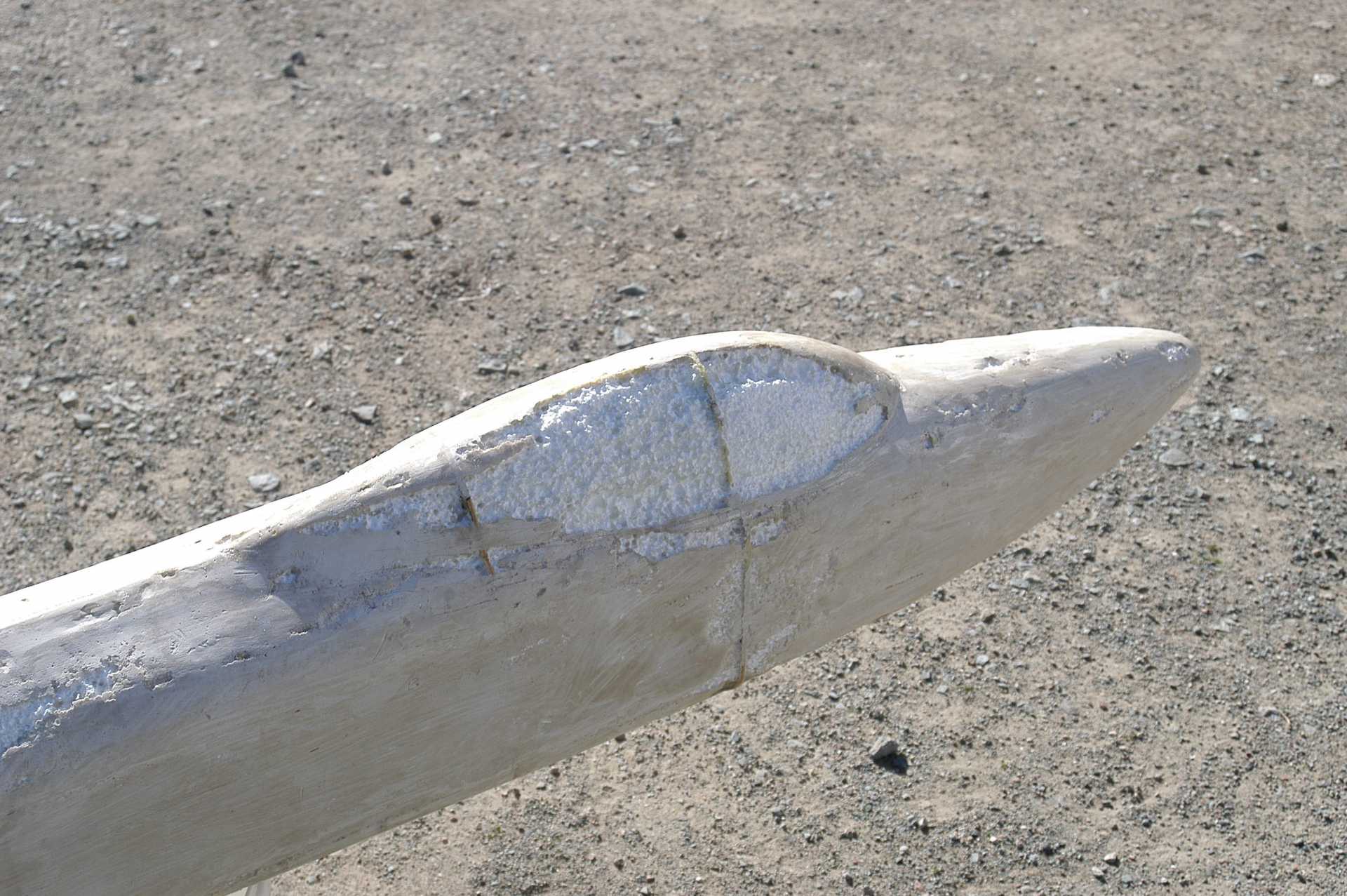

Ha Ha I did not think there was that much foam exposed :S

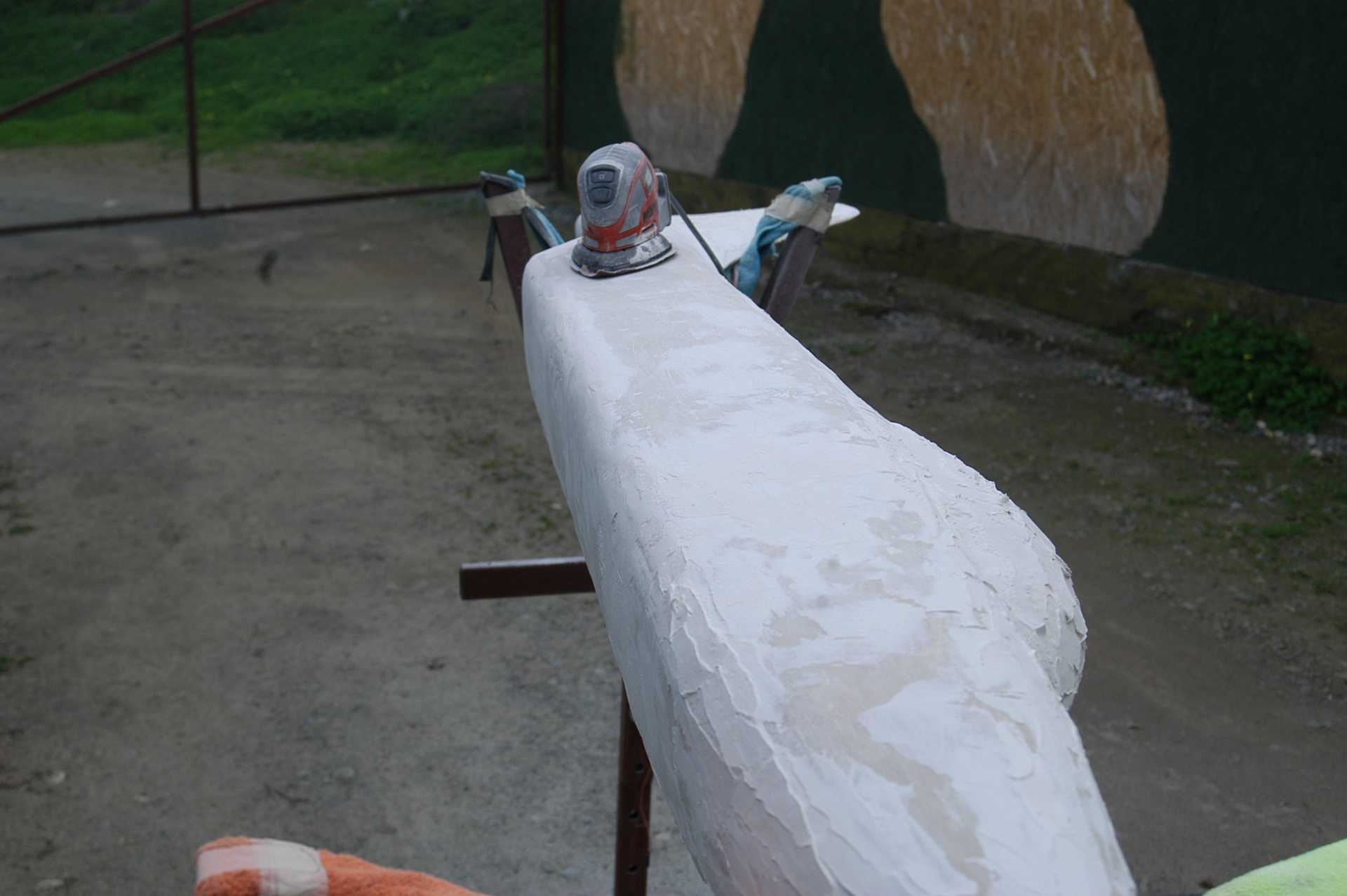

Anyway it stopped eating it, but the resin was still sticky this morning ( had this sticky problem last time I used it, that's why I stopped and stayed on epoxy ) so I took it out into the sun

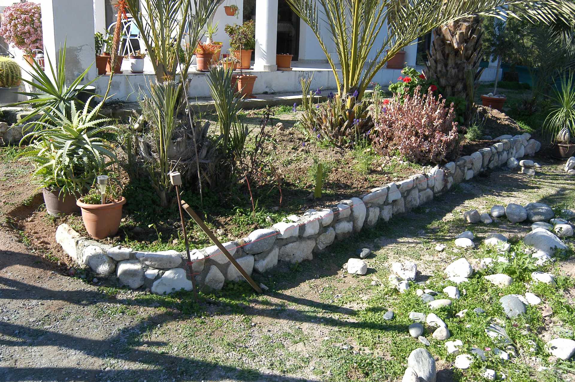

But did no modelling today as it was to cold out of the sun, so I did a bit more of my pebble ( that we pick off the beach ) wall
So in the morning I will buy another box of poly filler

29 Jan 2017 20:10 #47 by old fart
Replied by old fart on topic Own design and build sports turbine jet
Far better to start again using the correct materials. :unsure:
29 Jan 2017 21:21 - 29 Jan 2017 21:23 #48 by one tenor
Old Fart wrote: Far better to start again using the correct materials. :unsure:
OR glue on some 3/5 mm Depron on the bare patches and sand to blend and use light weight filler to finally blend in

29 Jan 2017 23:49 #49 by old fart
That would just be trying to improve on an already bad job.
30 Jan 2017 02:16 #50 by Quorneng
Replied by Quorneng on topic Own design and build sports turbine jet
Only polyurethane foam is safe with polyester resin. It used as the core in surf board. ;)
30 Jan 2017 06:35 #51 by THE BLACKBIRD
Correct materials ? the problem started because I cannot get the blue foam, inexperience with what im doing led to the second problem
It will come good in the end I believe, it is the first one so im learning, that's my excuse anyway ;)

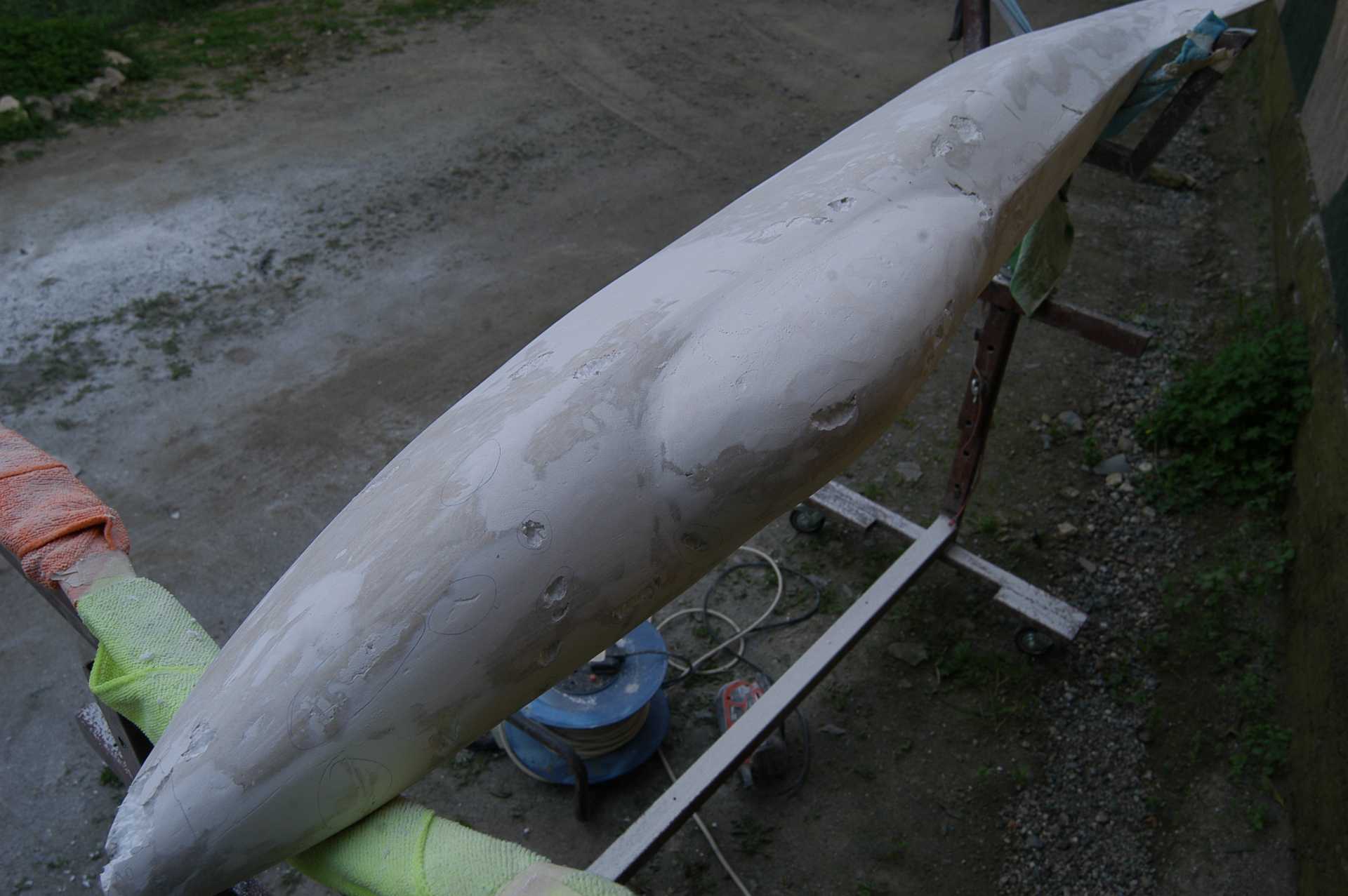

30 Jan 2017 17:28 #54 by THE BLACKBIRD

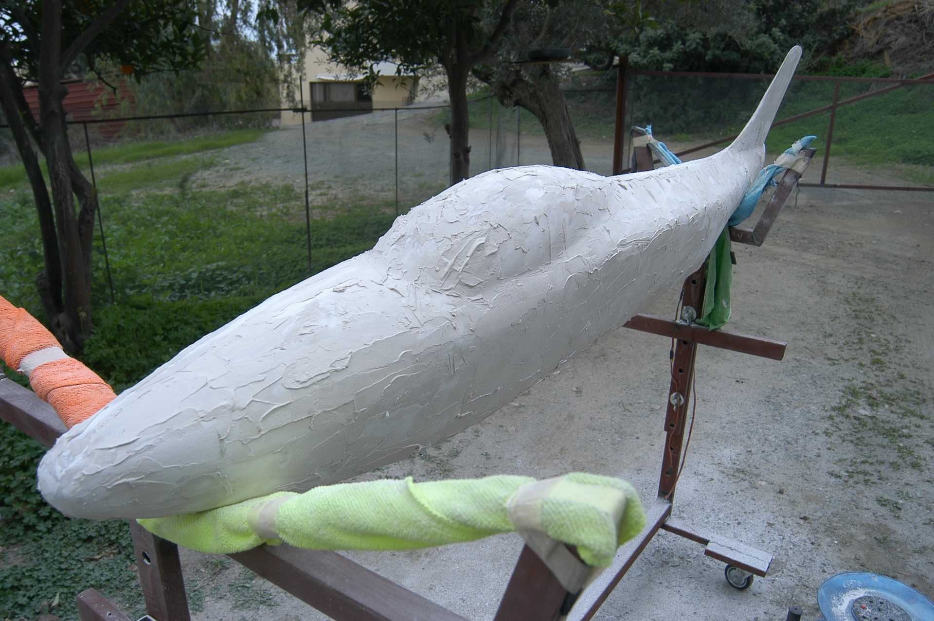

Again today it has been to cold outside and in the hanger
So all I have done is slapped another coat of filler all over it
When it drys I think I can then start to finish the plug :whistle:

31 Jan 2017 16:34 #55 by THE BLACKBIRD

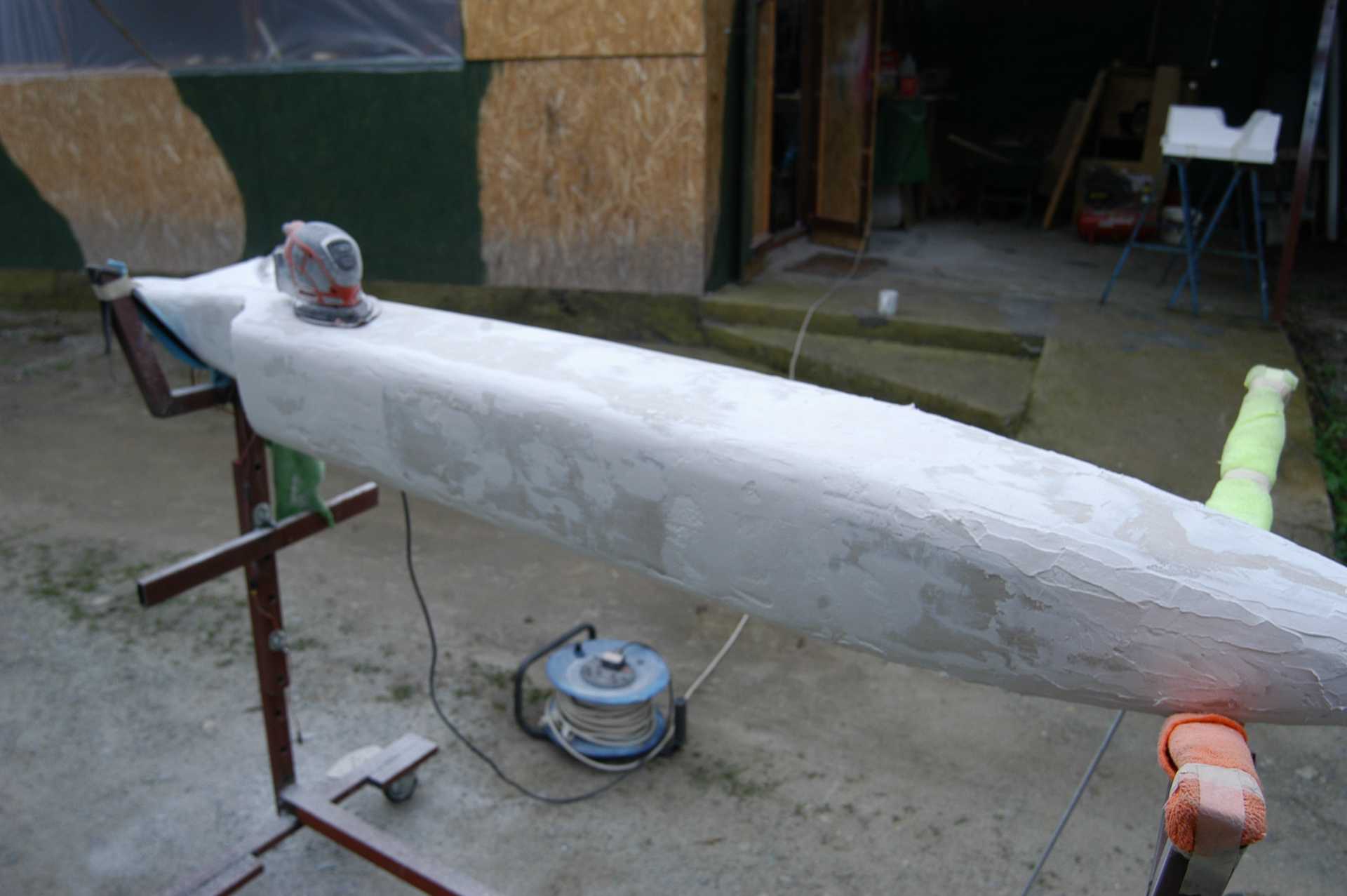

Got it sanded down today :)
It came out ok so now im up and running with it
I put another coat of filler on it so hopefully I can sand it again tomorrow and fill it again
Sand and fill until its good enough ( in my eyes ) :whistle:
Now im off to bed as I don't feel to good at all :sick:

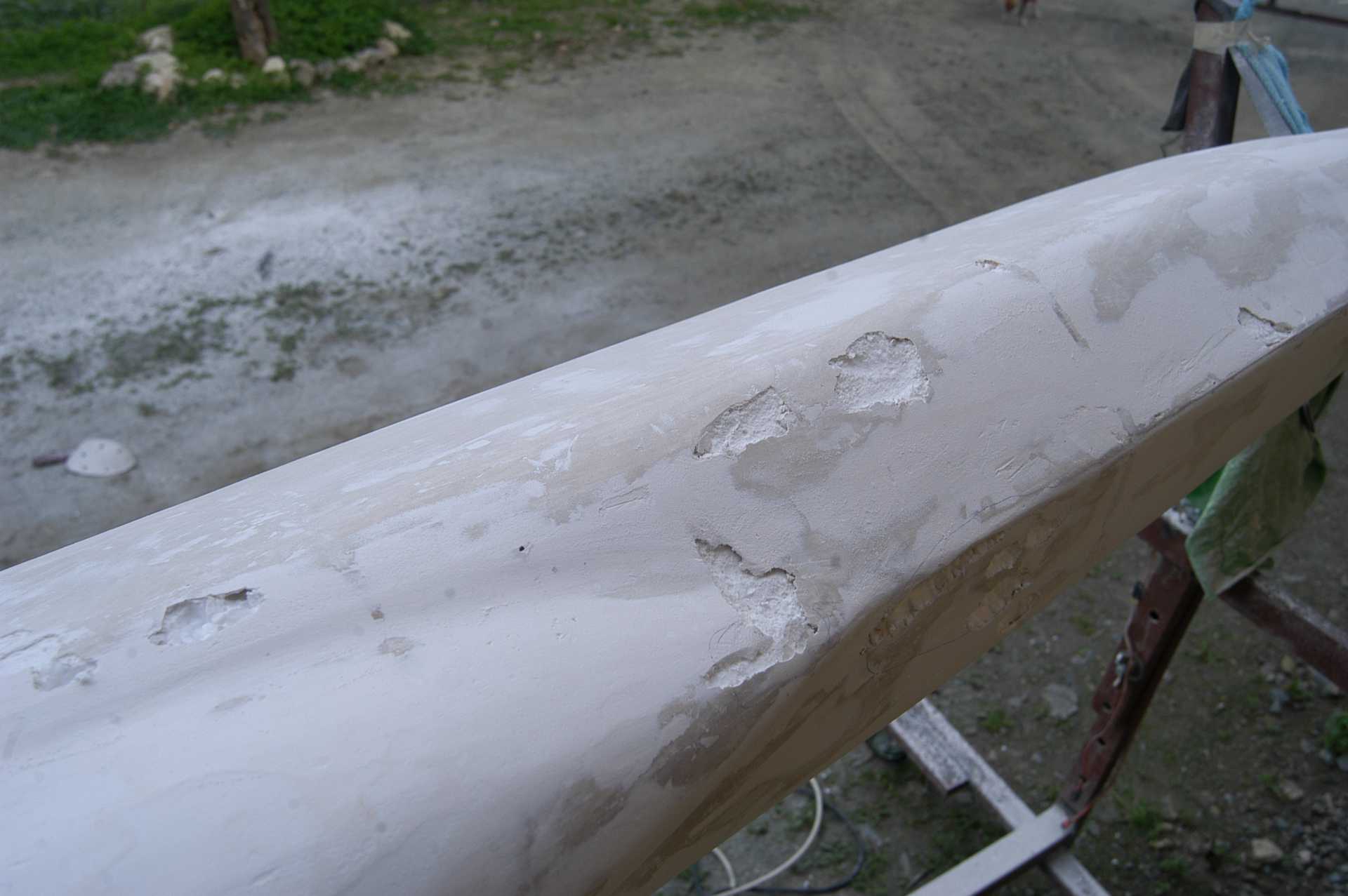

01 Feb 2017 18:35 #57 by THE BLACKBIRD

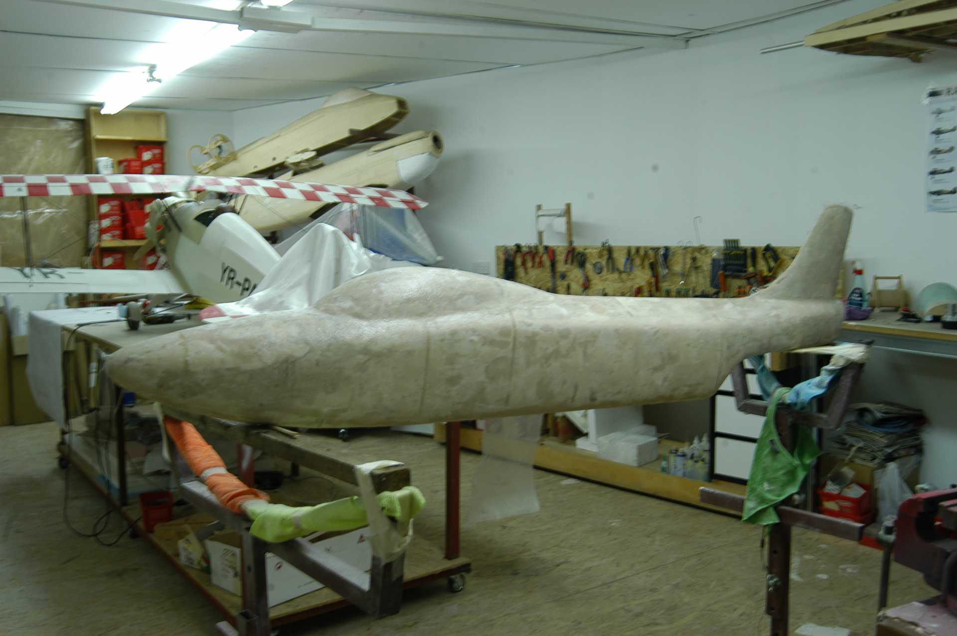

Sanded it down again today and it is coming together, but still getting some problems with this foam
so I dug out the remaining offending places and filled the in, will sand them off tomorrow then it will be ready for glassing

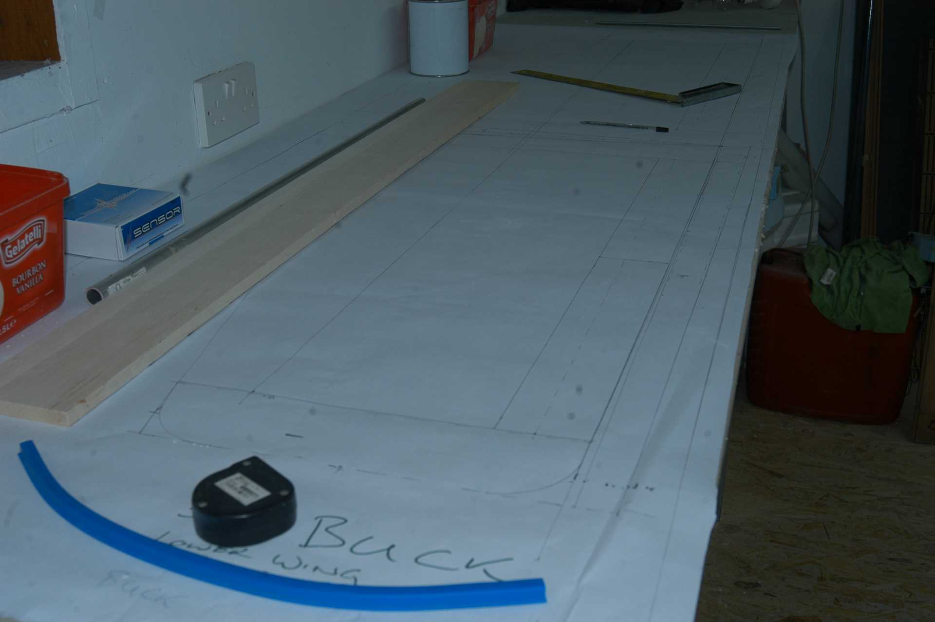

Did some drawing of the wings tonight but it was to cold to stay out there

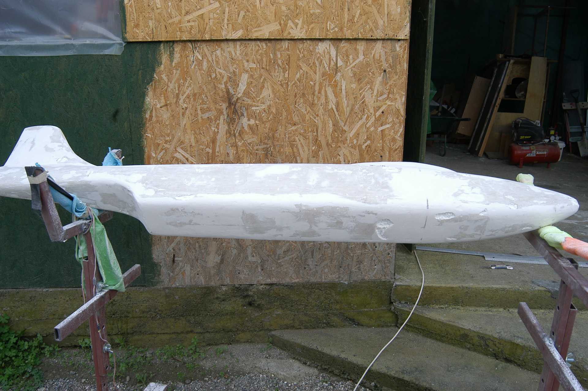

02 Feb 2017 18:41 #58 by THE BLACKBIRD
Sanded it down again this afternoon, then tonight I laid on the first layer of fibre glass cloth and resin
When its cured I will sand it down then put a second layer on

02 Feb 2017 21:50 #59 by Eric
Replied by Eric on topic Own design and build sports turbine jet
As you have glassed it all over, with no join - how do you intend getting the foam and plaster out?
Are you going to saw it in half with a band-saw, then glue it back together after hacking/chipping it out, and making hatches?
02 Feb 2017 23:55 #60 by Quorneng
Eric
I think what he is making is the 'plug'.
When finished, polished and treated with release agent the mould (in two halves) is laid up over it.
If all goes well and nothing sticks, the actual fuselage half is laid up inside the half mould to produce a half 'shell' that will have exactly the same outer surface as the plug.
A lot of work to produce the first fuselage but relatively easy to lay up more if required.
