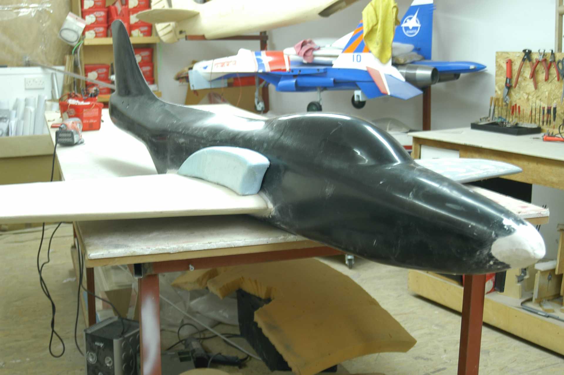

10 Mar 2017 19:02 #122 by THE BLACKBIRD
Seem to have been working on for a long time today and got nothing done :(
Sorted the out of square wings and faired the root ribs onto the fuselage and glassed them
Done some gardening and tried to sleep with no success :(
Thanks: Klipkopwildlife, Quorneng, old fart, Firewood

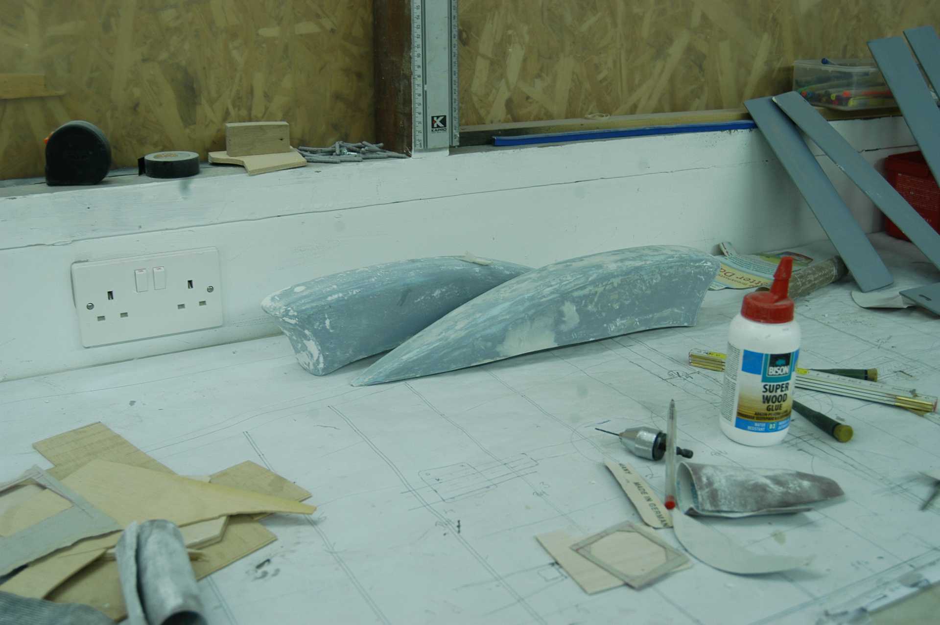

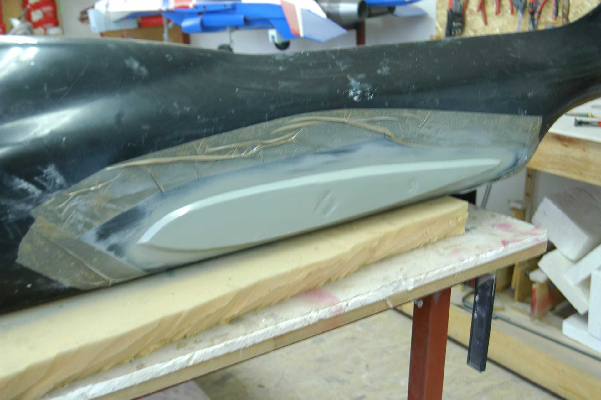

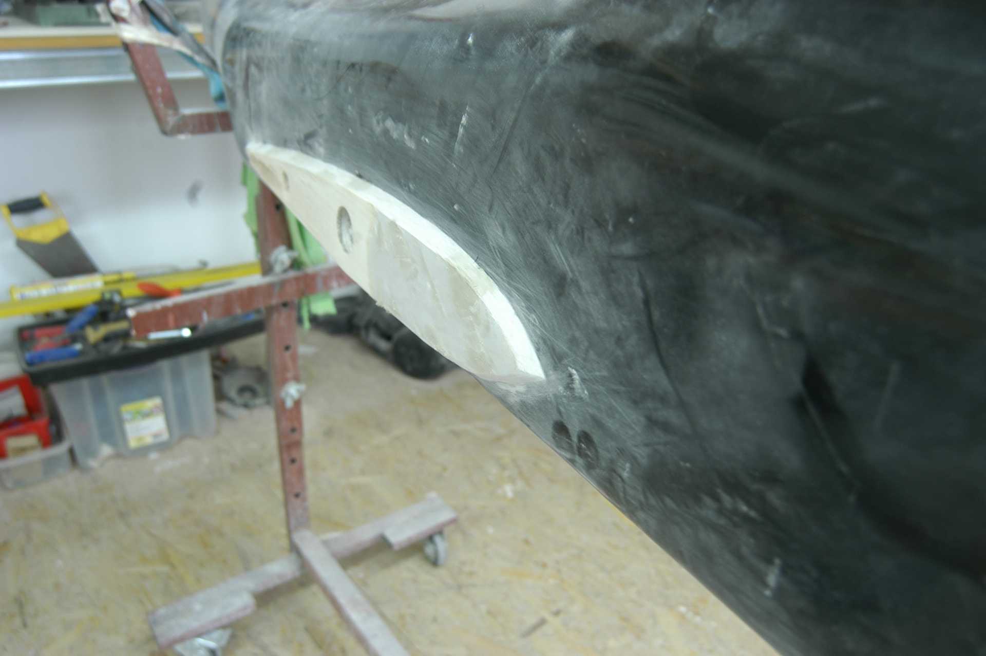

After spending quite some time on the wing roots, I glassed them last befor epacking in
This morning they were still tacky ?
Looked on the bench where I do the mixing and there was the measure of catalyst still in the measure :ohmy:
I had glassed it with resin only :evil: I can only blame the lack of sleep, :whistle:
That's my excuse and im sticking to it :)
Glassed the remaining parts today

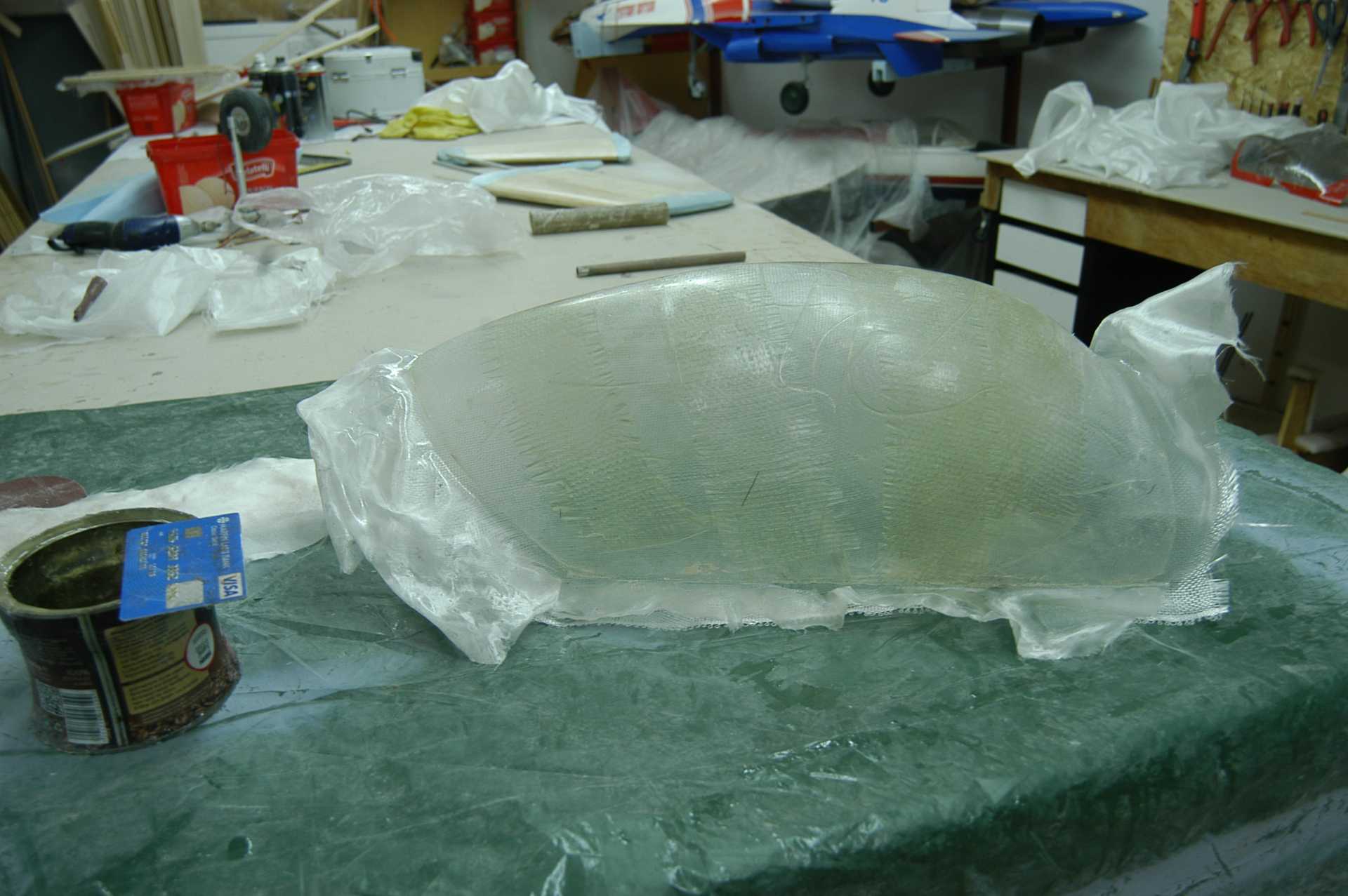

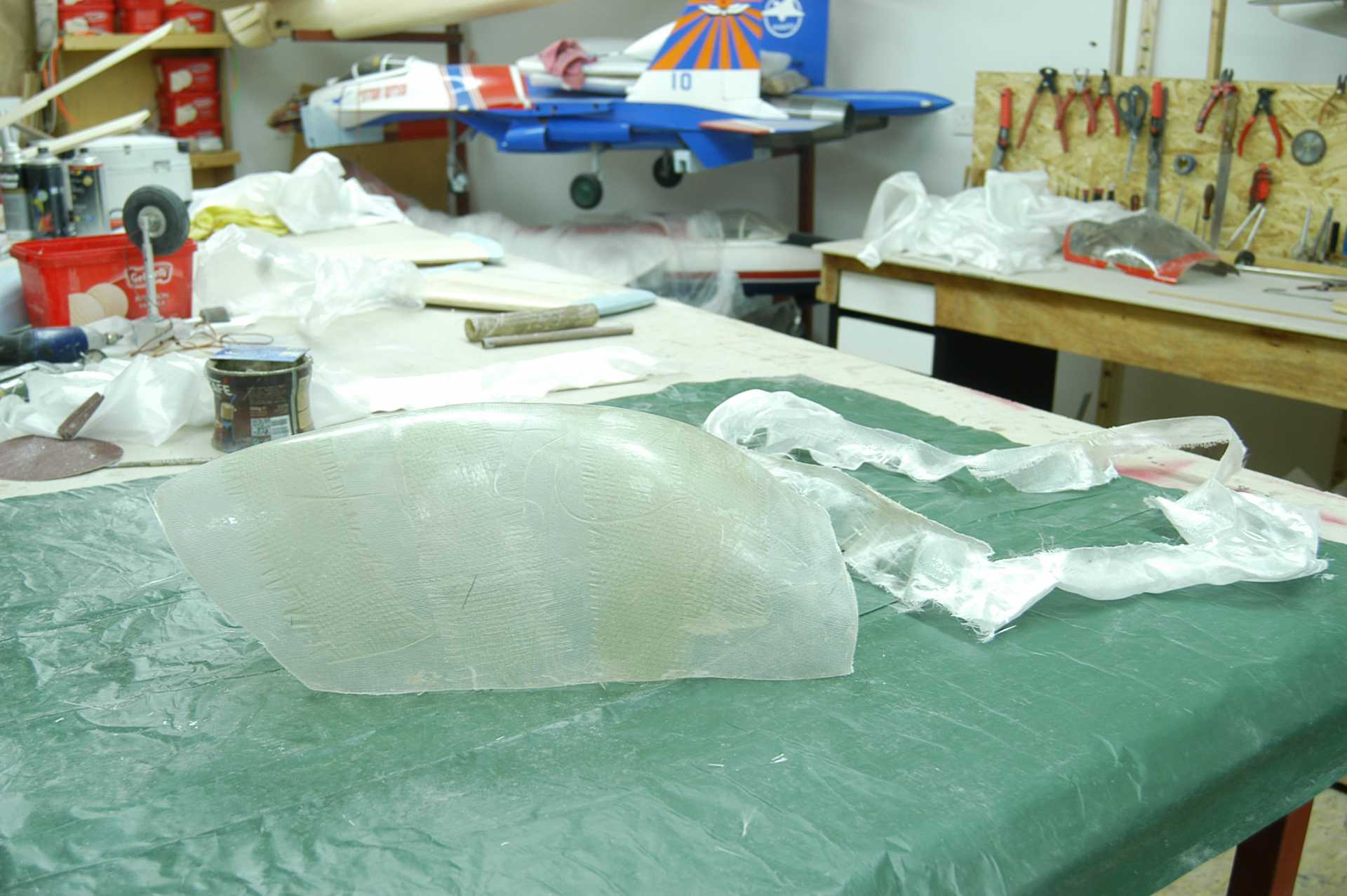

The canopy fr the revolver came out ok
Trimmed it up
And epoxied it in place
ill trim I later

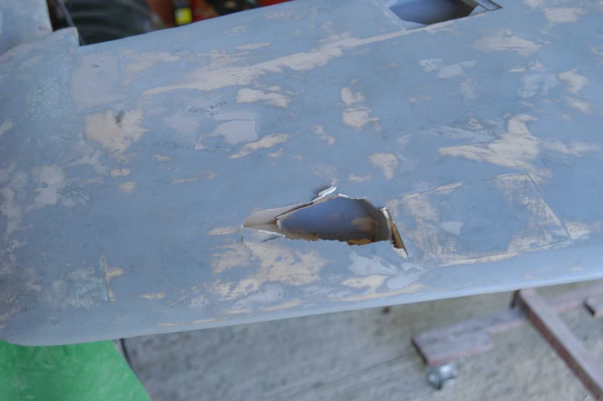

12 Mar 2017 20:42 #126 by THE BLACKBIRD
I spent nearly three hours this morning getting the resin and cloth off the root ribs on the fuselage, made a hell of a mess
sp got some filling and sanding to do, think iv been there before :S

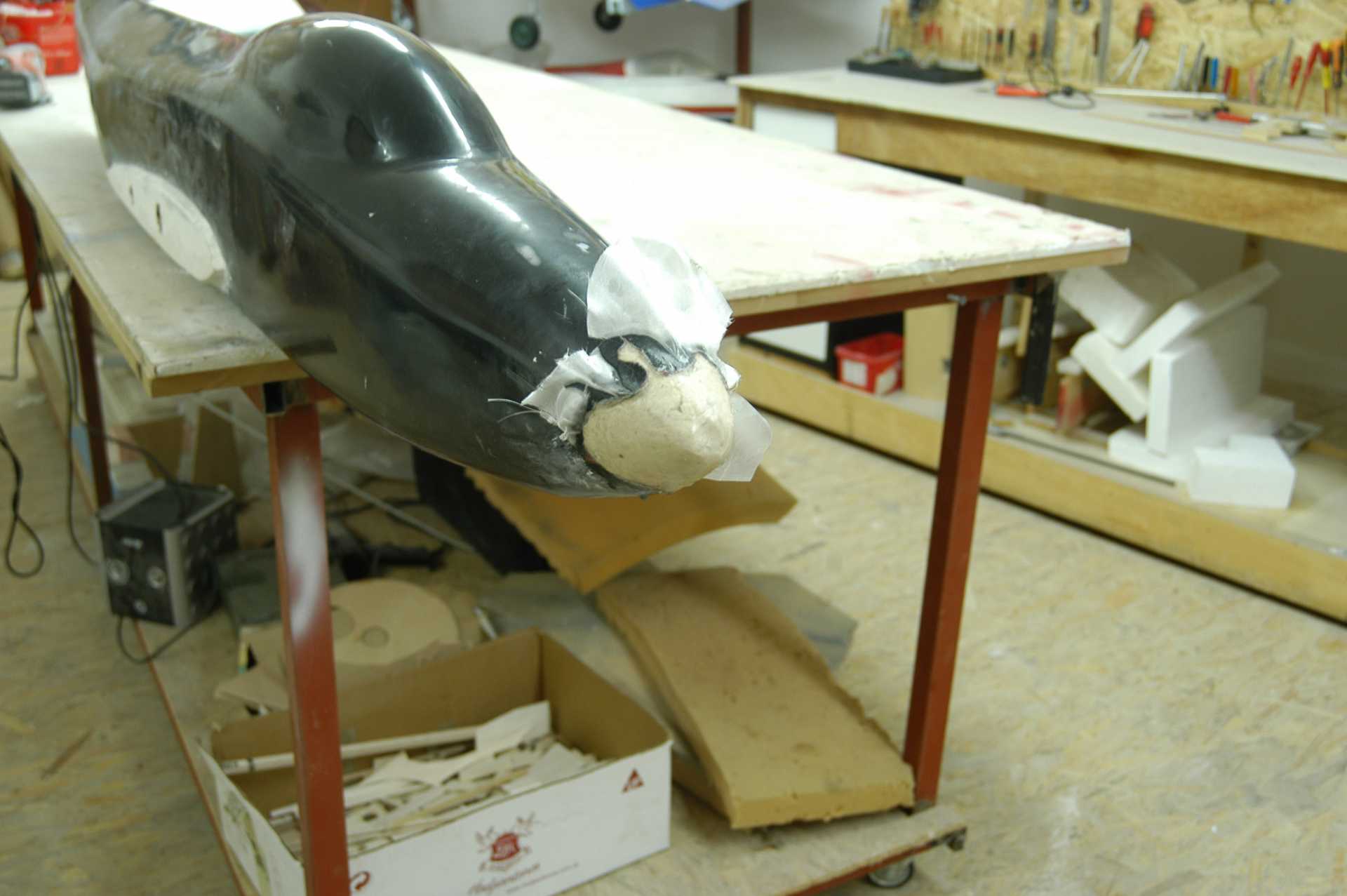

13 Mar 2017 19:48 #127 by THE BLACKBIRD
And so to todays disaster :S after filling the wing root on the fuselage I was sanding it with my small palm sander
and the front fell off the stand :ohmy:
So I packed in for the day :(
Thanks: Quorneng, old fart, boz, Firewood

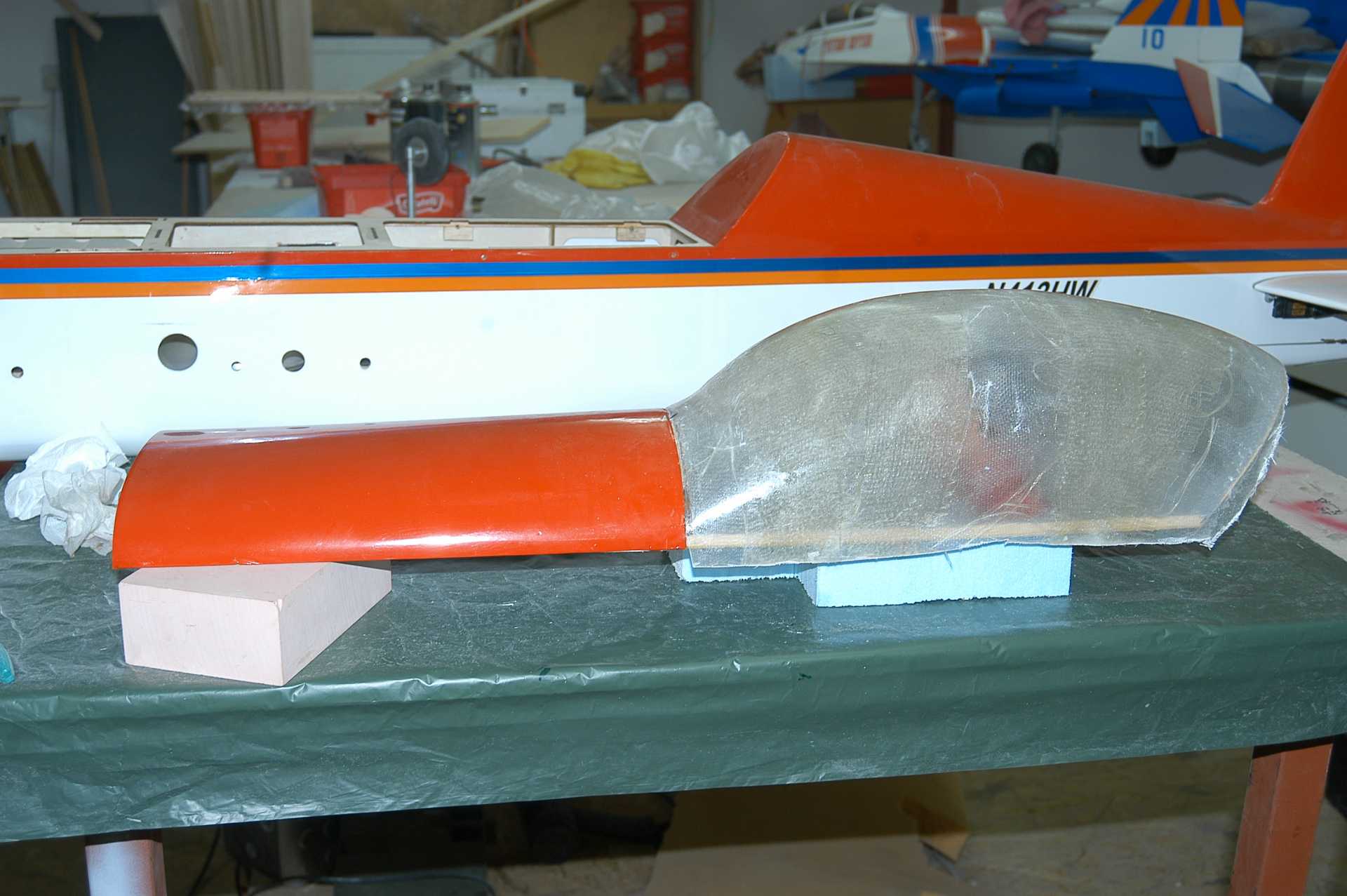

15 Mar 2017 20:47 #128 by THE BLACKBIRD
The wing root on the fuselage are about ready for glassing again and the new nose is taking shape, waiting for it to dry

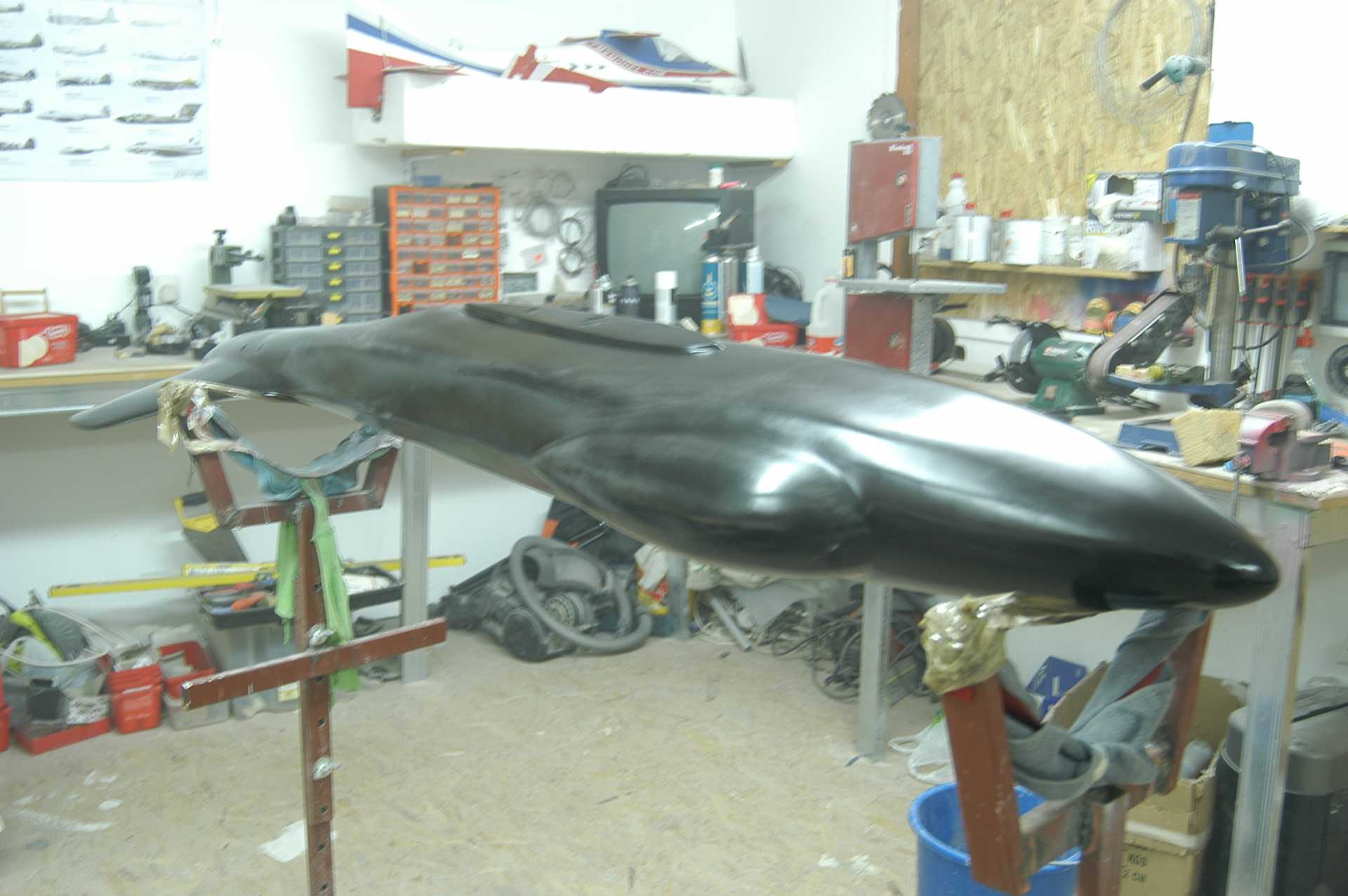

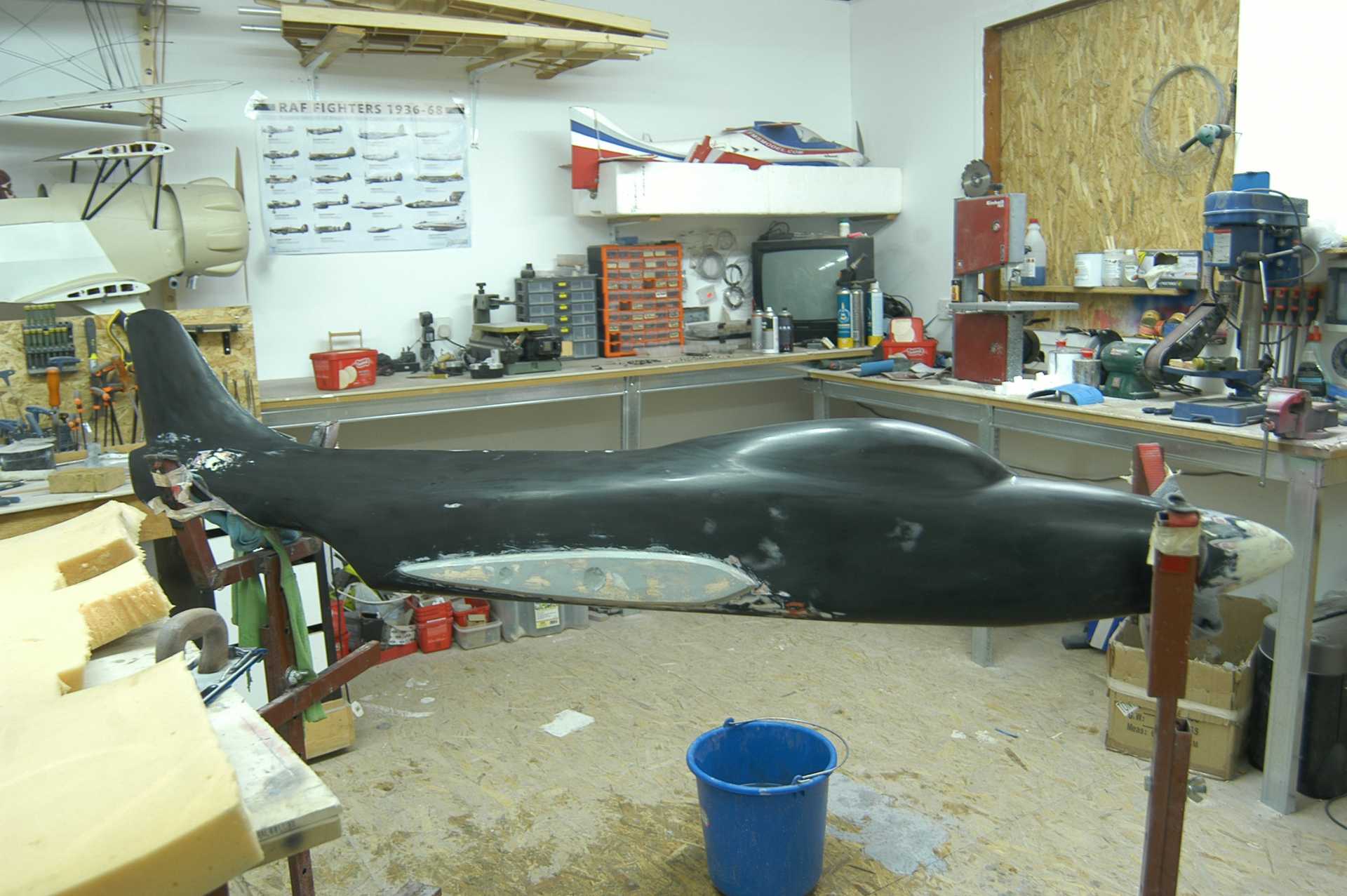

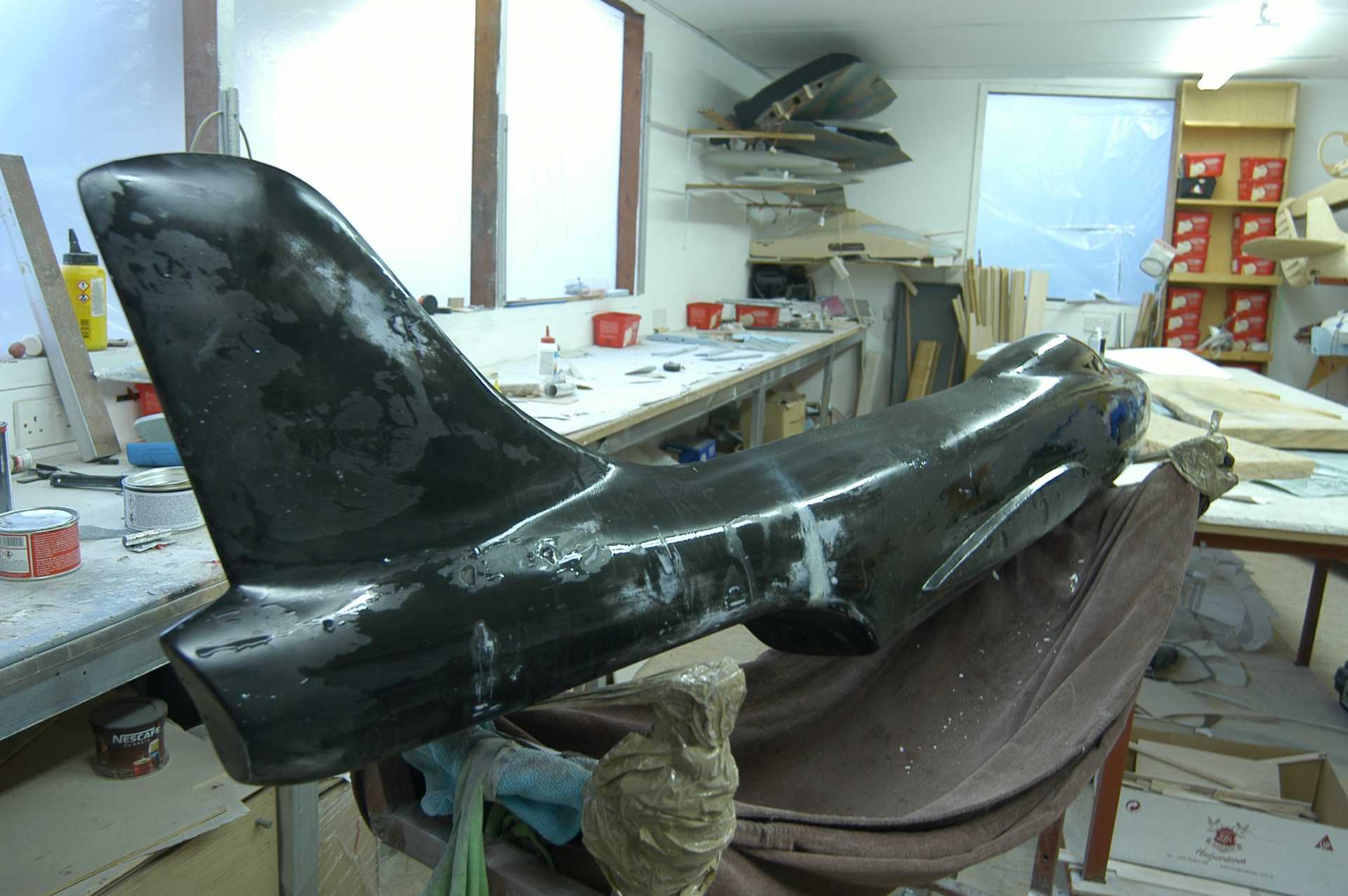

19 Mar 2017 20:34 #129 by THE BLACKBIRD
Had the new nose glassed
Today I have been filling and sanding it and the wing root on the fuselage
Stopped up the whole of the fuselage once more and gave it a good going over with 1000 wet & dry, ill give it a good clean up tomorrow and its ready for final painting :cheer:

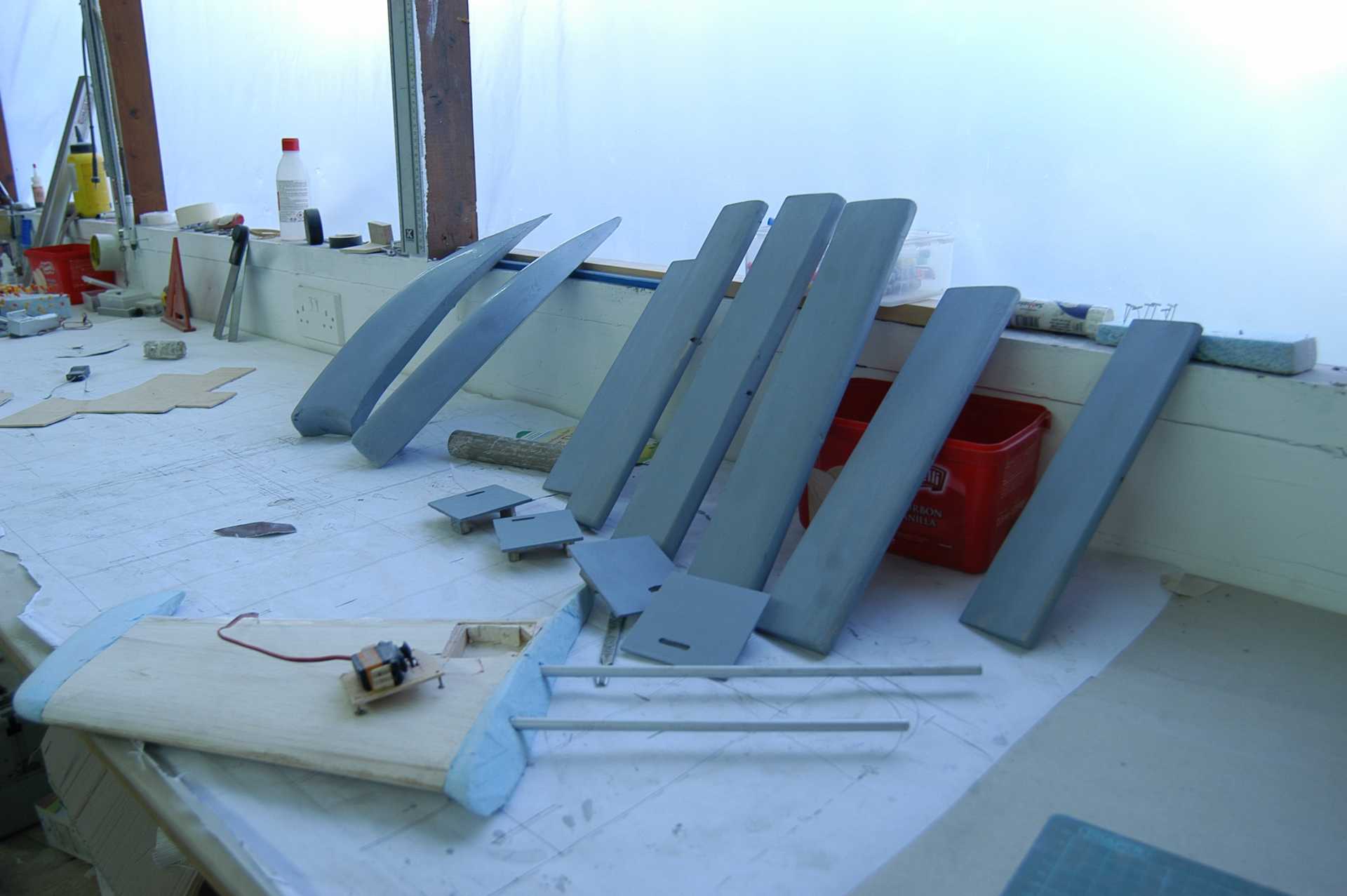

Got one of the elevator servos mounted
The rest of the bits and bobs glassed and primed

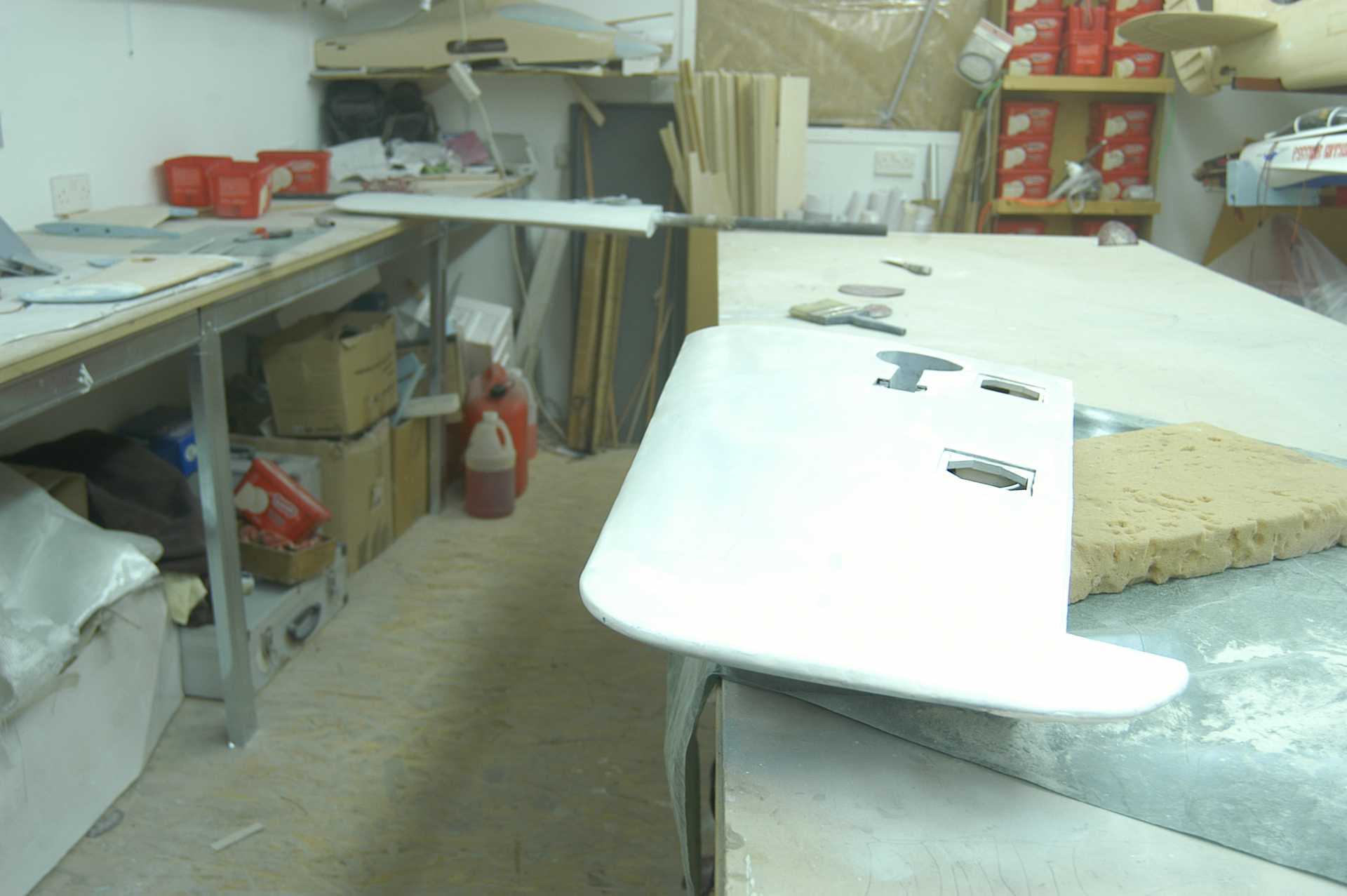

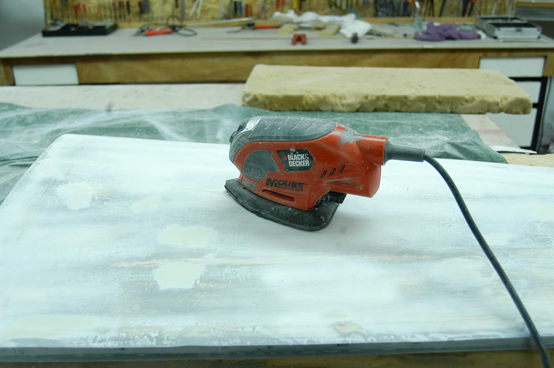

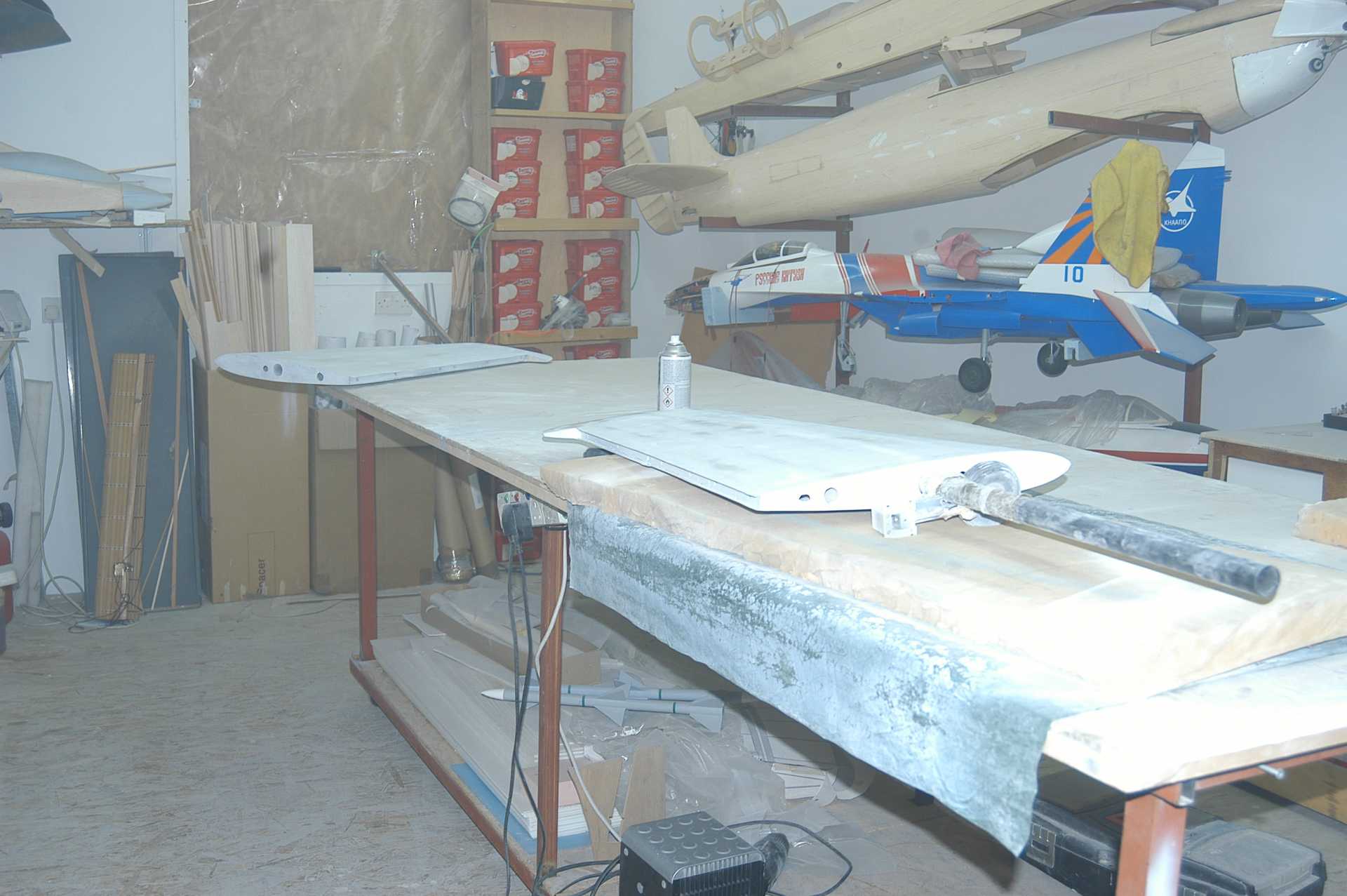

20 Mar 2017 20:19 #130 by THE BLACKBIRD
Well I put a coat of primer on the fuselage this morning and I have spent the day in between gardening filling and sanding and I thought it was ready to finish :S
but got the first of the finishing coats on it tonight
Also the first coat of white primer on one side of the wings
Thanks: Klipkopwildlife, Quorneng, old fart, boz, Firewood

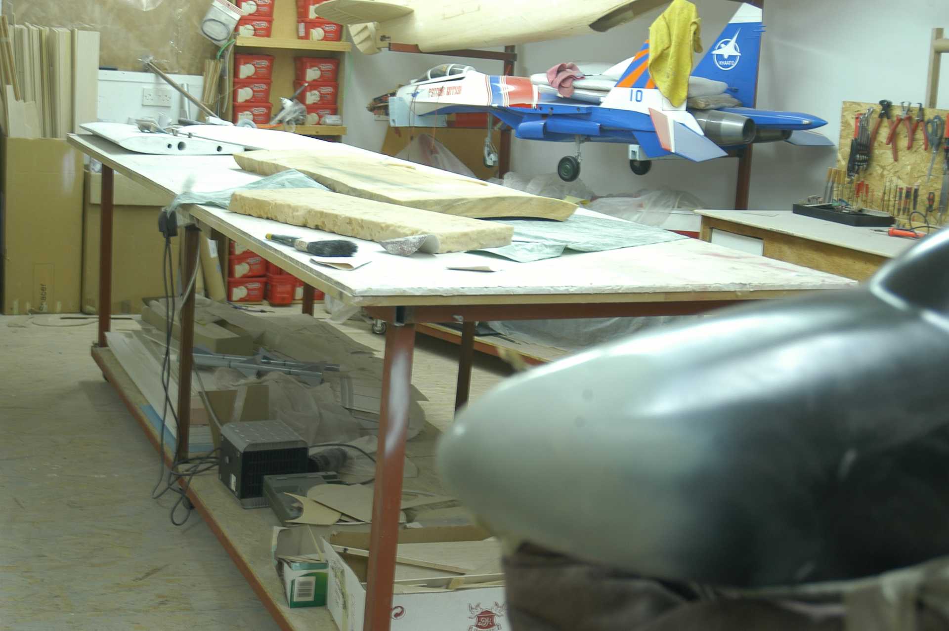

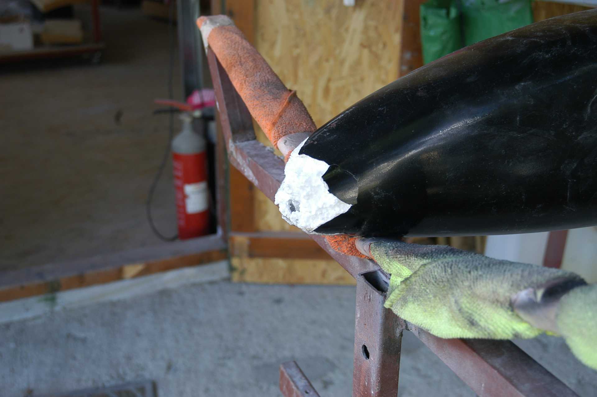

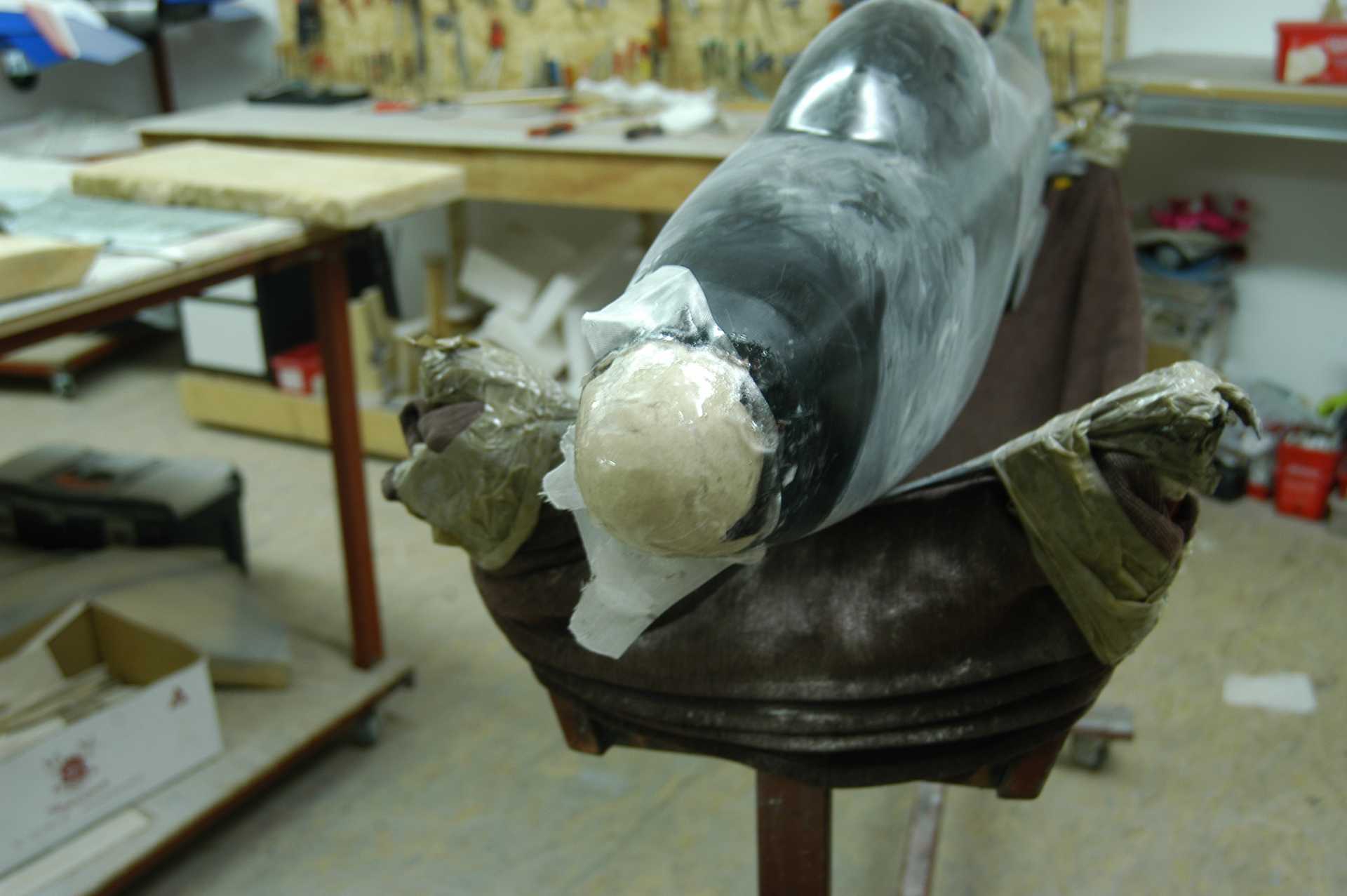

Being unable to sleep again ( it is now 2 in the morning ) I went into the hanger o do something and I stood admiring the fuselage, very pleased at how it had turned out, with having smashed the nose off
I touched the very smooth shiny surface and it fell of the stand, :sick: it was so slippery and the slope under the nose, it was on the stand a good 200mm and it just slid straight off BANG onto the floor
with more damage than the first time, again the nose has gone, even more and there are two cracks one at the front and one where it tapers just behind the engine
I really really am not in a good mood :angry: :evil:

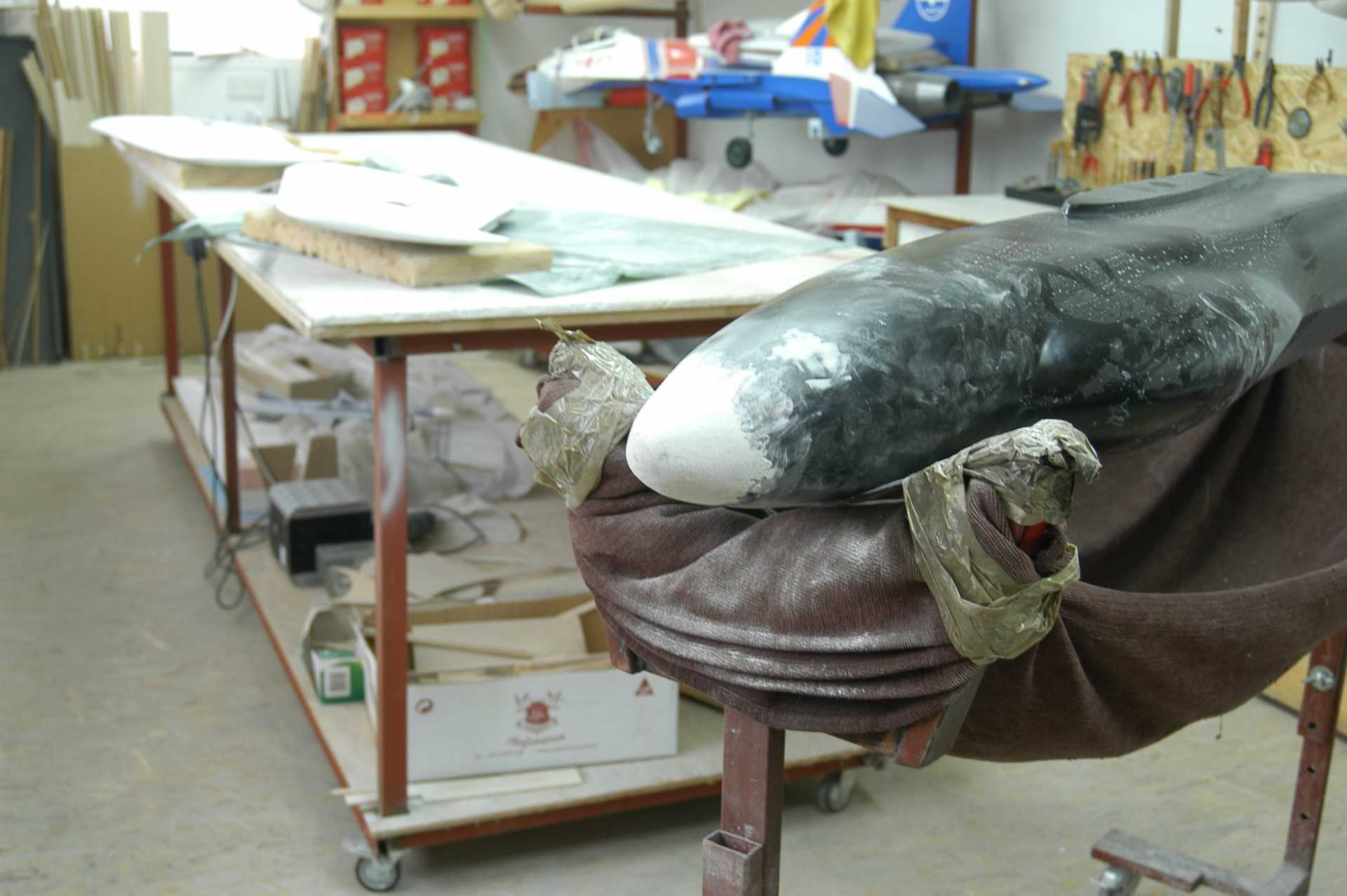

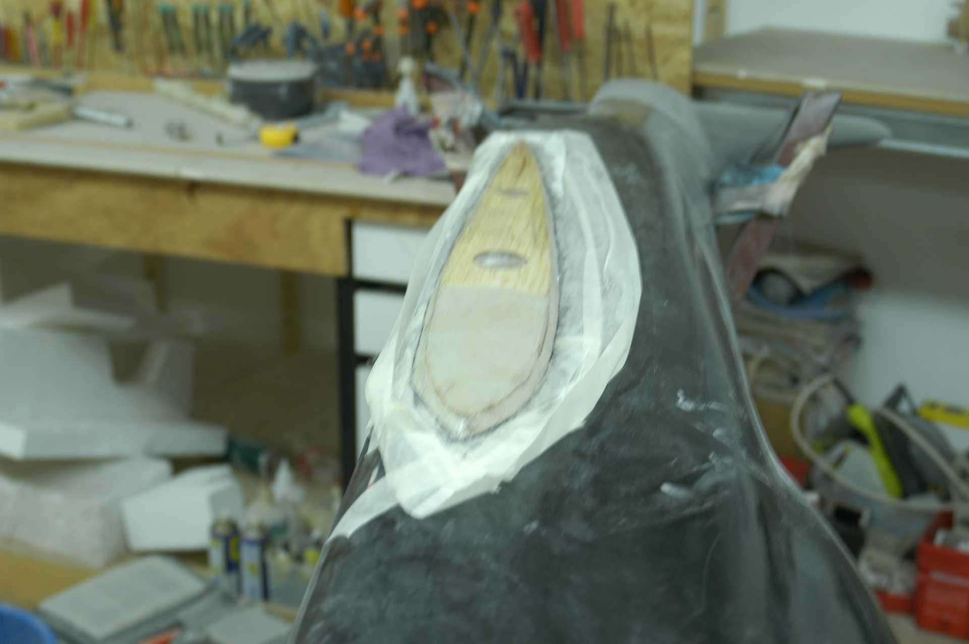

21 Mar 2017 20:16 #133 by THE BLACKBIRD
I have had a very bad day, I should have stayed in bed, only I never went to bed in the first place :( just cannot sleep,
Anyway I have started on the third new nose :angry: got it shaped and a coat of glass on it

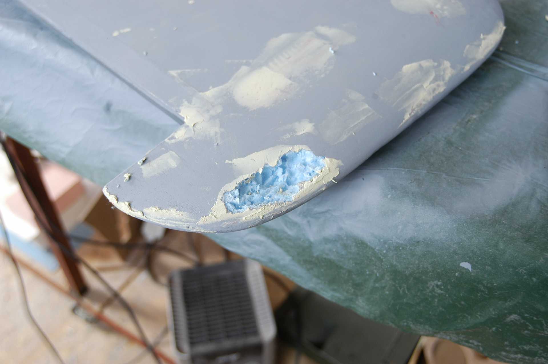

Still rubbing the wings down and another priming coat on
I don't think I will ever make the wing tips out of foam again, giving lots of problems, should have stay with my original plan and made them of fibreglass
working on the air intakes

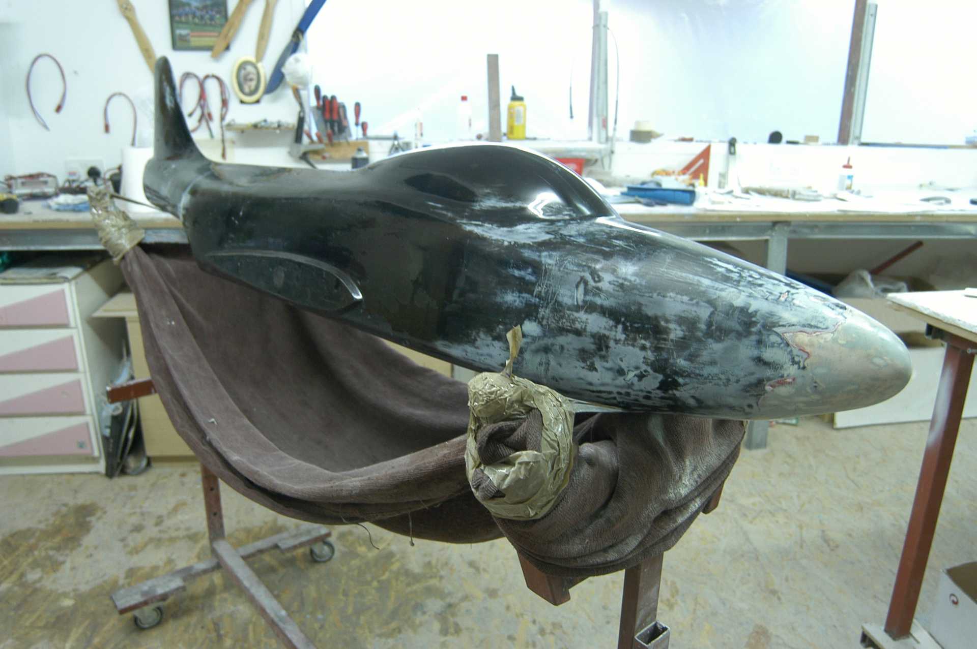

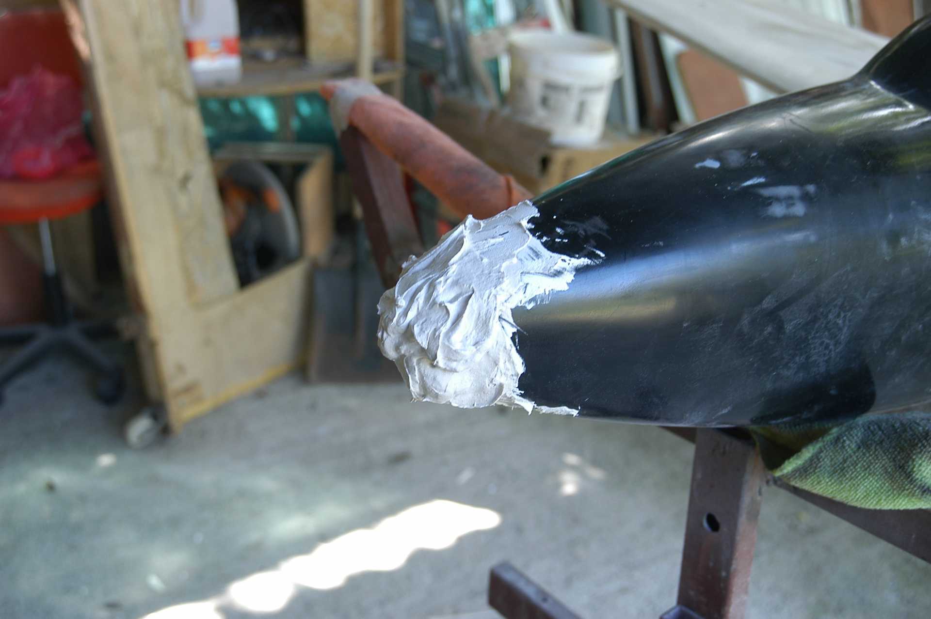

22 Mar 2017 18:39 #134 by THE BLACKBIRD

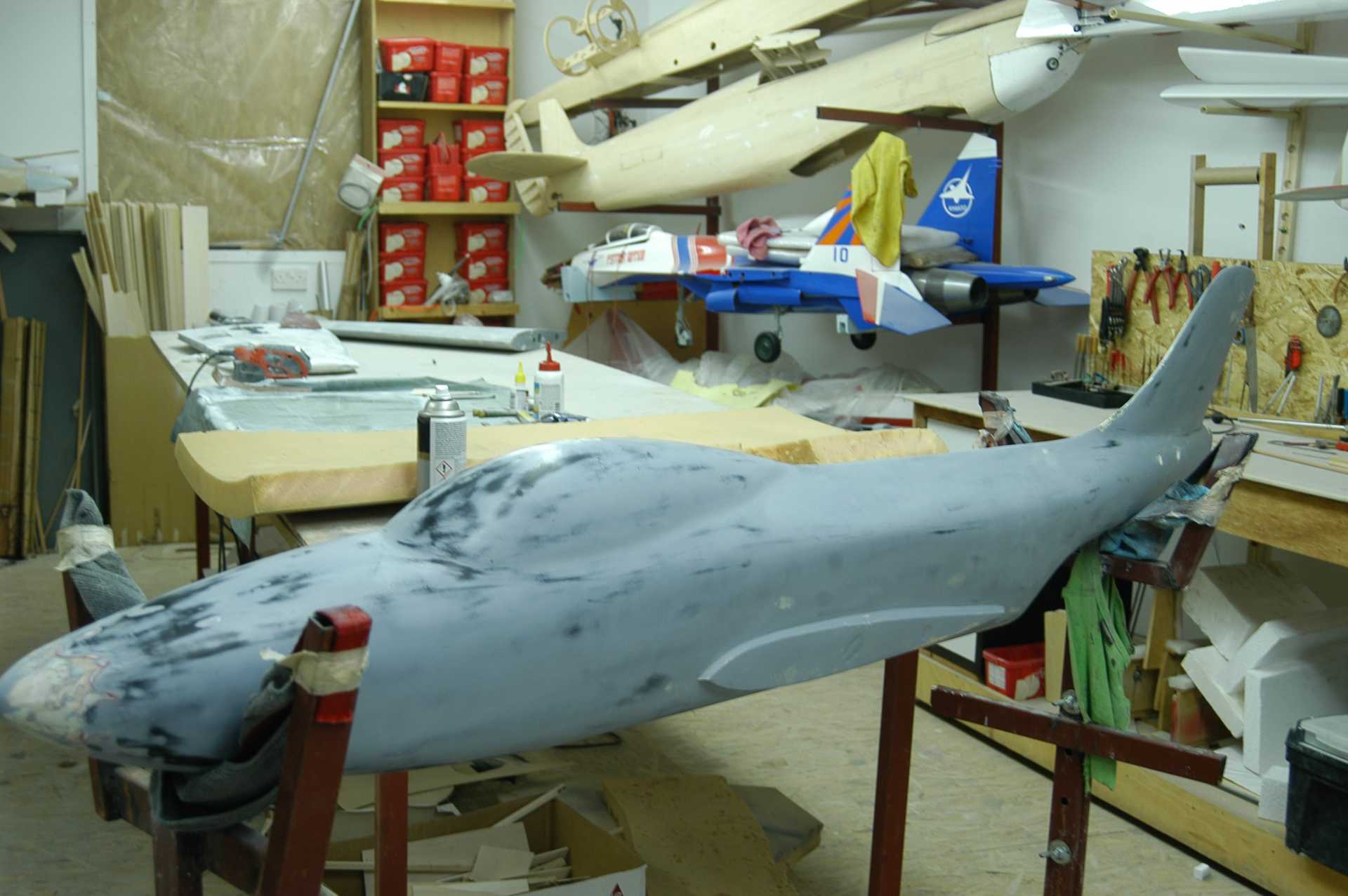

My new nose job, the third one taking shape
And a coat of primer
And the wings are now ready for the final coats of paint
When I sort a colour scheme out

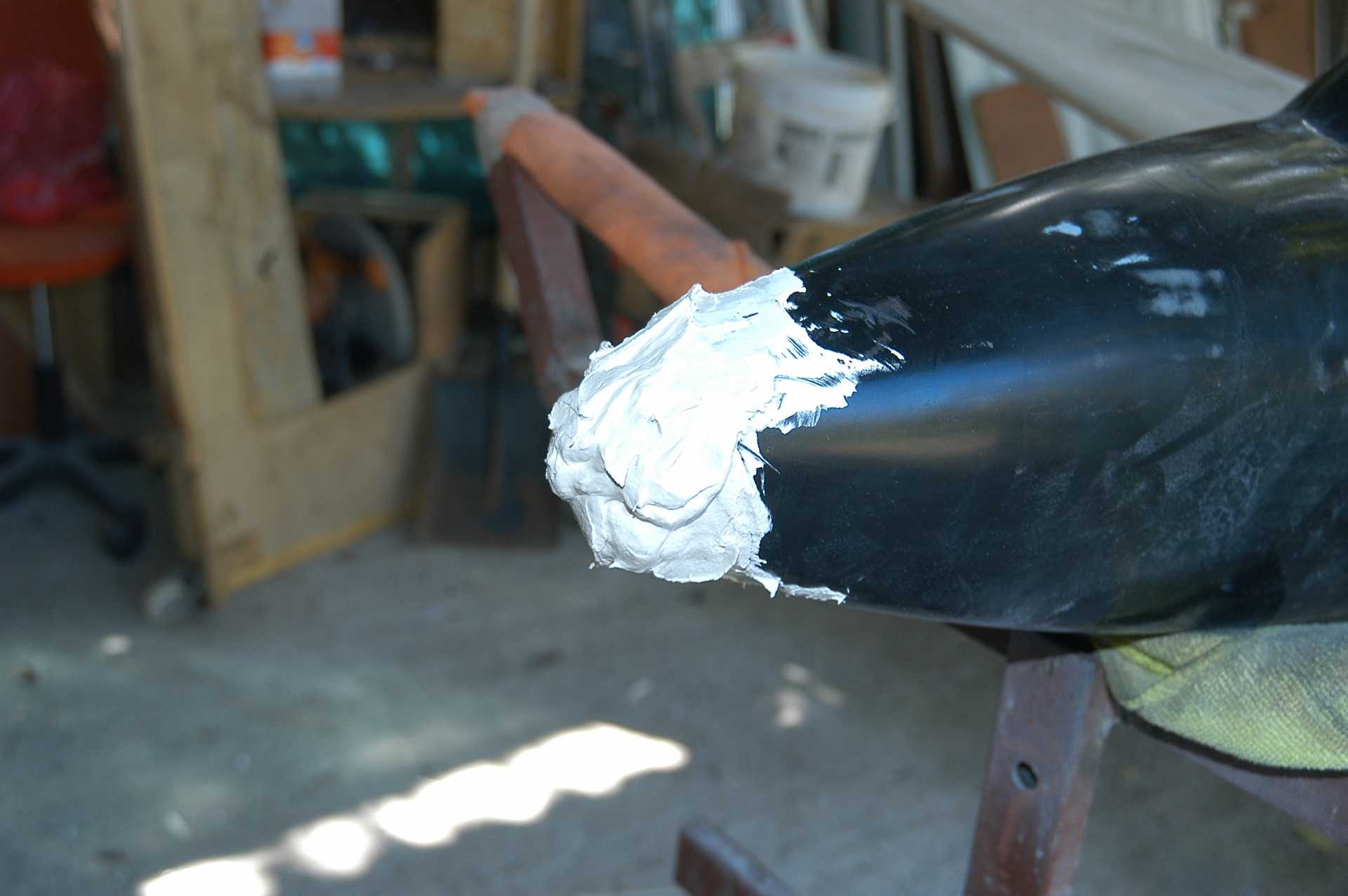

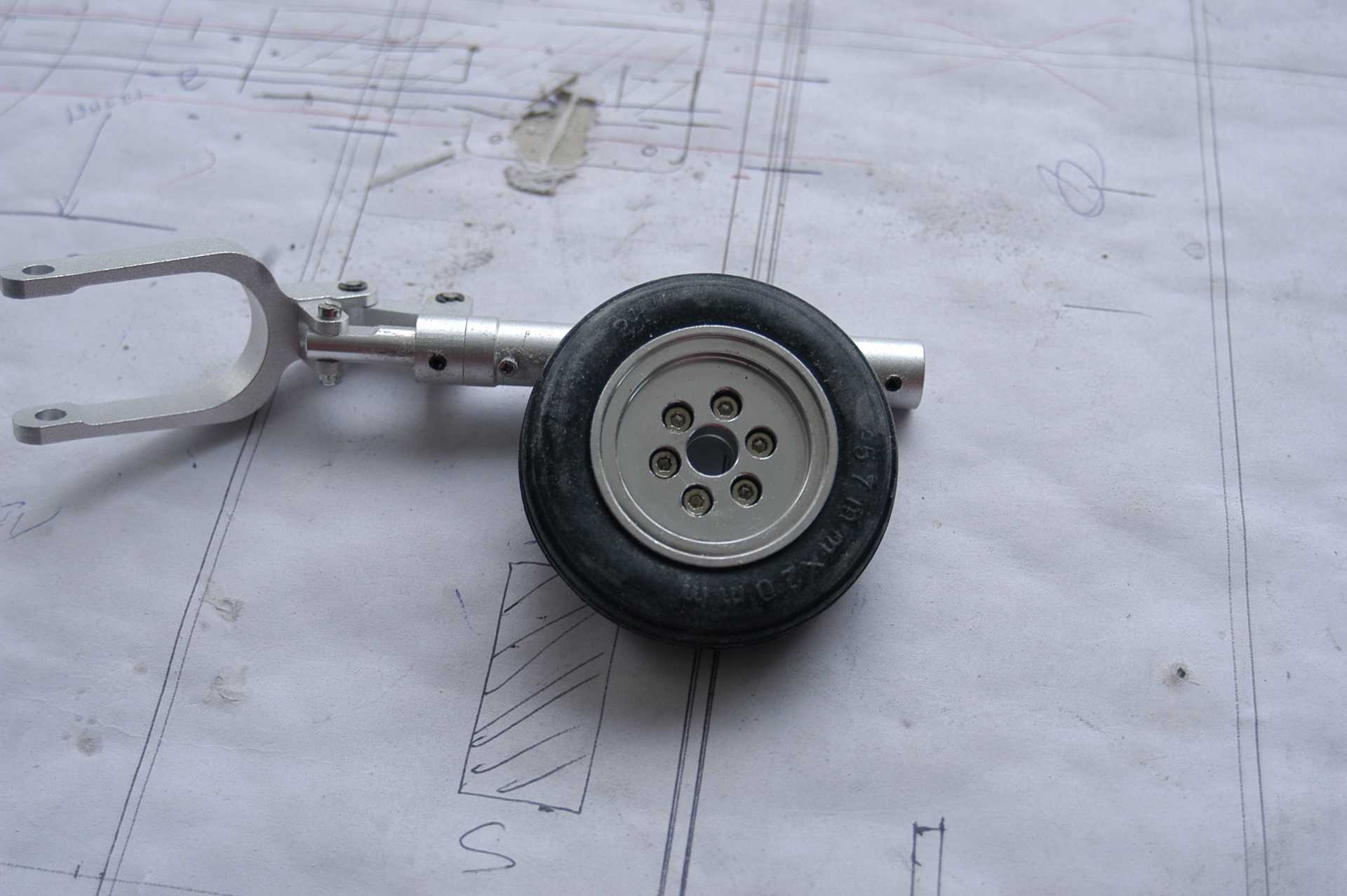

23 Mar 2017 20:11 #135 by THE BLACKBIRD
I am now back on my day job turning the jungle into a garden :(
The cheapo nose wheel turned up this morning good value for less than a tenner
started to make it fit the nose leg
The new nose is done
So I thought I may as well go over it all and fill any marks and rub it all down
