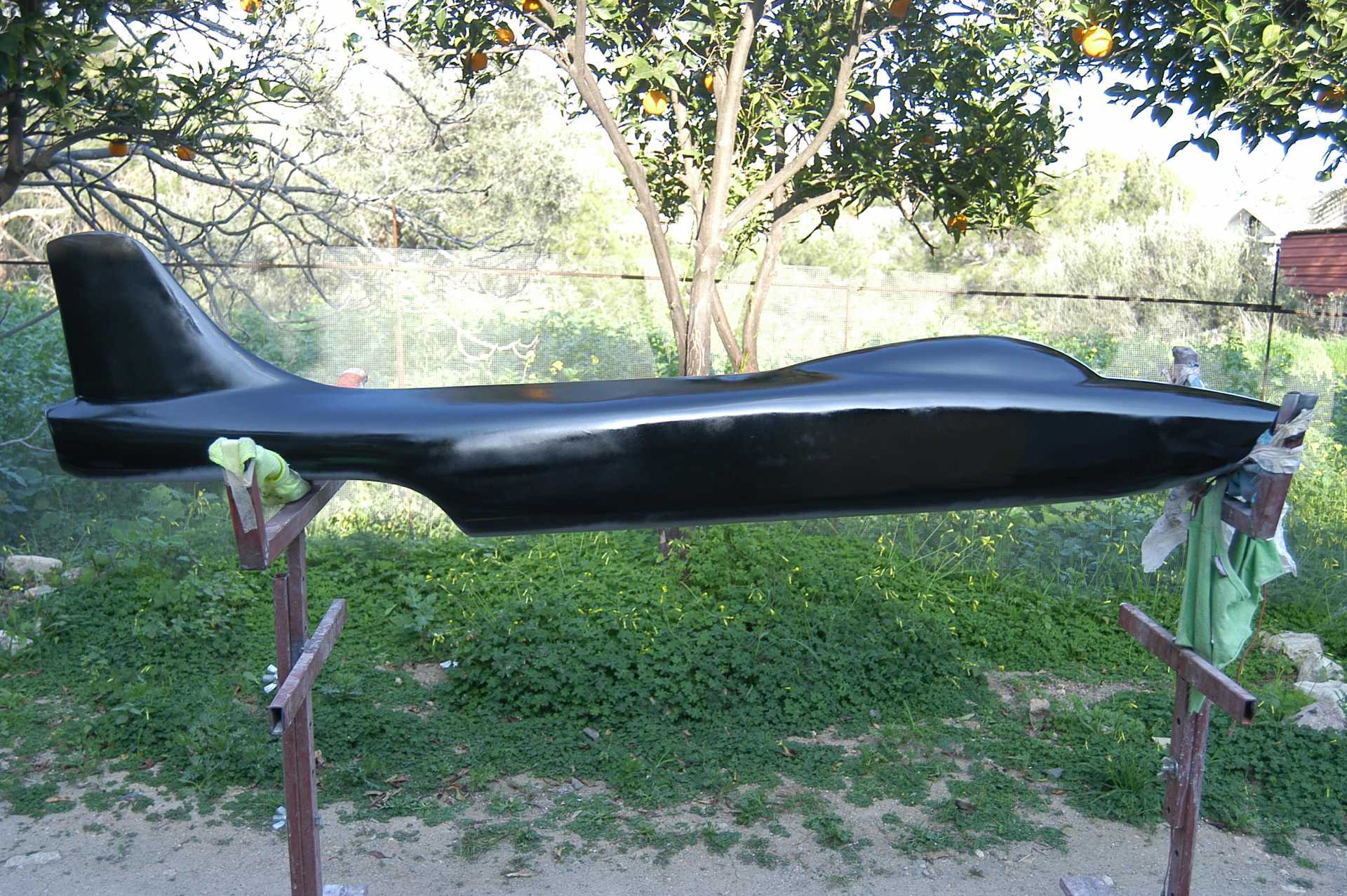

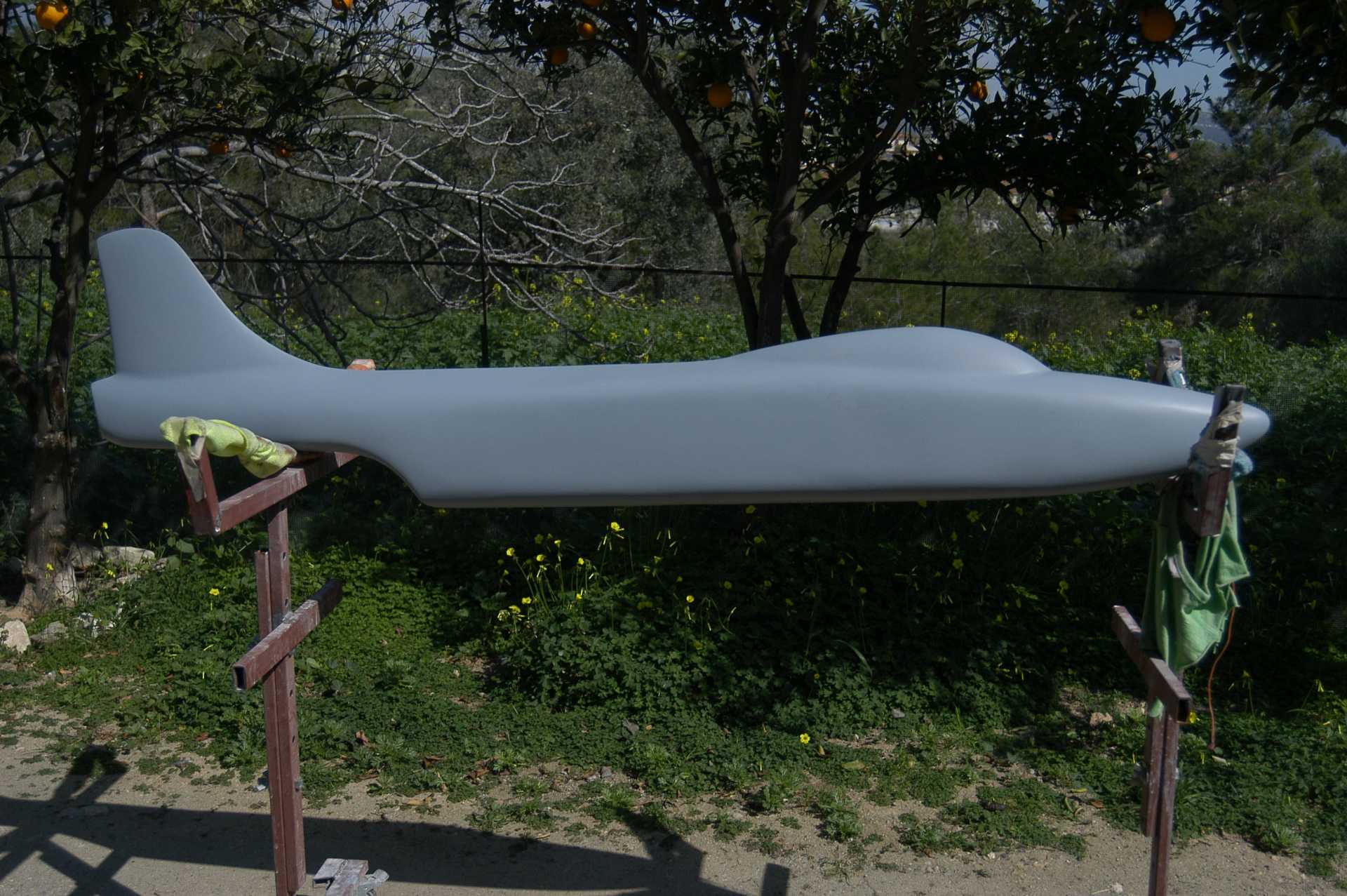

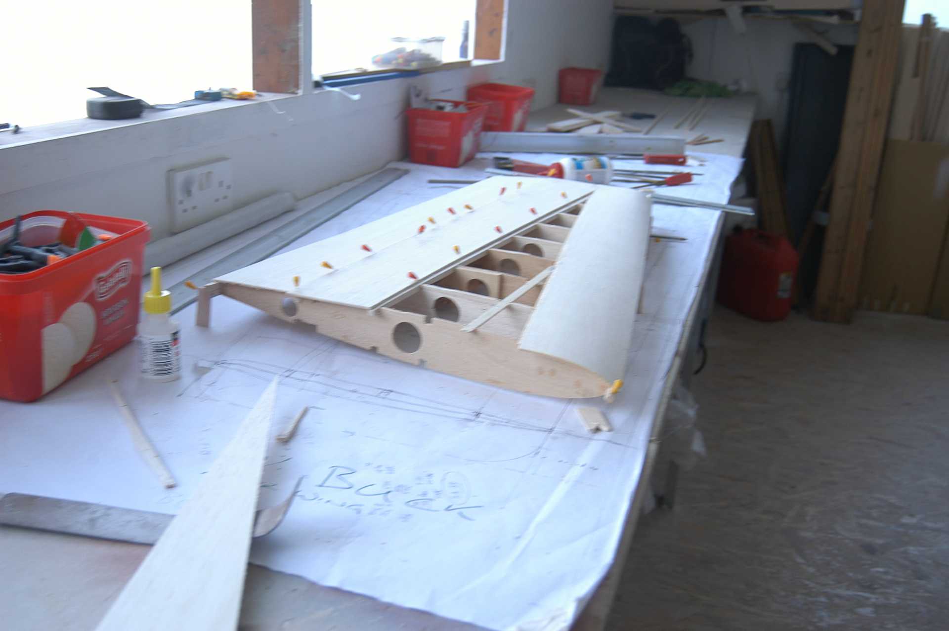

Put another coat of primer on this morning,
cut it back with 2000 wet & dry, cleaned it all up and sprayed the first coat of gloss
Its as near perfect as im going to get with my limited painting skills :( I will keep cutting it back between gloss coats

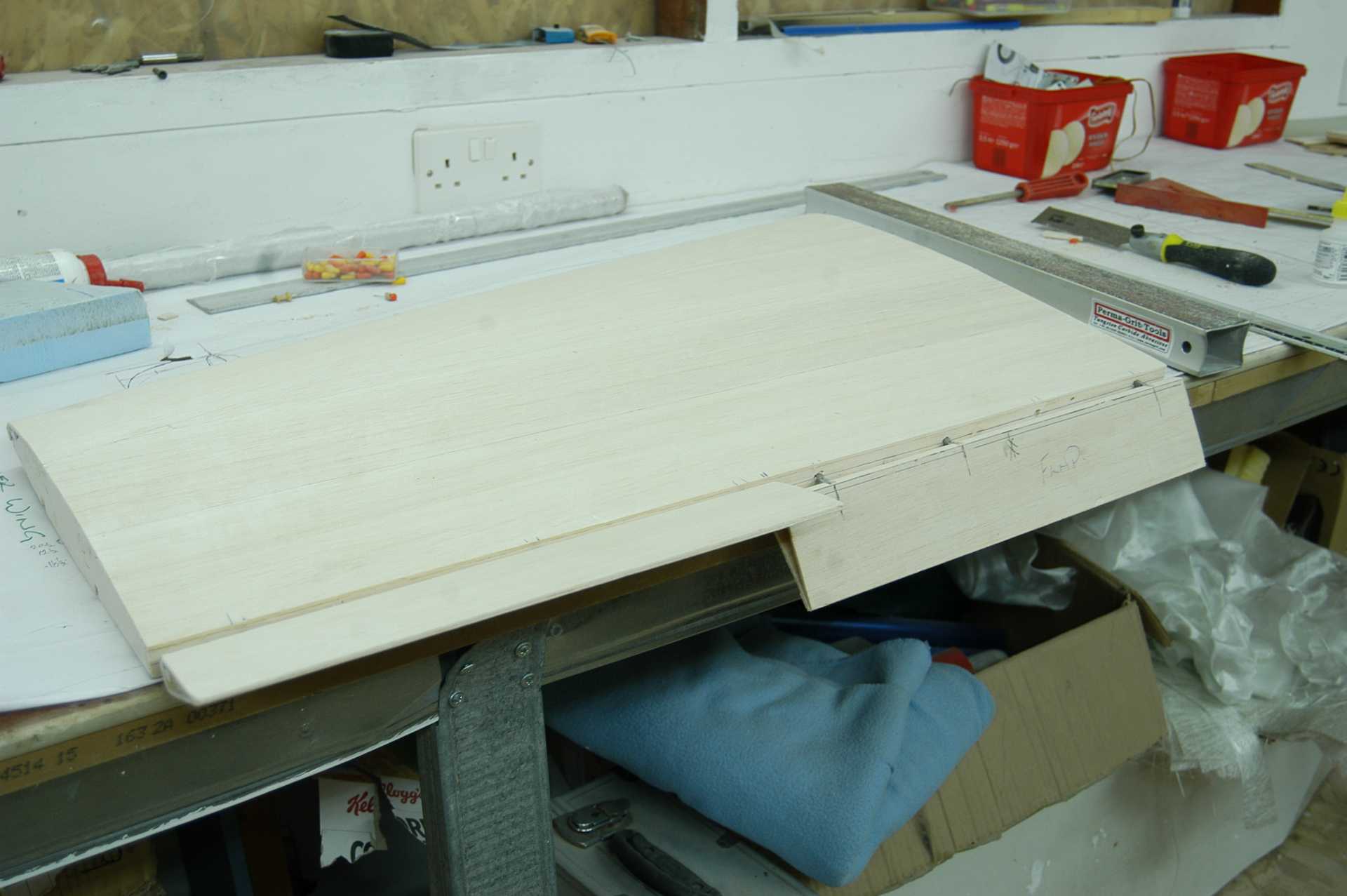

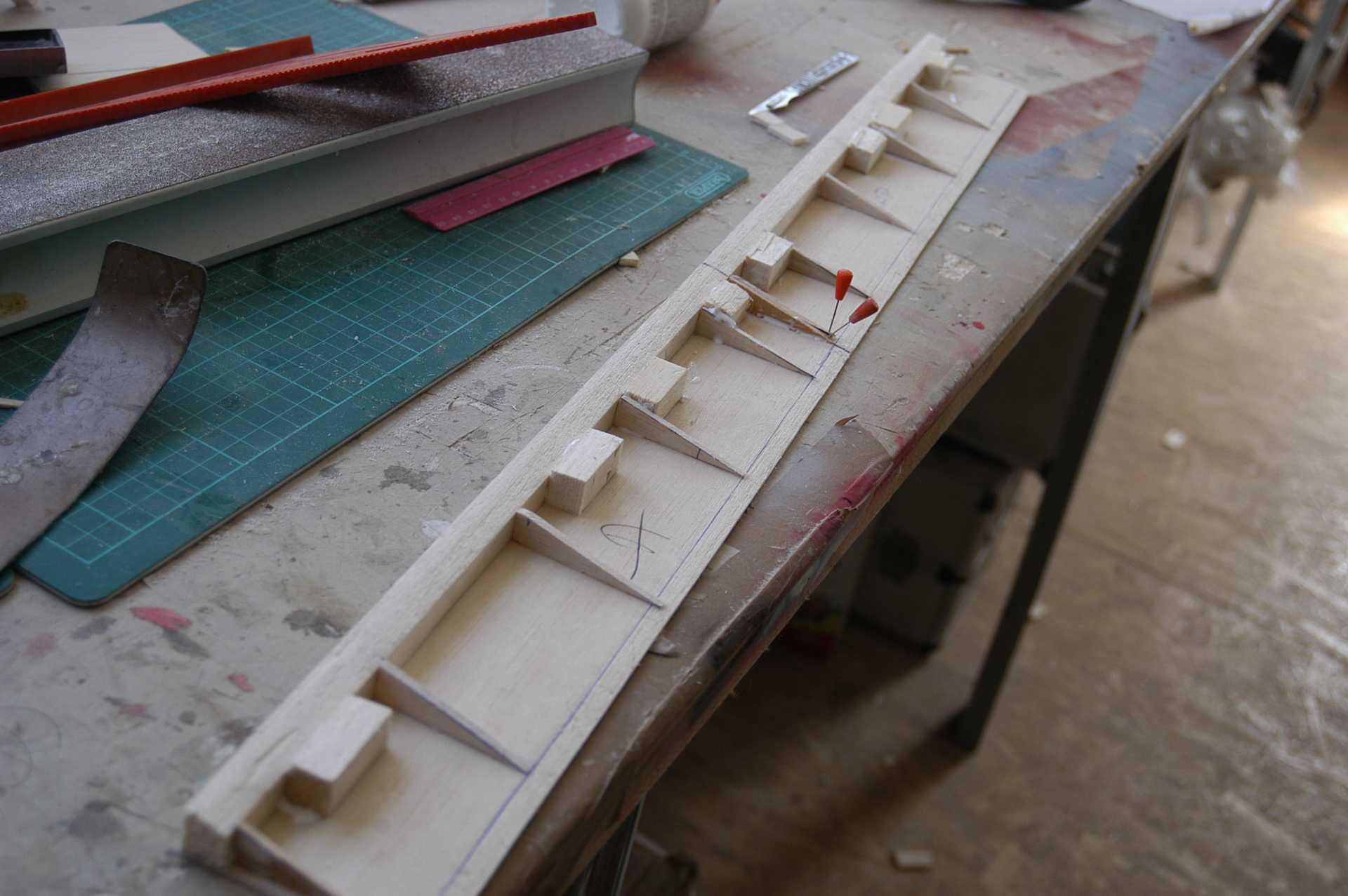

Made the aileron and flap

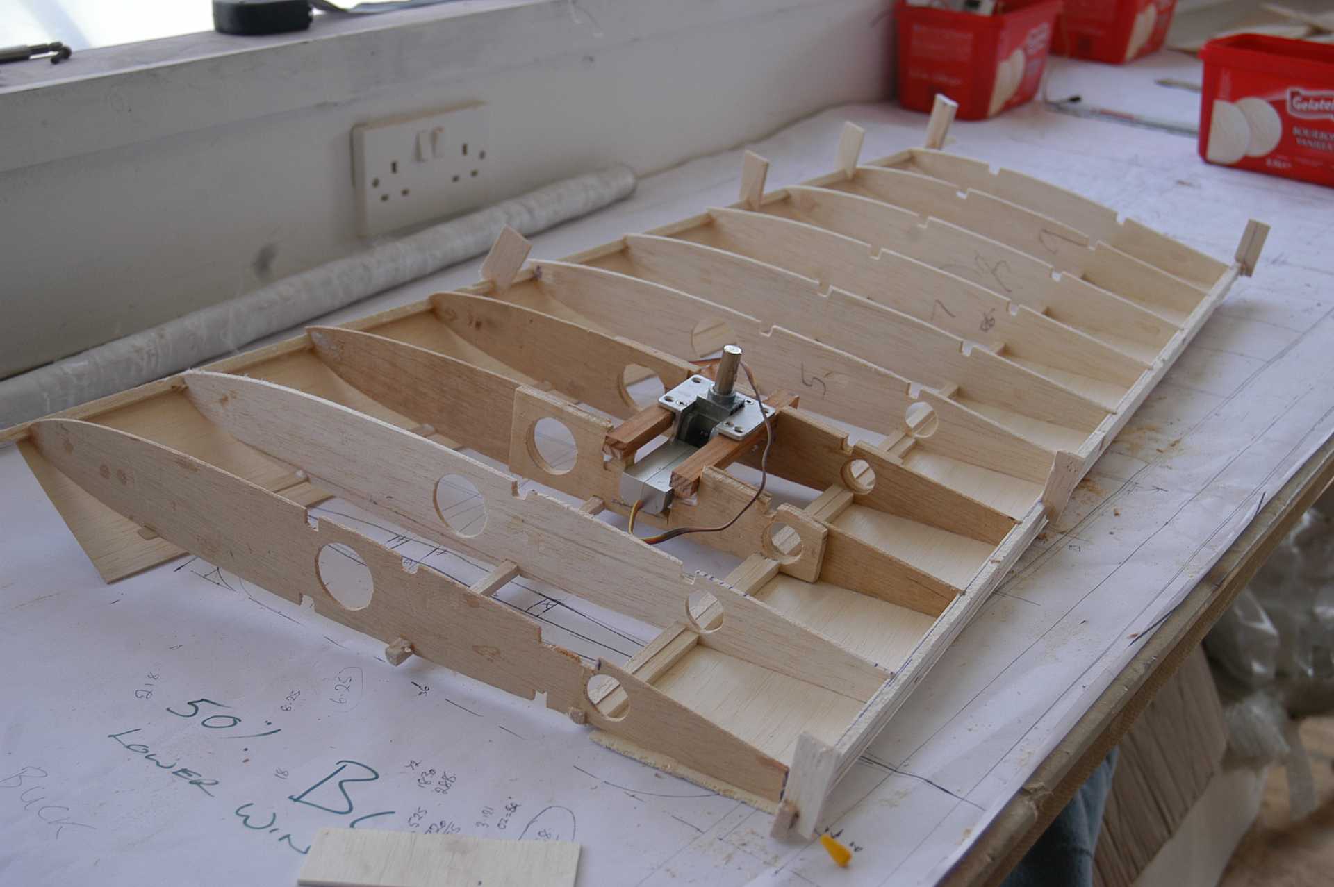

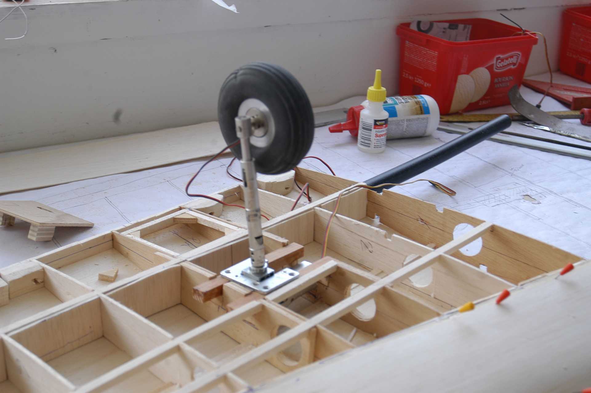

Retract fitted

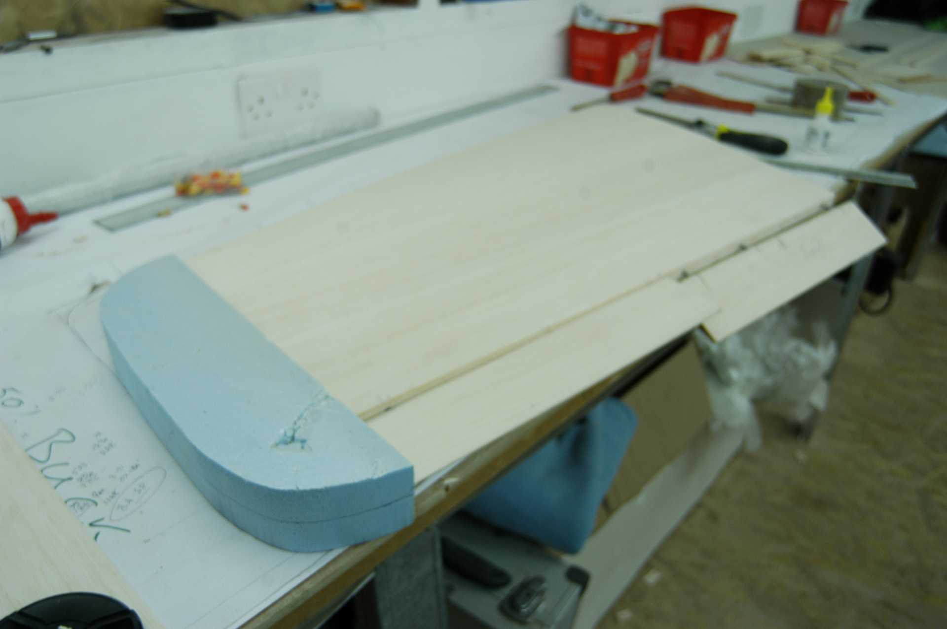

And started sheeting the top
Dry fit the flap / aileron
Cut the foam for the wing tip, will do it in F/G
Made up the mounts for he wing servo's
Last edit: 21 Feb 2017 18:49 by THE BLACKBIRD.
Thanks: Klipkopwildlife, Quorneng, old fart, boz

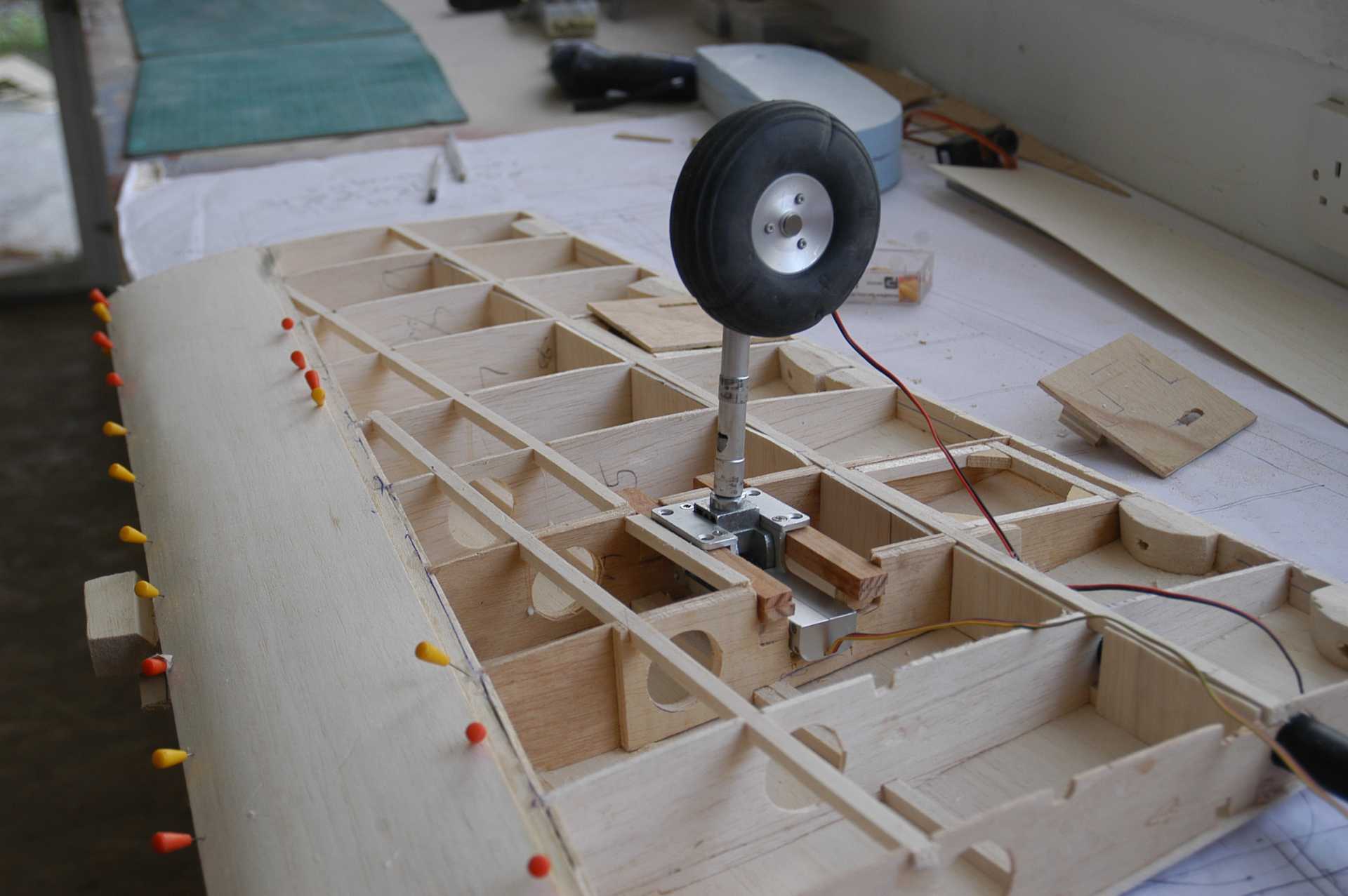

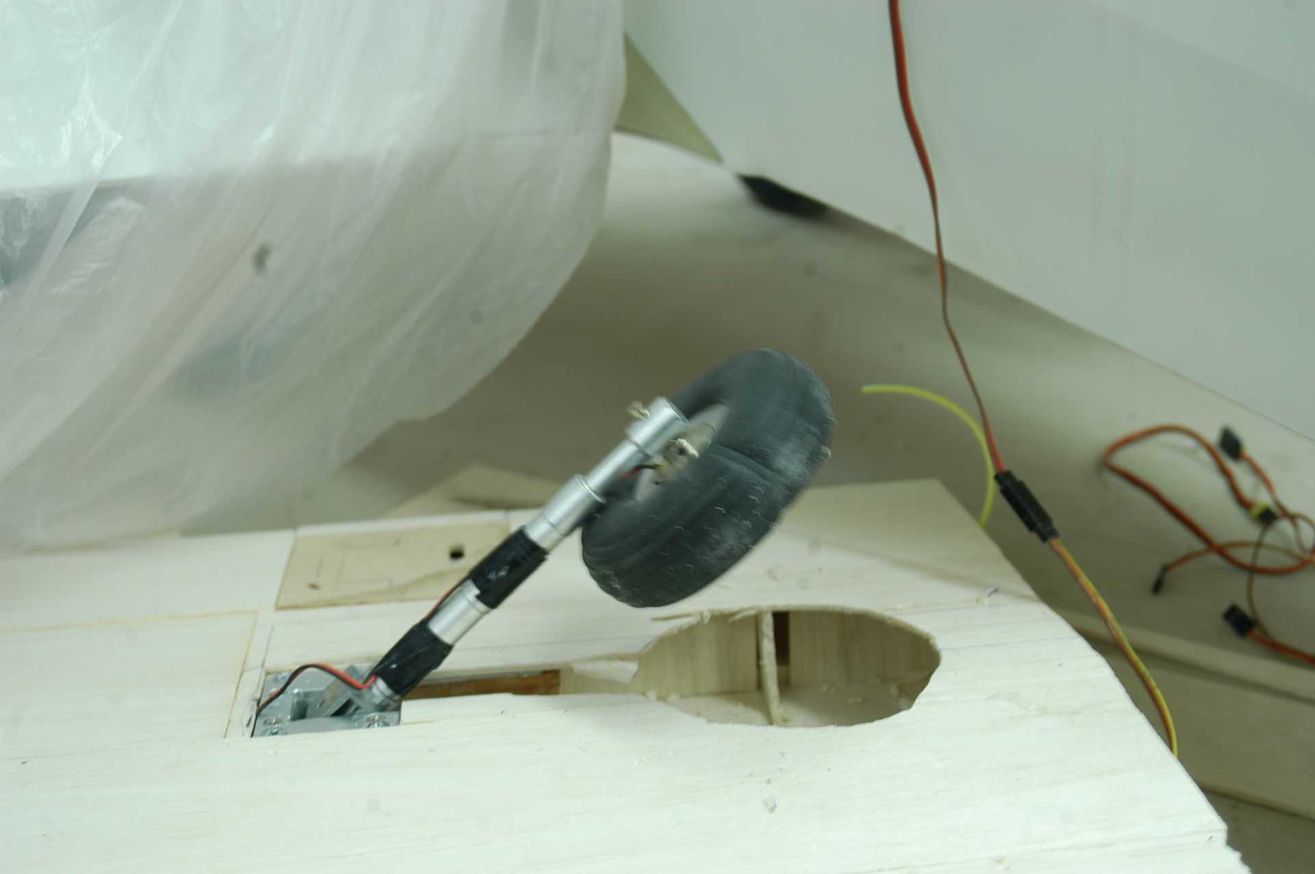

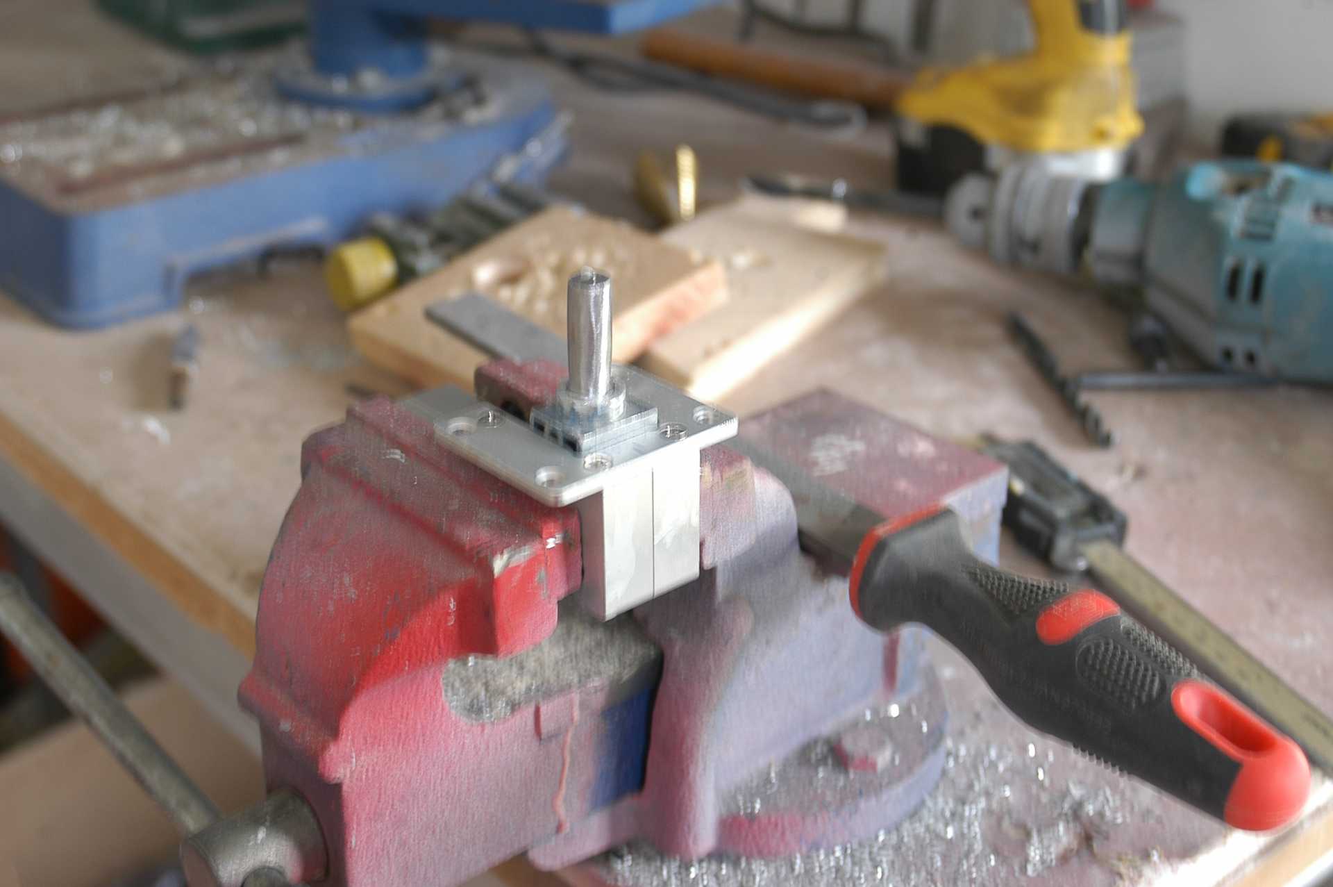

Thought I would have a go at the retracts while the paint dried using my basic tools, but managed to get one done, not to much blood spilt :S

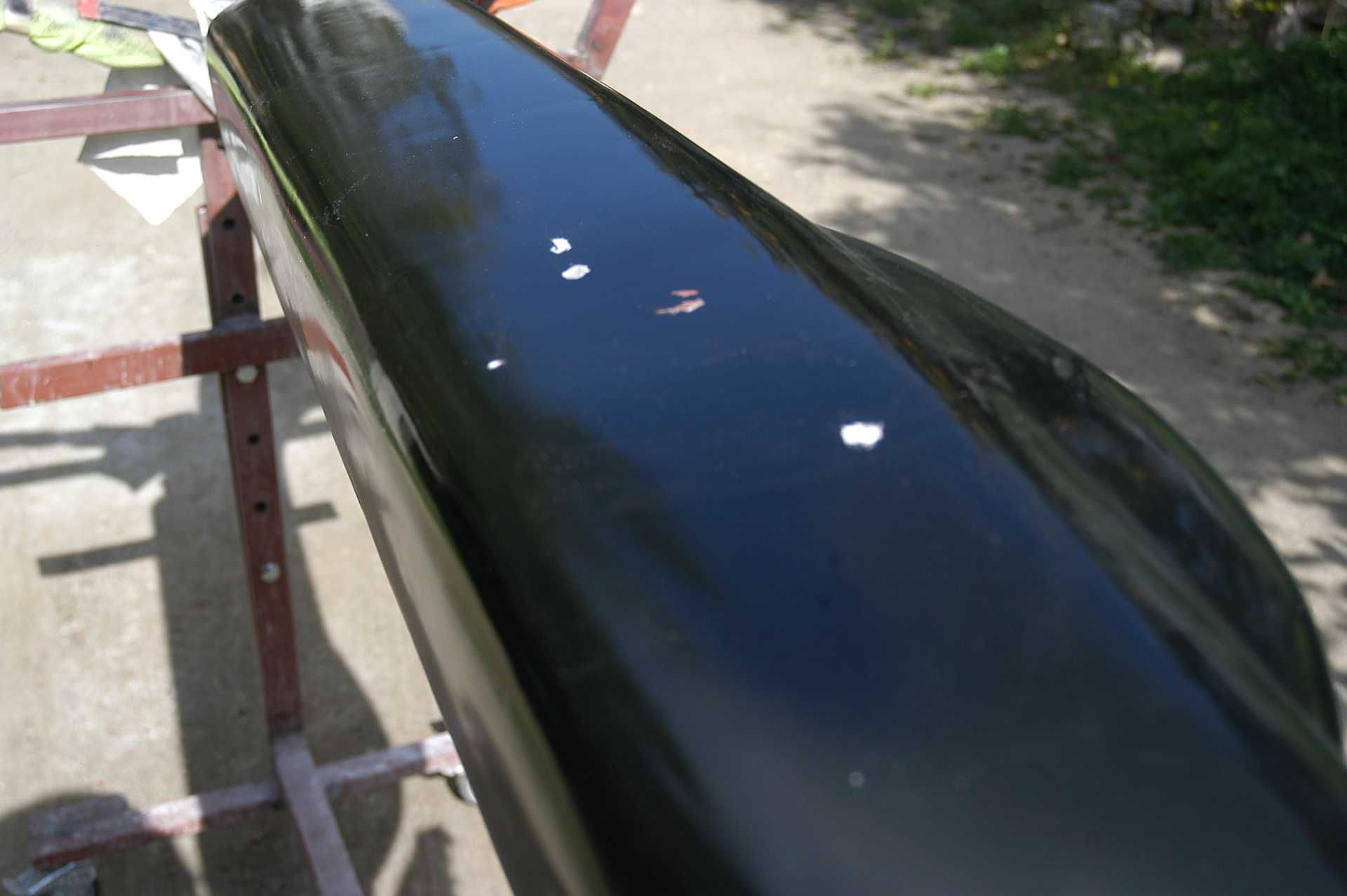

And the plug is starting to look good, I cut it back again and another coat of gloss

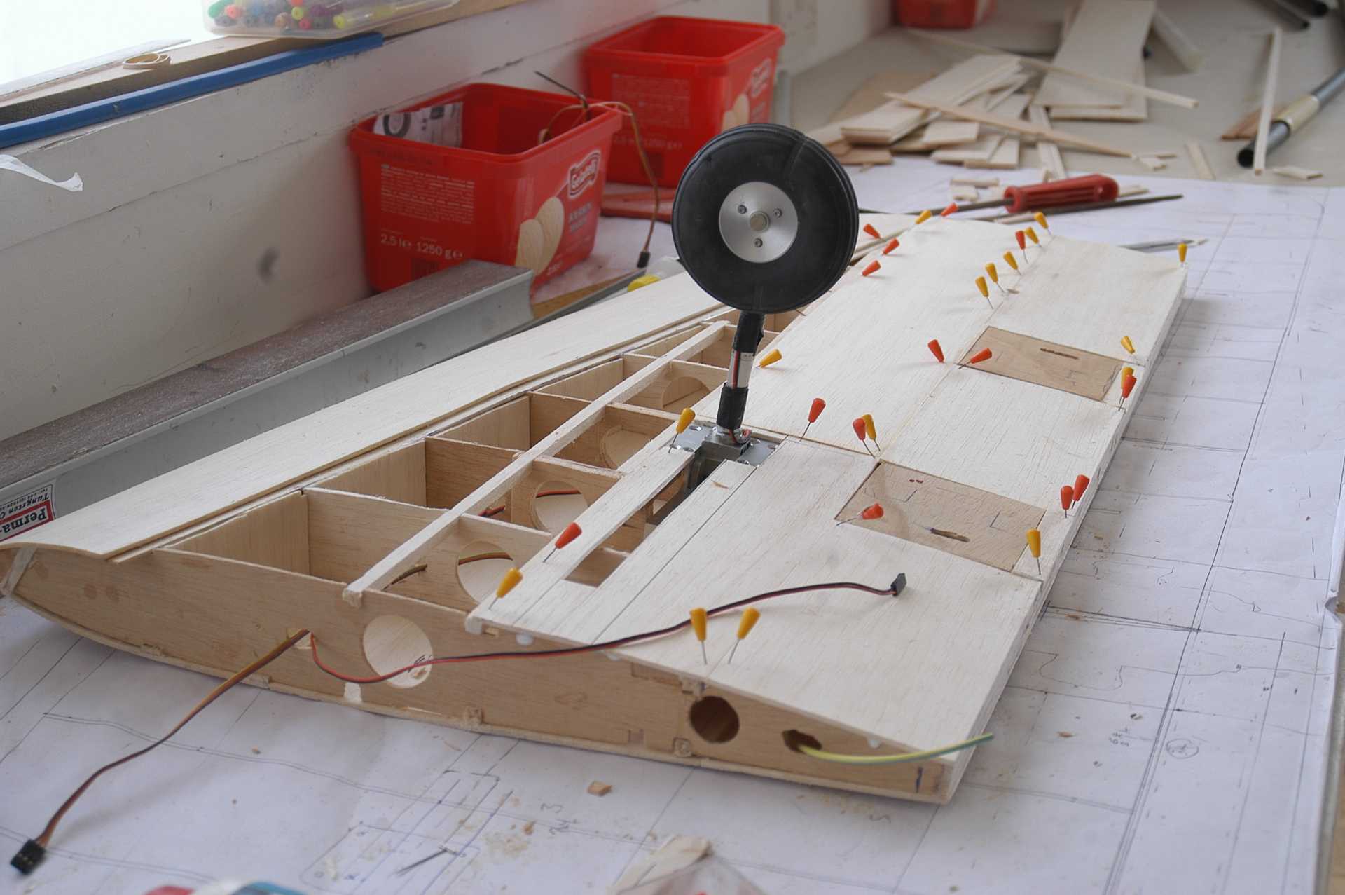

23 Feb 2017 19:20 #89 by Si_B
Replied by Si_B on topic Own design and build sports turbine jet
Plug is looking fab, but I have real concerns over those retracts. There is little material left and from the pictures the actual retract bearers don't look up to the job.
It's hard to get an idea of size etc, but for jet carrying 2 or 3kg of extra fuel on take of, I think you might have issues.
Simon
Thanks: THE BLACKBIRD, boz
23 Feb 2017 19:39 - 23 Feb 2017 19:41 #90 by THE BLACKBIRD
Another problem :angry: some bubbles appeared overnight so I had to cut the out and fill but I will
succeed in the end, I think :silly:

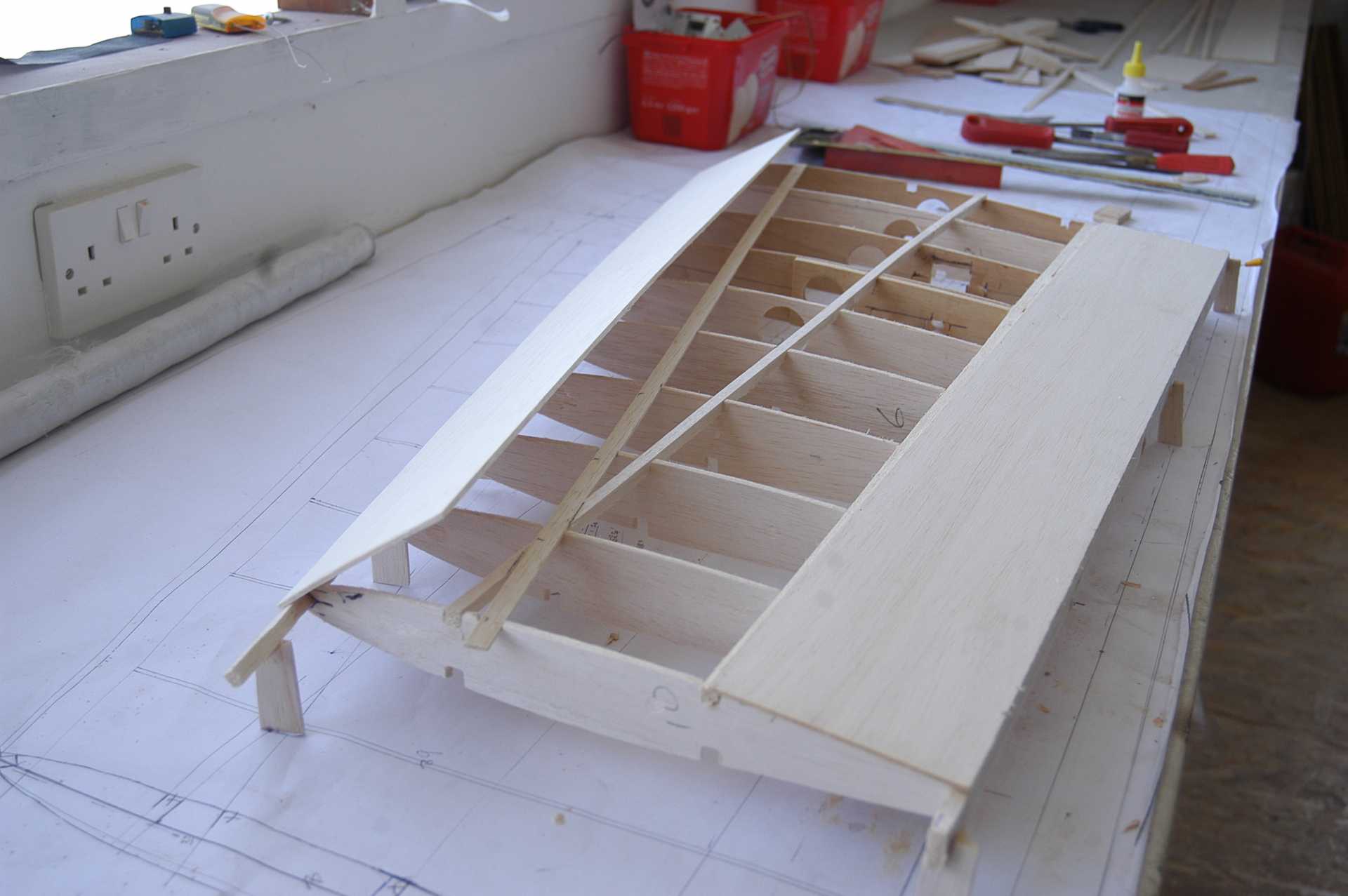

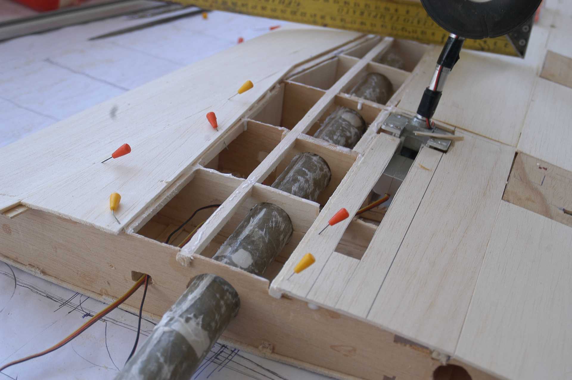

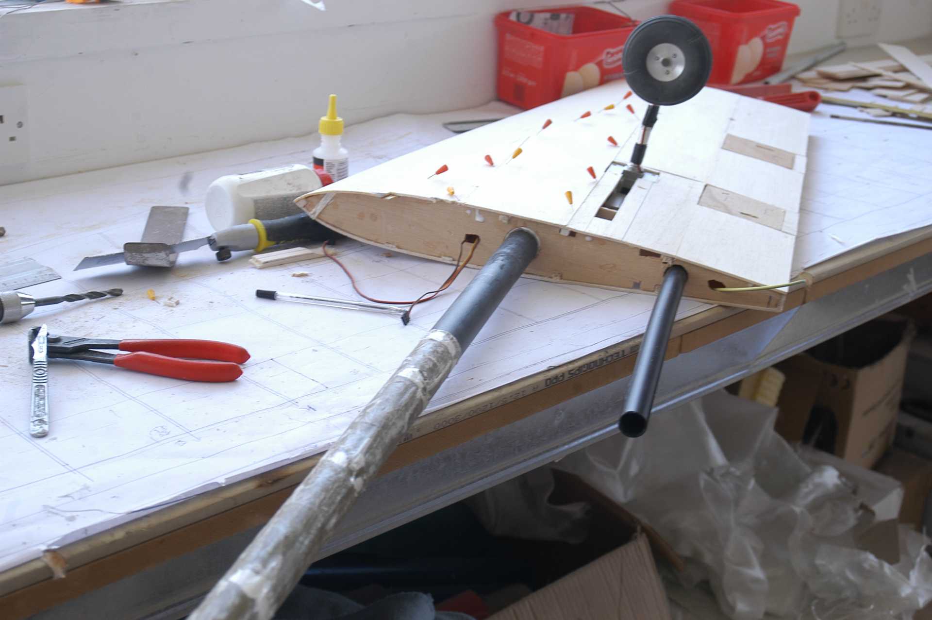

Sheeted the underside of the wing

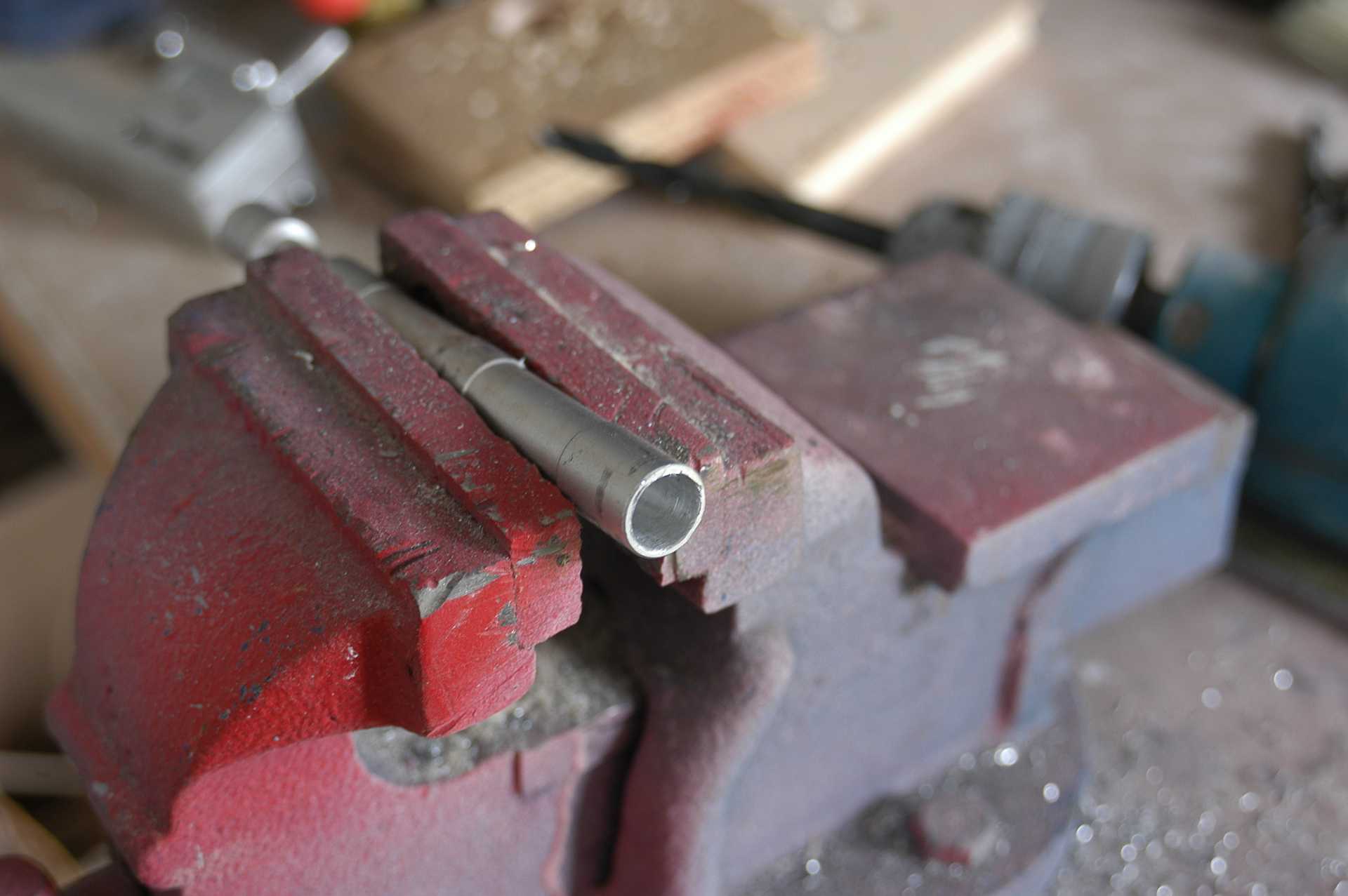

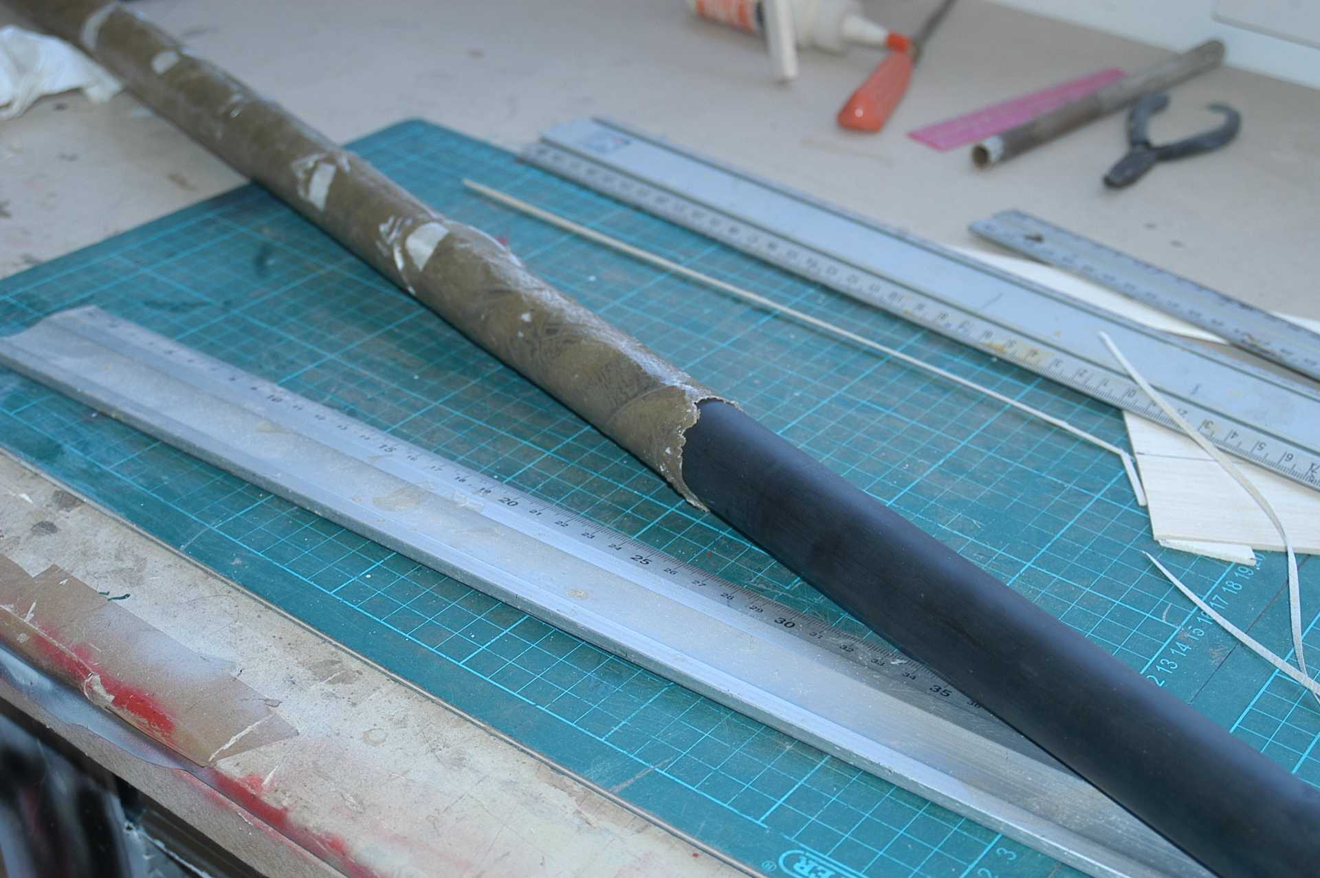

made another wing tube outer sleeve, came out good
and fit it in the wing
along with a smaller tube near the back

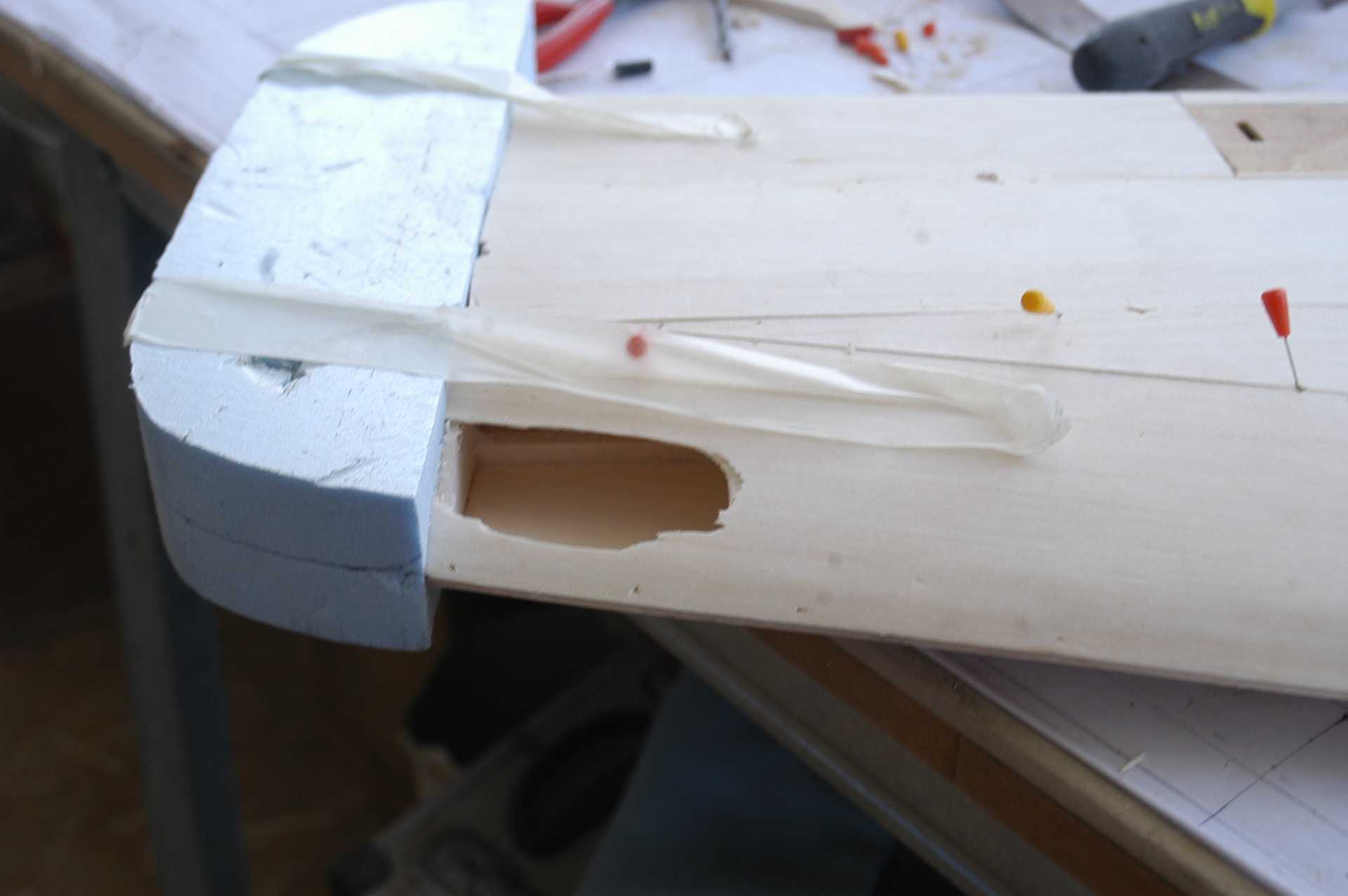

Tack glued the foam block for the wing tip and put my left hand thumb through the sheet, I have little control over my left hand as yet, find things difficult at times with it
The cheep retracts work just fine :P

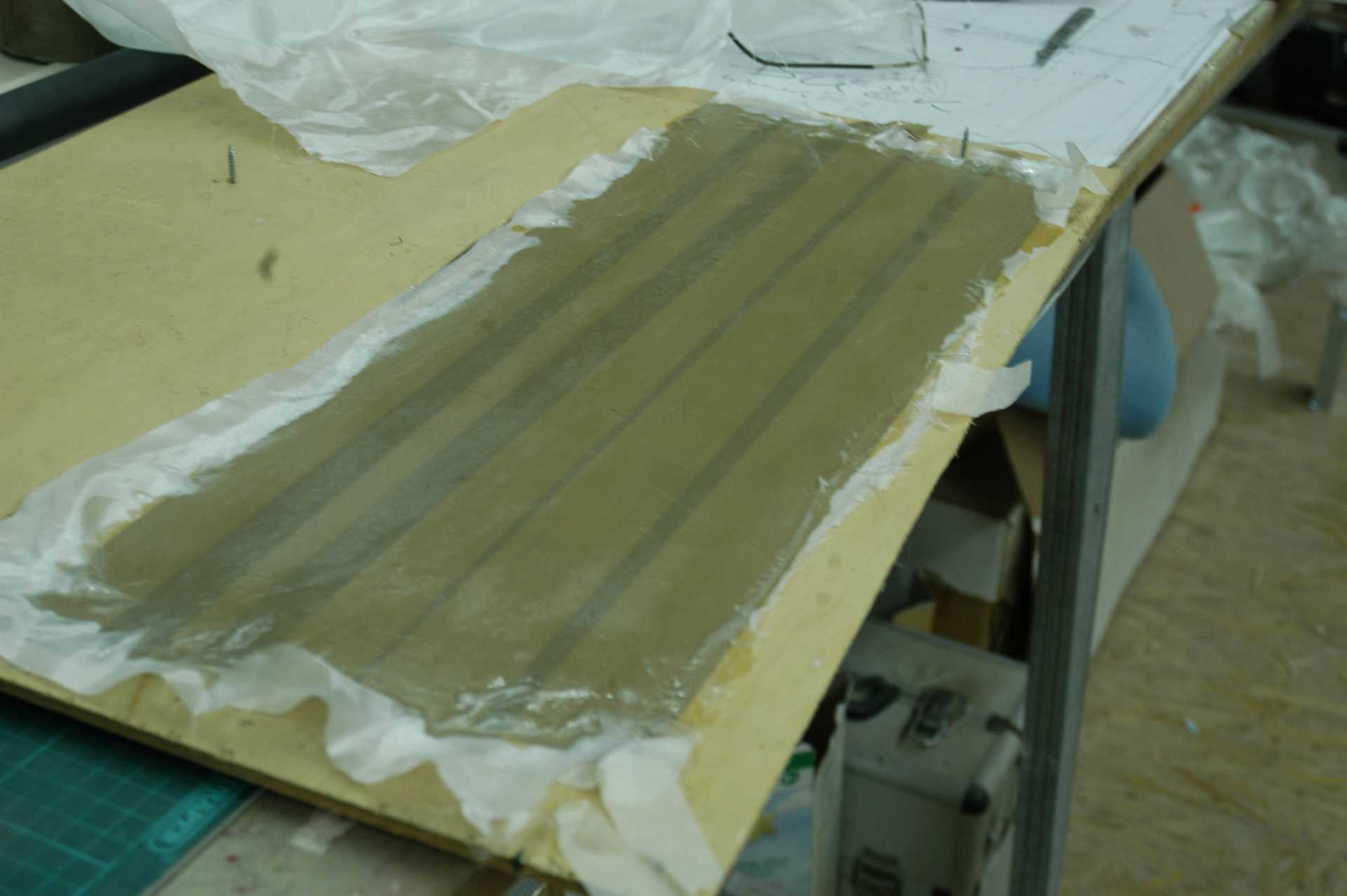

Going to line the retract hole where the wheel fits in the wing with thin F/G sheet, so I had a go at making some, laid some brown parcel tape on a flat board then put the cloth on top of it, worked in the resin with my bank card, nothing left in there anyway ;) then did the same with a second layer
I will see if it works tomorrow :)
