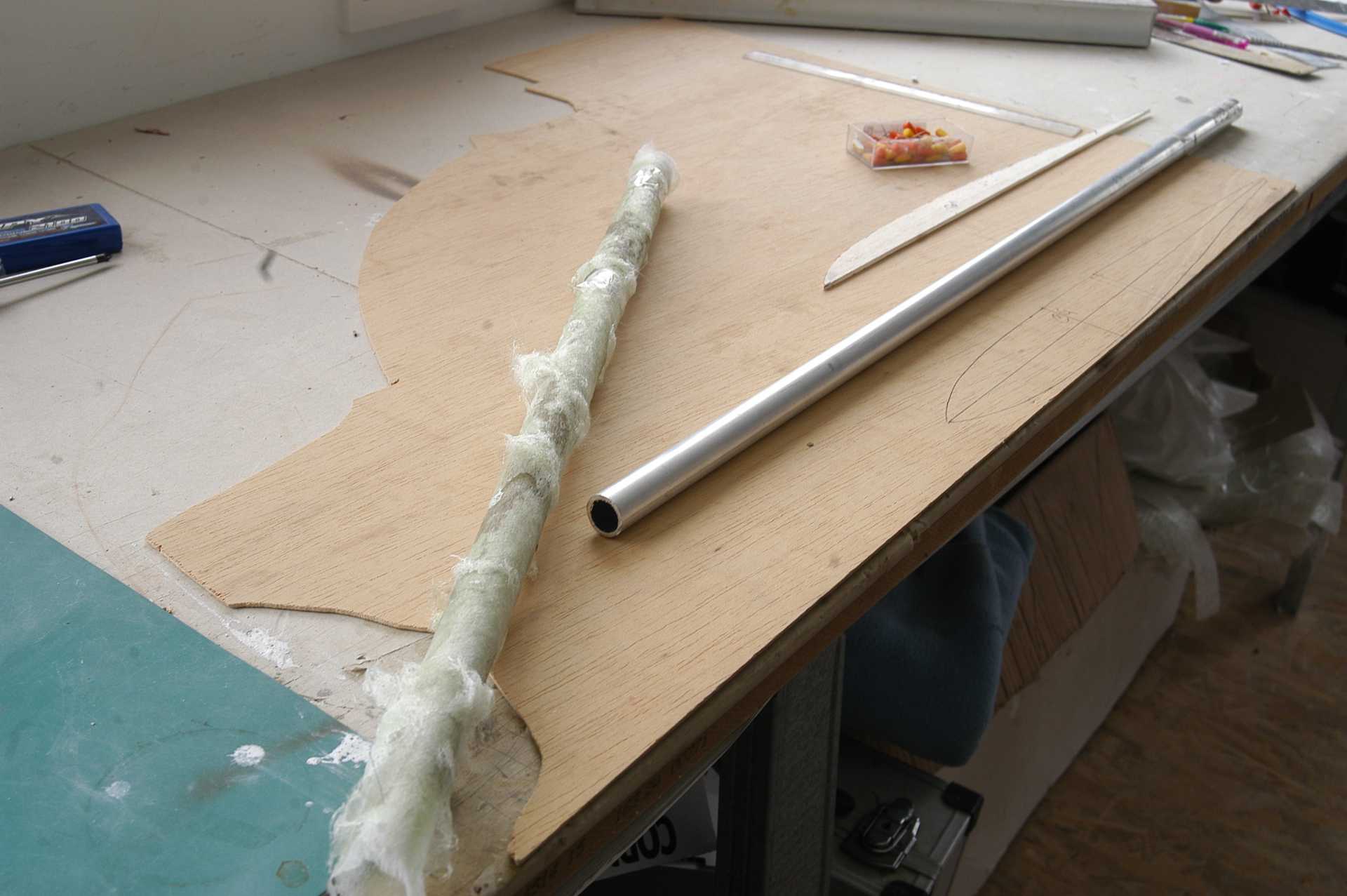

13 Feb 2017 19:20 #64 by THE BLACKBIRD

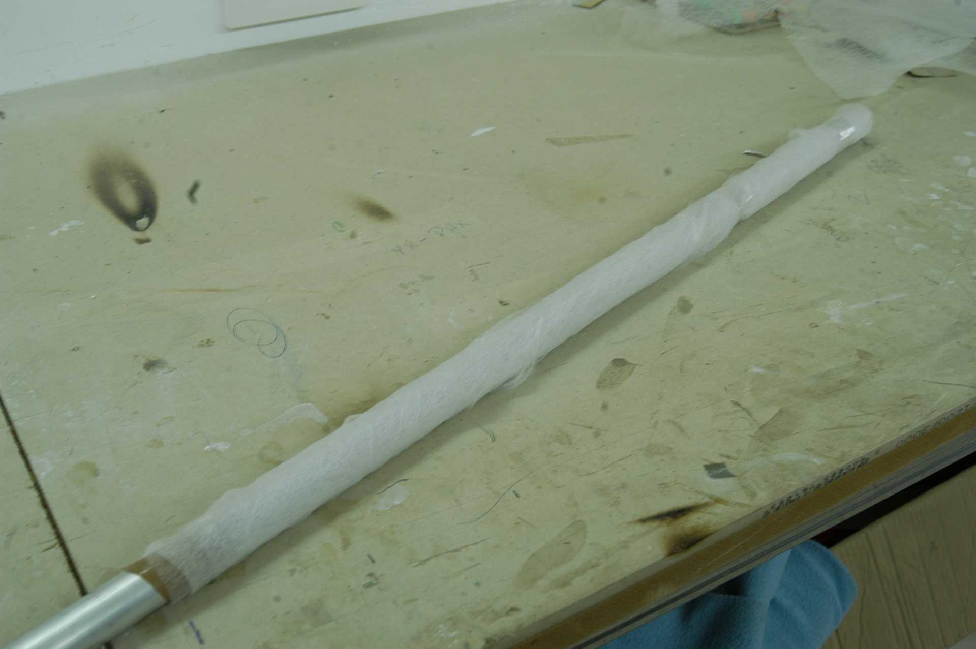

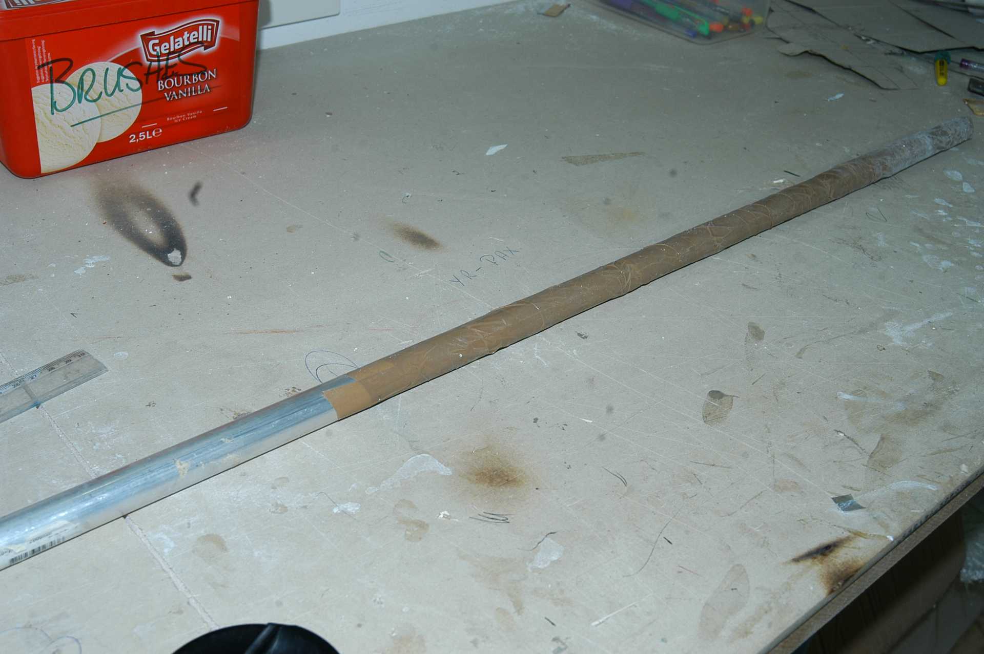

This morning I got Nat to give me a hand or two to get up to my little shed, once there I could rest on my chair which is on casters and move around a little
Anyway I managed to experiment with making a wing outer tube on a ally tube, I wrapped the ally tube with brown parcel tape sticky side out, then three wraps of some glass cloth I found, then sloshed some resin on it;
But I used the wrong cloth as it all pulled apart when I brushed the resin on, did not matter as it was only to see if I could actually get it off the pipe when it set
to my surprise it came off , so I will do another one to see if I can do a better job of it
onwards and upwards got to get the left hand side better trained :whistle:

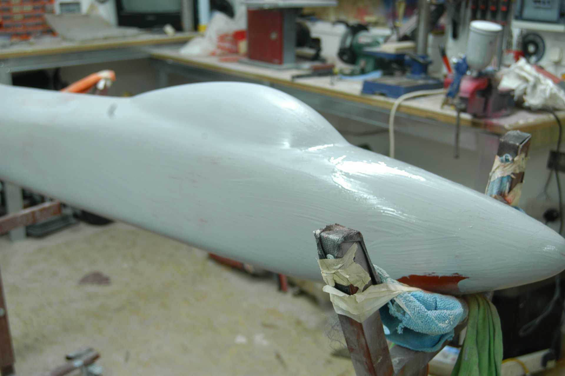

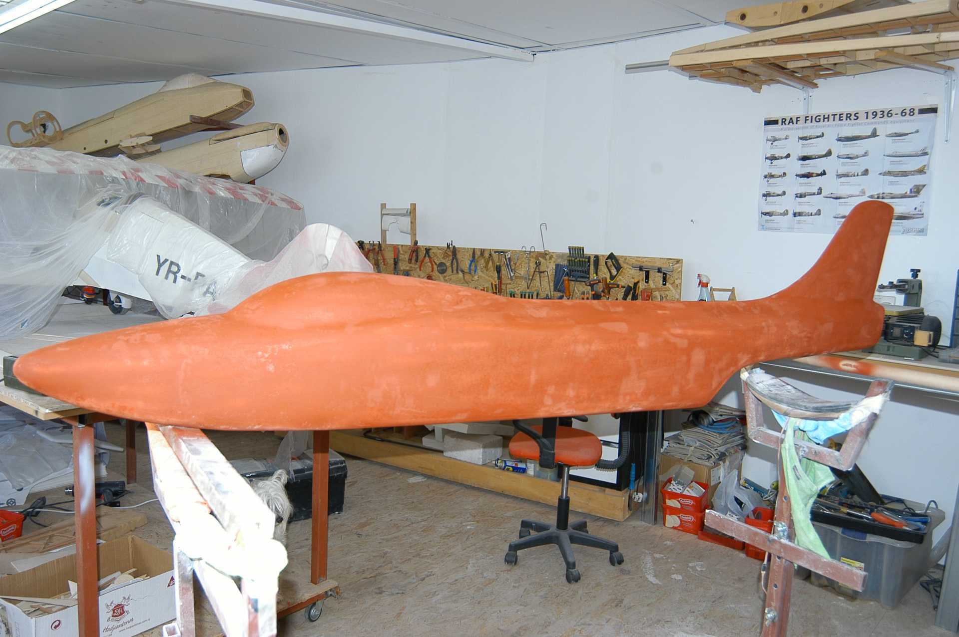

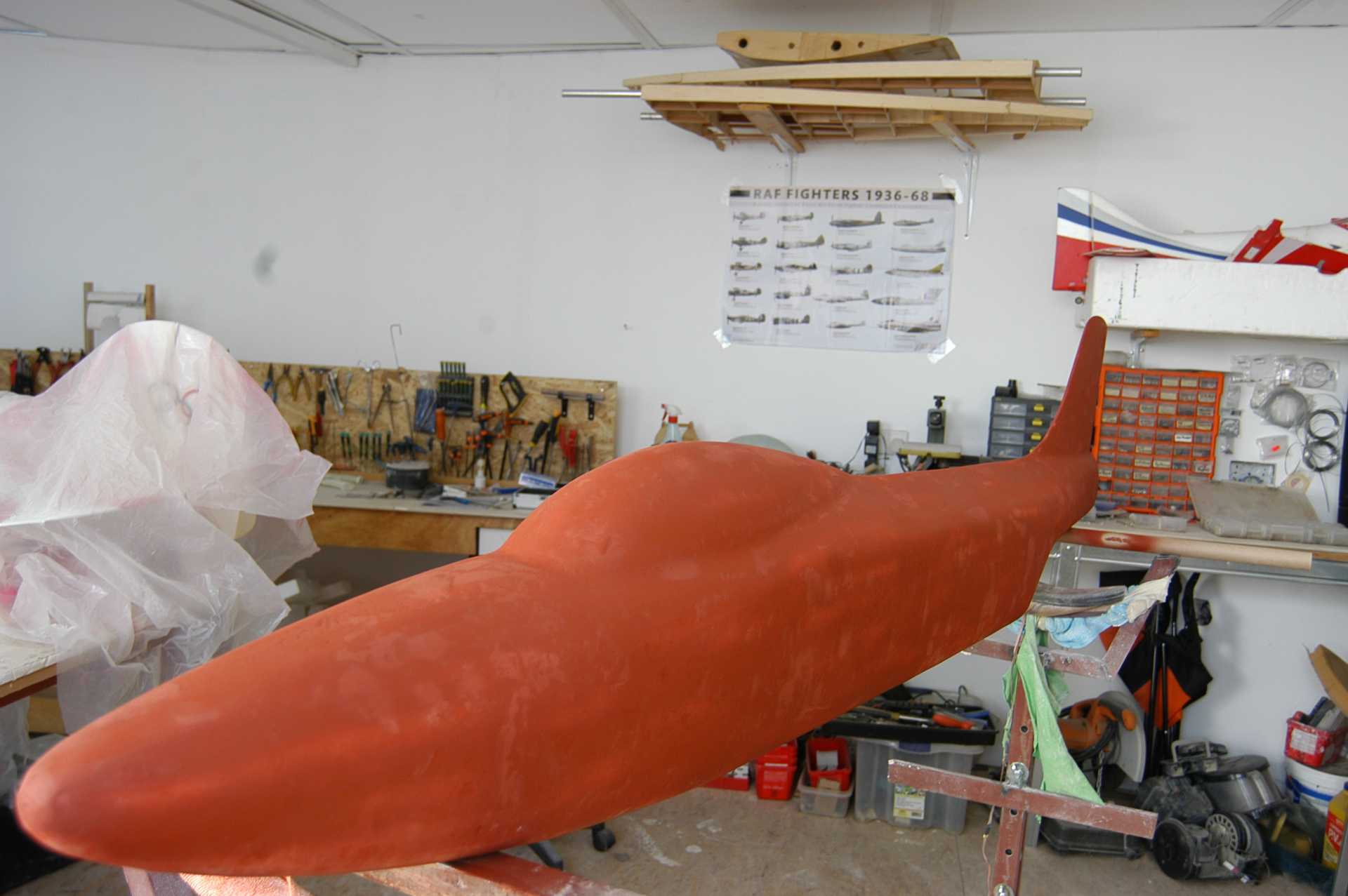

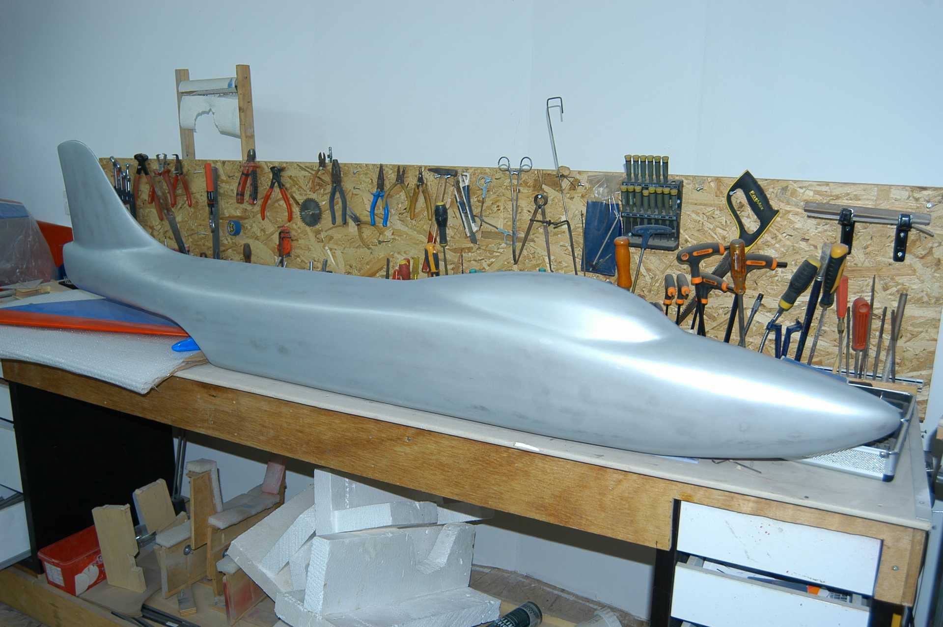

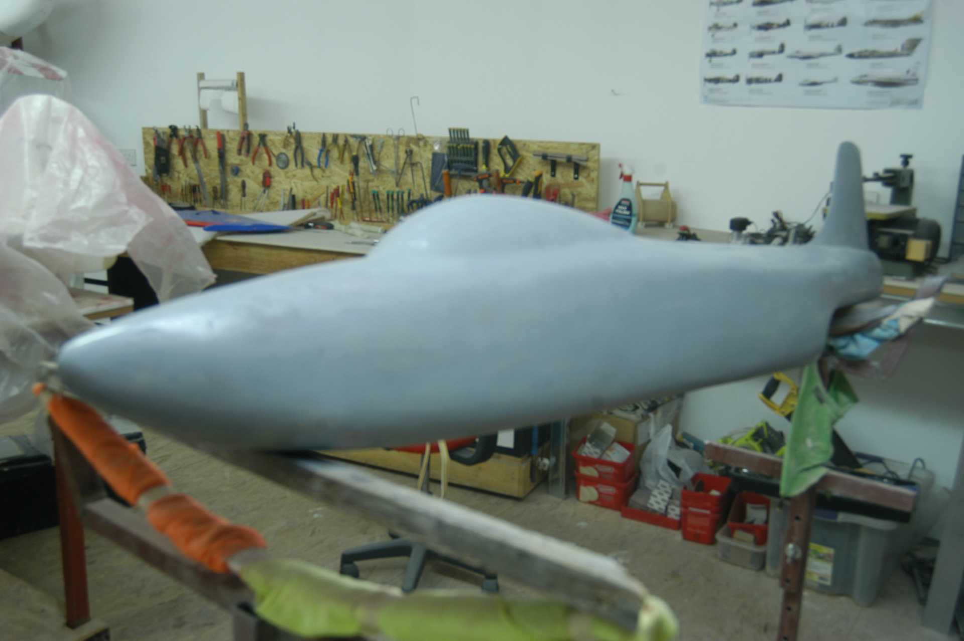

15 Feb 2017 18:29 #67 by THE BLACKBIRD
Filled it with P 38 then rubbed it down ( good exercise for my left hand / arm ) sprayed it grey primer
then filled it again rubbed it down then sprayed it red primer
same again this time white primer
then did it all again finished grey primer again
In the morning ill rub it down then then do as many times as needed with primer filler rubbed down each coat

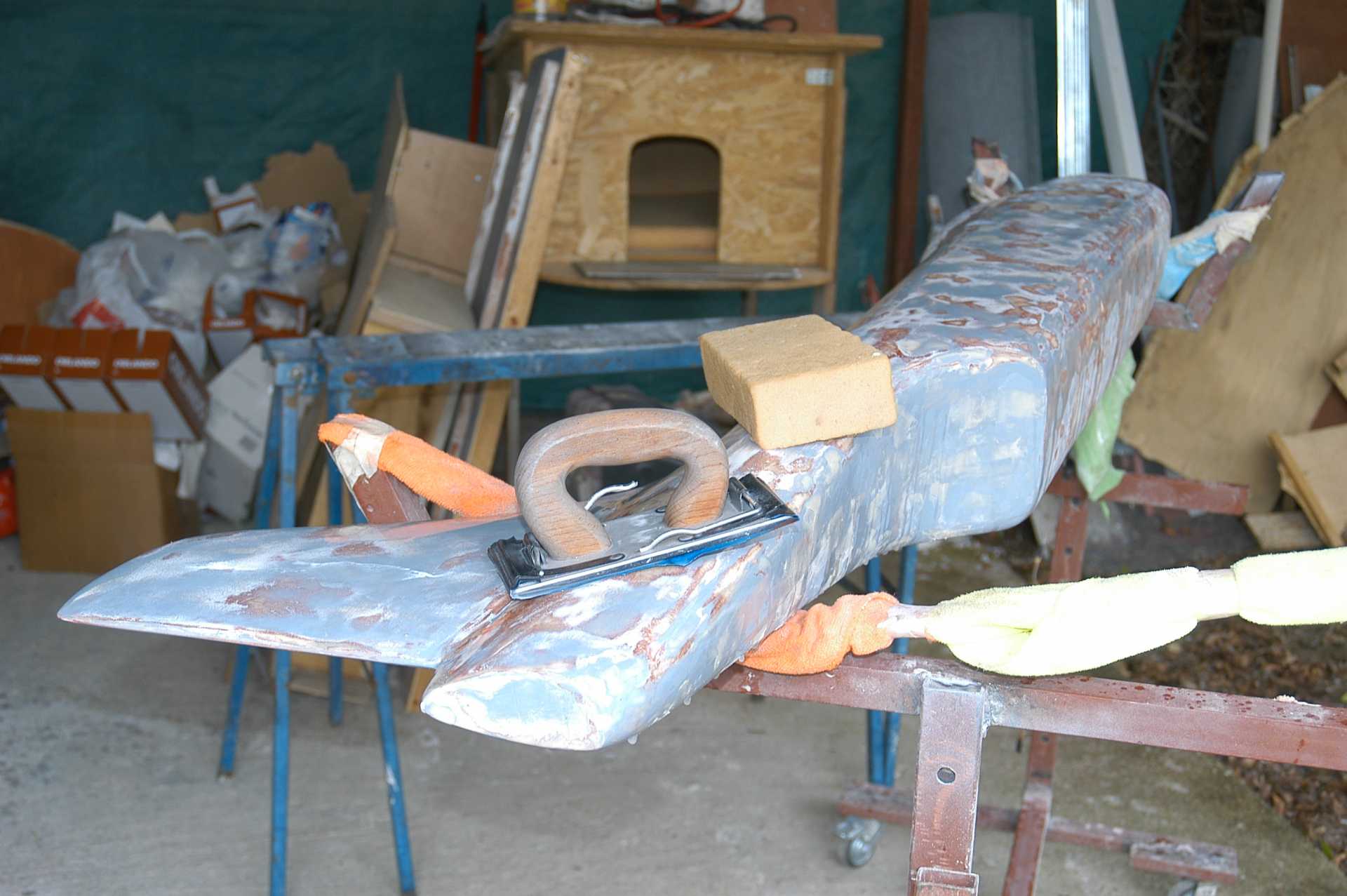

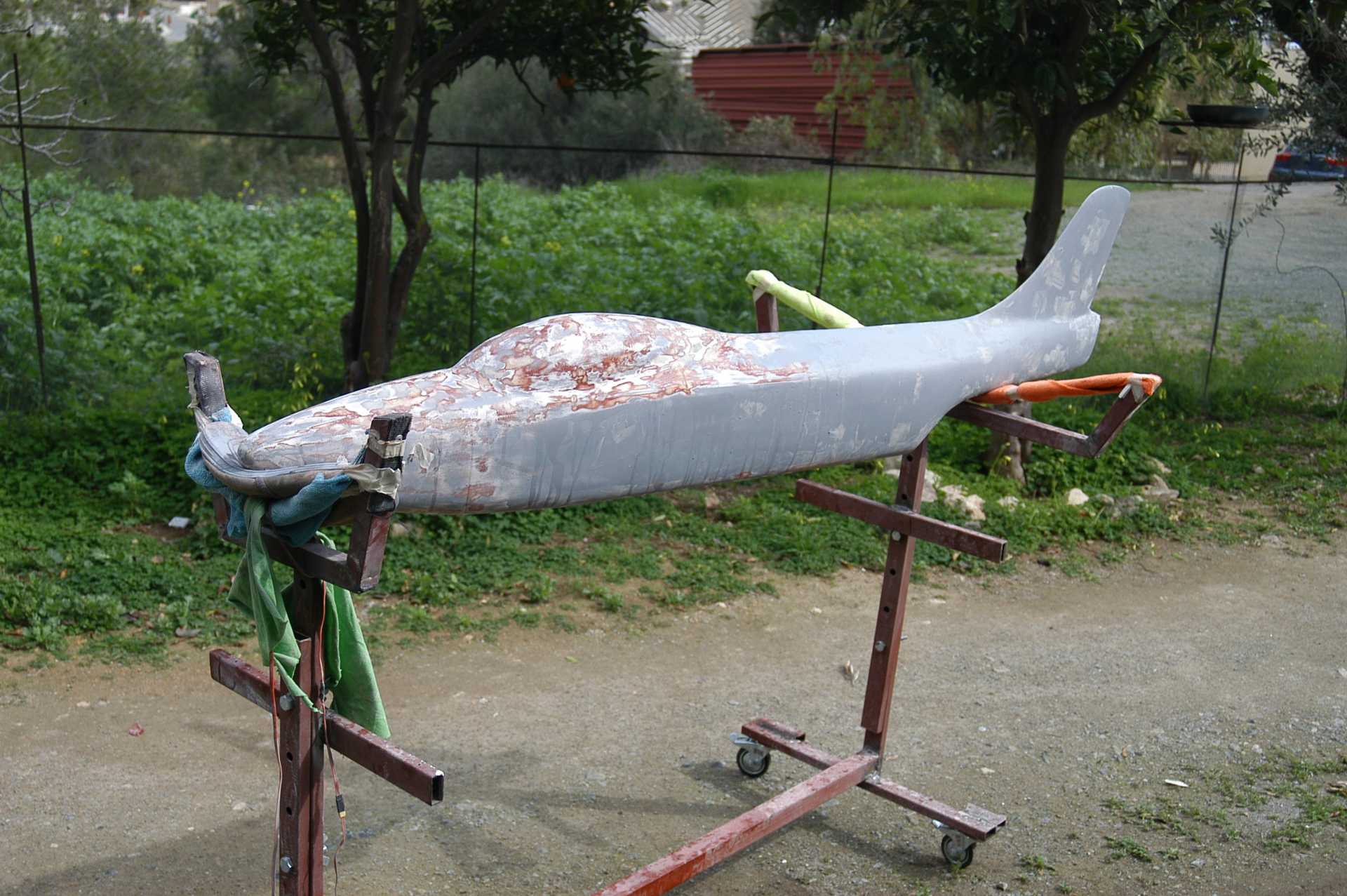

16 Feb 2017 18:51 #71 by THE BLACKBIRD

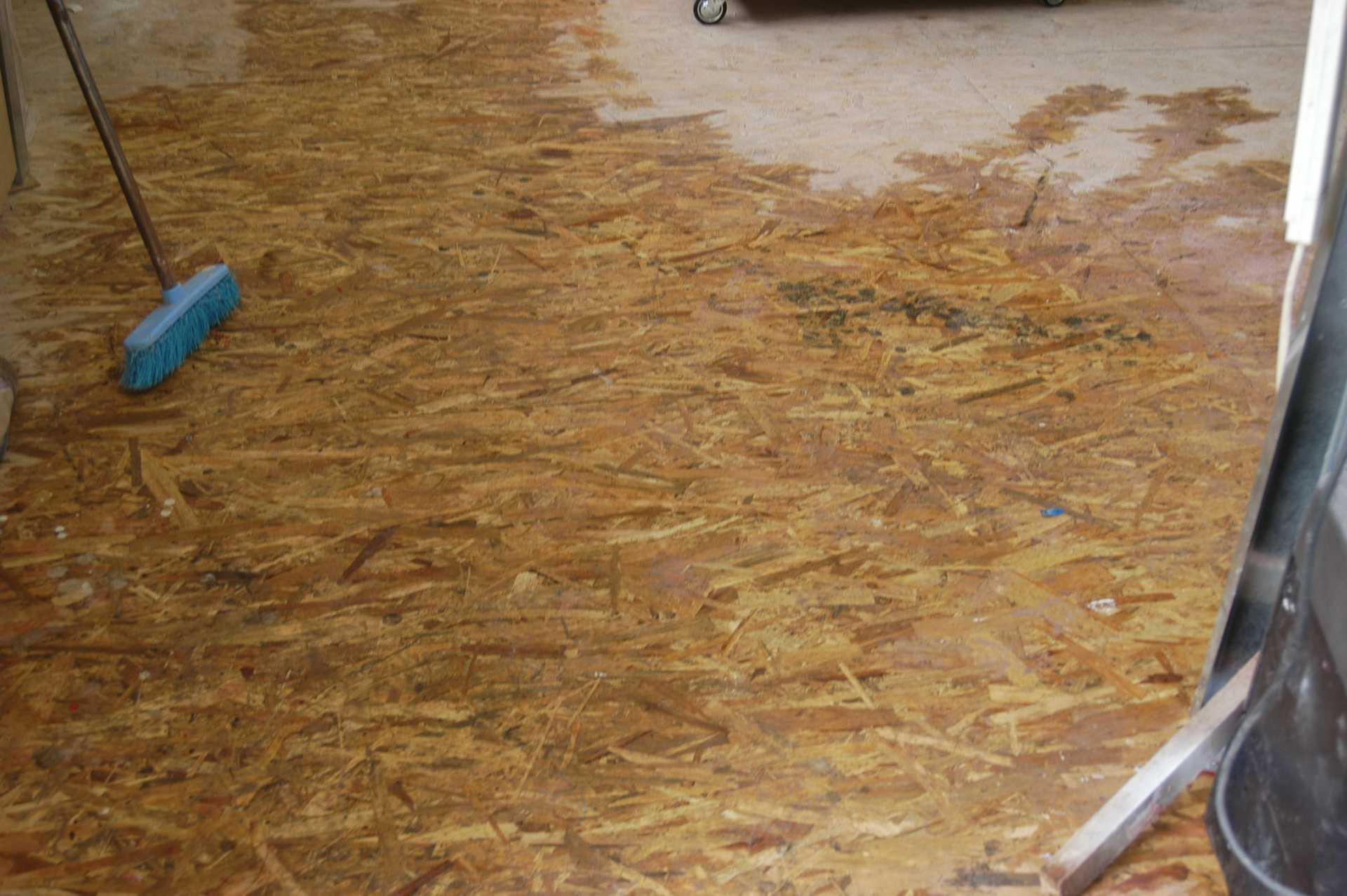

did some more this morning spent a couple of hours looking for and filling any blemishes
Then thought I would rub it down with wet & dry just started to rub it and the big bucket I Was using for the water decided it would part from its handle :( a lot of water all over my wood floor
Which is not good for it, shovelled as much out the door as I could then decided I would do it outside in the sunshine
Got started then it rained :angry: so had to move back under cover
finally got it cut back ready to spray with primer filler only to find my spray gun would not spray it for some reason, it worked ok when I did the Lancaster, so I slopped it on with a brush
Don't matter as I will sand it all off in the morning leaving on only what is in low spots

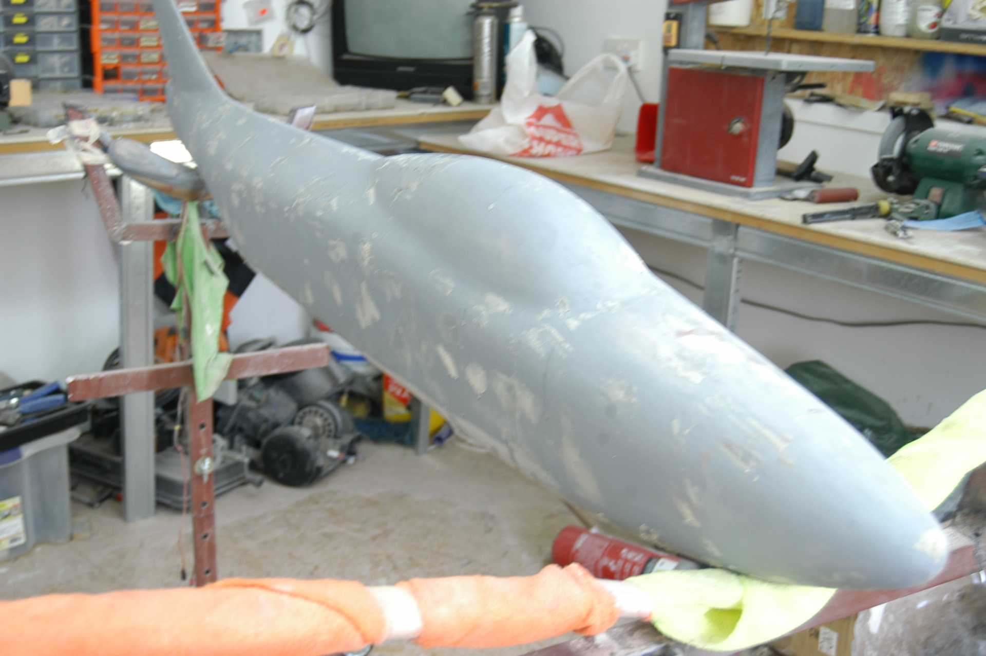

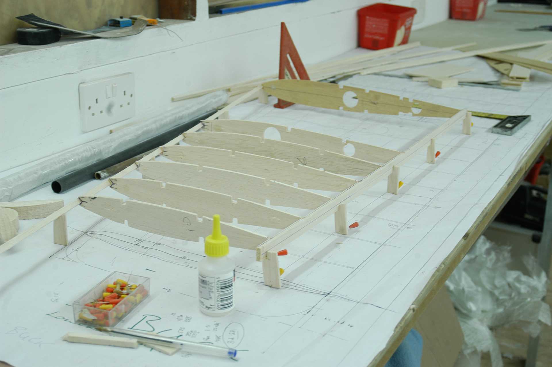

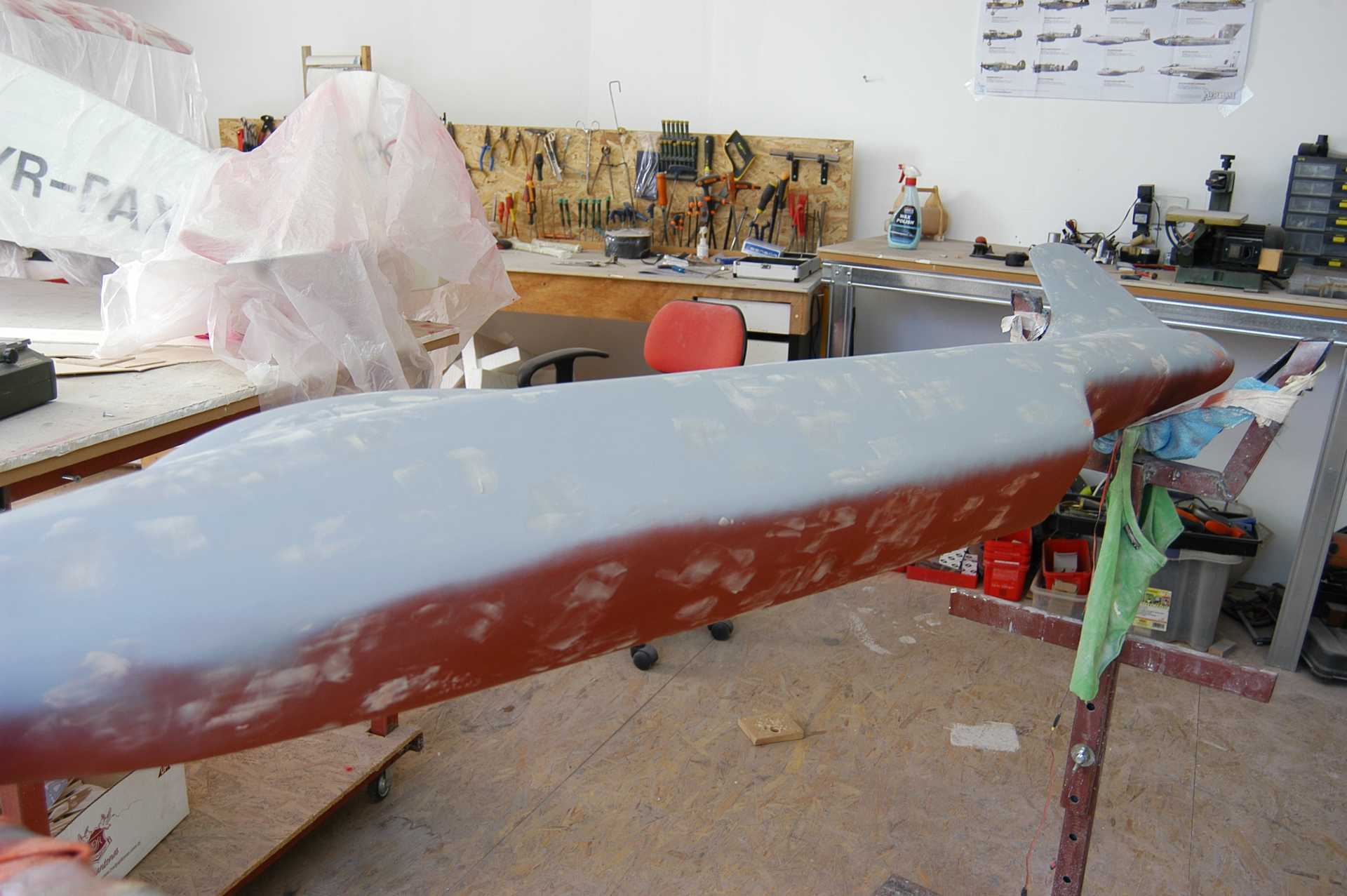

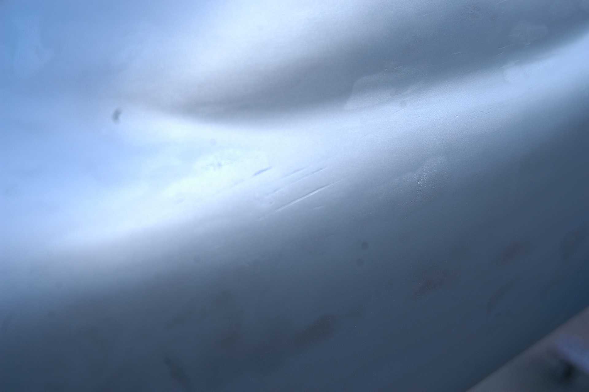

19 Feb 2017 19:31 #72 by THE BLACKBIRD
Im still filling sanding and painting, seem to be chasing shadows, every time I paint it it shows up more imperfections :S
I think it may be the p38 filler that im using, I think it is coming out of the tiny marks when I wet & dry it
I will use something else tomorrow
So I made a start on the wings, cut out the ribs, stripped some spars from 6mm sheet and stated to assemble

20 Feb 2017 04:05 #73 by one tenor
Use stopper ( like thick primer ) Also called knifing stopper.Fills all minor scuff ,scratches etc and leaves a silky smooth finish.Get it from Halfords etc
20 Feb 2017 12:51 #74 by Eric
Replied by Eric on topic Own design and build sports turbine jet
I doubt that there's a Halfords in Cyprus, O.F!
BB, try using more water and less pressure, on the wet and dry. It looks like you are getting 'beads' of residue, which are then scouring the finished surface! Also try using a much finer grit!
