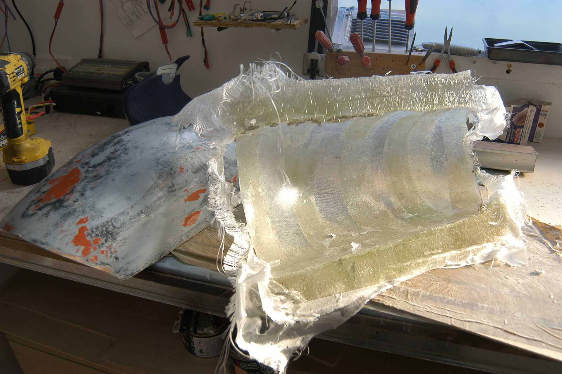

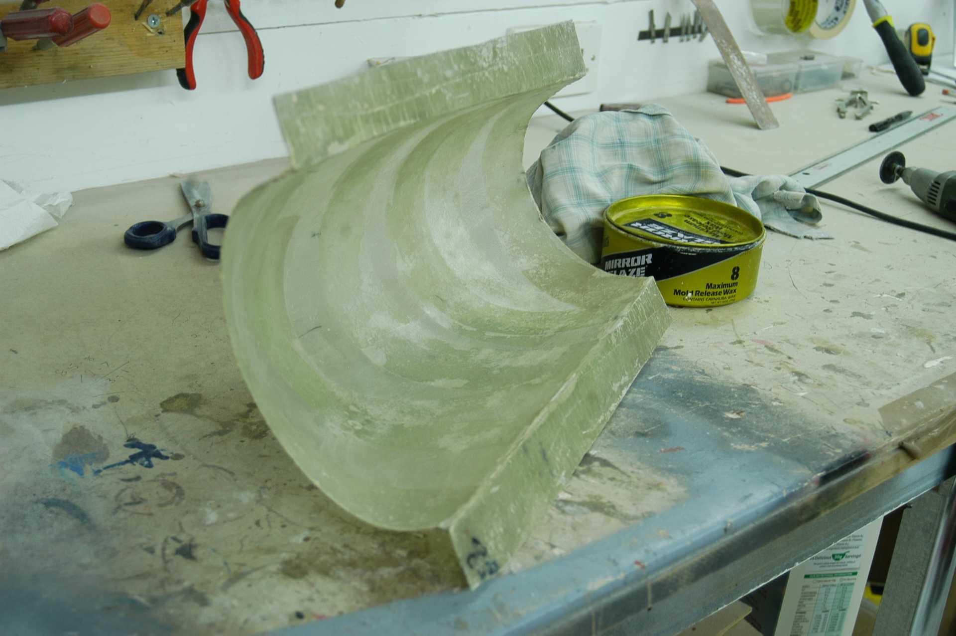

The mould came out good well pleased with it
After cleaning it up
After 12 coats of polish, I will spray it with mould release tomorrow
Then I can cast the canopy

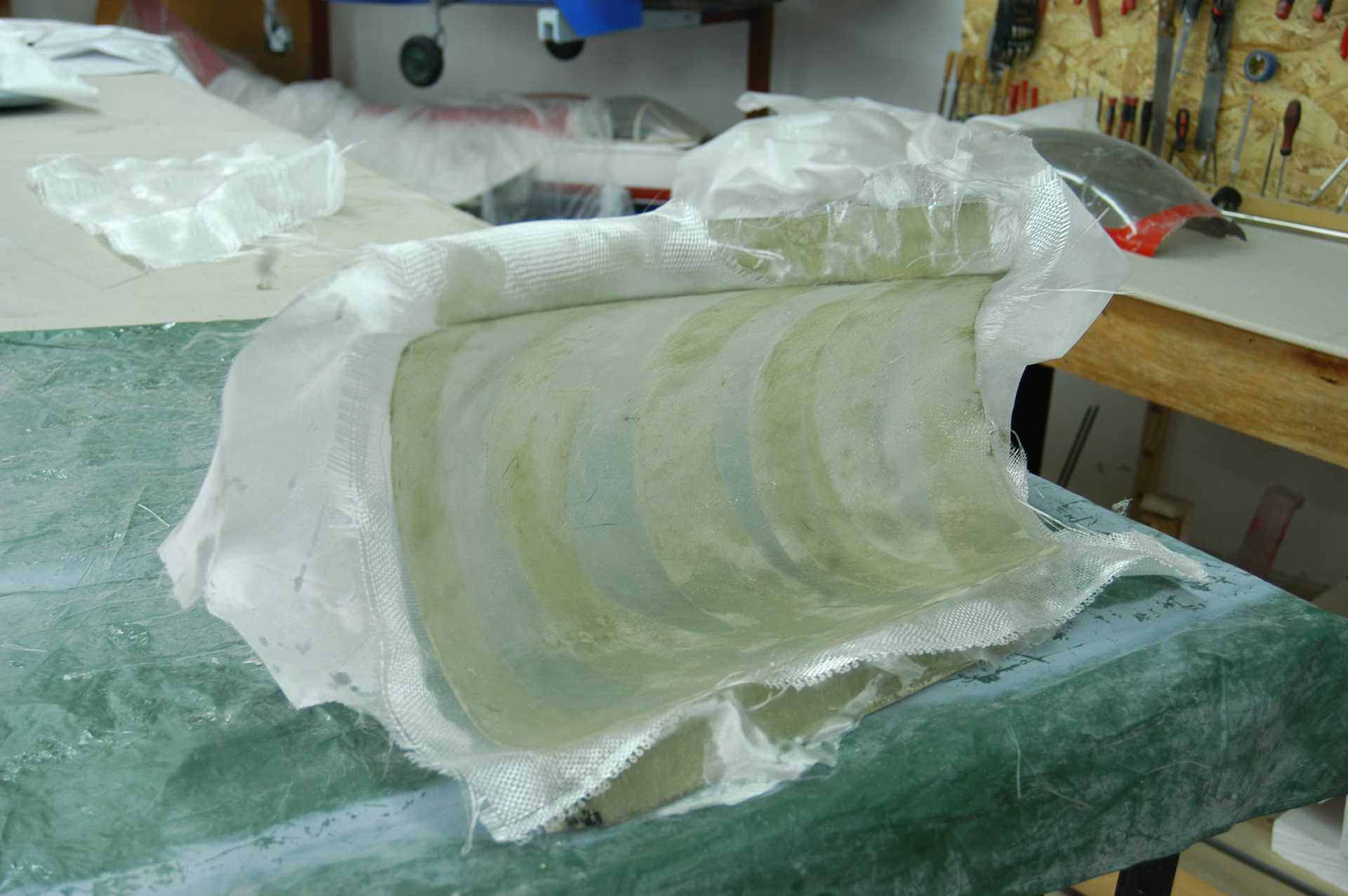

More done on the second wing

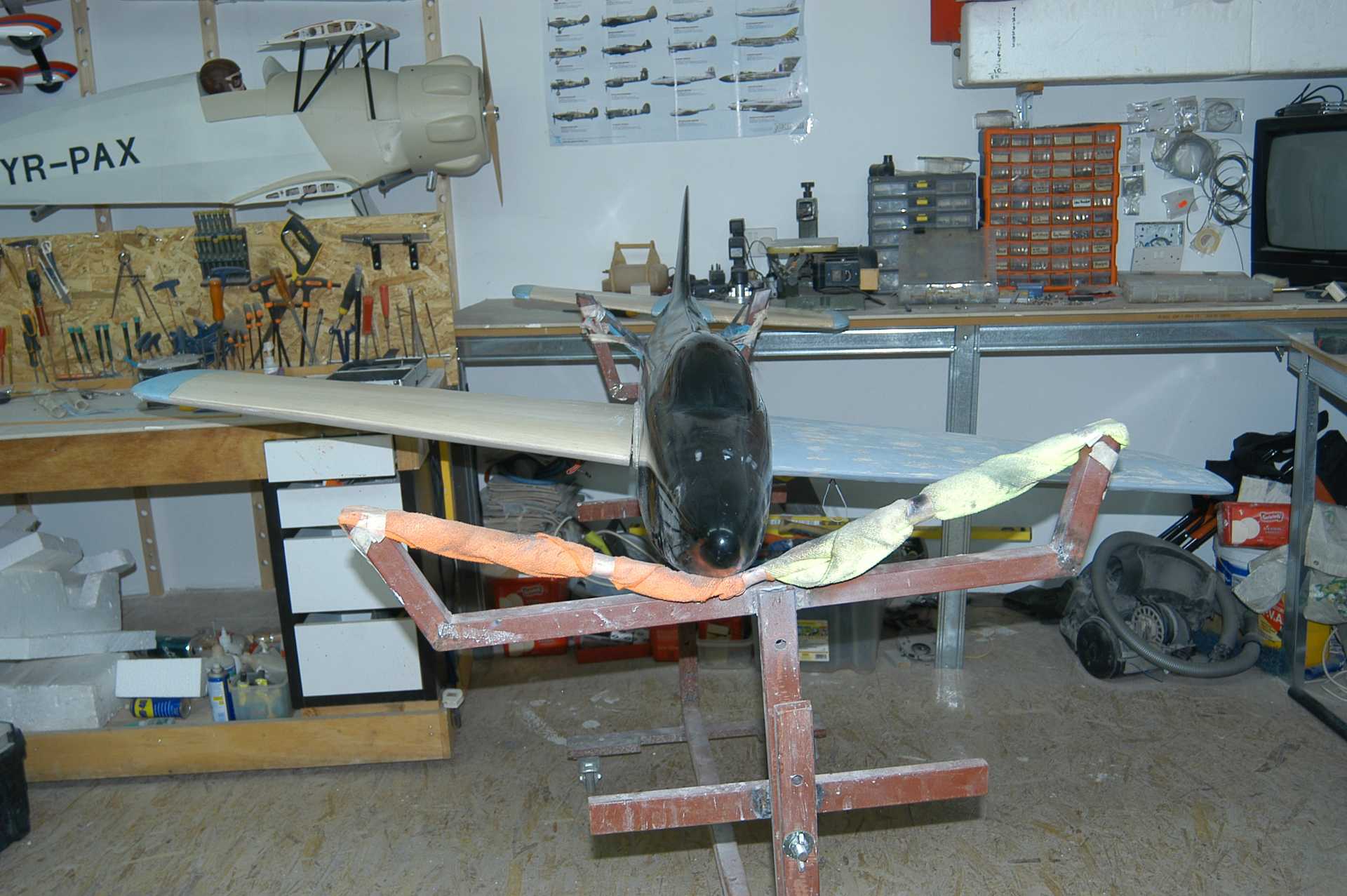

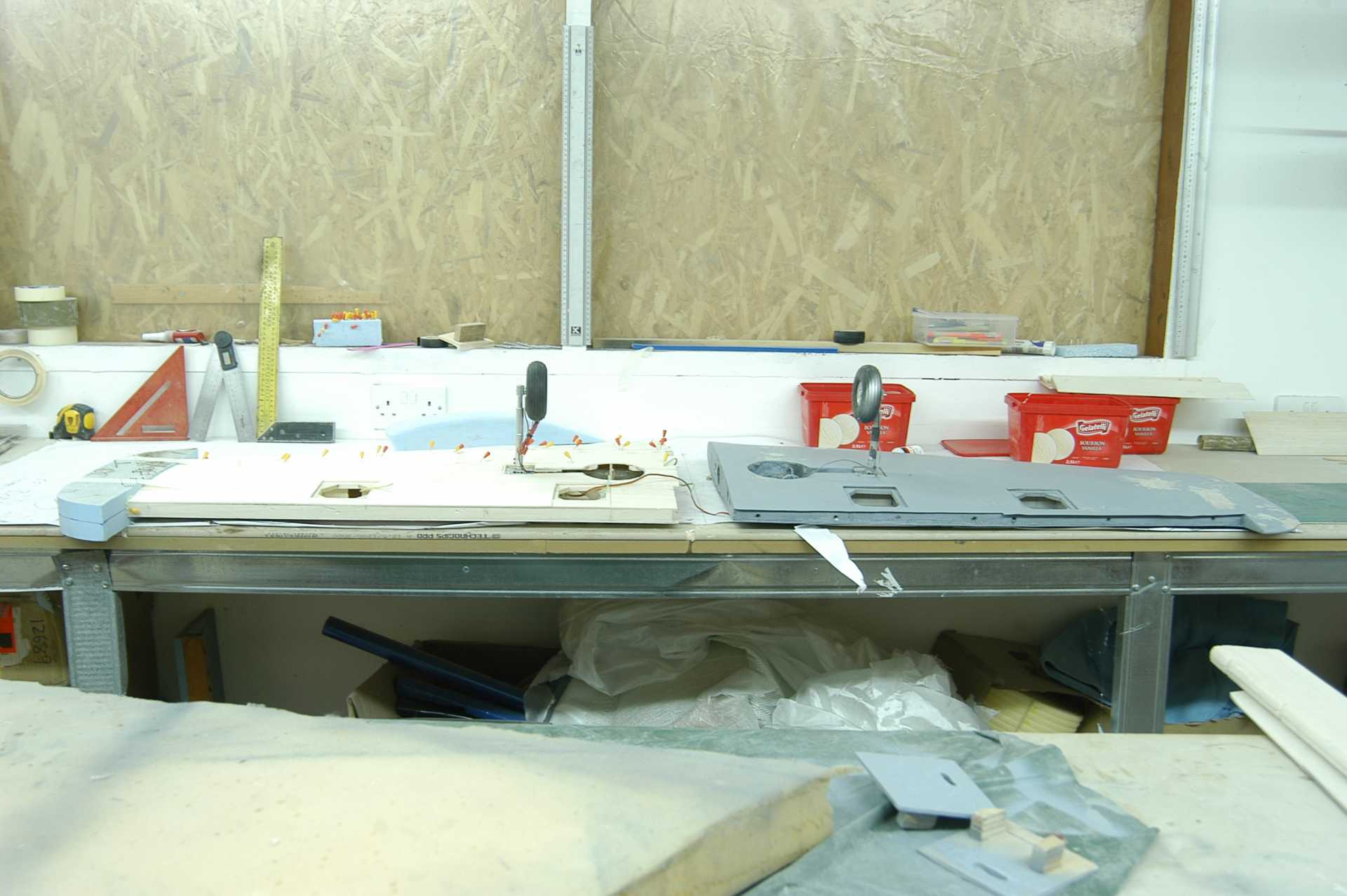

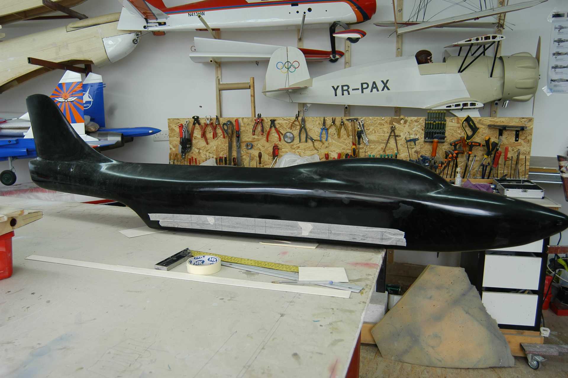

07 Mar 2017 20:09 - 07 Mar 2017 20:19 #109 by THE BLACKBIRD

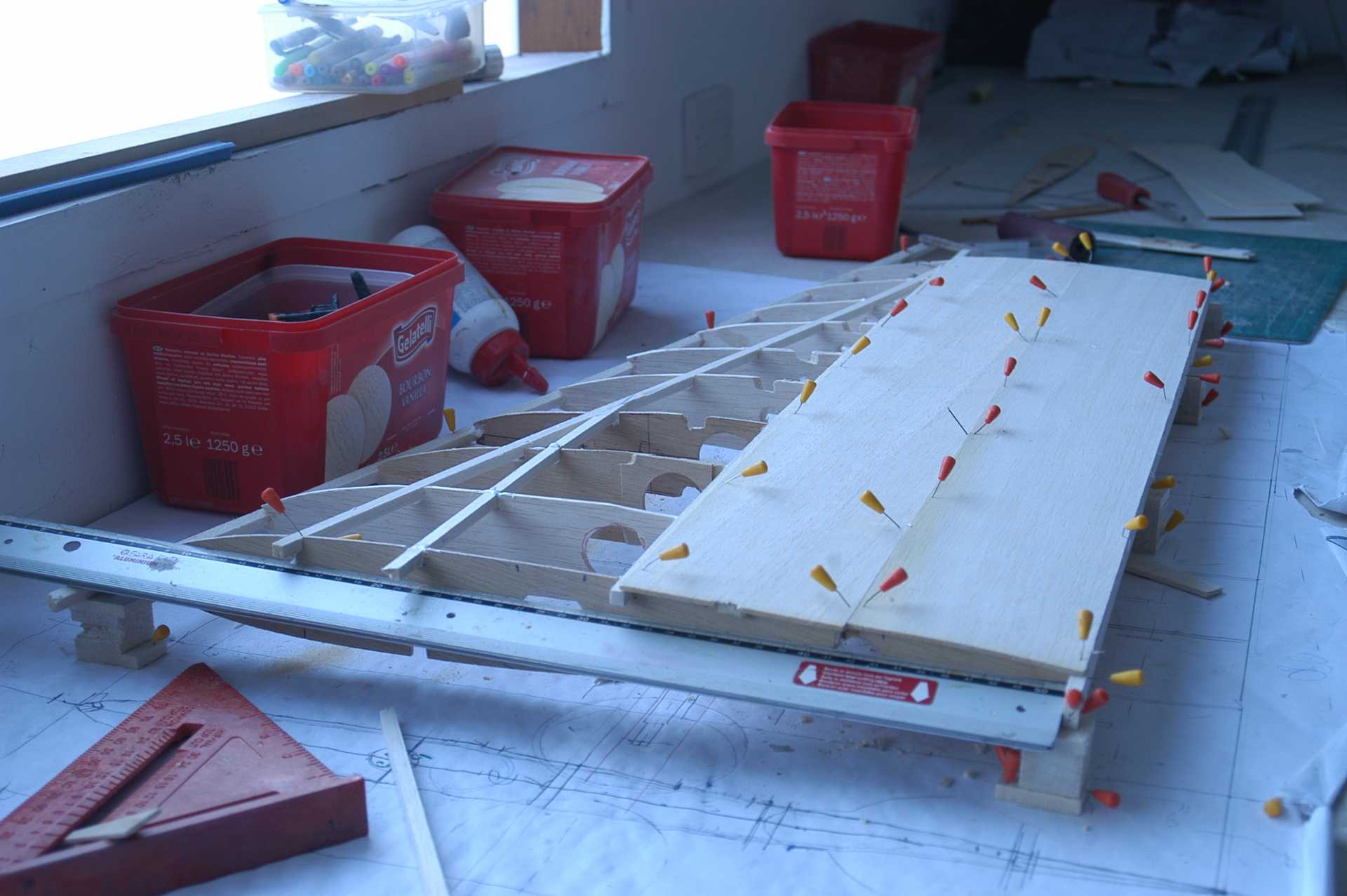

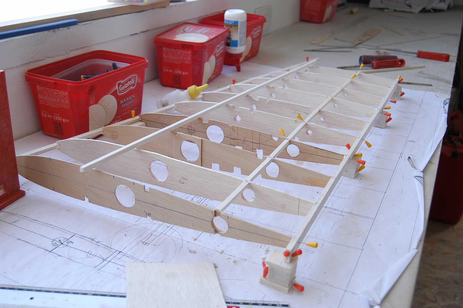

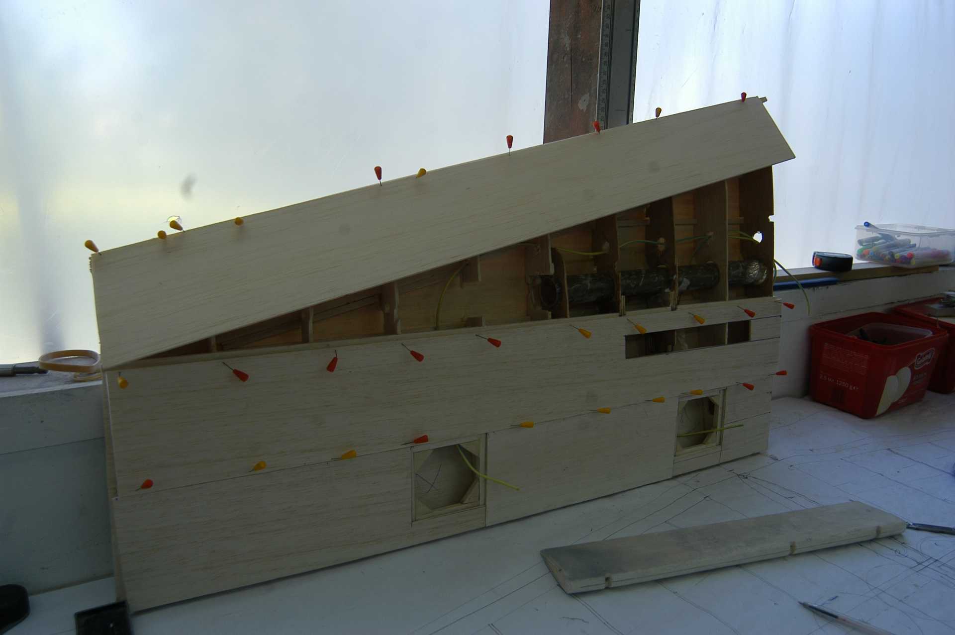

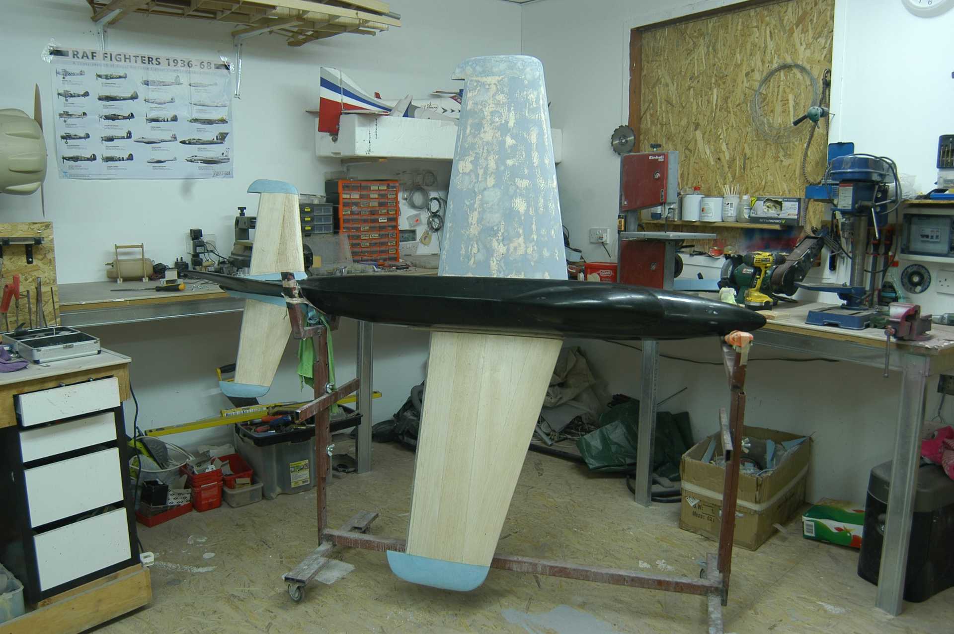

Got on with the wing construction today, got the other main leg made
And got the wing all complete
Need to sand it down and dry fit the flap and aileron

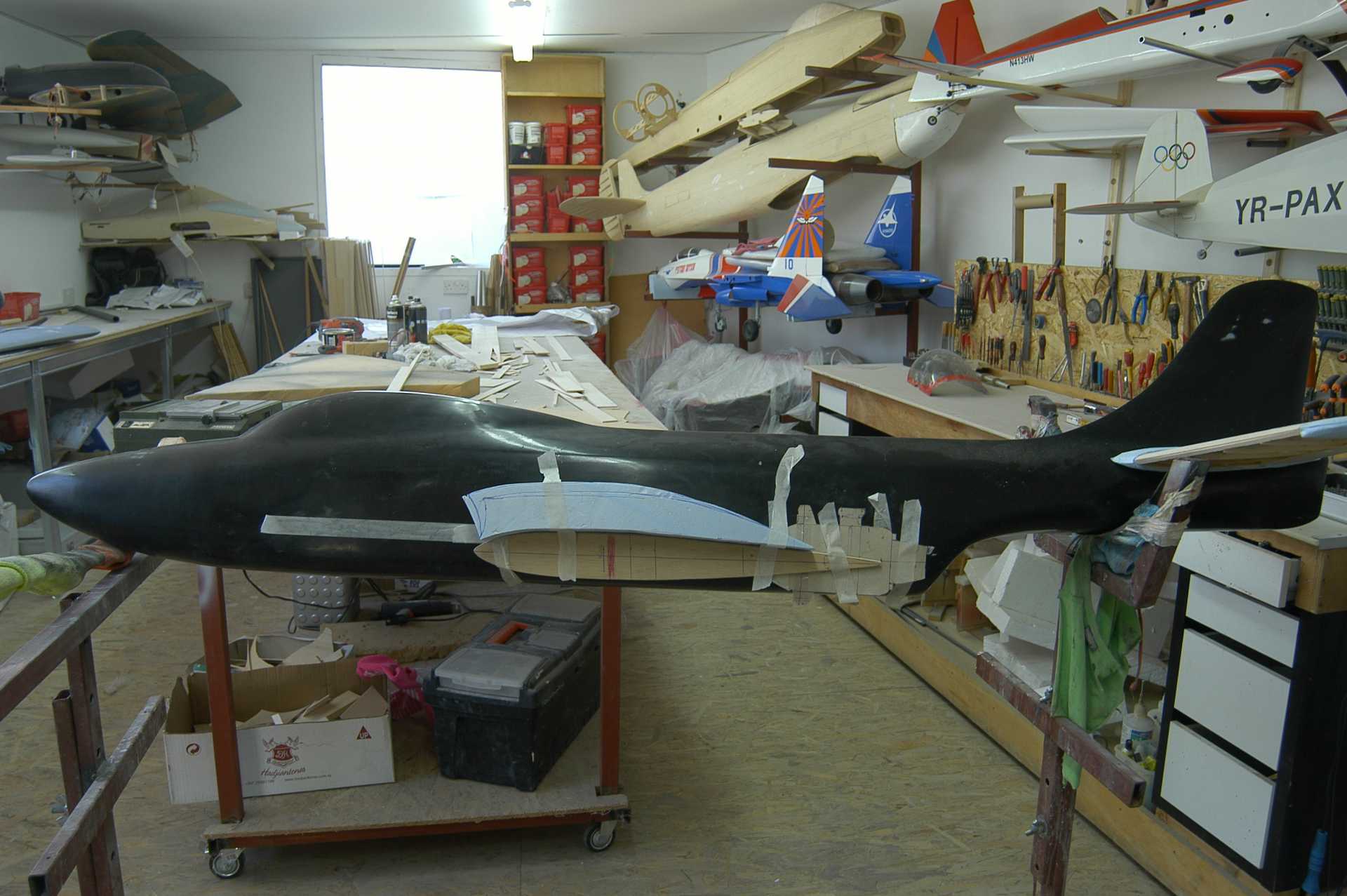

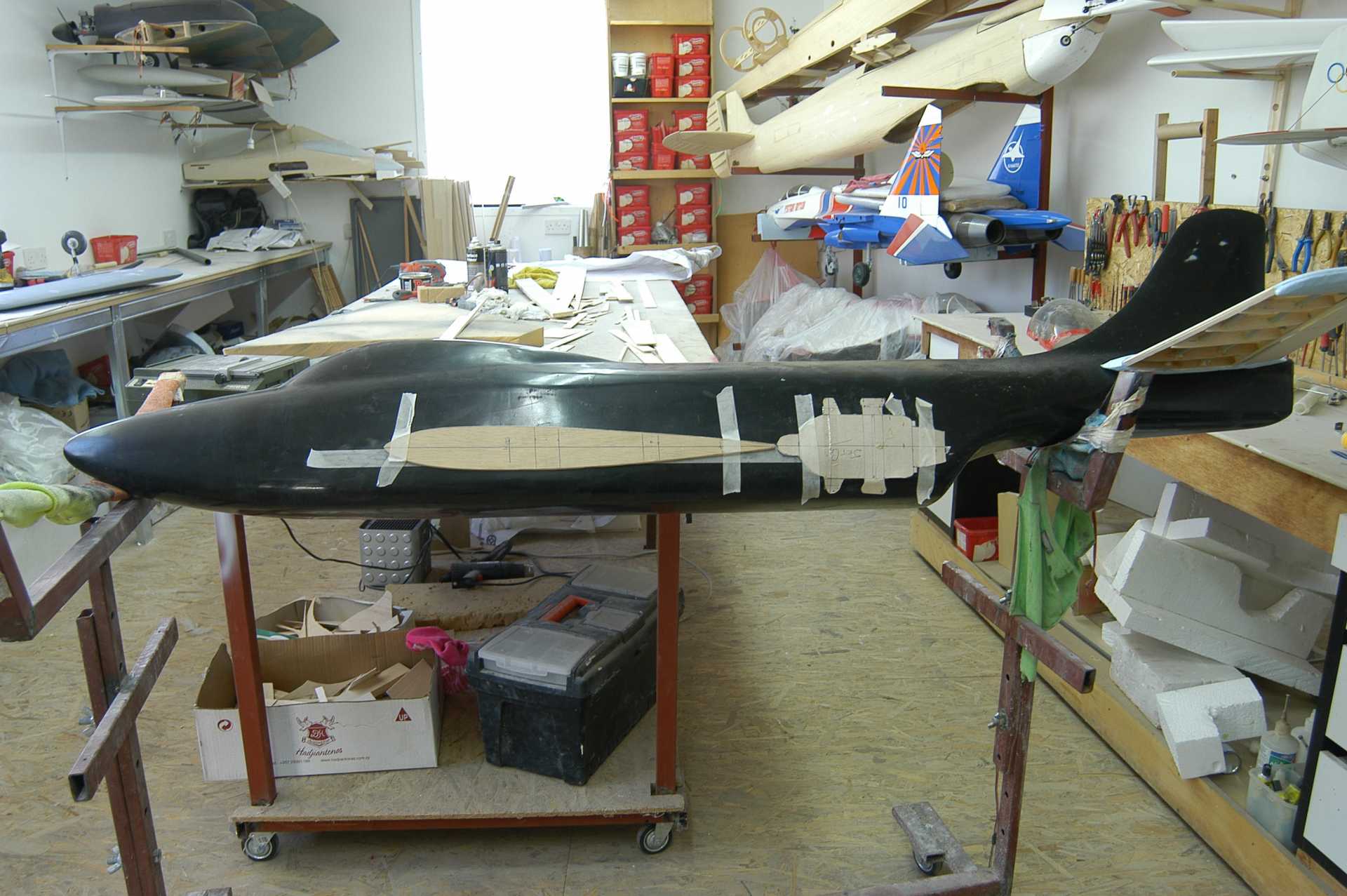

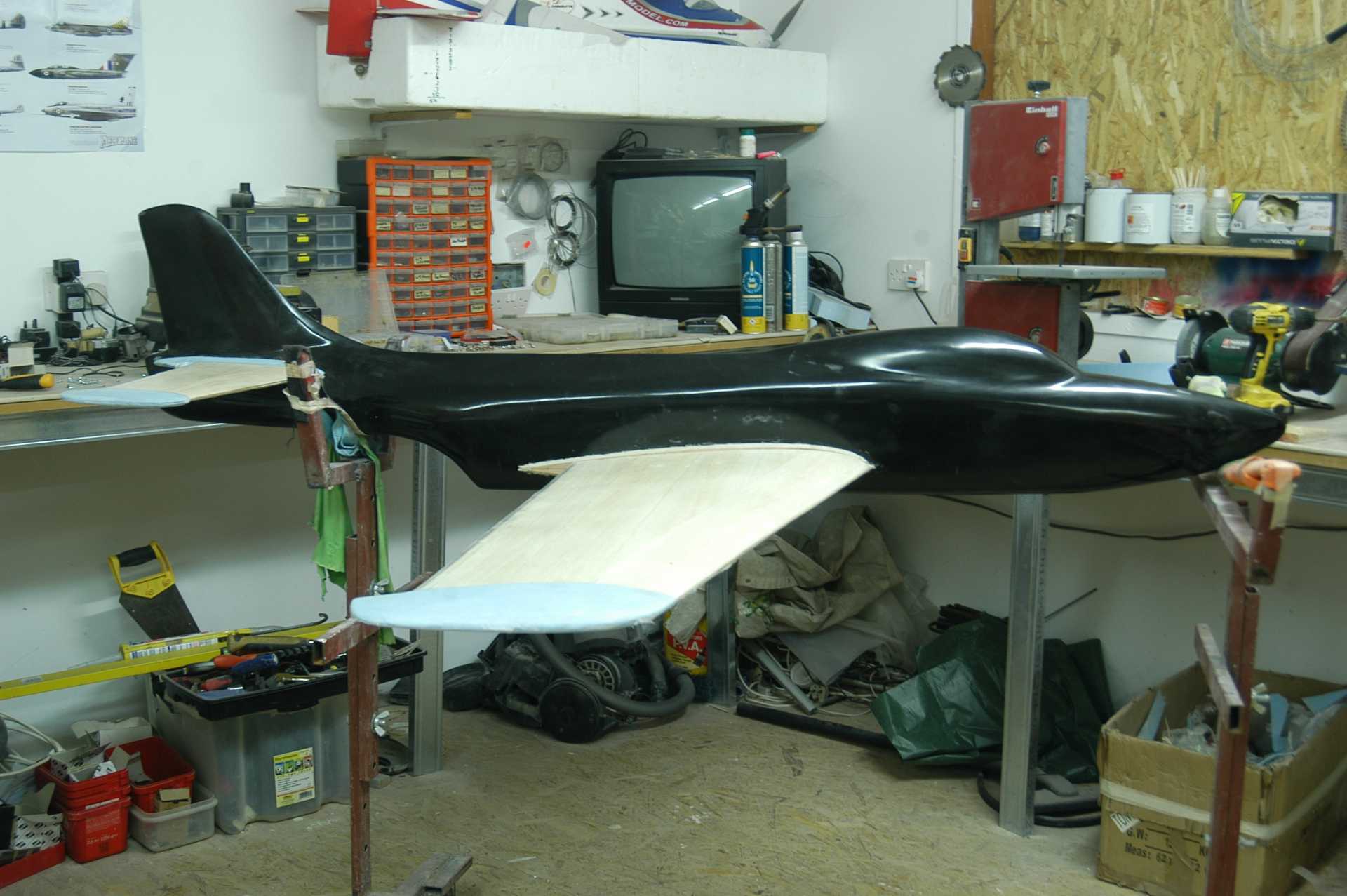

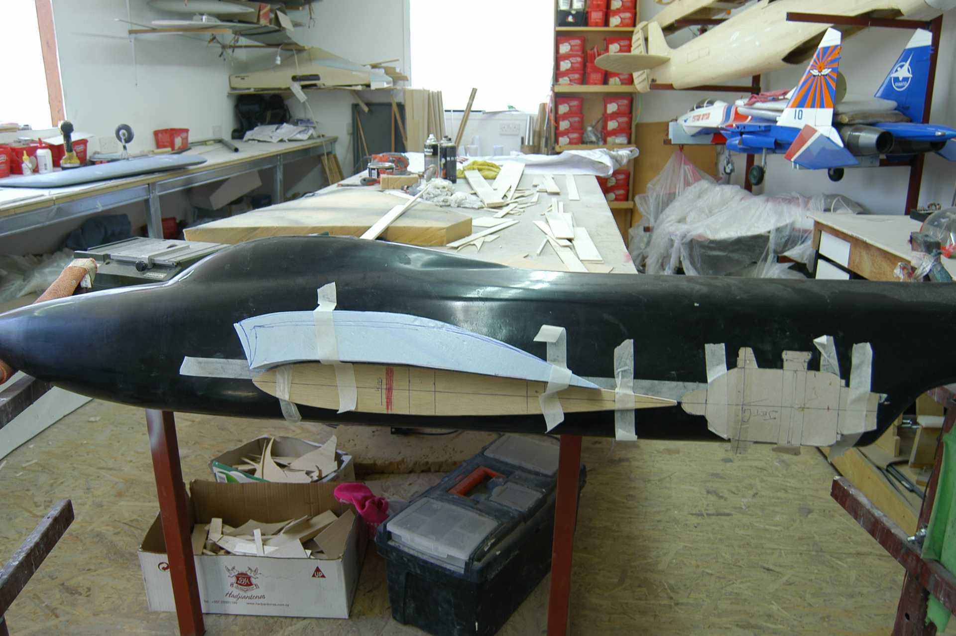

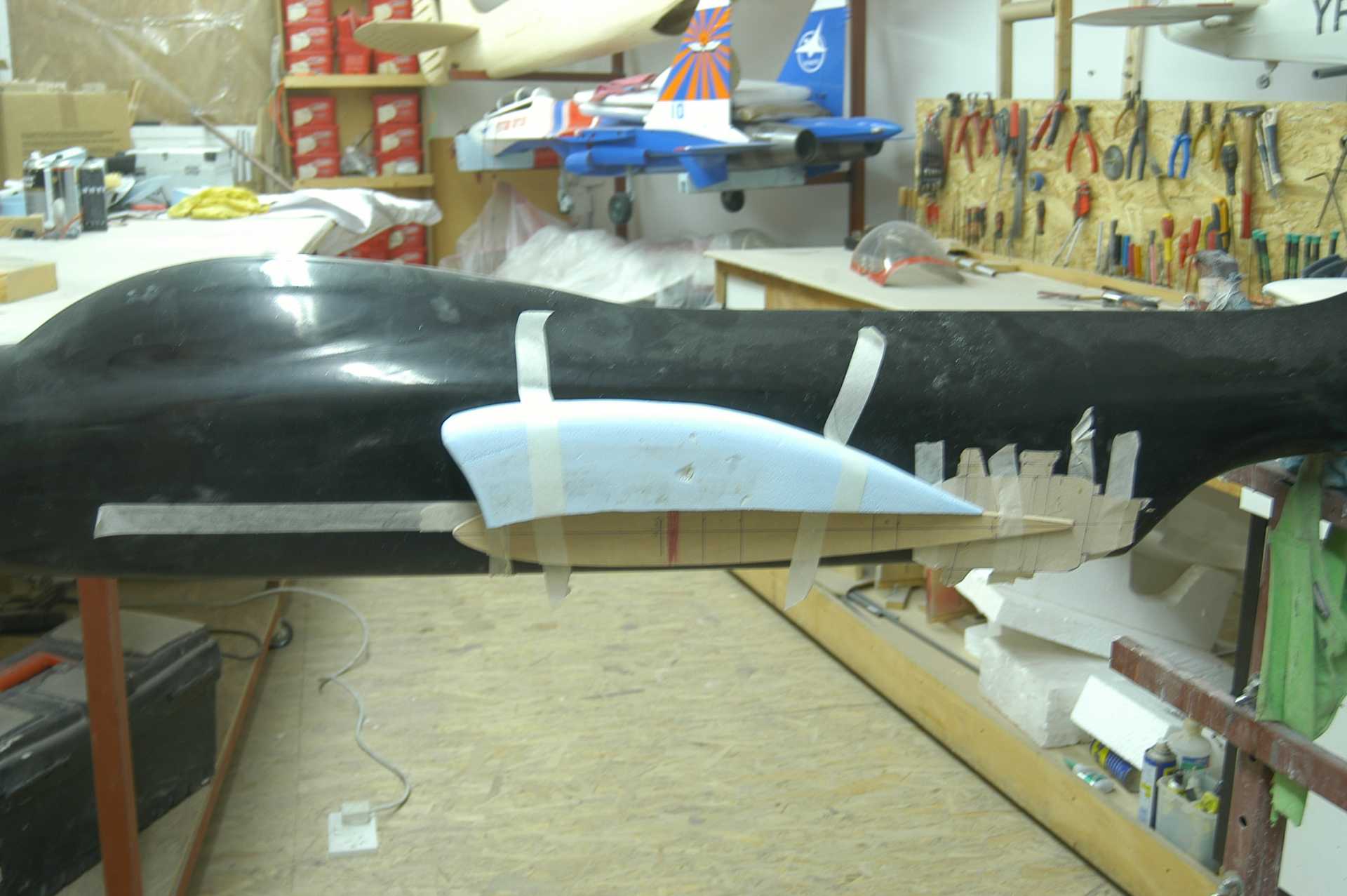

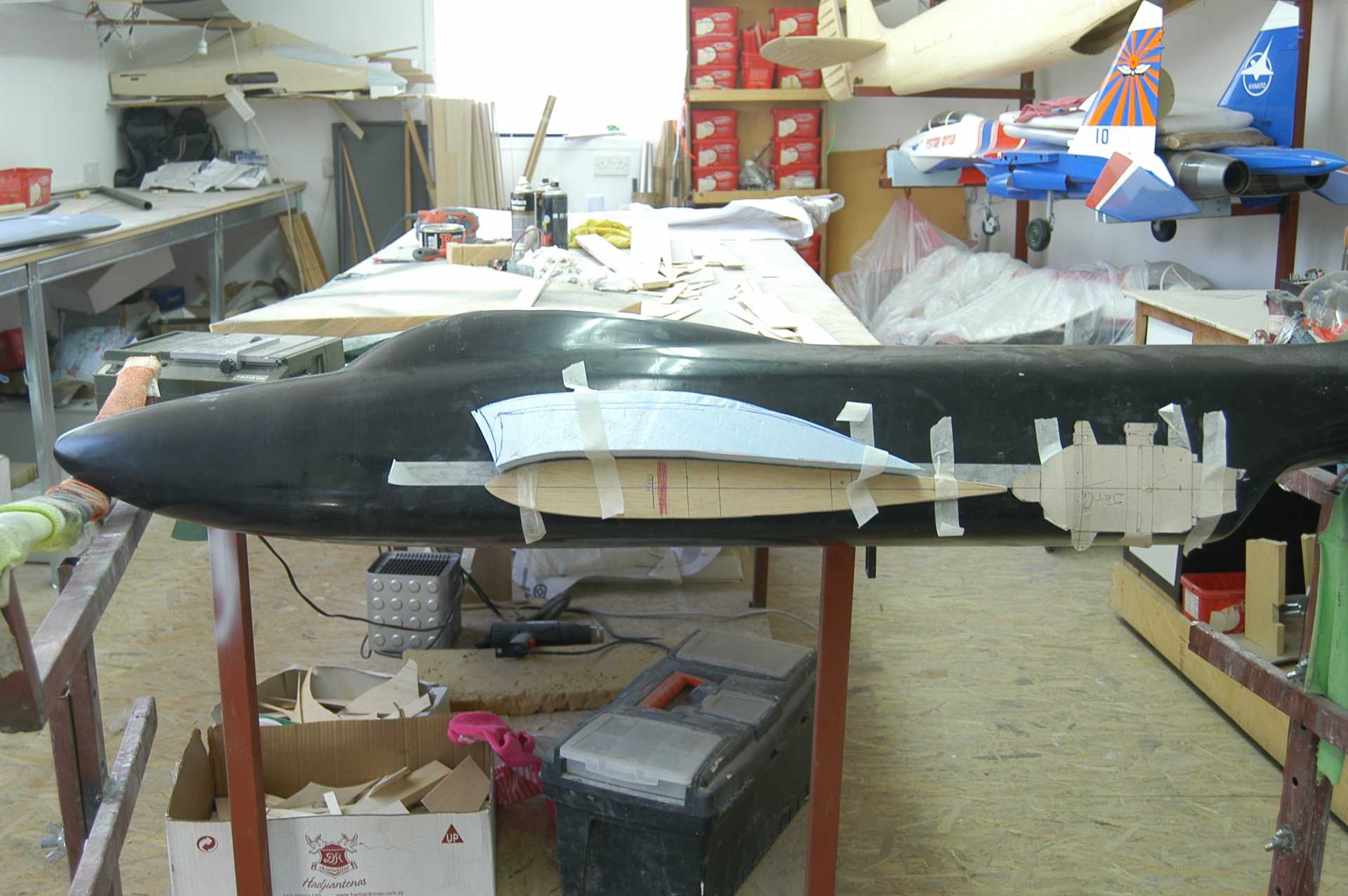

Had a play with the wing position and air intake
Or further back by 100mm
Or in a higher position
hment=16808]DSC_0003-102.jpg[/attachment]
Your thoughts on this please

07 Mar 2017 20:24 #110 by Ex-Member
Replied by Ex-Member on topic Own design and build sports turbine jet
fantastic project Tony.
i would go further back myself with the wing and intake.

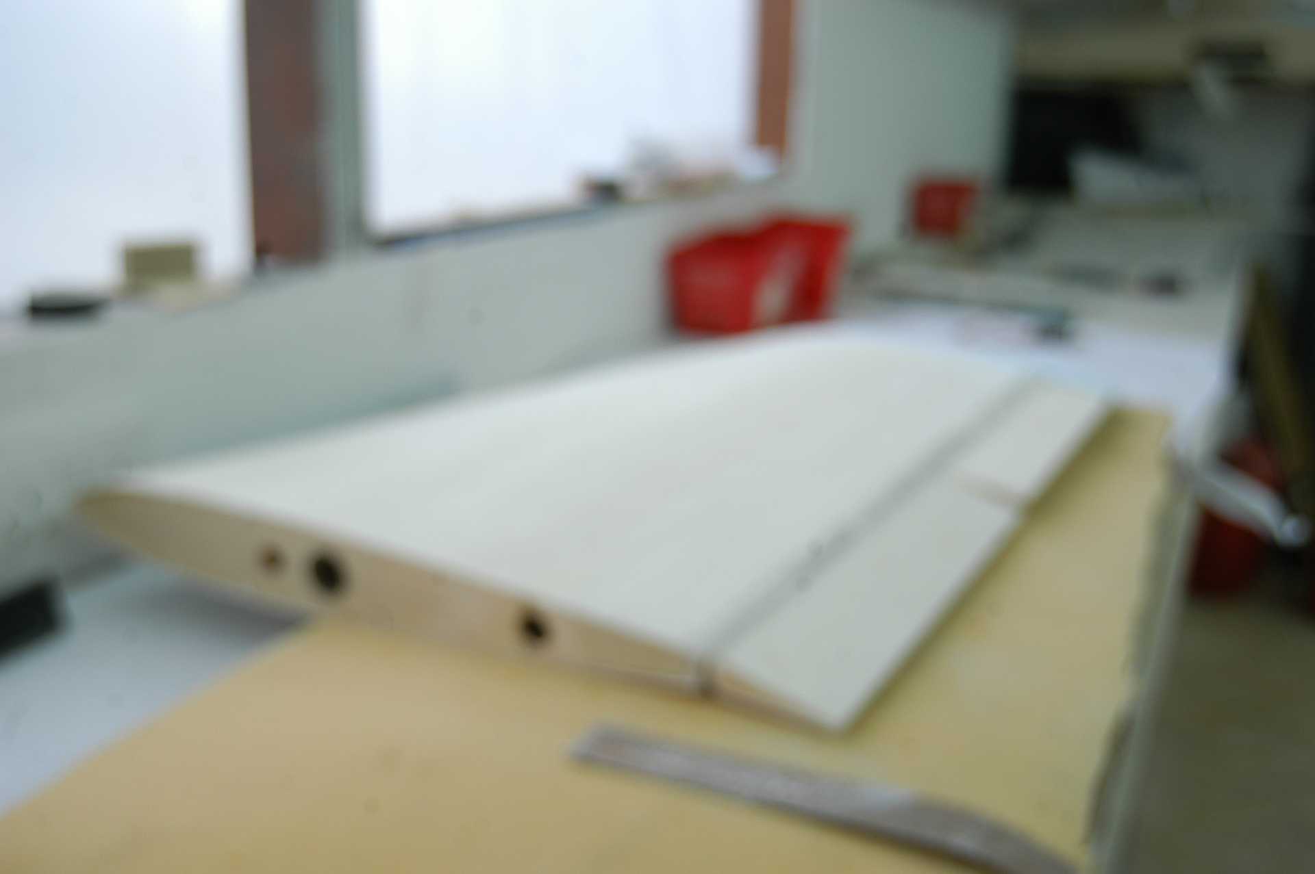

08 Mar 2017 19:57 #111 by THE BLACKBIRD
Another night without sleep, pain killers doing no good at all :sick:

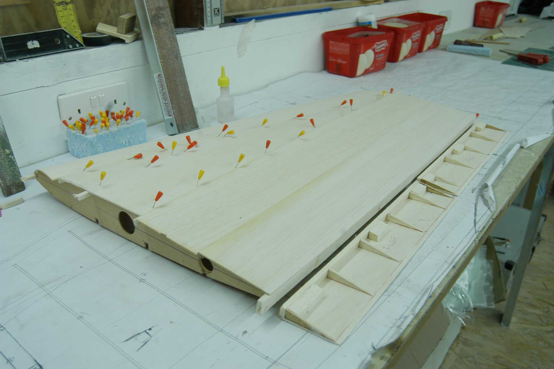

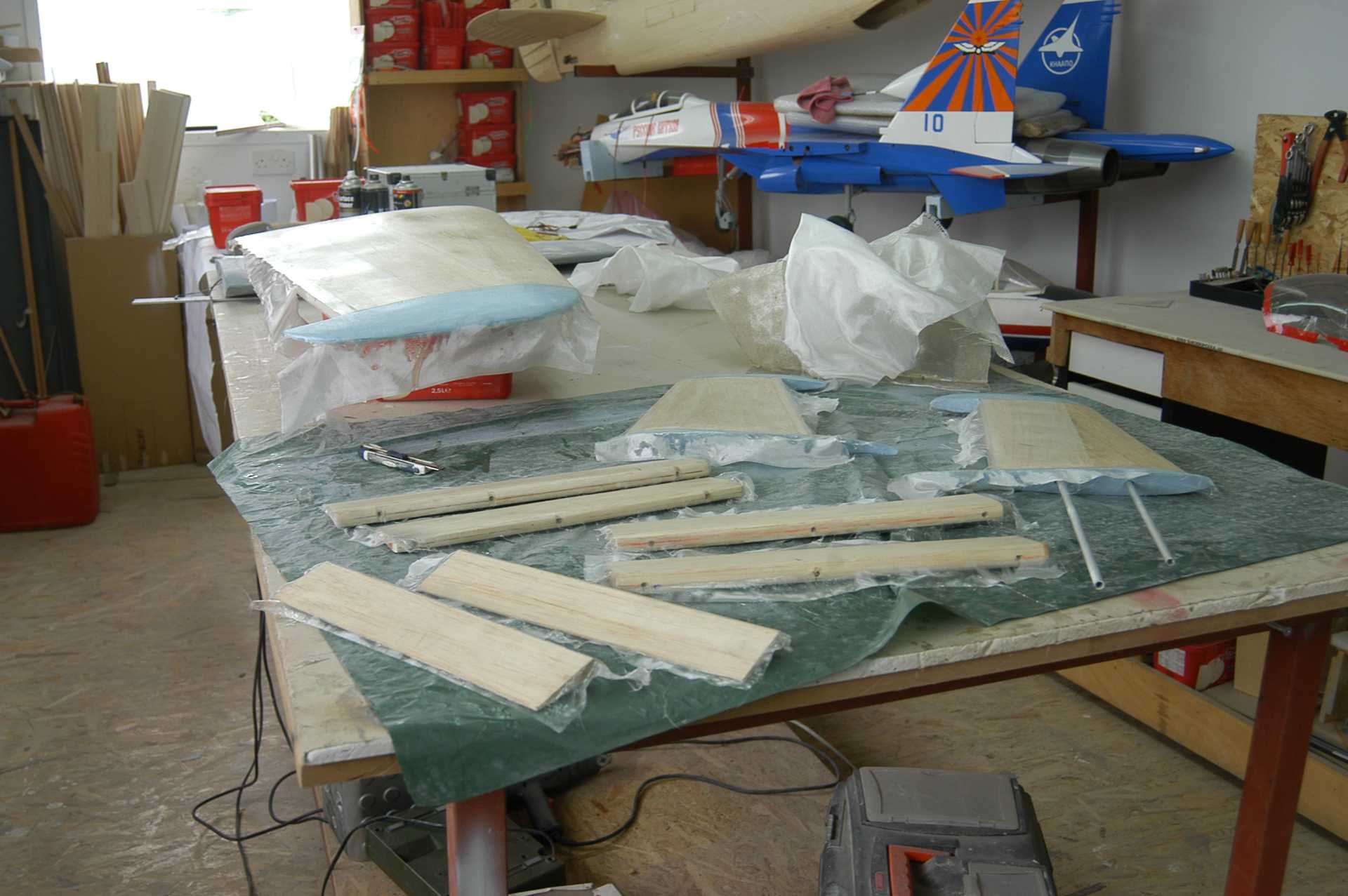

Got the second wing panel finished including the flap and aileron, and dry hinged them
not one of the best photo's don't know what happened

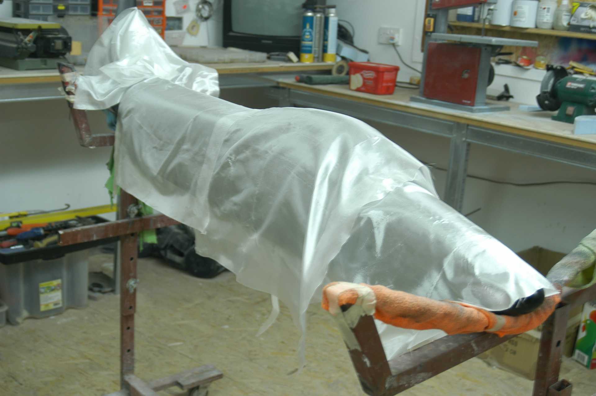

Cut the glass cloth for all the parts to be glassed
So ill be glassing them tomorrow
that's all for today :(

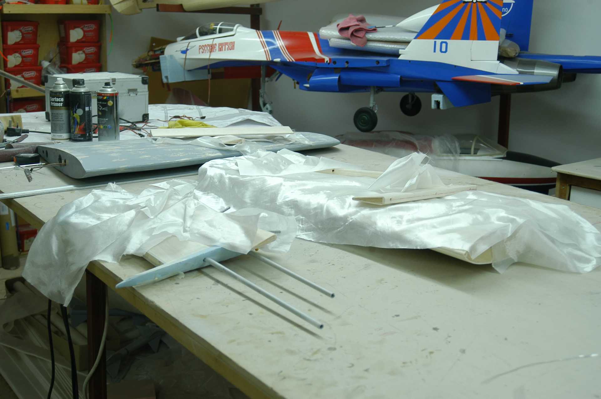

09 Mar 2017 09:53 #113 by THE BLACKBIRD

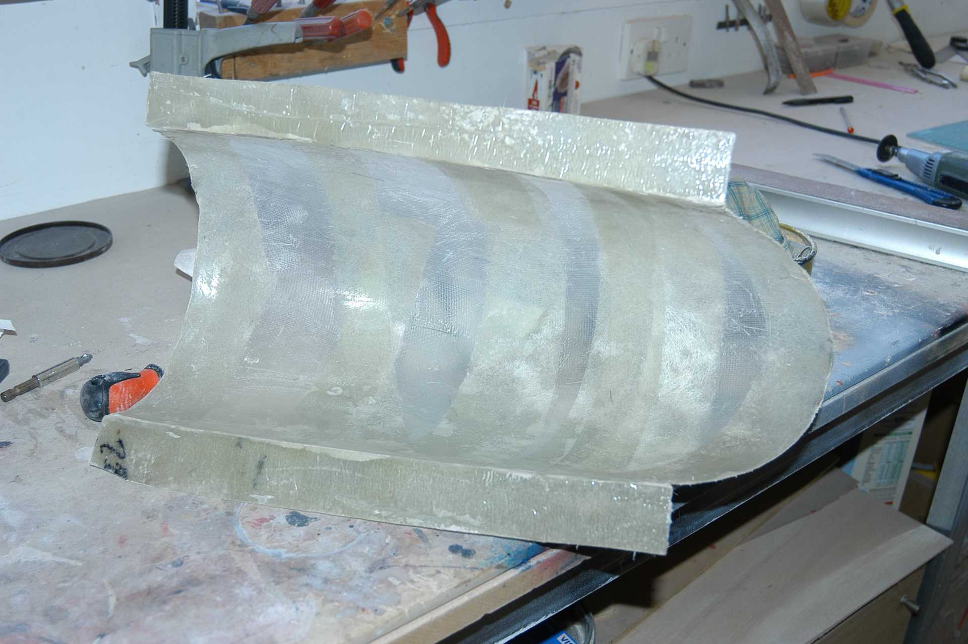

I again last night that's my forth night without sleep, I went into the hanger at two and glassed all the parts for the wings and tail, just got the canopy for the Revolver to do today now.
:sick:

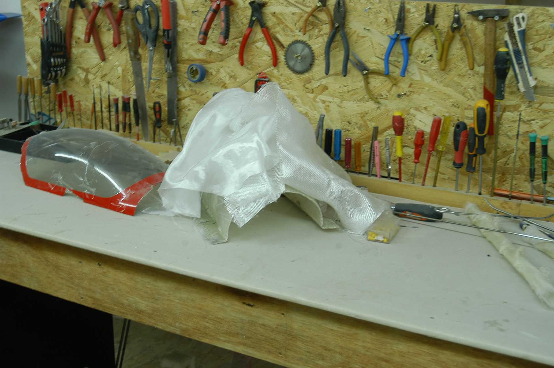

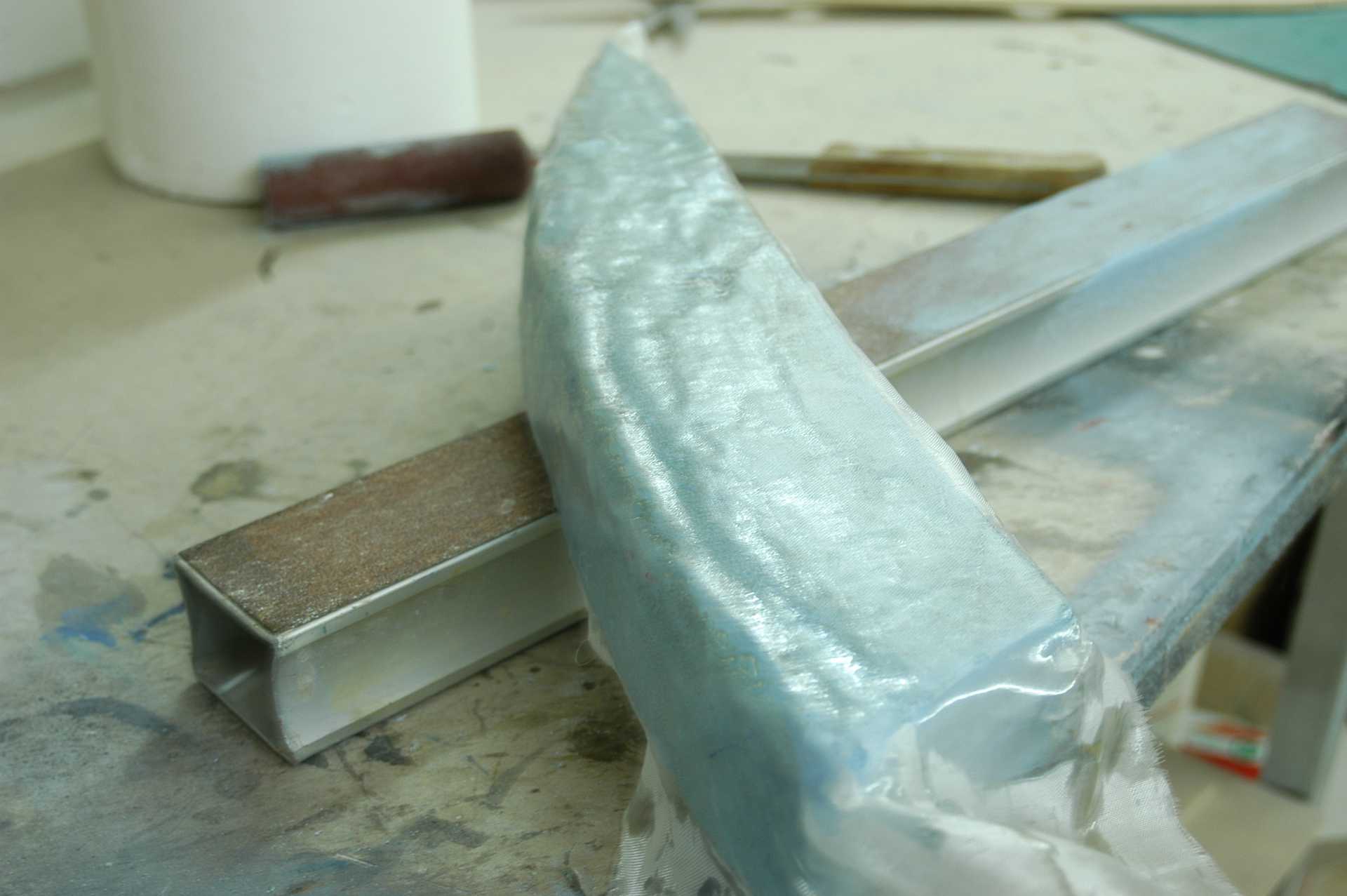

09 Mar 2017 19:57 #114 by THE BLACKBIRD
Not such a good day,
The parts that I glassed at two o-clock last night :S
Here with the surplus cloth cleaned off, I will sand all the edges down tomorrow
The Revolver cowl laid up
Thought I would glass the air intake plugs, just got the first one done and realised I had used polyester resin :angry: with the obvious result

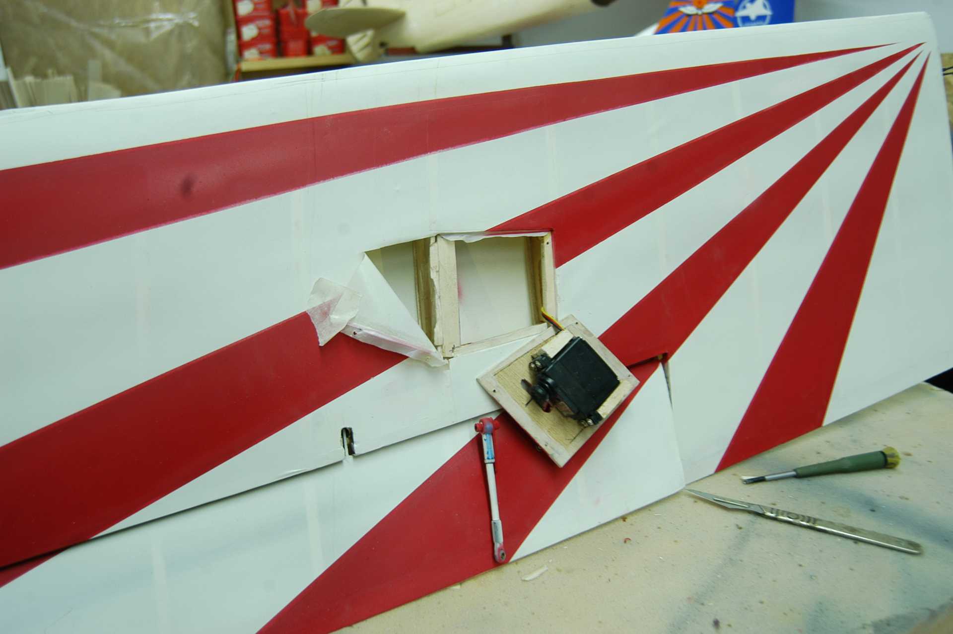

Then I needed to find what servo I had used in the Bucker, I struggled to get the tiny screws out :silly: put to much pressure on the drive and this happened

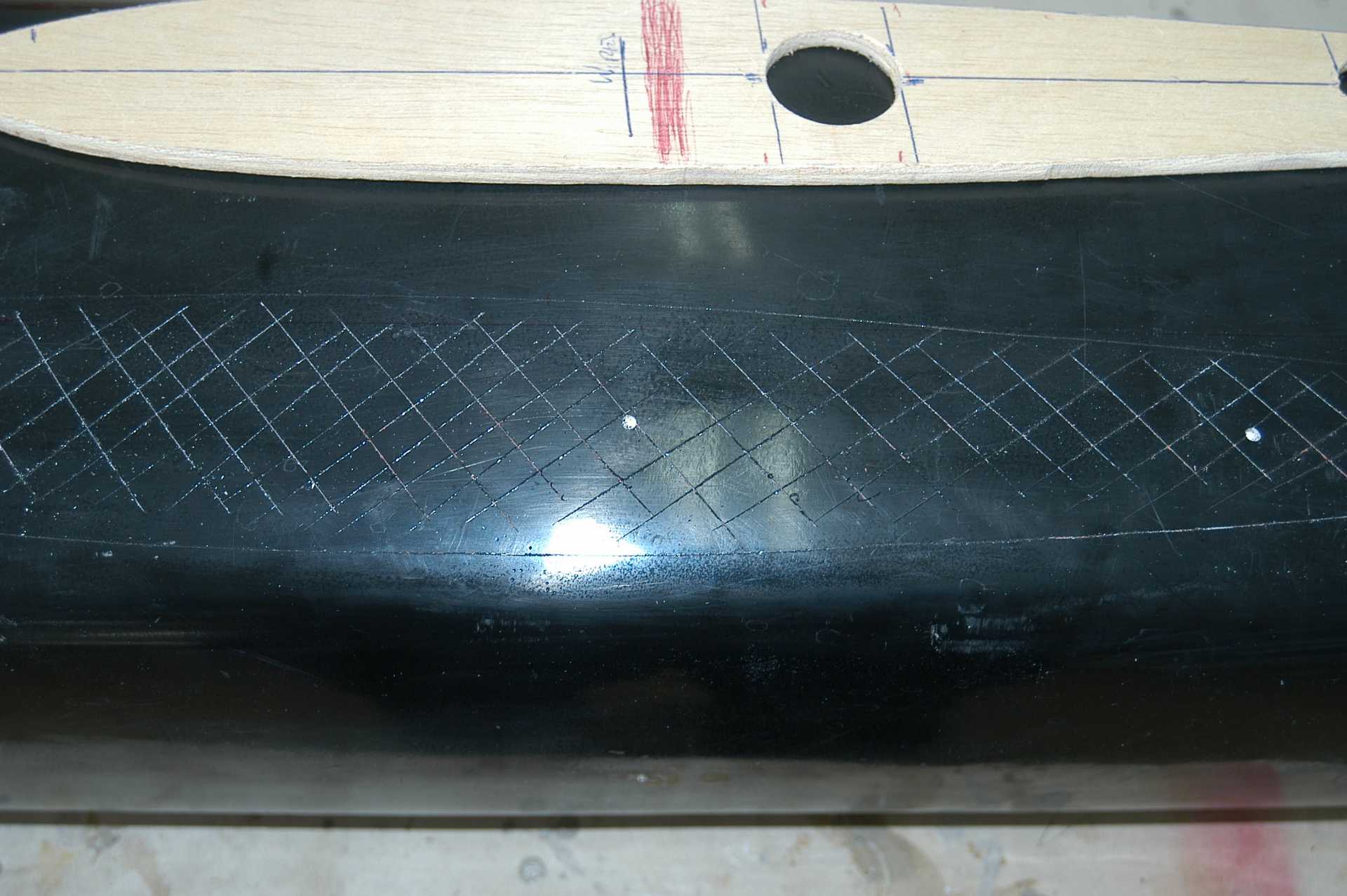

Took a long time to set up the wing roots on the plug
Then I epoxied the root ribs on after keying the plug

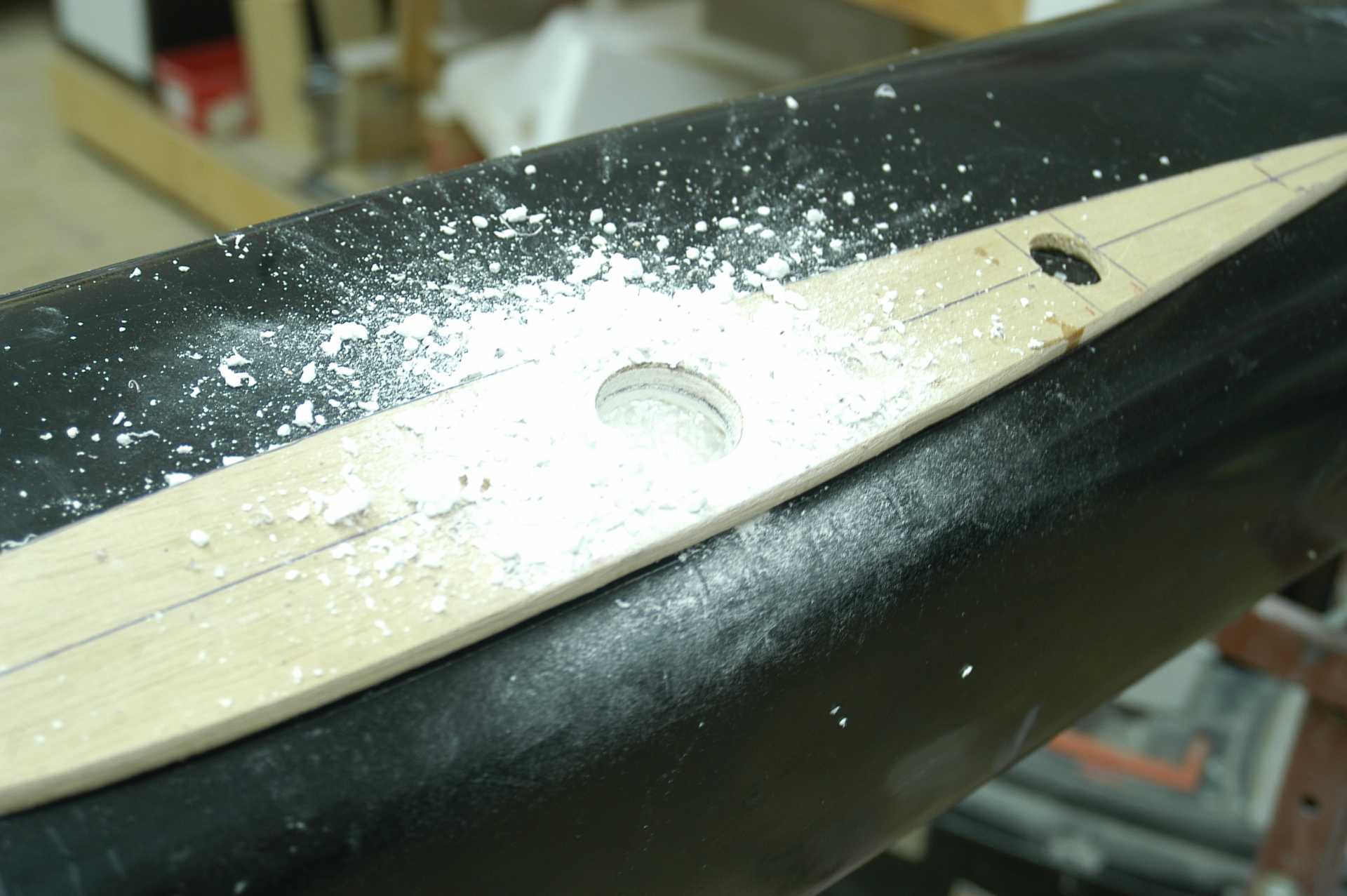

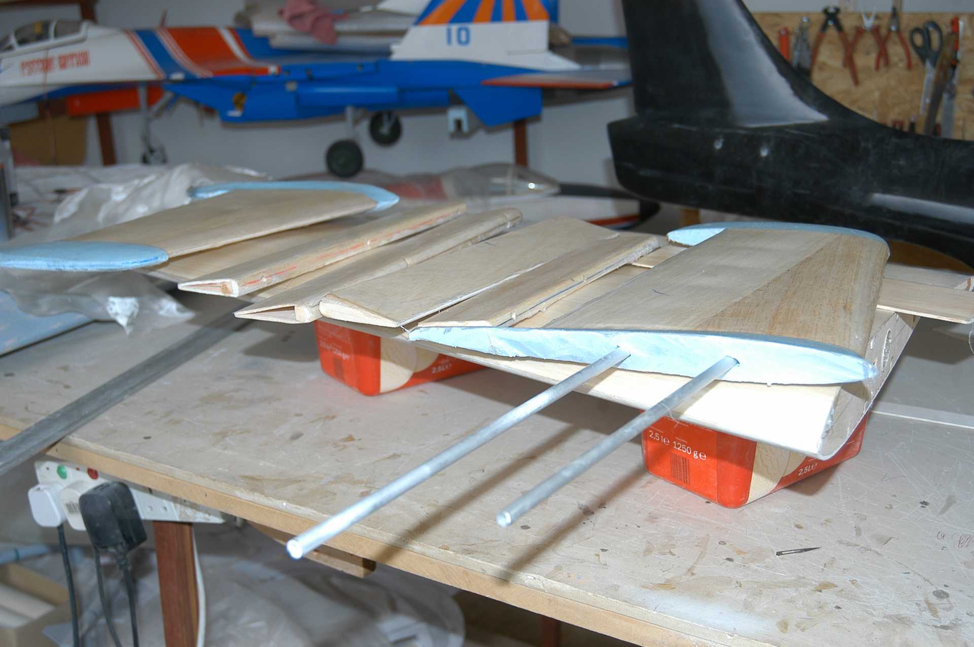

09 Mar 2017 20:08 - 09 Mar 2017 20:11 #115 by THE BLACKBIRD
Drill out the holes for the wing tubes so I could check the fit
The had the obligatory fitting together
Only to find I had cock up the roots :ohmy: had got it out of square :angry:
Ill think of the best way around it over night
But pleased with the way it looks, its good when something comes together ;)

09 Mar 2017 23:18 - 09 Mar 2017 23:27 #117 by THE BLACKBIRD
Ref. the wing position I put it as I had designed it, what I am trying to do is build it without having
to add weight as most jet models have to have church roof stuck in them some as much as 3 kg :S
The centre of the 3 lt fuel tank is on the C/G, it will have 4 lipo's in the nose so hopefully I can adjust them to get the balance :whistle:
