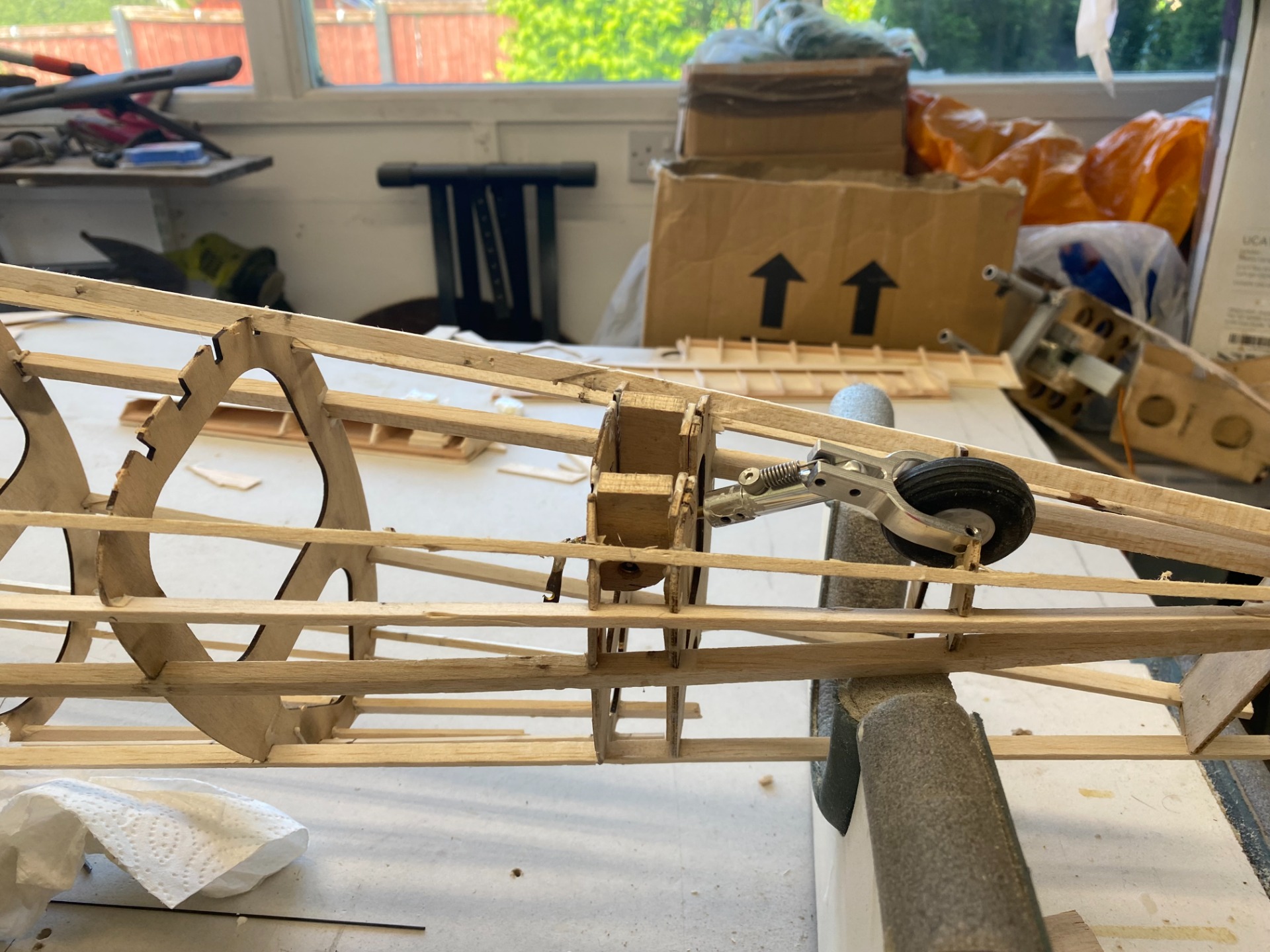

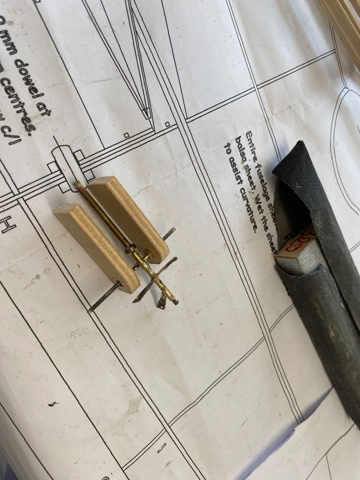

I need to make a retracting steerable tailwheel for this model and it must be light weight
08 May 2026 23:53 #64 by THE BLACKBIRD
I was having a play around trying to make a main gear leg and i silver soldered the stainless steel tube, i will not use it as its heavy

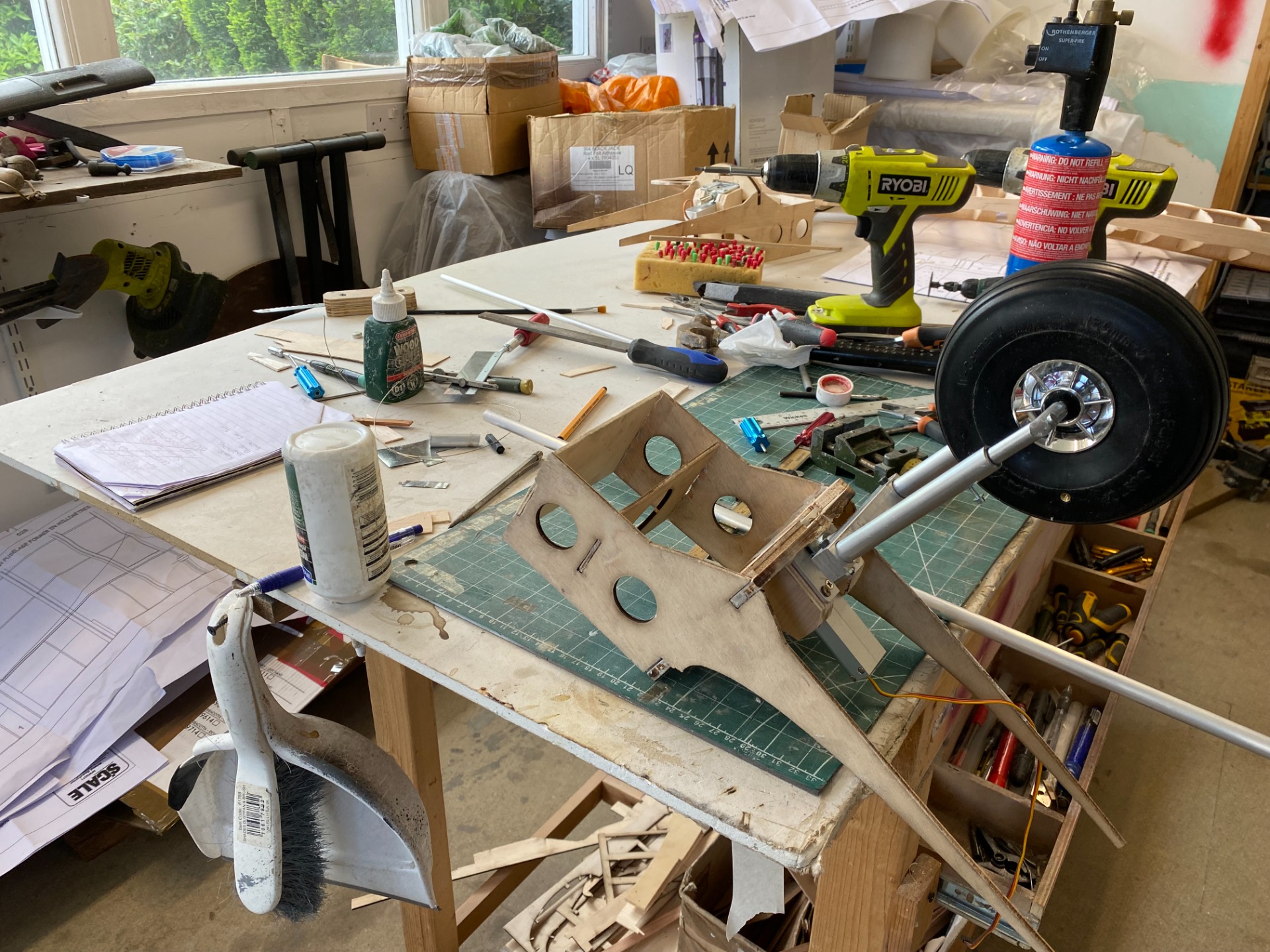

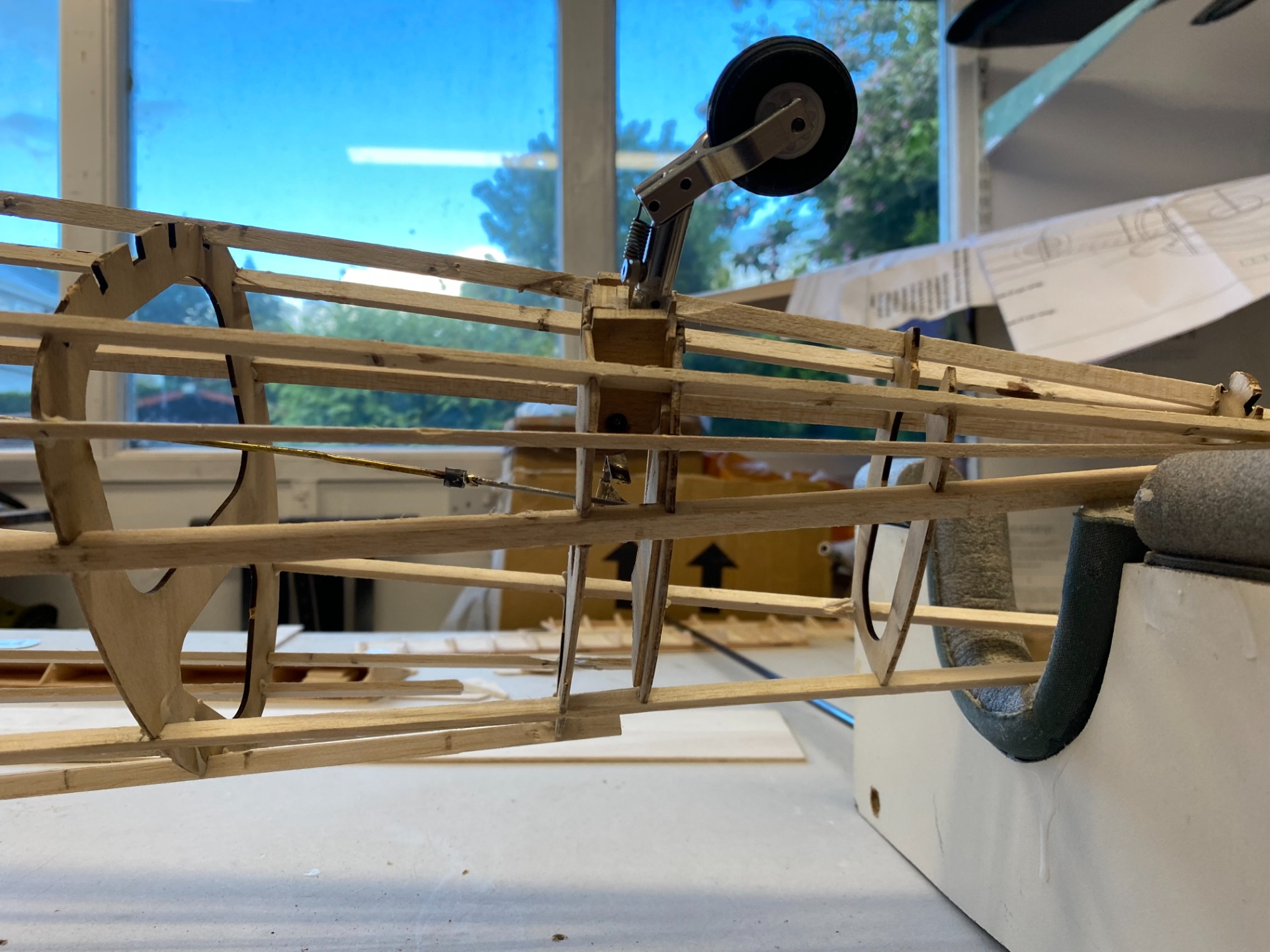

10 May 2026 19:05 - 10 May 2026 19:06 #65 by THE BLACKBIRD
Still playing around with the landing gear, the limited tools dont help, God look at the bench, looks like Klipies
Loosely laid a plank on the side of the fuselage to see how the wing fits, its ok
And of course having a go at the retractable steerable tail wheel
And working on the aileron and flaps

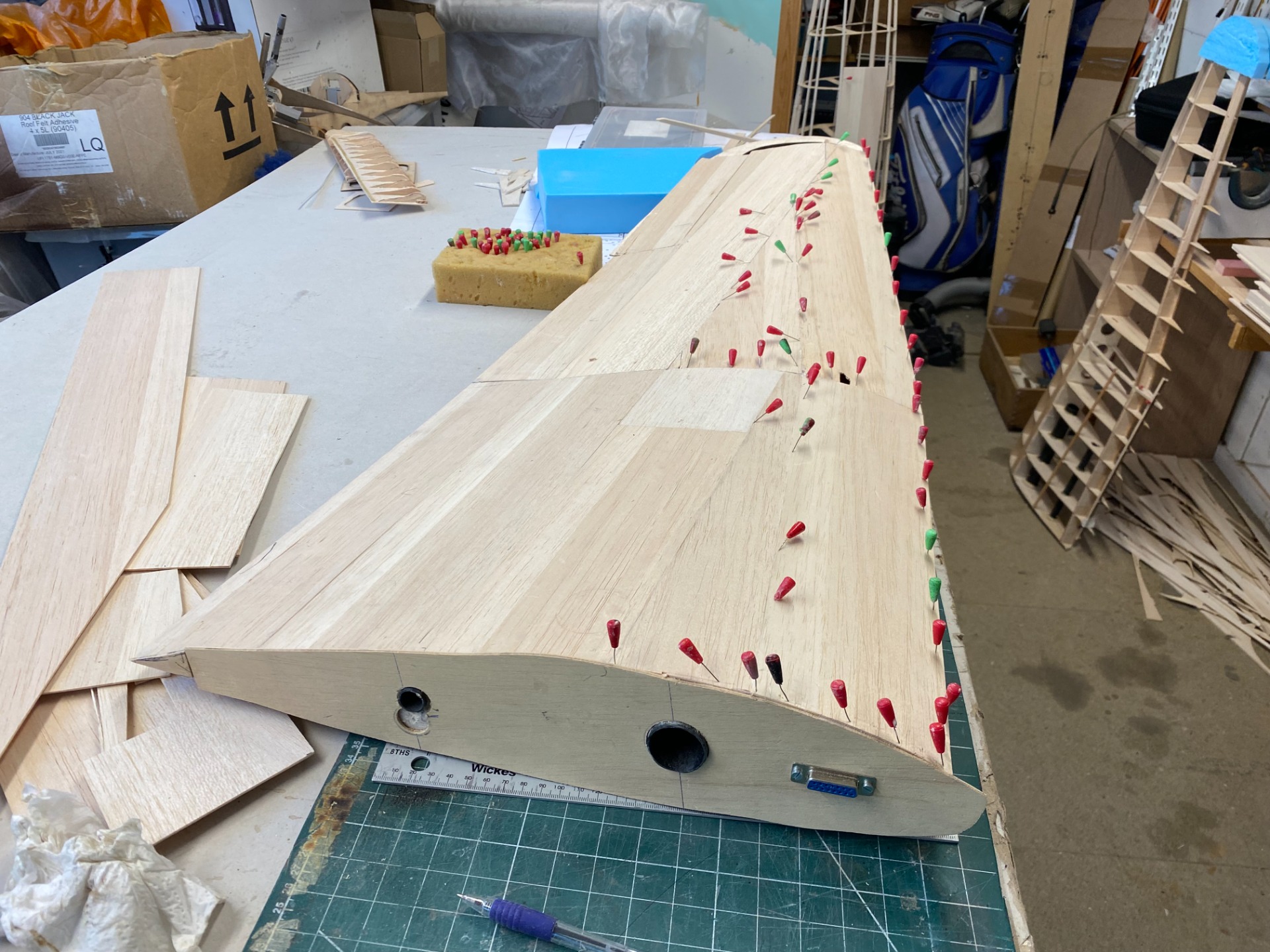

12 May 2026 20:49 - 13 May 2026 10:27 #66 by THE BLACKBIRD
I finished sheeting the underside of the wing and started the top
That done i finished the top sheeting and called it a day

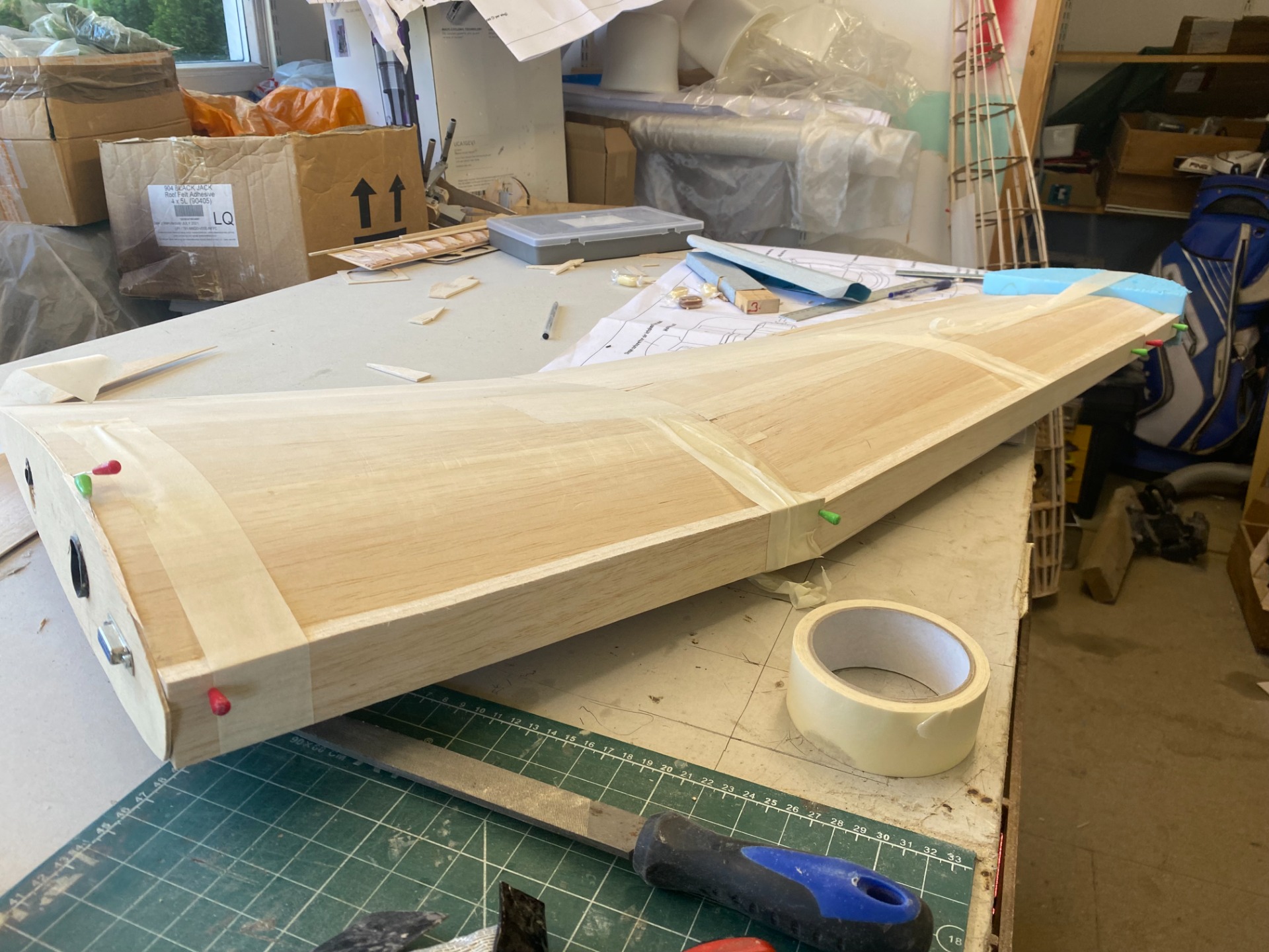

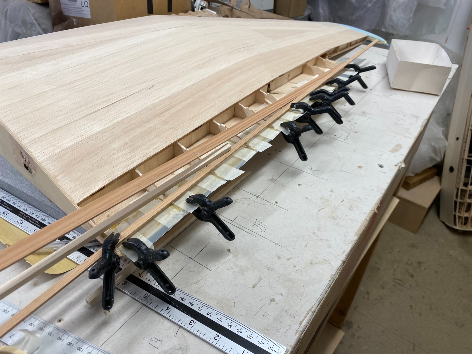

13 May 2026 21:21 #70 by THE BLACKBIRD
Had a mixed day got all the sheeting done and the leading edge on and sanded down  But the trailing edge is a very week design, no strength in it at all as i found out even though i had glued a strip of Proskin along to edge
So iv tried to glue a piece 50mm wide along the whole trailing edge
Adding weight in the wrong place but it was no good left, see how it turns out

13 May 2026 22:17 #71 by Ralpharr2001
Replied by Ralpharr2001 on topic A nice sized Bristol Beaufighter
That's a good idea BB of using flightskin to strengthen the trailing edge. I'll steal that idea and use it myself.  I usually glass a strip of 25g cloth to give it strength. But it does leave a poor surface finish that needs to be filled if the surface is visible.

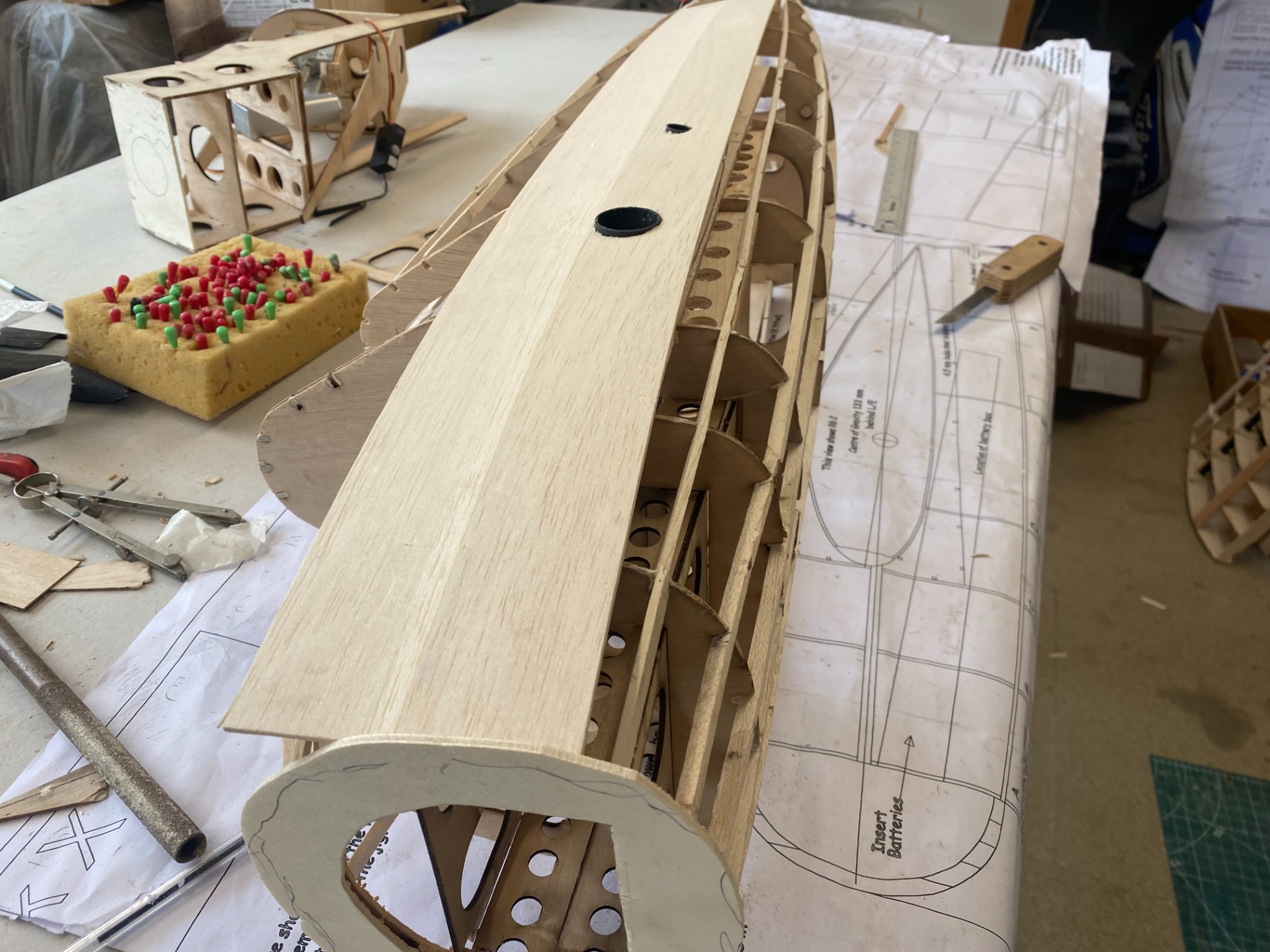

14 May 2026 20:25 #73 by THE BLACKBIRD
It set out to be a good day, i got the most slabs laid that i have done before the pain gets to bad and stops me
Then i mounted the tail wheel
I need some carbon tube to connect to the retract servo which iv fit under th cockpit as i was using some brass tube that i had and silver soldered M2 ends on it
But i set fire to the bloody fuselage in doing so
Also scorched the wire from the new servo i has just fitted for the tailwheel
