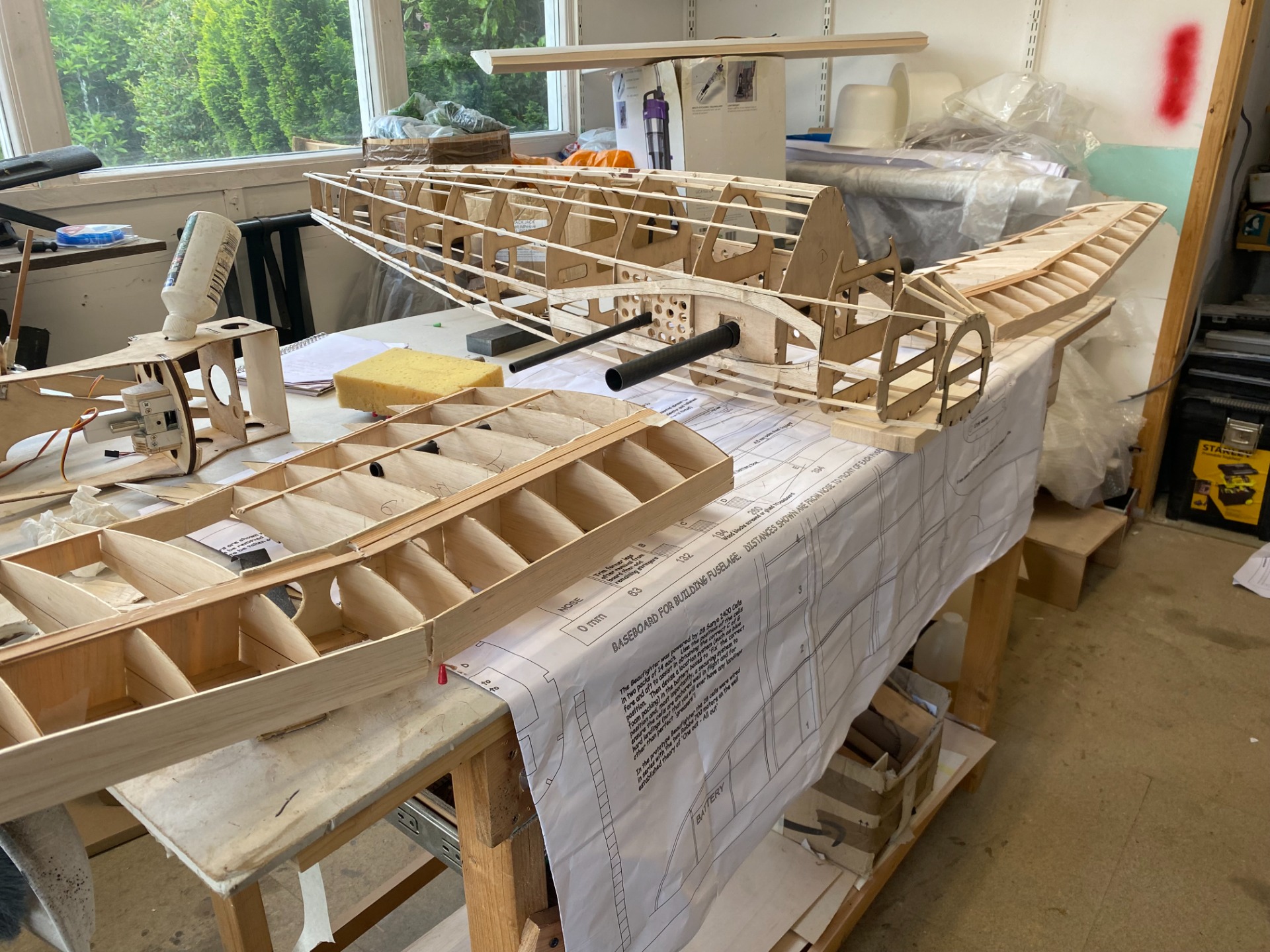

30 Apr 2026 21:12 - 30 Apr 2026 21:15 #49 by THE BLACKBIRD
The 30mm outer tube and the 26mm tube that fits in it  will reach as for as the engine landing gear mounting and a second 18mm tube to the rear of the wing will do the same
The outer wing panels have a 90mm dihedral from just beyond the engine mounts it seems a lot put it says its to scale, it has some very small china ply braces but iv cut some full depth 3mm decent ply braces that are glued the the spruce spars

02 May 2026 10:02 #53 by THE BLACKBIRD
Not doing to well with this build im still having problems with the wings, everything is built to the plan but nothing seems to fit together, what with the ss tubes not being able to silver solder and now the multi pin plugs i ordered that were advertised as a pair iv only got the male half in the post

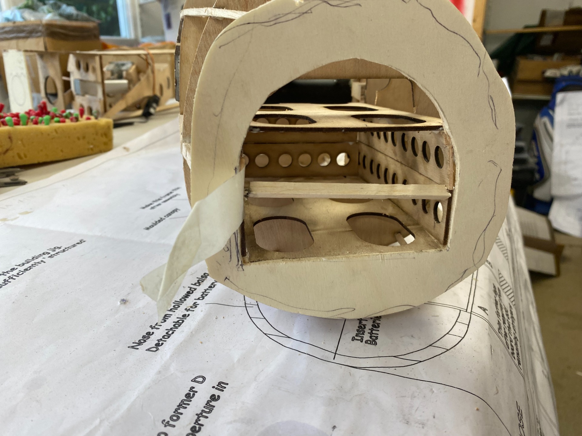

06 May 2026 19:58 #58 by THE BLACKBIRD
Hi Ralph yes ill put them in the nose in fack iv made the box for them to slide into, im going to make the nose cone out of fibre glass and make it so it comes off with just a twist

This is the servo tray
