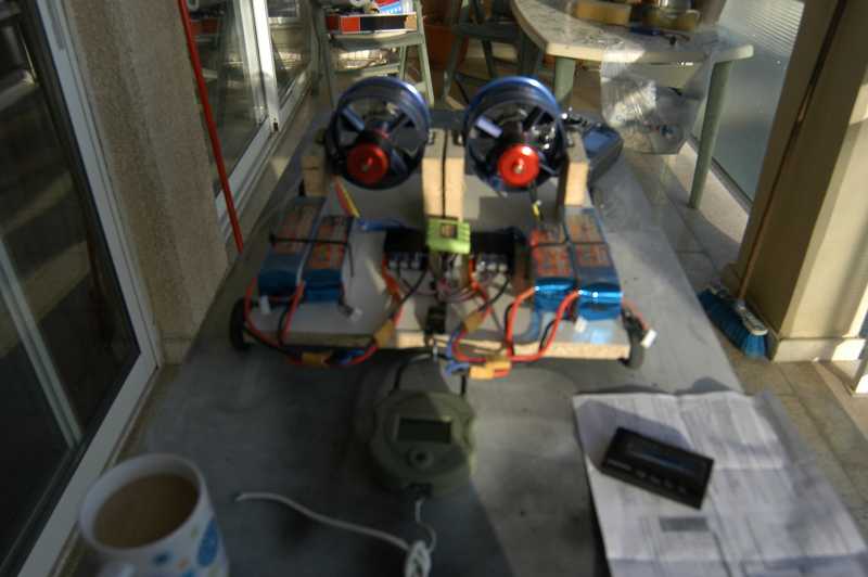

The Lander fans would not work today the esc's kept telling me that the voltage was to high
refused to work, each lipo is fully charged each one show's it is 2 volts over what it should be :ie the 6s is 24v instead of 22.4 and the 4s are 16v instead of 14.8v

08 Apr 2012 01:40 #84 by THE BLACKBIRD
Replied by THE BLACKBIRD on topic Re: EDF Problems in SR71 Build.
I thought that was what i said!!! i cannot use the lipos until i get some plugs
08 Apr 2012 23:41 #85 by THE BLACKBIRD
Had another go with the fans but still no joy, the wat meter is still giving the same readings but when i put the lipos back on the fusion charger to discharge it the charger was saying the voltage was to high and would not do anything.
Getting realy pissed off with it now, to many problems to get any enjoyment from it.

09 Apr 2012 03:24 #86 by Eric
Replied by Eric on topic Re: EDF Problems in SR71 Build.
BB - have you got them wired up like this?
