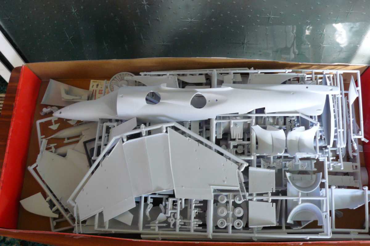

thanks tony, here is a sneek peek at it.

09 Aug 2013 23:19 #111 by Ex-Member
thats purdy sir
me like.
10 Aug 2013 08:11 #112 by Ex-Member
I shall be watching the Harrier build closely. It's one of my favourite aircraft too and I have a similar kit waiting in the loft for a rainy day.......I shall look and learn :D :D

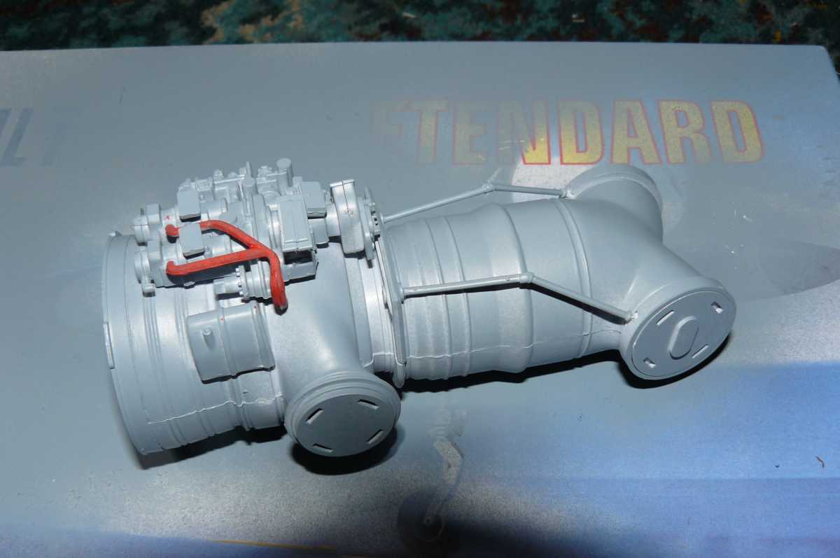

thanks Andy, well i got bored and started the harrier i have started the Pegasus 11 Mk 101 engine now its primed and now to put the paint on.

Very nice Sky.
The 11-21 "Big Peggy" makes a rather pleasing noise for a jet engine as it winds down to idle after a vertical landing. For some reason, the similar noise created by her bigger sister, the 11-61, is rather grating in comparison. Don't know why, and neither do the engineers who designed and built her. I was working for Rolls-Royce plc at the time and did a lot of the initial testing of the 11-61.
I've got several Harrier kits waiting to be built, including this and the Airfix 1/24 Sea Harrier. Any hints you can give in the construction of yours will be much appreciated, Sky, particularly if you find (and overcome) any issues en route to completion. It's a long time since I've built a proper static model so I've forgotten most of what I learned.......
