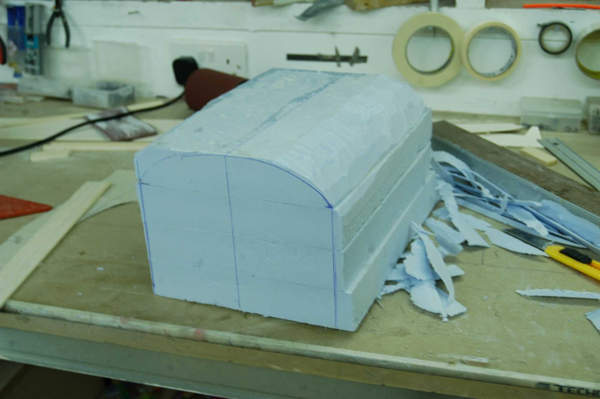

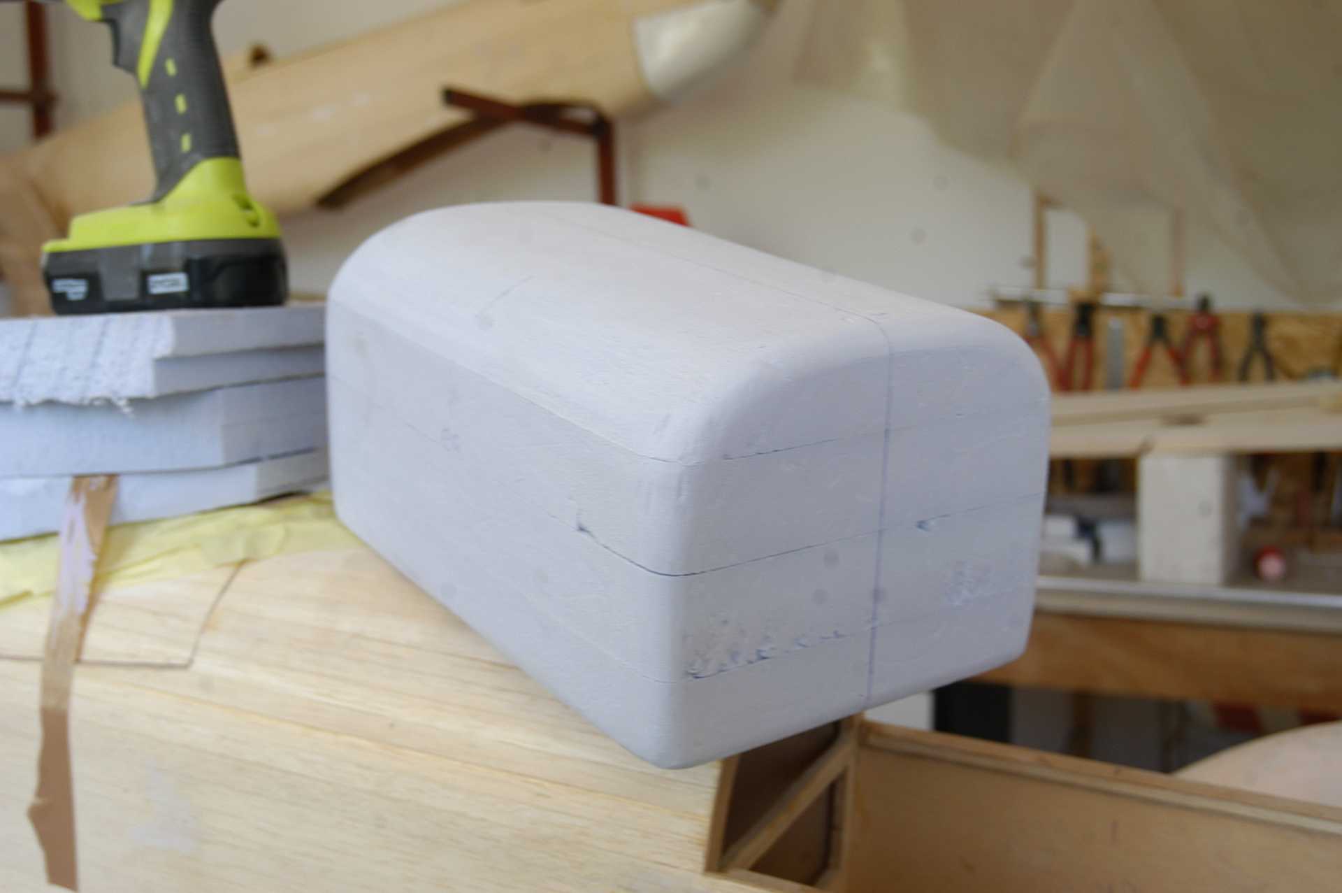

Been doing the plug for the fuel tanks ill make it from fibre glass, the intention is to make one big tank then carefully cut it ni half length ways, make a flat FG plate and lay each half on it and Hysol the tank to the plate then seal with FG
The tank as it stands is 300mm long 200mm wide and 130 high, hoping that will give me enough fuel for a reasonable flight time, as I think the two turbines at 44lbs thrust will be working hard to power this bird
The centre of the tank will be on the C/G

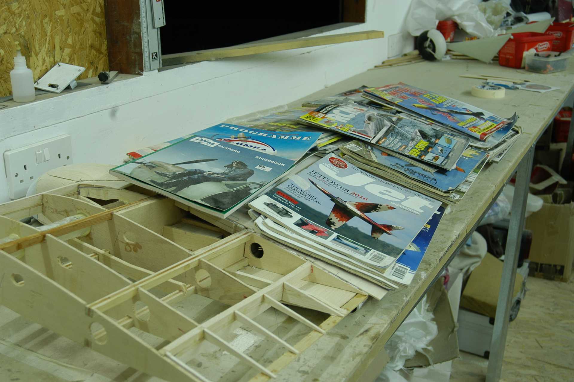

When I sheeted the wings I cut and pinned all the sheets in position then taped the joint took it off the wing laid it on the bench and ran diluted white glue in the joints, when dry I the gave the sheets a coat of resin on the inside and immediately glued it in place on the wing,
Laid mags on it to hold it down in place, im hoping the resin on the inside and glass cloth and resin on the outside will give it a stronger skin, I was originally going to skin it with pro skin the same as the Hunter but I think I like the wood better

I do like the idea of weighing down the sheeting with magazines - thanks for that, I'll store it away for future use! ;)
06 Sep 2017 07:57 #202 by THE BLACKBIRD
Yes it put pressure over the whole area, as little or as much as you want, just add mags, might be a bit heavy for you dinky ones :)

I like the idea of pinning to the framework, then gluing the joints. You could in theory damp the wood so it forms to the foil shape at the same time. You end up with a pre-formed wing skin that won't put stresses on the rib structure.
06 Sep 2017 12:23 #204 by THE BLACKBIRD
Hi Klipy I only pinned the sheets in place until I taped the joints then lifted it off and glued the joints

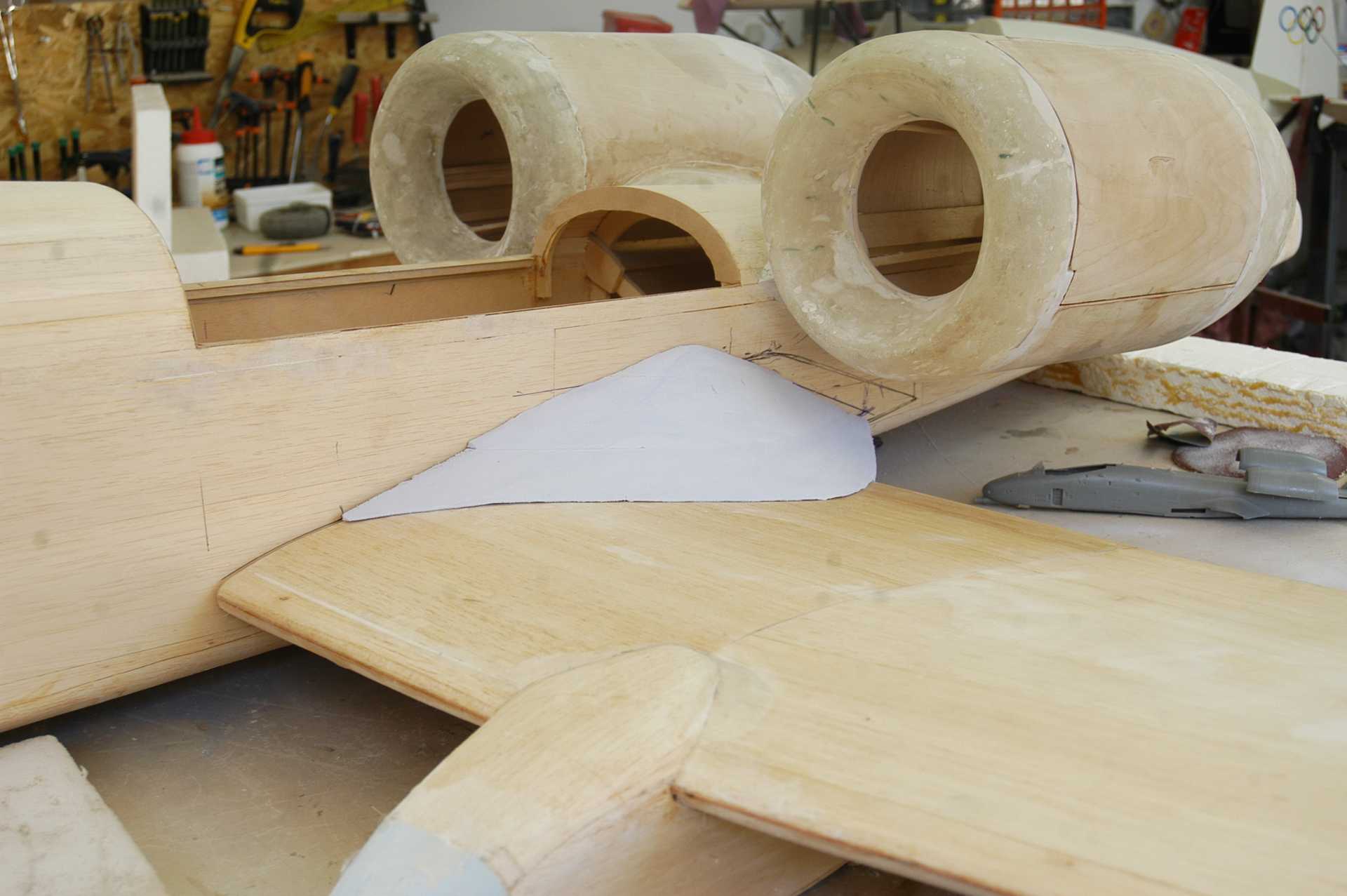

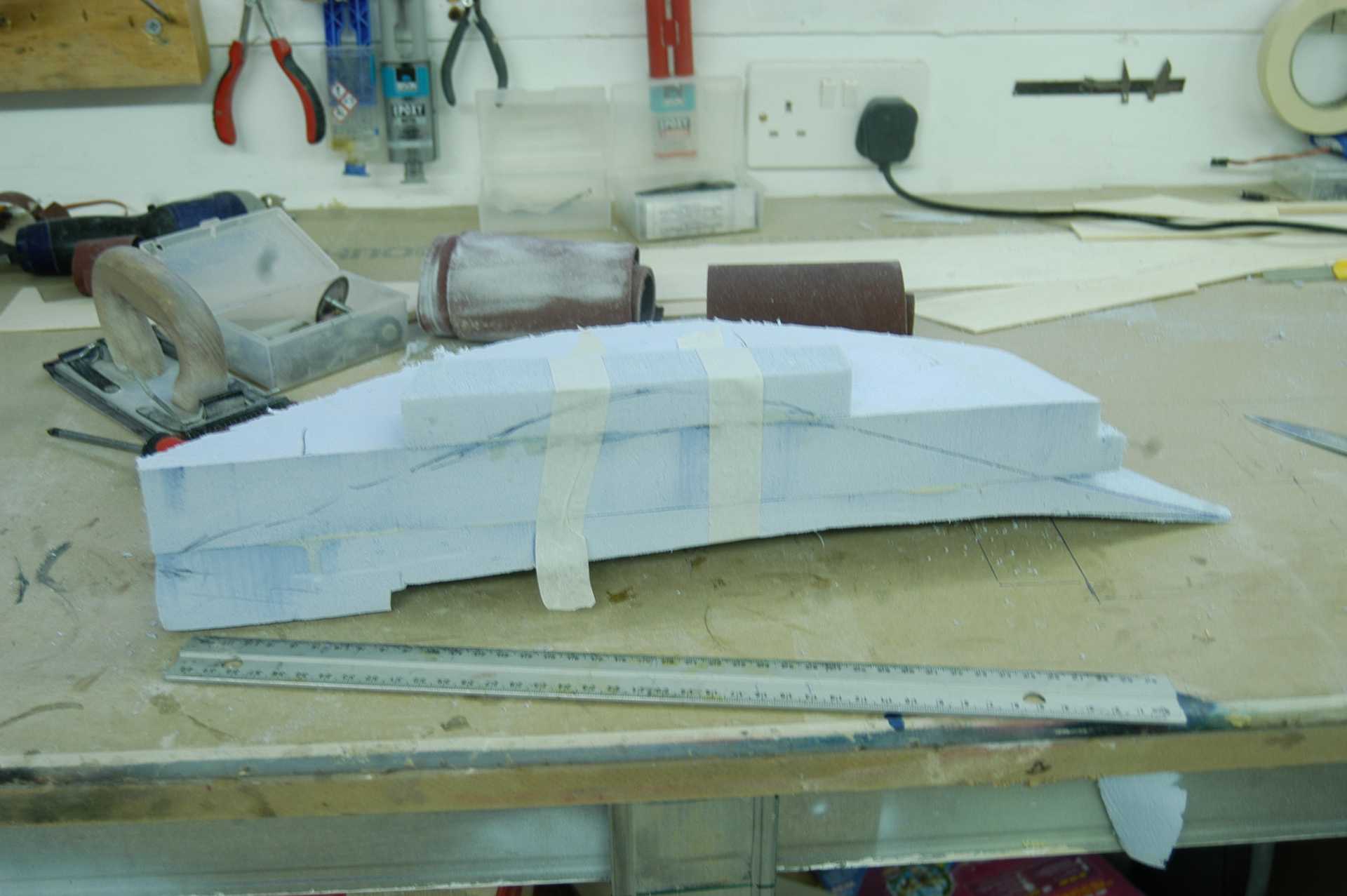

Made a new canopy plug for it as the other one was not up to standard
And did the area at the wing roots, the first one I got the shape wrong
Got there in the end
Got the wings and part of the fuselage glass last night
