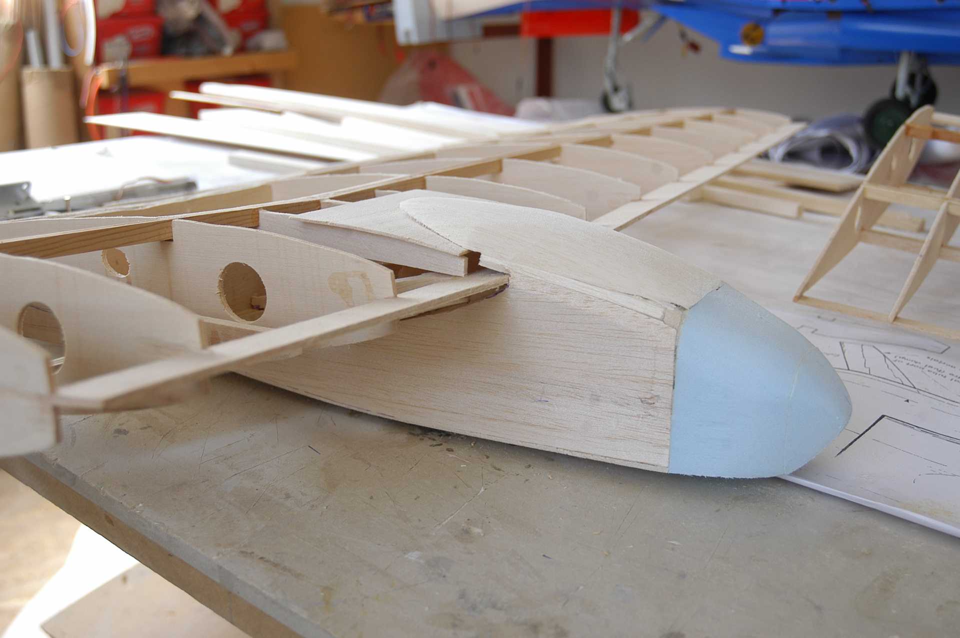

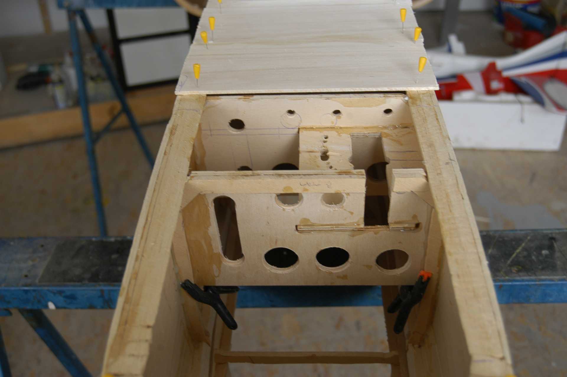

Got the nose gear mount sorted and hysoled in, also some sheeting on the bottom
And started on the other wing pod

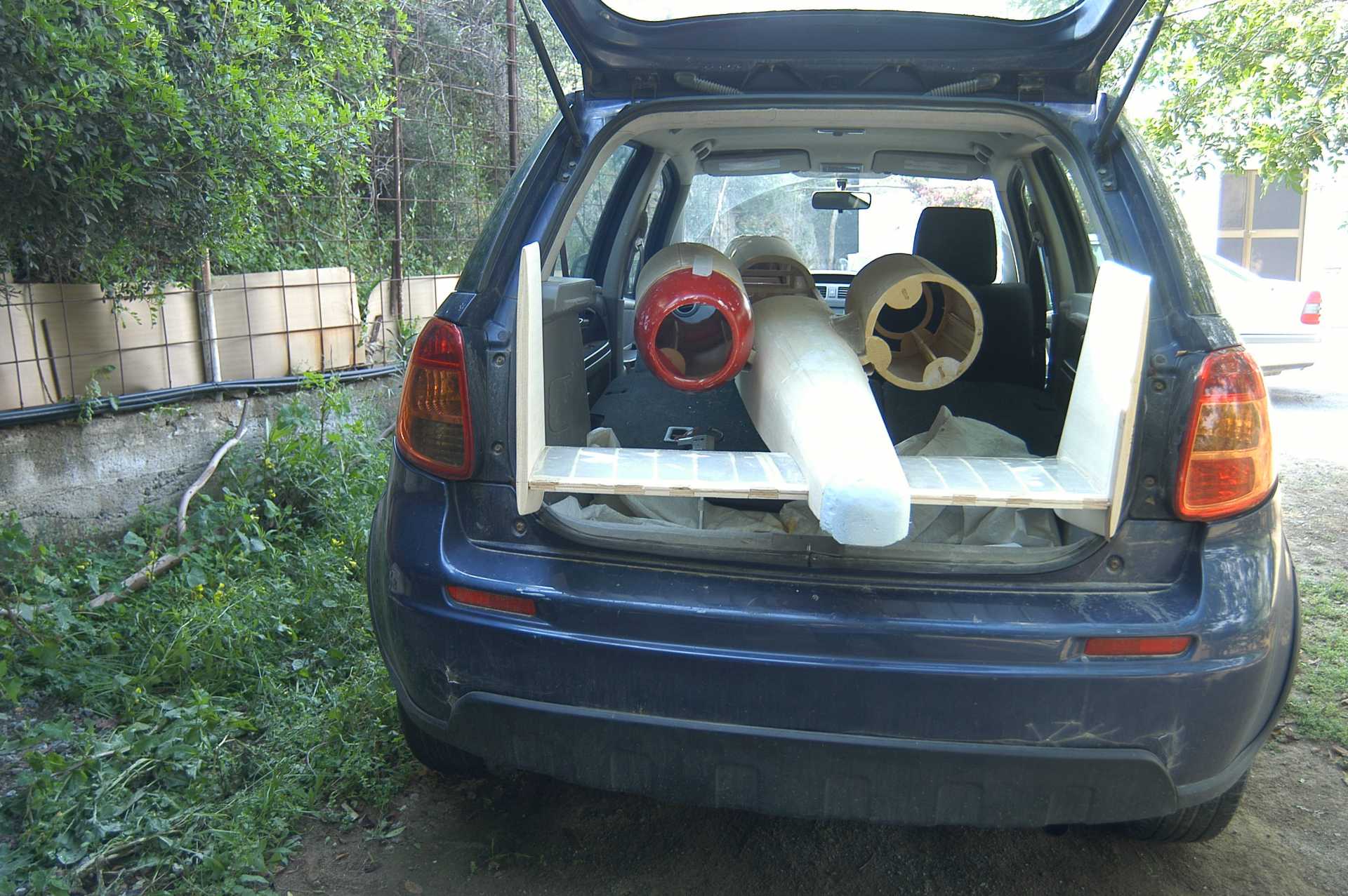

I wanted to see if it will fit in the car

Yes it will go in the car, well nearly ;) a bit like the SU27
And seeing as I had it outside, I put the bits together, as you do

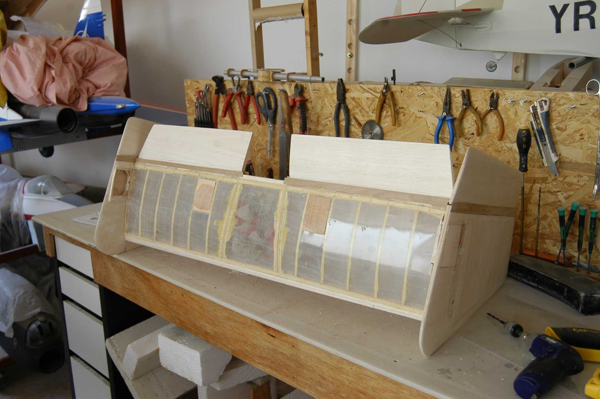

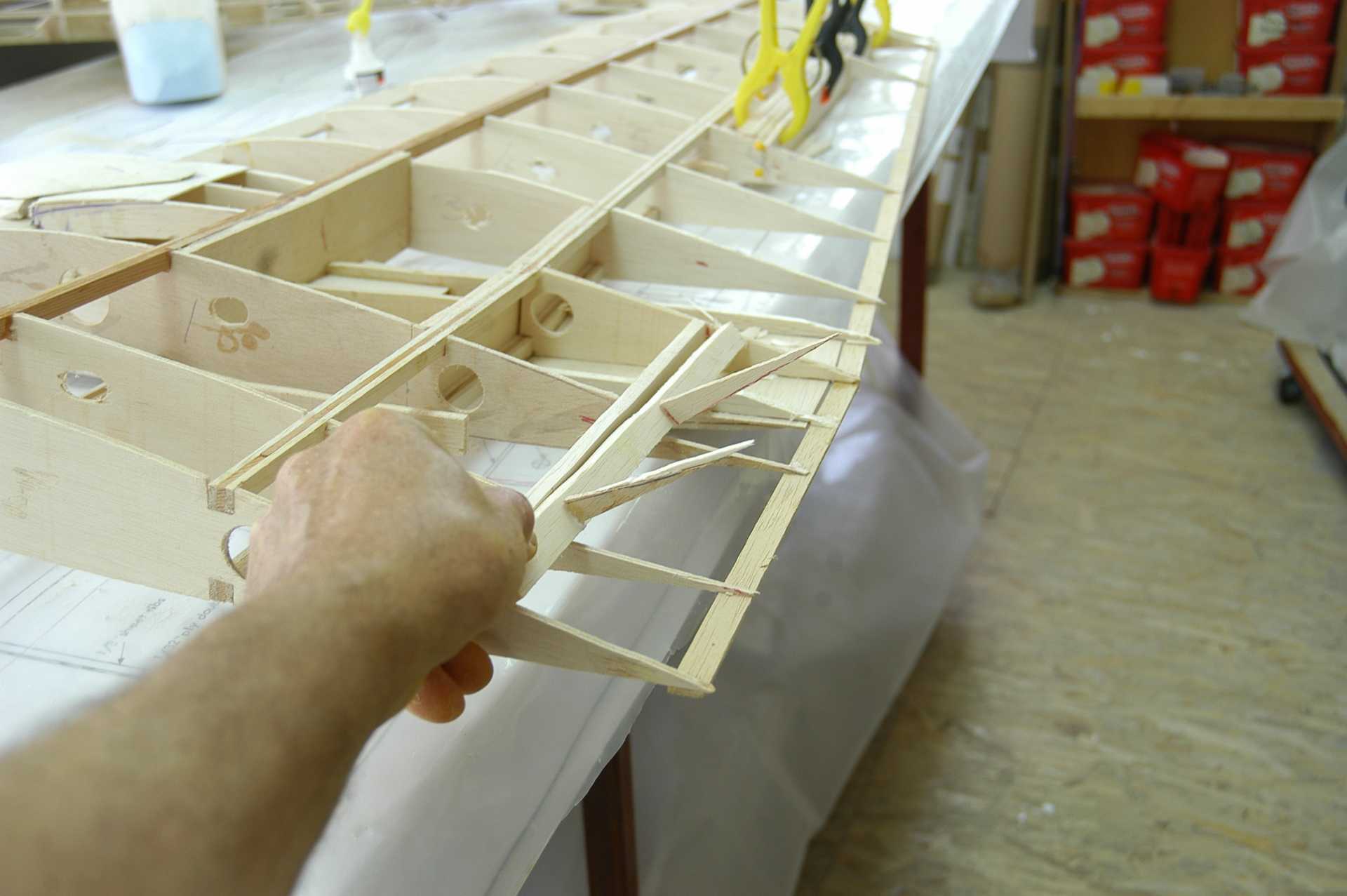

this plane is quite an odd one, it has flaps on top of the wing :ohmy:
Or at least mine did :(
I built the flaps in the top of the wing instead of underneath :lol: :lol: :lol: :lol: and did not notice it until I was well on :S
That bang on the head has really had an effect, and not for the better :silly:
Got the other pod done
And apart from the flaps not a lot else :(

22 Apr 2017 10:47 #186 by Eric
:P :P :P I said, a few days back, that you had built the wing upside down! :P :P :P [badass]

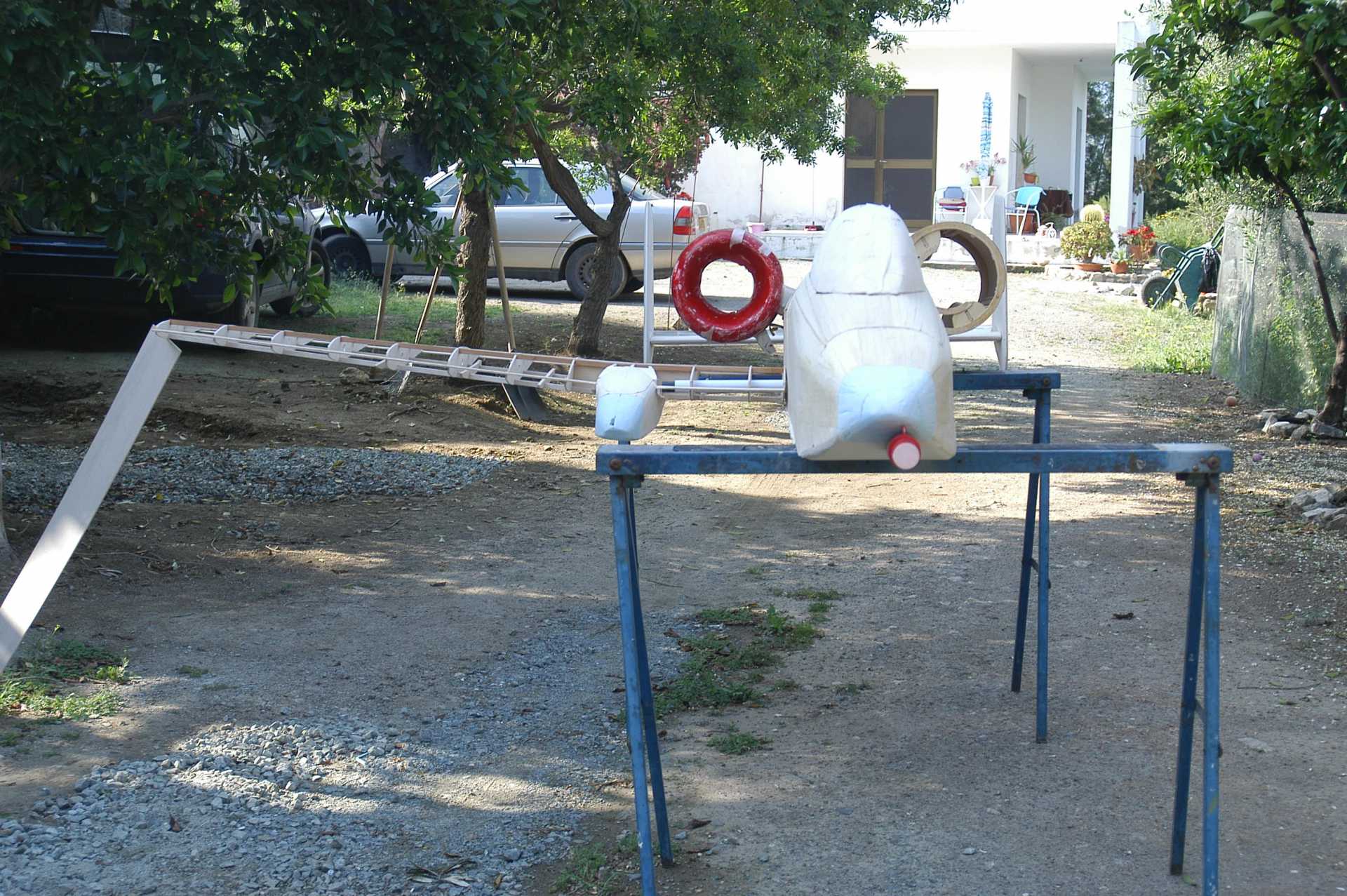

Glassed the parts for the engine pods
Came out ok and even saved the plugs, must be improving
Here they are bolted together and getting the first few coats of polish on them

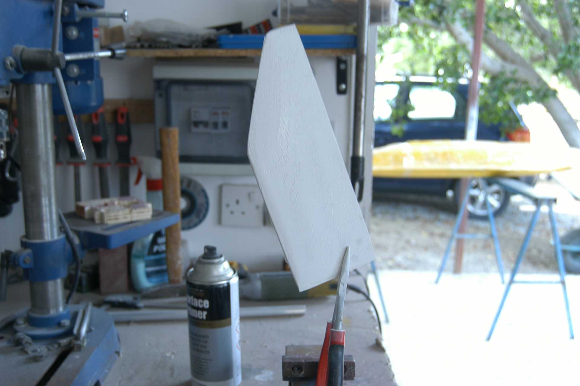

Got all four mounts for the rudders and elevators servos, and built the two rudders and the elevators, and skinned them with 2mm balsa, dry hinged them in place, they are ready for glassing
Started to make the plug for the two fin thingys :blink: that go underneath the fuselage
I think that will be about it for a couple of months until I get back from England as I will sheet everything over this time because of the visitors in the roof :angry:

I glassed the elevators and rudders, one job less when I get back, but on the elevators I glassed one side then I gassed the other side or so I thought :huh: when I looked today I had put both on one side of the elevators :S

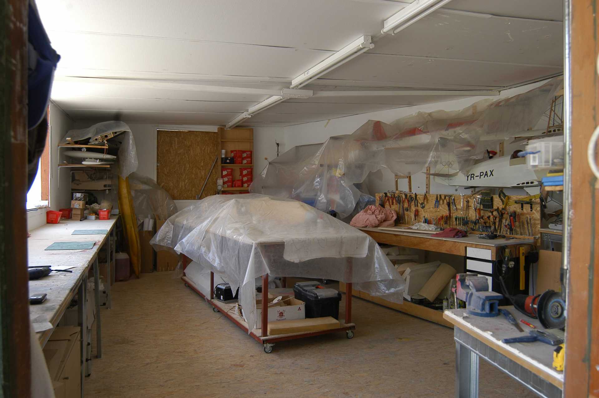

I covered the models in my little shed
Thinking I need to extend it and make the gin and tonic area into storage for models unless I start crashing them again :)
That's it for now

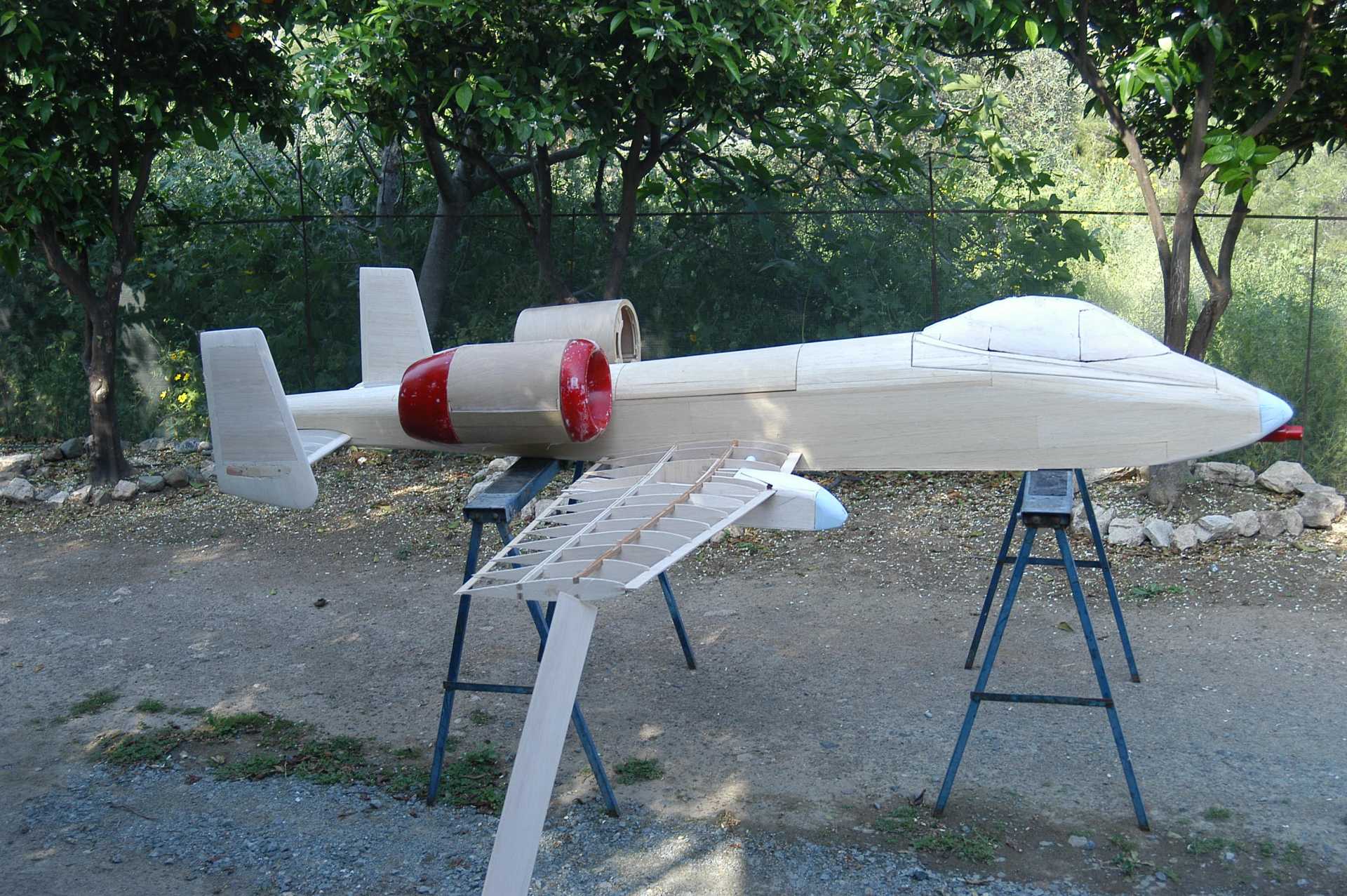

So a update picture

That is quite some plane!
03 Sep 2017 21:45 #195 by Ex-Member
Replied by Ex-Member on topic The Cyprus A10 THUNDERBOLT
Wow...that is certainly impressive BB. :cheer: :cheer:
