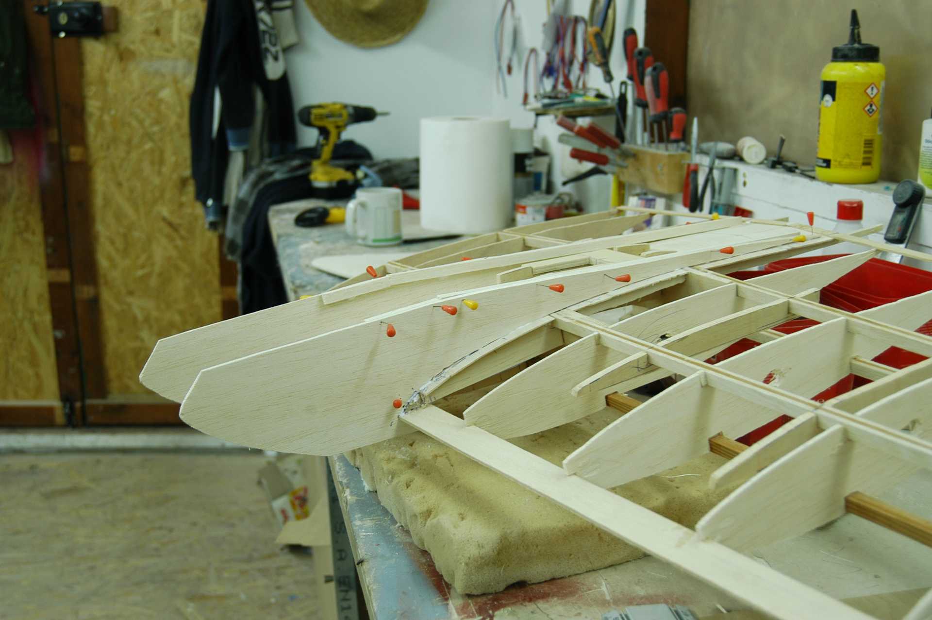

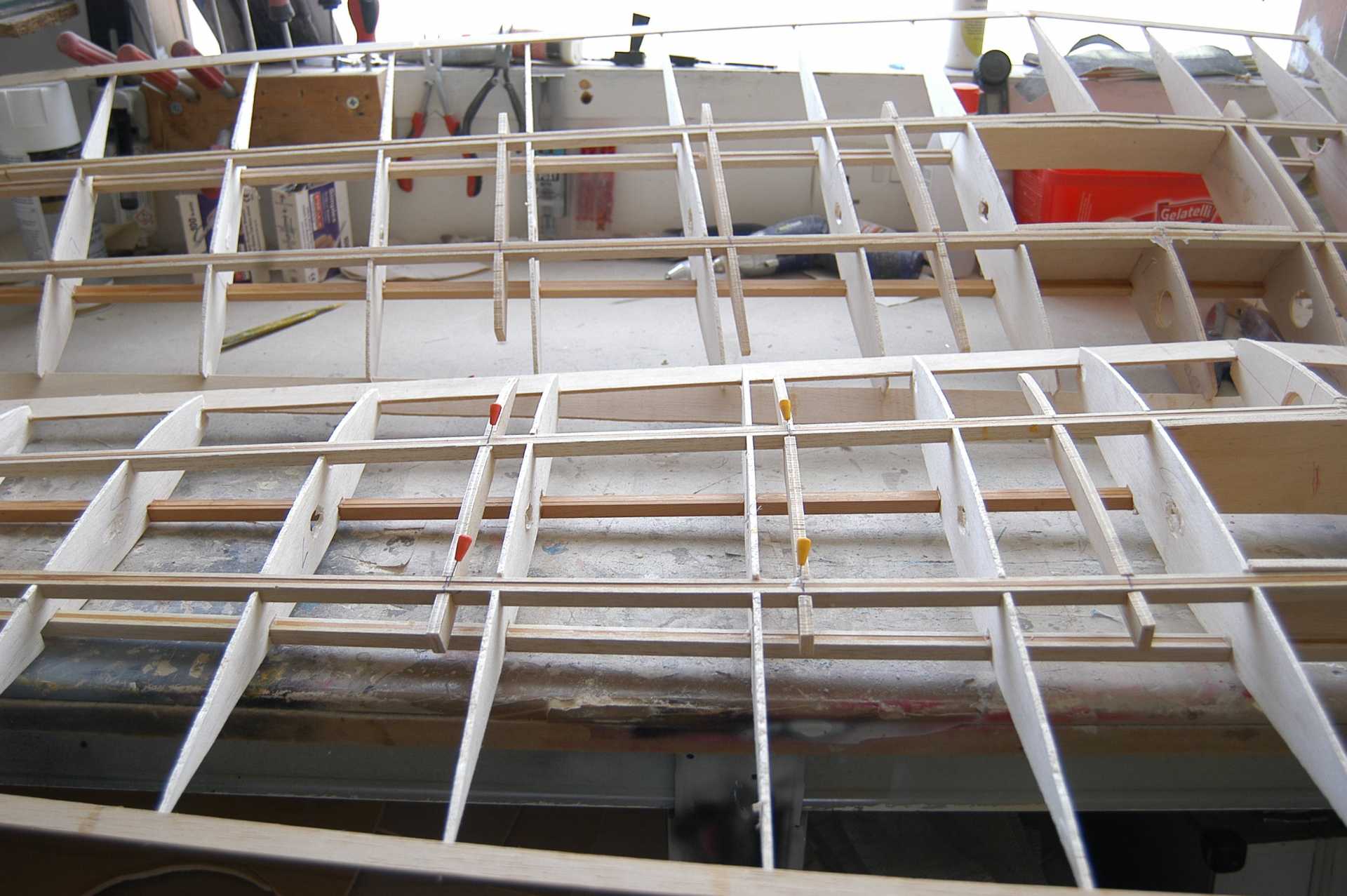

Added ply blocks for the hinges

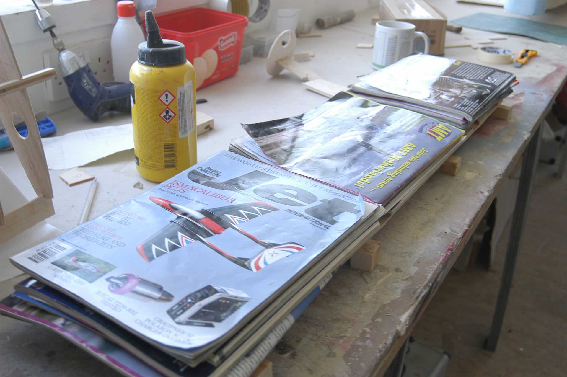

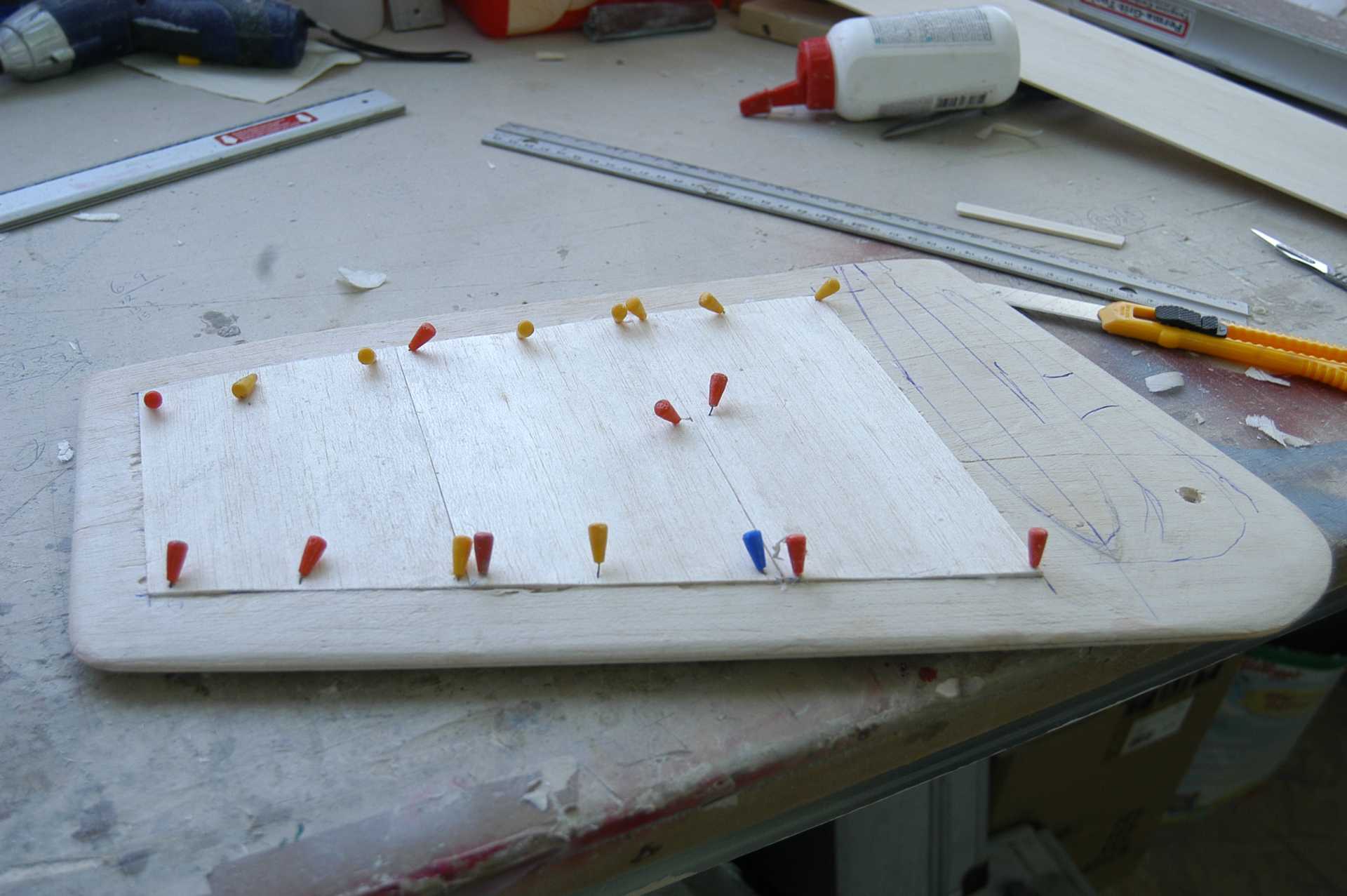

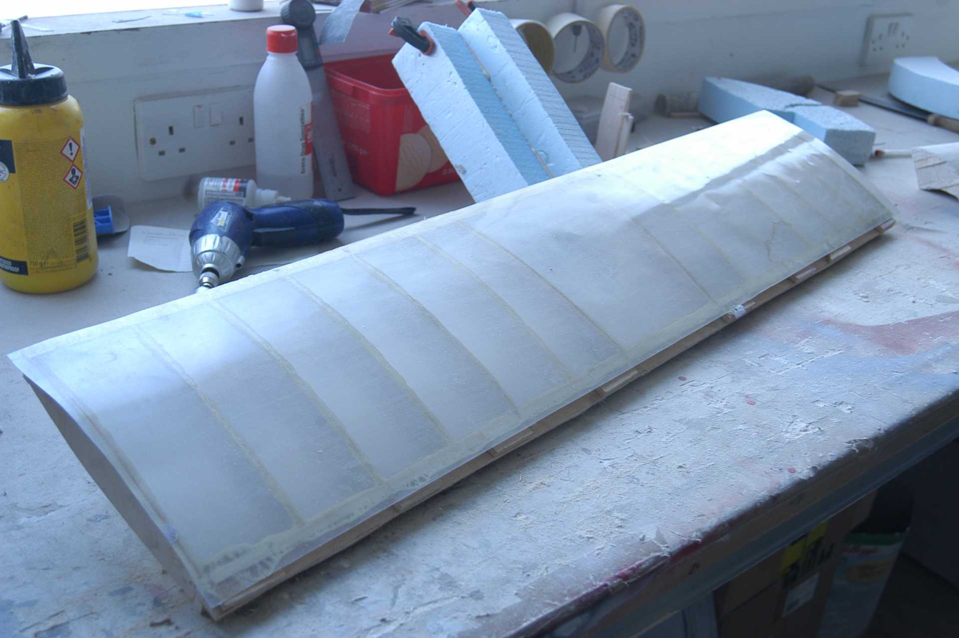

Cut some proskin to cover it with
Glued it on with polyurethane glue and weighted it down to dry
An hour later it is done the surface is ready to paint

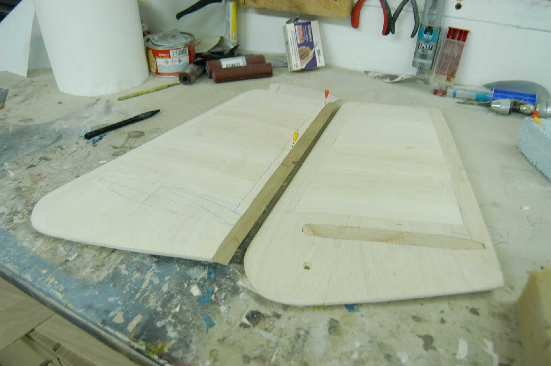

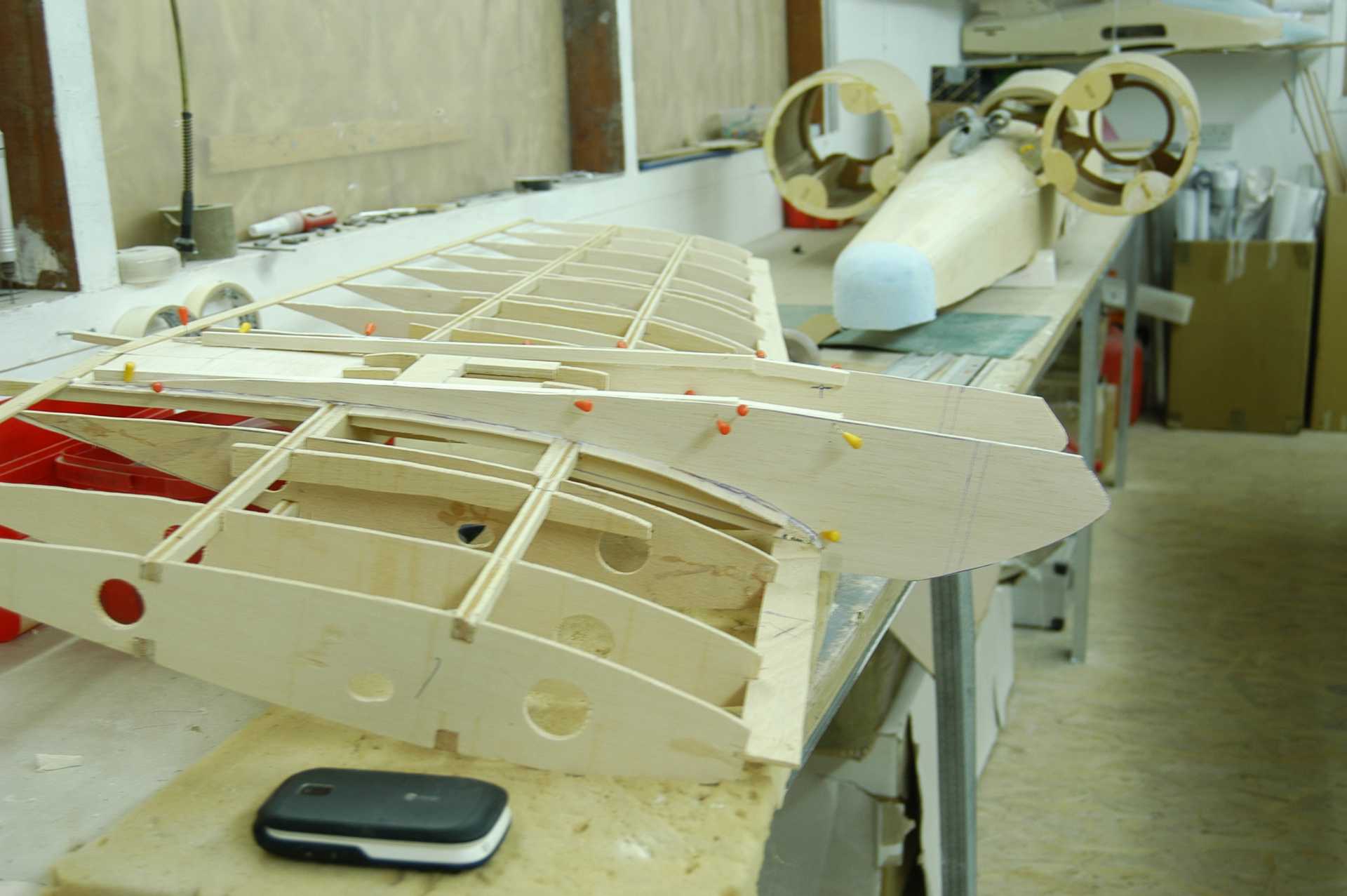

Cut the fin plug to shape and pinned it on ( as you do )

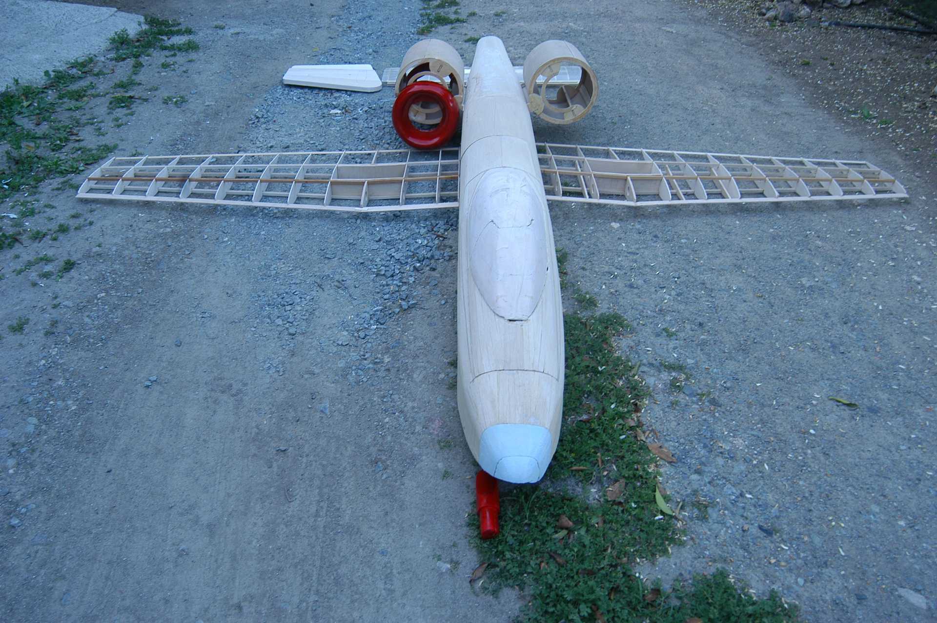

Took the parts outside and laid them in position
Shes a big un

the fin just cut from one sheet or is it layers.
09 Apr 2017 21:42 #169 by THE BLACKBIRD
Two layers of 9mm balsa

Added the hard mountings for the underwing stores, four on each wing

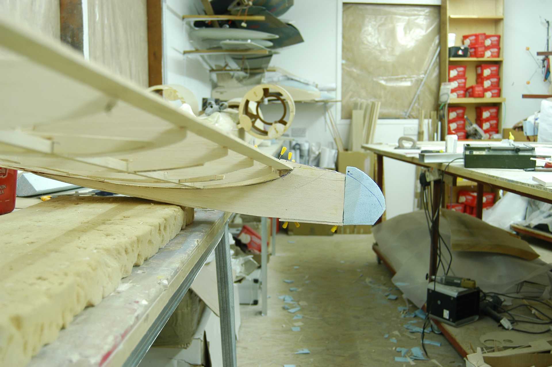

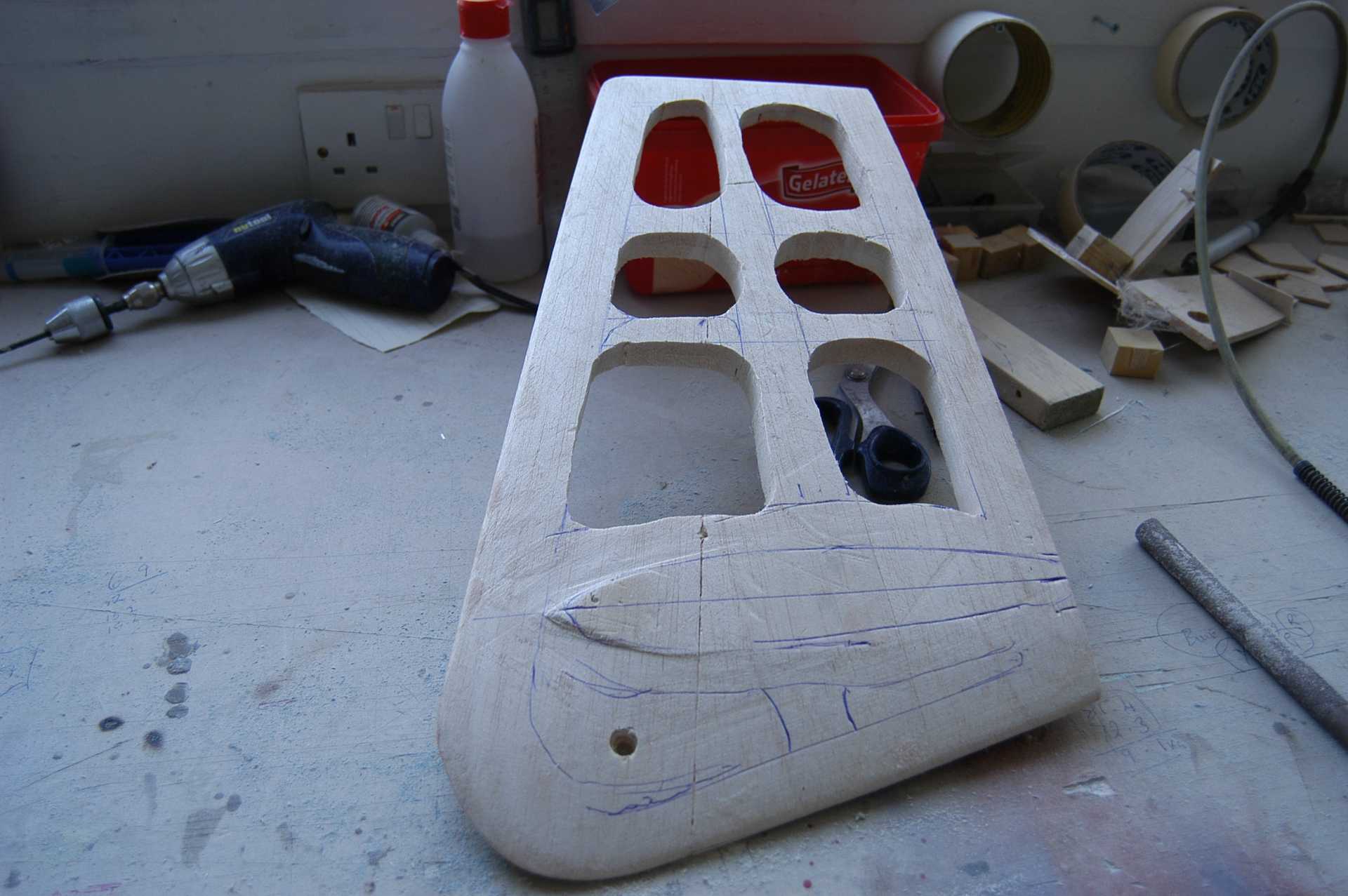

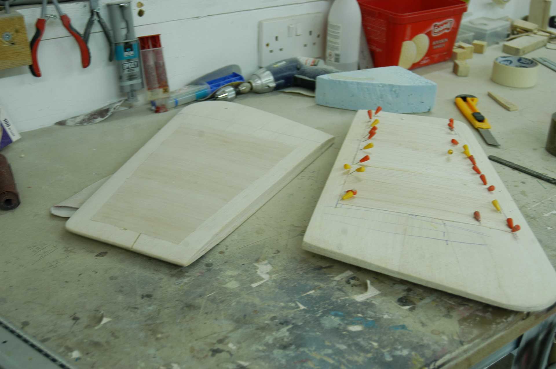

Then the fin, I had intended to do them in fibre glass, but I would need four separate moulds, four separate half's to be joined together with the internal woodwork, so im doing them in balsa, cut out some middle bits to lighten, saved 42 g :lol: then rebated it and laid 3/32 balsa in it

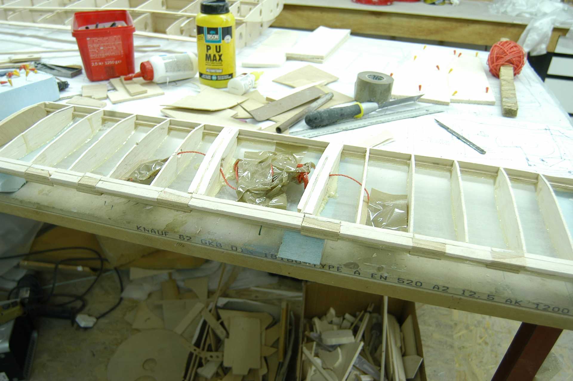

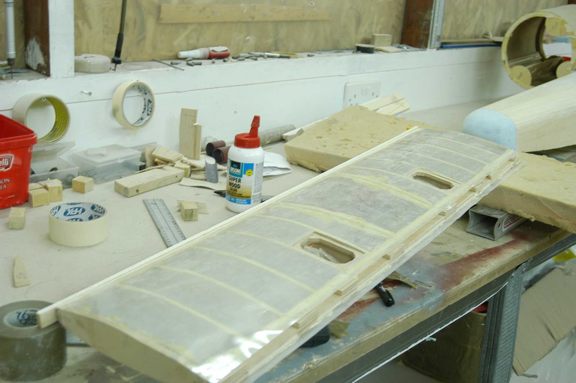

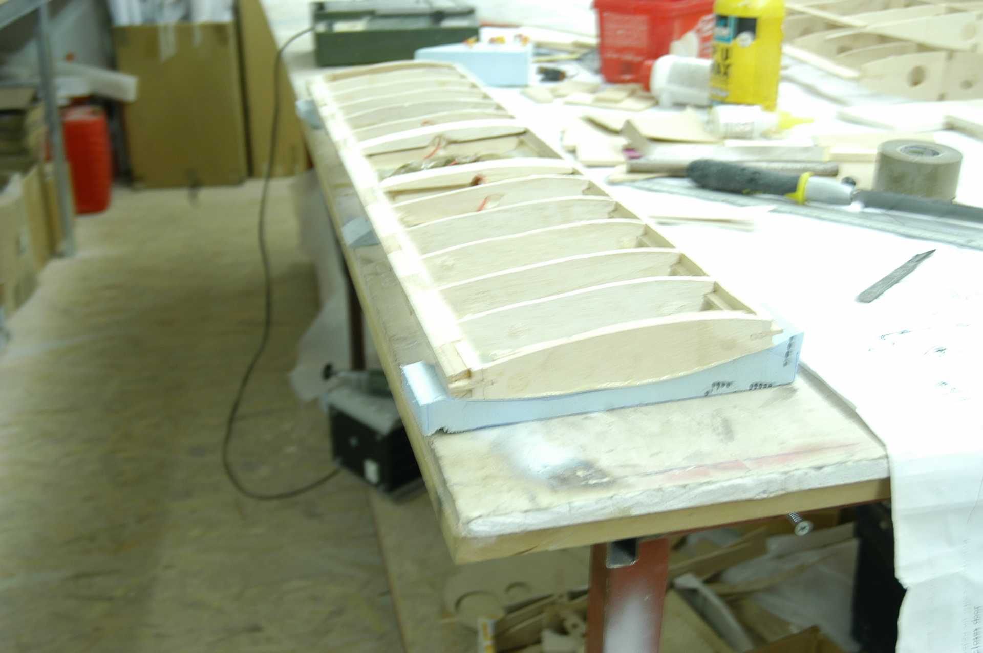

Then the tail plane, added the ply frames and pull strings for wires for the elevator servos, ply blocks for hinges, hard points for fixing the fins to sanded it all down and then covered it with proskin and weighed it down with magazines

Rebated balsa skin!
Seems a complex way of doing it. I would have thought it would have been simpler to build a balsa framework and then balsa sheet it. :P
11 Apr 2017 19:51 #172 by THE BLACKBIRD
Yes Simon but this was the plug for the glass fibre ones ;)
11 Apr 2017 20:17 #173 by Ex-Member

If the original solid balsa fin was going to be used as the plug for a glass mould then the chosen method of its conversion to a 'flight' item makes complete sense. Many thanks.

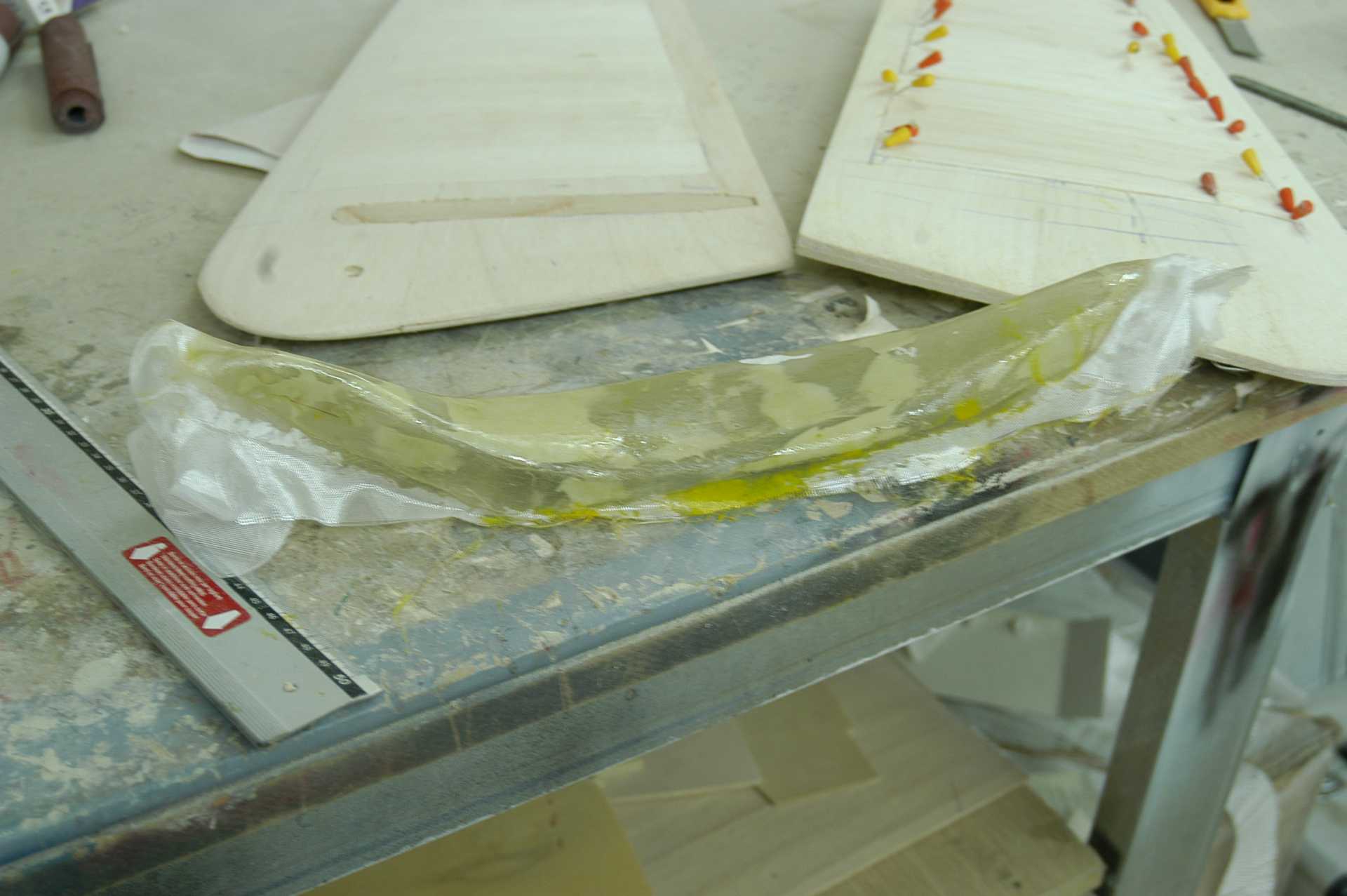

Been tidying up the tail plane and finishing it off, servo mounts are done, just waiting for the hysol to go off
Made the other fin, same as the other one to keep the balance, also laid in a 6mm ply mounting point
Laid the first of the engine to fuselage fairings

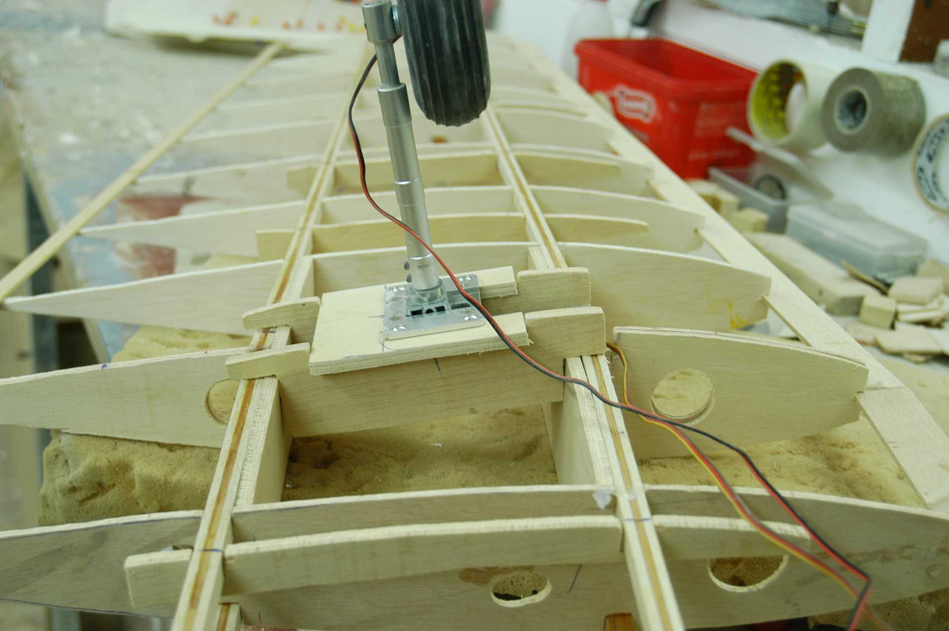

And have been figuring out the main gear mounting o get the angles right, it seems the these planes have long legs, I never noticed before but to get the wheel in the right place with it up determines how long the legs are, probably a 100mm longer than the hunter
I shall be trying to do my own gear again as the set for the Skymaster A10 which is the exact same size as this one is 1900 dollars :S

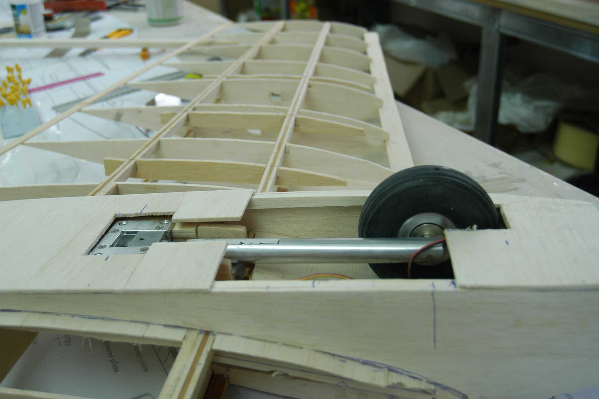

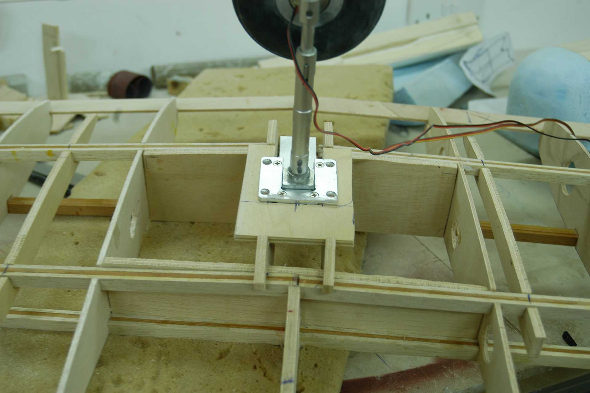

Been working on the retract bearers and the retract pod, took a bit of working out as I have lost the parts for the 1/48 plastic model
About finished the fins, a bit more sanding then they can be glassed

An even less productive day on this gal, a bit more sheeting done and I found just enough bits of blue foam and stuck them together for the front of the pod

Had no time much on it today, but done some more on the pod, reshaped it as it did not look right, it is about done now and I have sorted the retracts out so I can use the same sort as the other jet, cheap ;)
