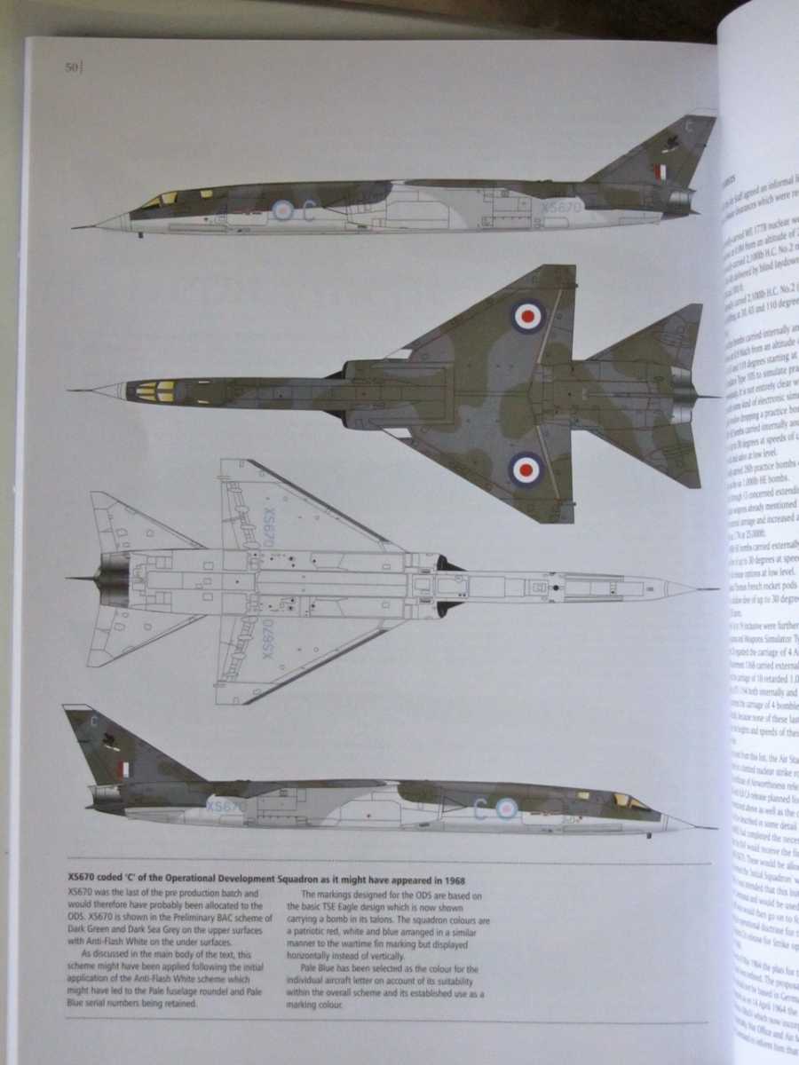

03 Aug 2014 20:34 #34 by Ex-Member
Replied by Ex-Member on topic TSR2 in depron
Thanks to Andy we now have a colour scheme sorted.
