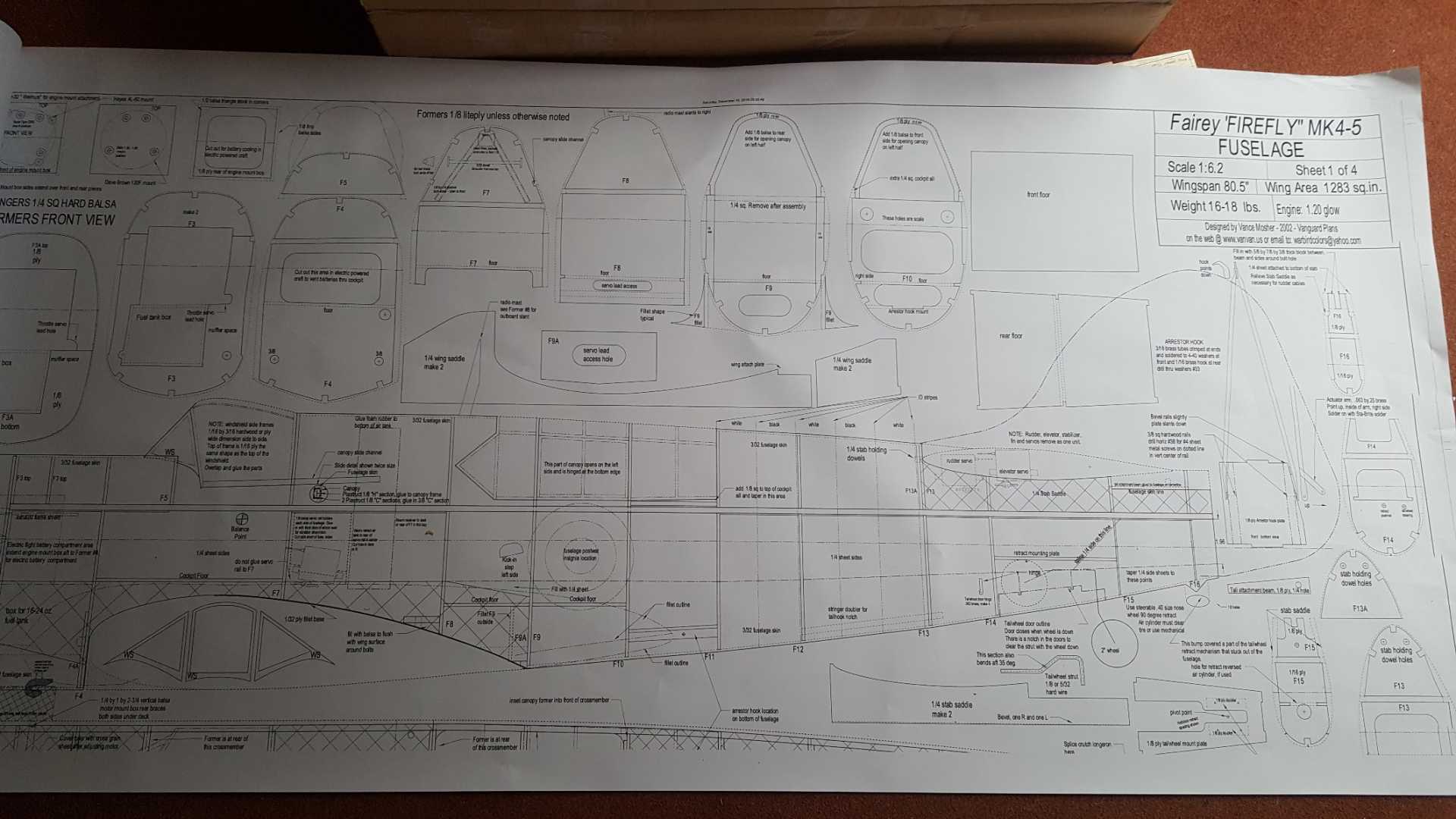

Sadly Vance has passed away so the the plans, laser kits and parts have been taken over by Chuck Greaves. Chuck was very helpful getting my order sorted and shipped. I sent away for the plans, build instructions and the laser cut parts which arrived from the USA 2 weeks from order.The plans are on 4 sheets, very informative and detailed. Laser cut pack is very good with just a few laser burn marks. Nothing a wipe over with sandpaper won't sort.

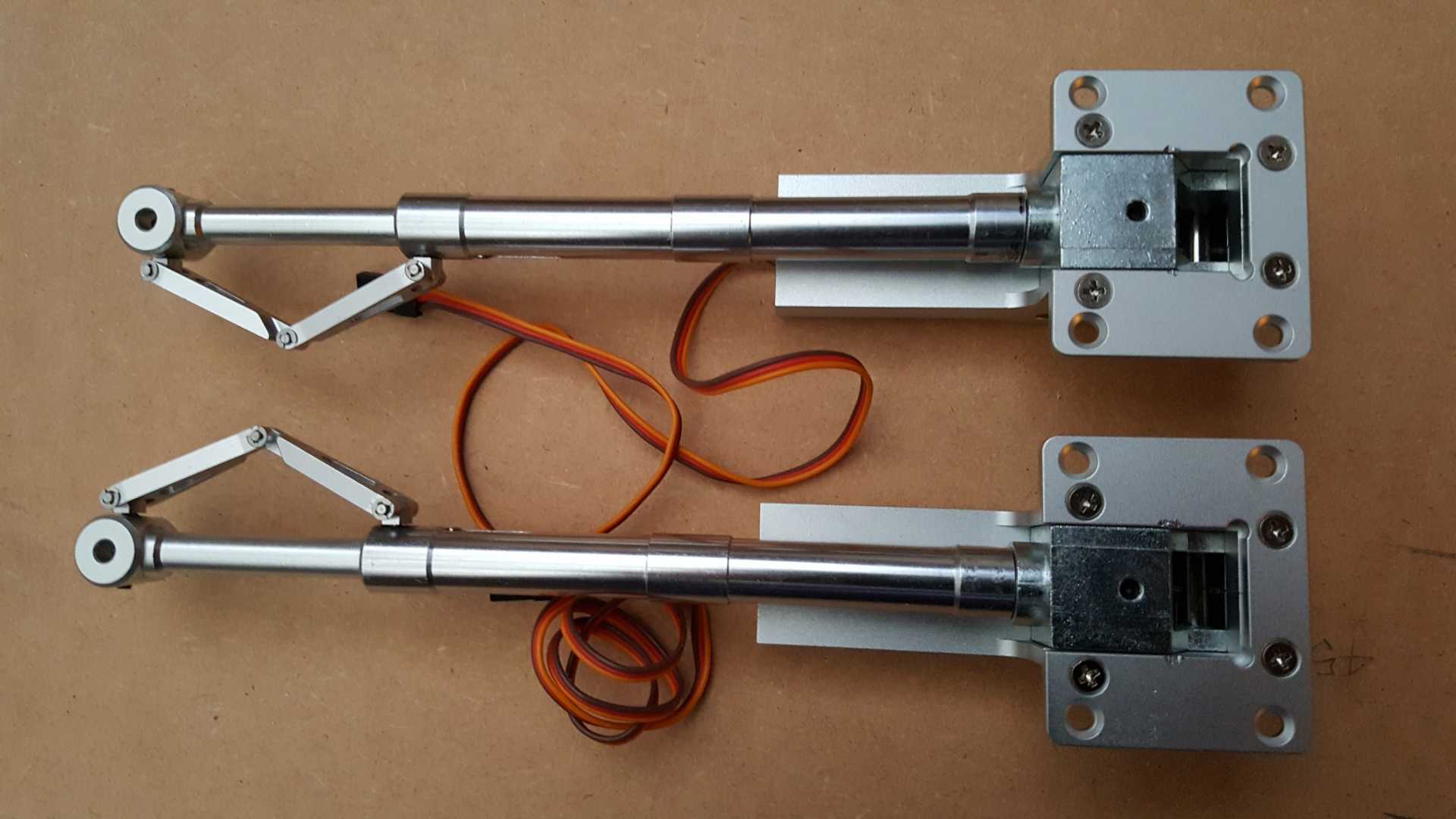

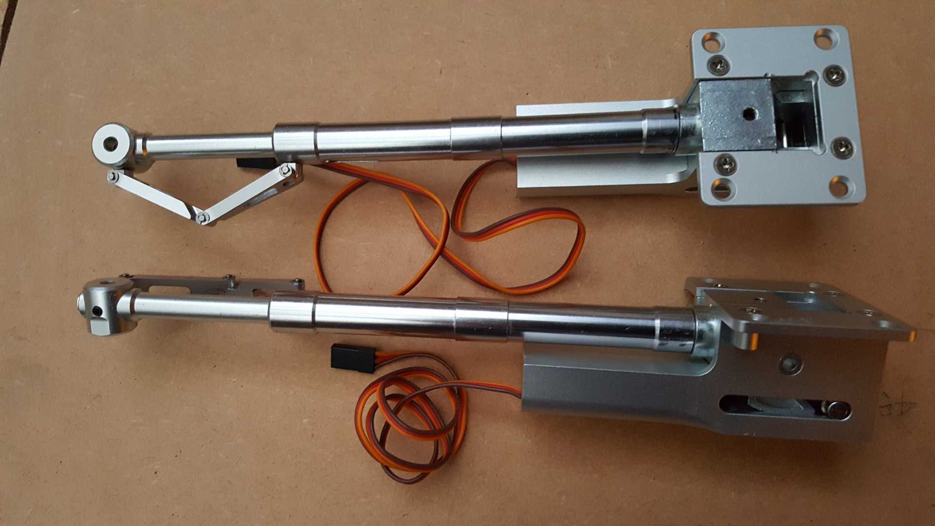

These servoless retracts are rated for 8 - 10kg models so just the ticket as the model is going to be approx 16lb. The action is very smooth. The oleo's were separate to the retract units and slightly longer than required. So I put them in the lathe tonight to get the pivot to axle length correct. Took 20 minutes but they are spot on to the plan. They will need a bit of dressing up to get the scale look but a great starting point. If ever there was an incentive to build a wing these are it.

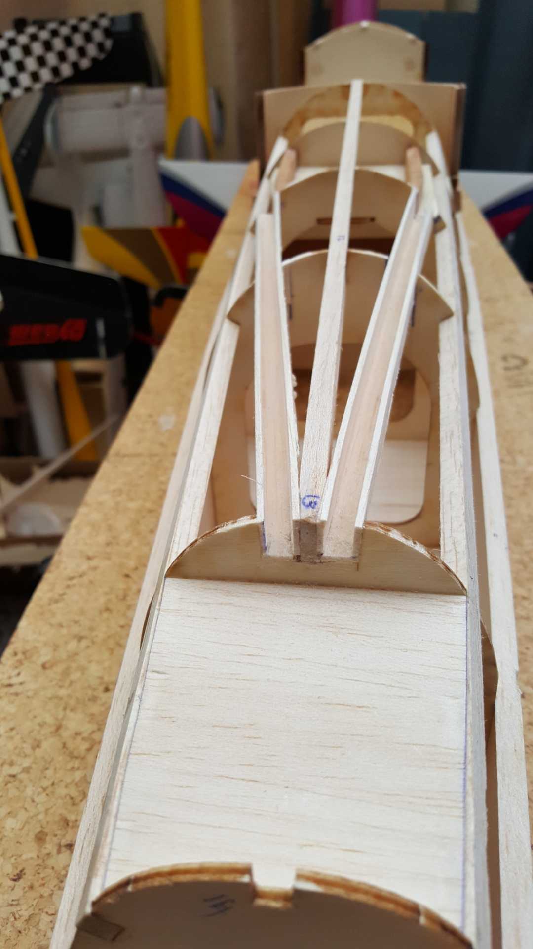

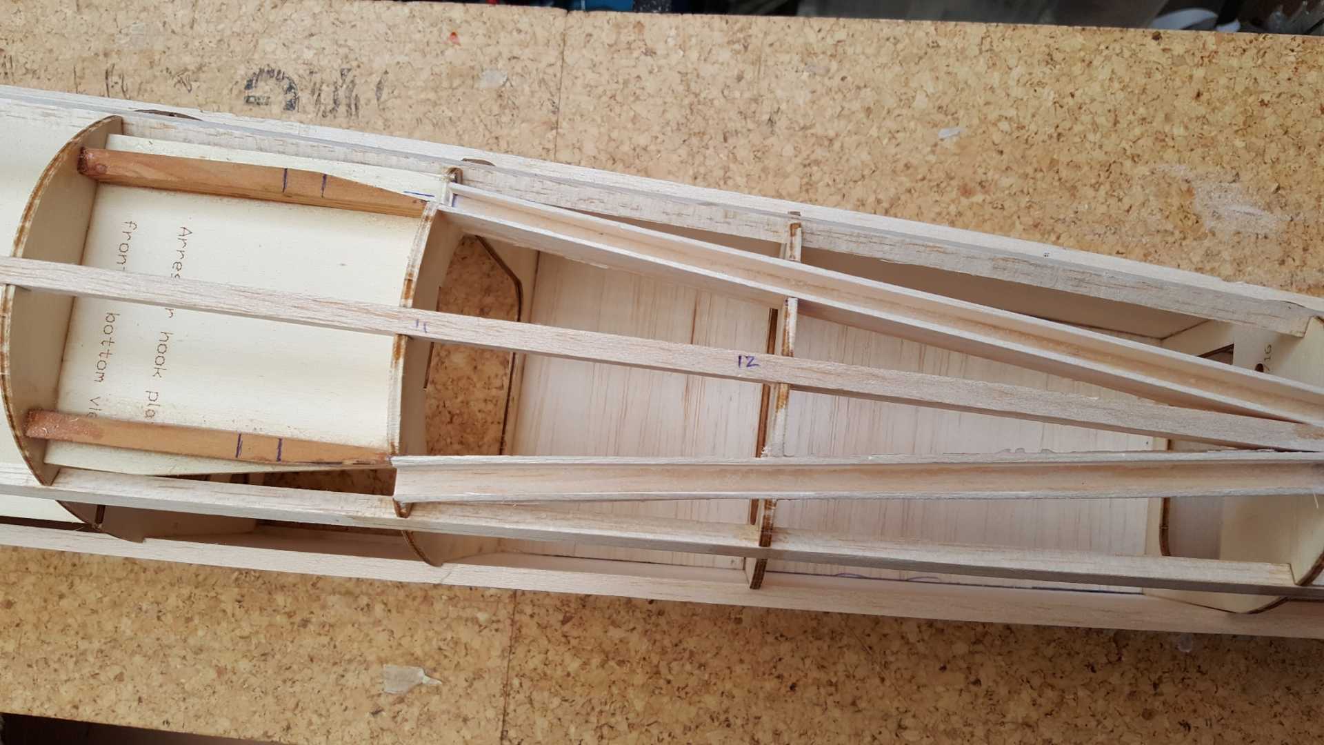

05 Aug 2017 17:44 #14 by Ralpharr2001
Replied by Ralpharr2001 on topic Fairey Firefly MK5 from Vance Mosher plan
Here's another teaser, and build photo's for Tony. :P

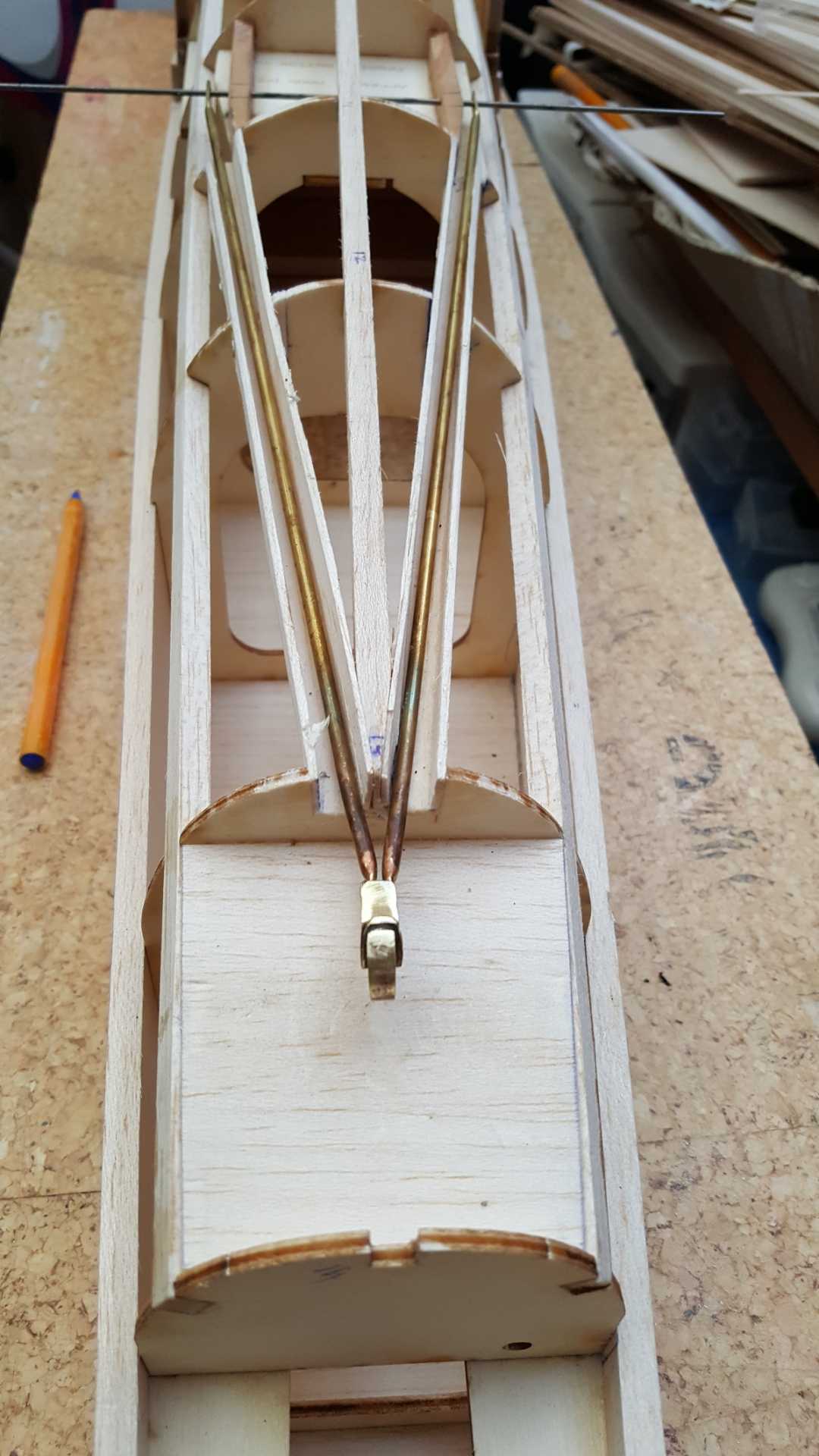

Got on well today. The bottom section of the fuse is pretty well built, just sheeting to do. As you can see the laser cut parts go together very well. Remember, the photos show the bottom half of the fuselage as first it is built upside down. When all the sheeting is done I will turn it over and build the top onto this bottom section.
As expected I have already deviated from the design!! :whistle: :whistle: I have built in the arrestor hook troughs that allow the arms of the hook to sit inside the fuselage. I have also modified the section where the hook sits to be more scale. Yes the hook will be operated by a servo.

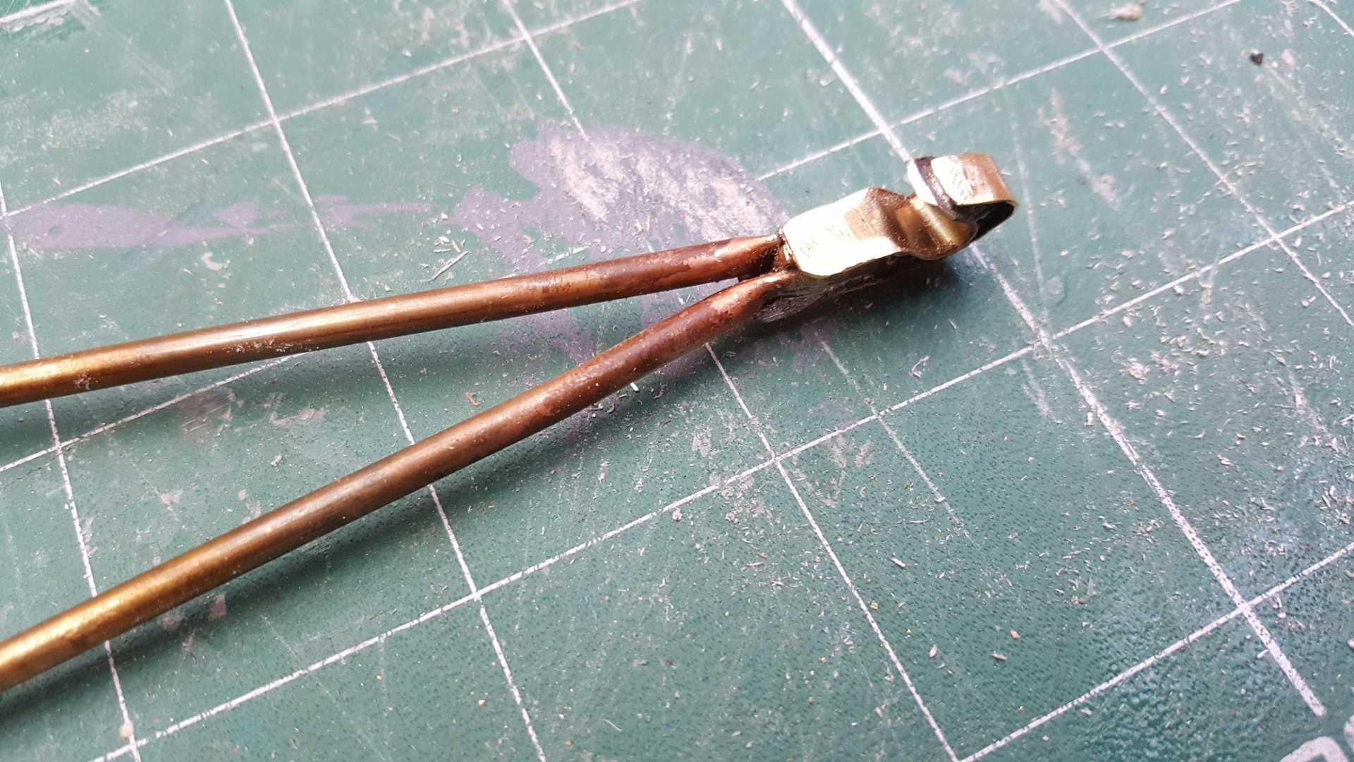

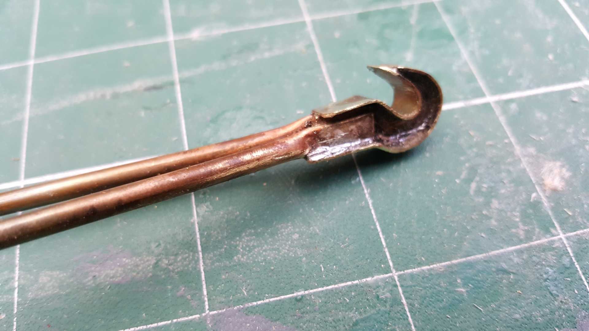

Had a break from balsa bashing and did a bit of brass bashing instead. Made the tail hook arms and hook.
First step was to make the arms by flattening each end, drilling holes for the pivot pins and cutting the hook. The whole assembly was then silver soldered together.
Then I added some thin brass sheet to form the inner and out flange which was soft soldered into place.
A little bit of shaping and we have a hook that is close the scale that i'm happy with. Compare it with the picture in the previous post of the real thing. I will add the internal bracing angles with a soldering iron later. With some filling, sanding and painting it will look quite good.
