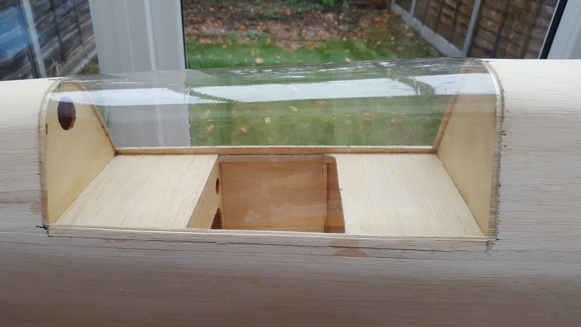

Replied by Ralpharr2001 on topic Fairey Firefly MK5 from Vance Mosher plan
Did a little more on the Firefly. Got the cowl to fit quite well. Only a little filler will be required. Considering the state of the cowl to start with I'm pleased with it.
Fitted the observer canopy. On the full size aircraft this fit flush with the fuselage skin. So I rebated the edge balsa skins and sat the canopy into it. I shall frame both canopy's with 1/64th ply. So the edges will be framed to the fuselage skin as per the full size. Should look ok.

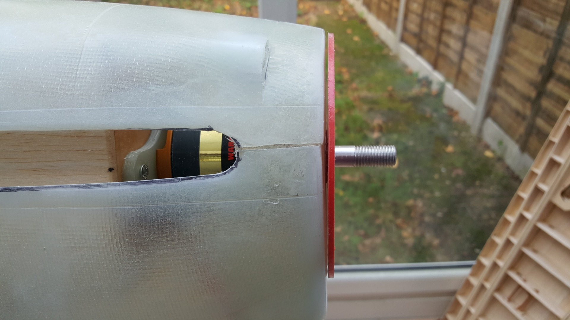

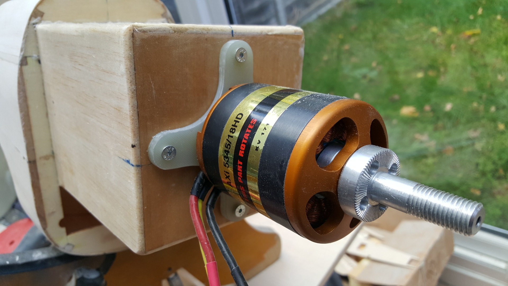

20 Oct 2020 16:49 #64 by Ralpharr2001
Had a pretty crap day at work so decided to leave early and do a bit more on the Firefly.
The job tonight was to fit the motor. Which required getting the thrust line lined up with the plan, lining the cowl up square to the bulkhead and the spinner back plate lined up with the front of the cowl with an even gap! :unsure: Not too much to ask. Well I must come home frustrated and stressed more often!! It went extremely well. :woohoo: I printed a temporary spinner back plate for alignment purposes. Everything lined up, nice gap between the spinner back plate, on center to the front of the cowl and the back of the cowl lined up perfectly. Not wishing to push my luck i stopped there and had a glass of wine to celebrate!! [badass]

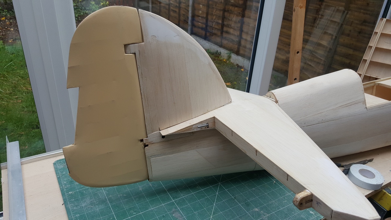

25 Oct 2020 17:22 #66 by Ralpharr2001
Focused on the tailplane this weekend. The rudder is fabric covered on the full size so I covered the model rudder in Solartex. Film covering is not one of my favourite parts on building model planes and I've never used Solartex before. So a good recipe for a cock up, teddy's getting thrown out of the pram and the wheels pulled off it for good measure. :dry: :dry:
It actually went on quite well and is easy to form around curves and teddy is still in the pram. :woohoo: The secret is having the right temperature on the iron, 100 - 120C is good and slightly higher, 130C, for tightening. It was recommended not to use a hot air gun just the iron. Very pleased with the result. Only got to make some rib stitching and add that, something else I've never attempted.
Fitted the tail lights for the scale look.
Servo's, Hitec 5085MG, were fitted and linkages made. Works nicely. A little bit of tidying up just before paint and this part is ready.
