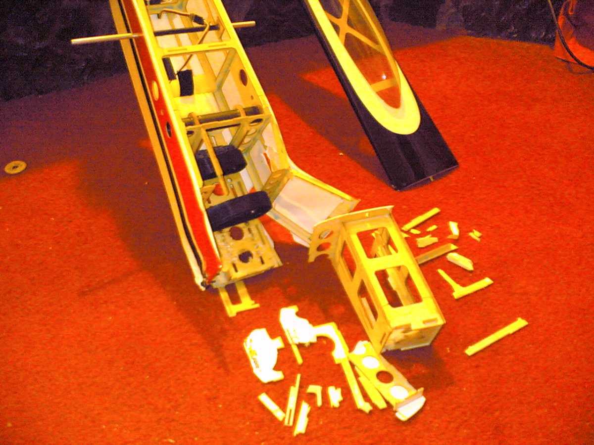

11 Dec 2013 19:32 #70 by Phil Wood
As some of you may know, this model did get completed & flew very well.... for a short time. :(
I made the mistake of using an Orange receiver without a satellite & the range just wasn't up to it. Garry was flying it at the time & he shouted to me that he'd lost all control, we could do nothing but watch as it spiraled in. :ohmy:
It's been put on ice since then, but it's going to get a reprieve & be put back together. ..... here's what I've got to fix. [badass]

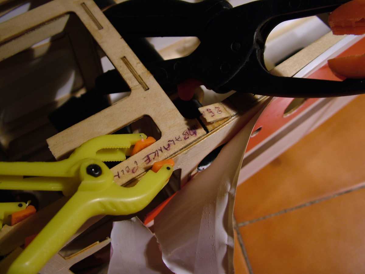

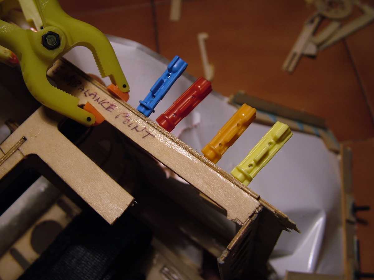

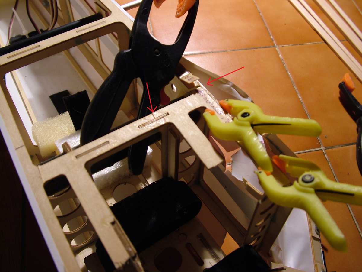

21 Jan 2014 03:45 #74 by Phil Wood
Finally got around to working on it again, even if it is "Stupid O Clock" in the morning. :silly:
My approach is to refit as many scraps of the remains as possible first.
My logic in this is that the basic geometry is easier to get right if all the old bits fit. The original structure had the correct side & down thrust built into the bulkhead or firewall ... I'd like to get this exactly the same.
I'll strengthen all the glued areas later, but for now I'm lining up & tacking pieces like this .... the bit where I wrote down the balance point is nice & easy .... just match up my handwriting.
